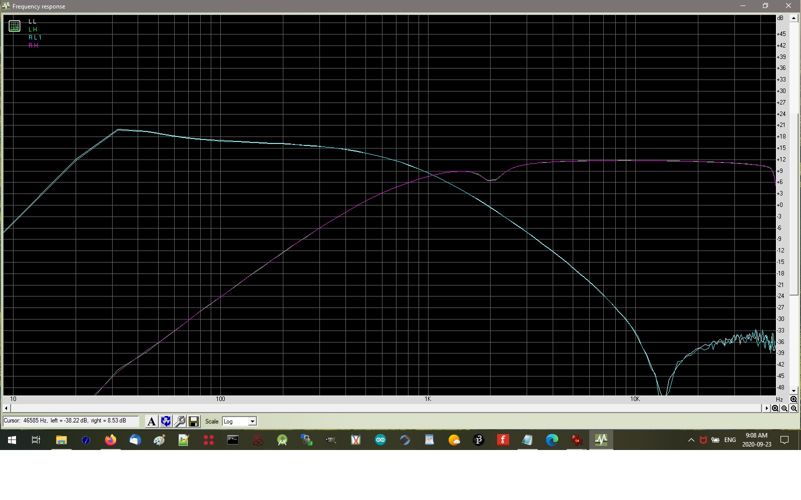

It doesn't look like a serious issue, but it's interesting.
One possibility is C28, which if it has some inductance to it might give you
something like this.
When I have some time I will take a look.
Great thank you pinholer for your feedback. So i will live it as it is and began listening to music!
Mr Pass, If it can help pinpoint the cause the notch seem to follow the cut off frequency. Here's some more graph with different frequency setting for the low pass.

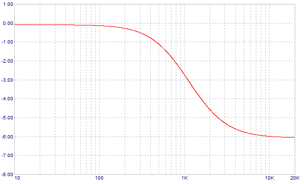

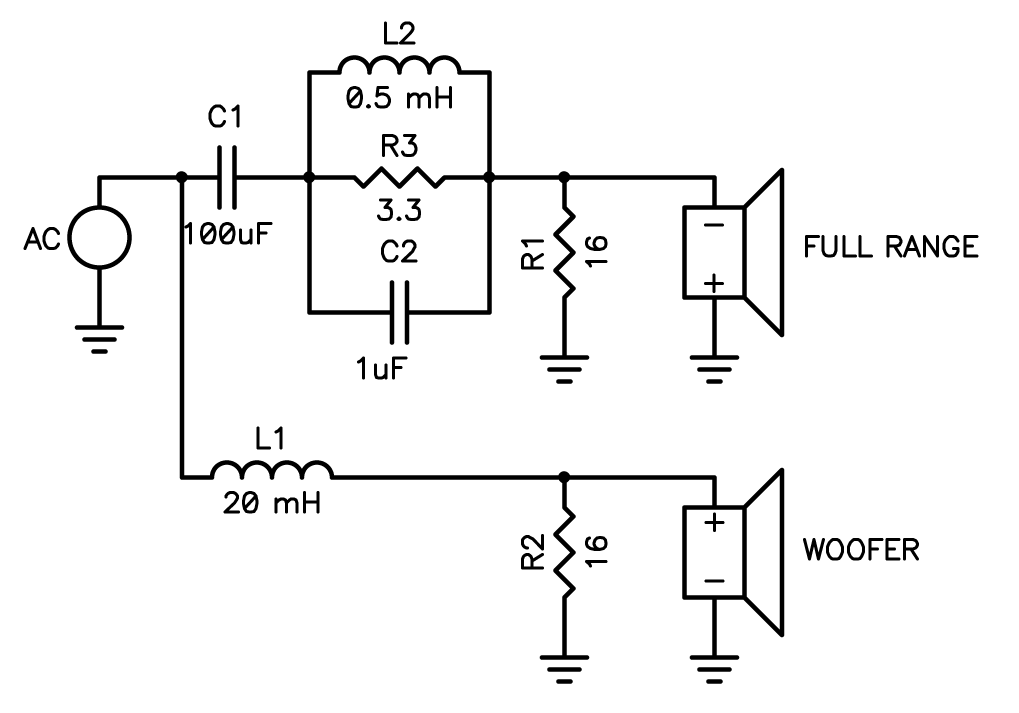

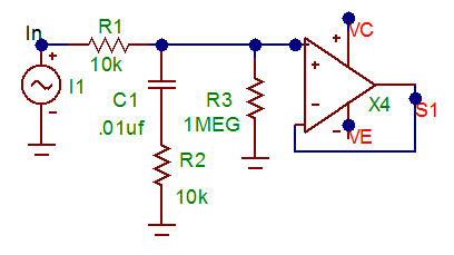

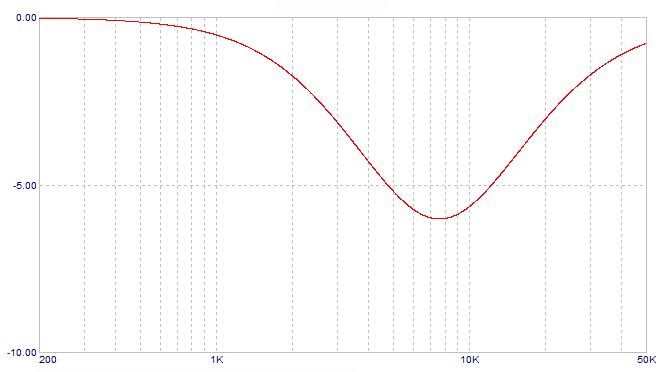

I just bought a pair of the SAL drivers that I want to use on the Martin King open baffle. For complicated reasons this calls for a 200 low pass on the woofer and a 500hz high pass for the SAL. But Nelson has noted this driver might benefit from this correction filter that applies -4 db above 2.5k. Would that type of conture be hard to implement in this crossover. Or I could just go old school and wind that .5mh inductor for the network.
Nelson, thanks for the response. For my power needs if I use your passive LRC filter I only need about 10 watts but using a line level filter I won't need that much power. And needless to say happy new year.
