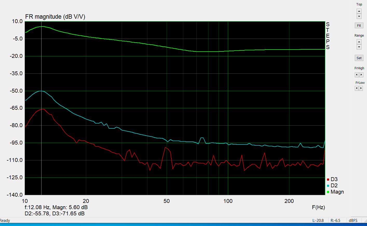

So I measured the 100 or so J113s that I have and found that they are all more or less from the same batch with Vp between 1.5 and 1.99V. The Idss is 19 to 22mA. So I breadboarded the LXminStudio Sub filter and finally got an acceptable response curve measurement. I then checked both the THD and the swing limitations (with my limited means) and am satisfied with the results.
Here some data points:
For a single J113 buffer I can get the THD down @ 1KHz to .006x% (take this as a relative indication with my measurement set up: Focusrite Scarlet2i2, REW or ARTA). Interestingly the CCS source resistor at 140 to 150 ohms sets the stage but the load resistor at around 9kOhms (vs. 10kOhms) makes a difference in THD.
For the complete Sub filter the THD @ Freq. less then 40 Hz the whole set up is feisty ( a lot of 50Hz noise etc.) but shows THD .x%.
Base Boost is there: @12Hz just under +6dB
Output Swing: About 20 Vpp at the output at 12 Hz at clipping onset (gestimated from scope). For what I need this should be house shaking.
Anybody see anything off the mark on this way forward?

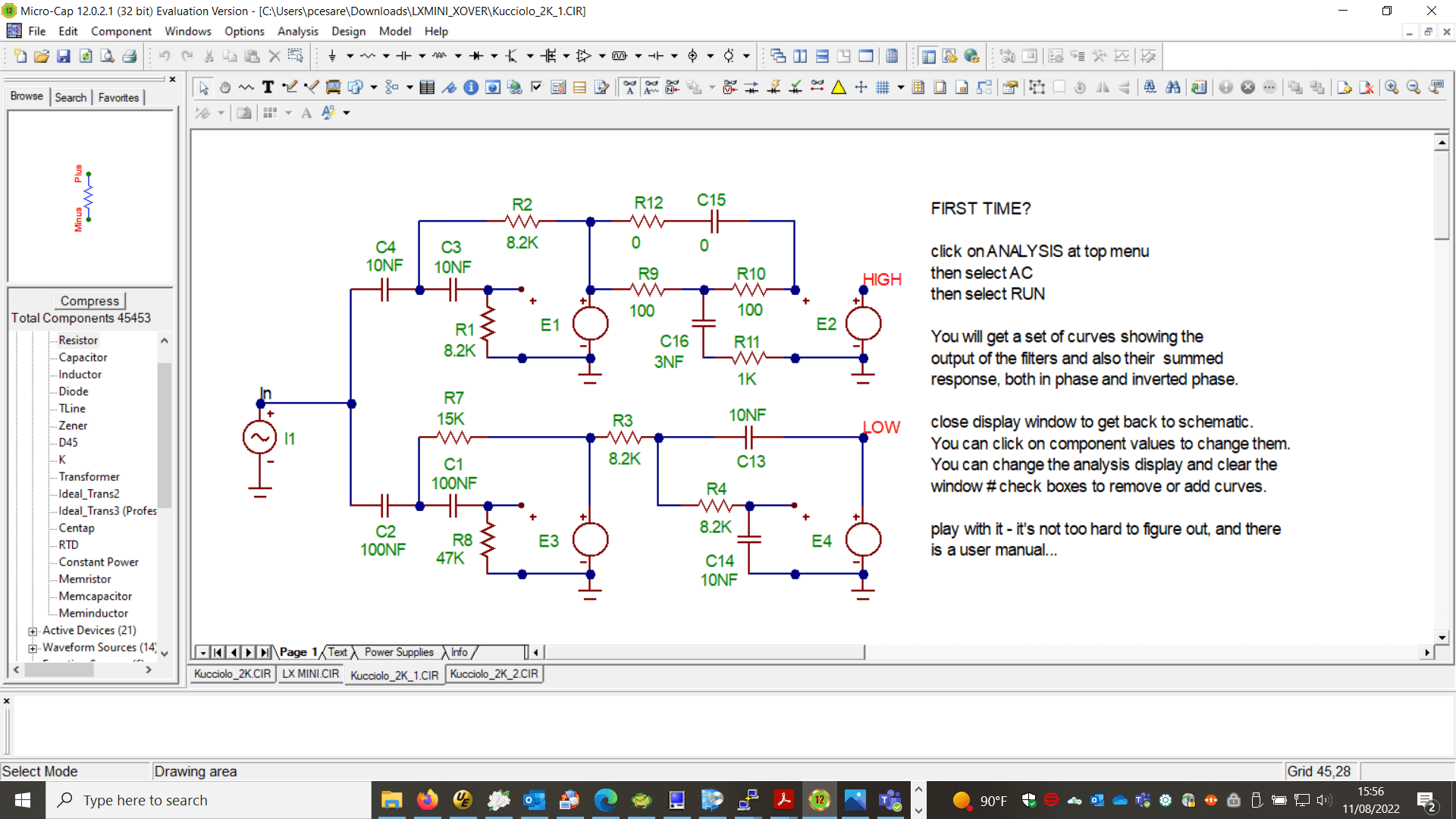

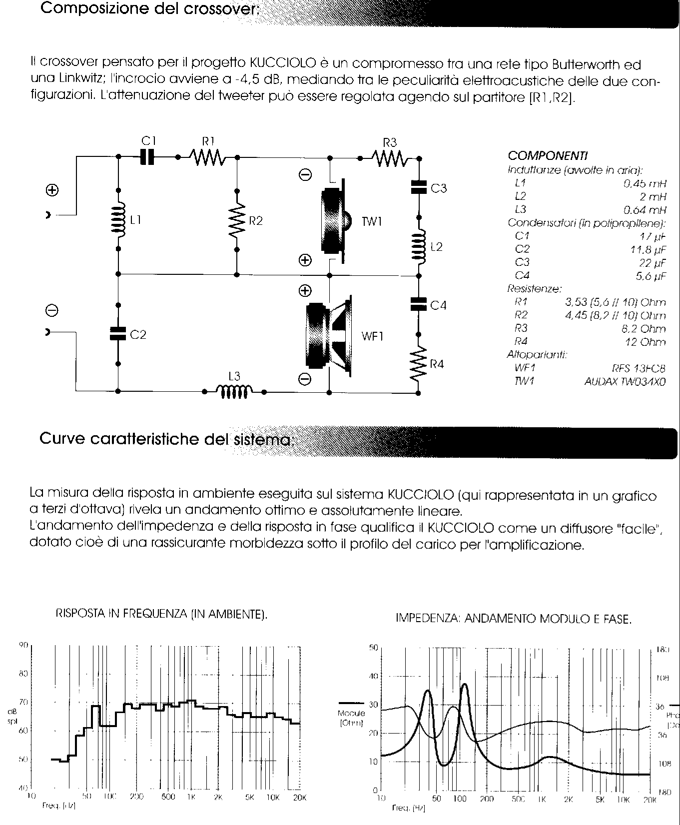

Hello great comunity ,I am a beginner and try to understand how to use the LX-mini crossover for and old 2 way speaker presented many years ago on "costruirehifi" magazine equipped with mid-woofer RES 13FC8 (was SIARE 13V8) and tw AUDAX TW034X0.
The passive crossover is a compromise between a Butterworth and Linkwitz network, mediating between the electroacoustic peculiarities of the two configurations with an fc about 2000Hz, the attenuation of the tweeter is regulated by the resistances R1 and R2 of the attached schematic.
I followed the cubicincher user approach by creating the same bandpass between 50Hz and 2500Hz (C1=100nF on simulation) for the mid-bass and a LP filter
set to fc 2000Hz .z
For my point (better noob ) of view the microcap simulation would seem correct, I'd like to have your opinion.

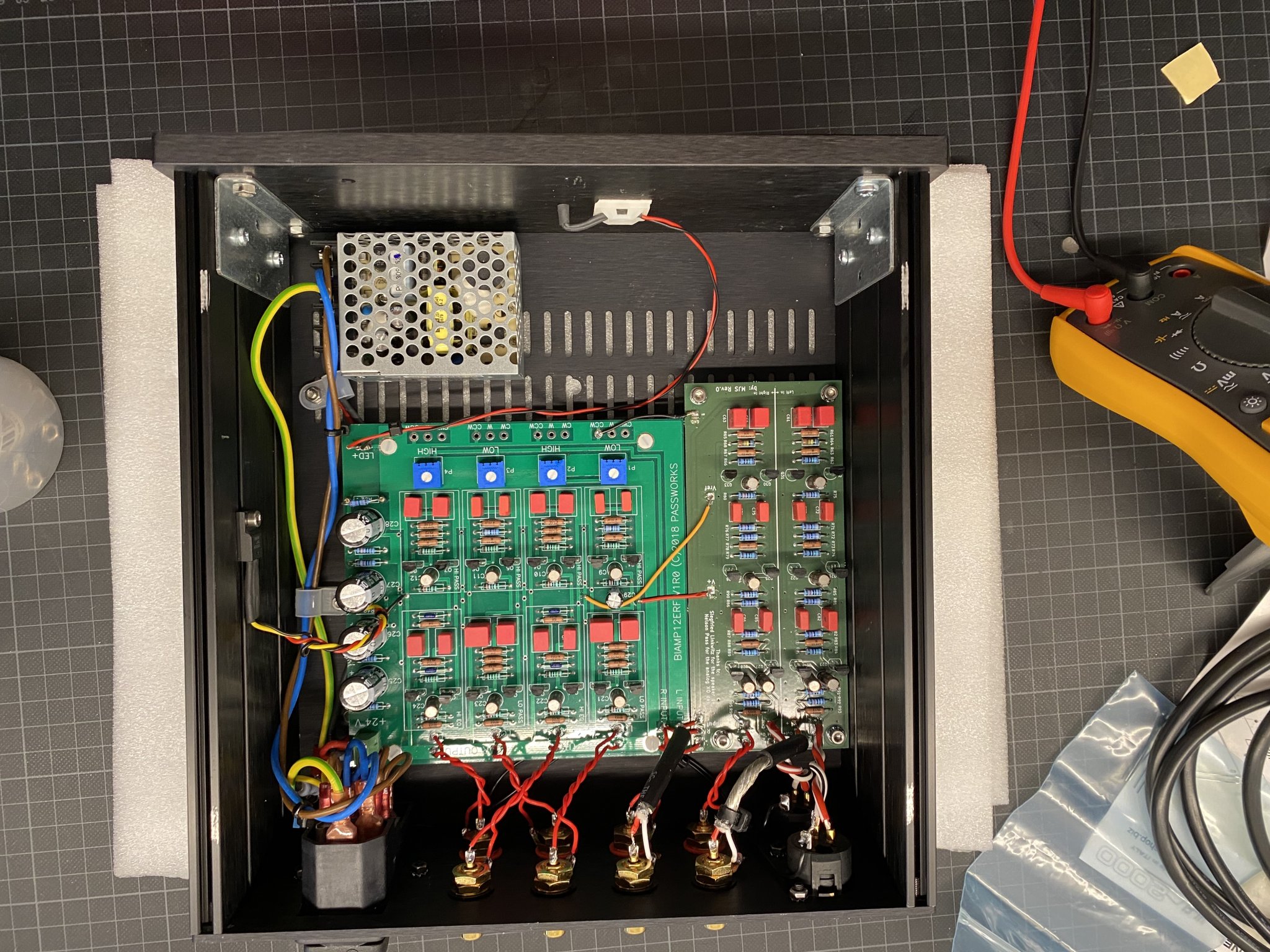

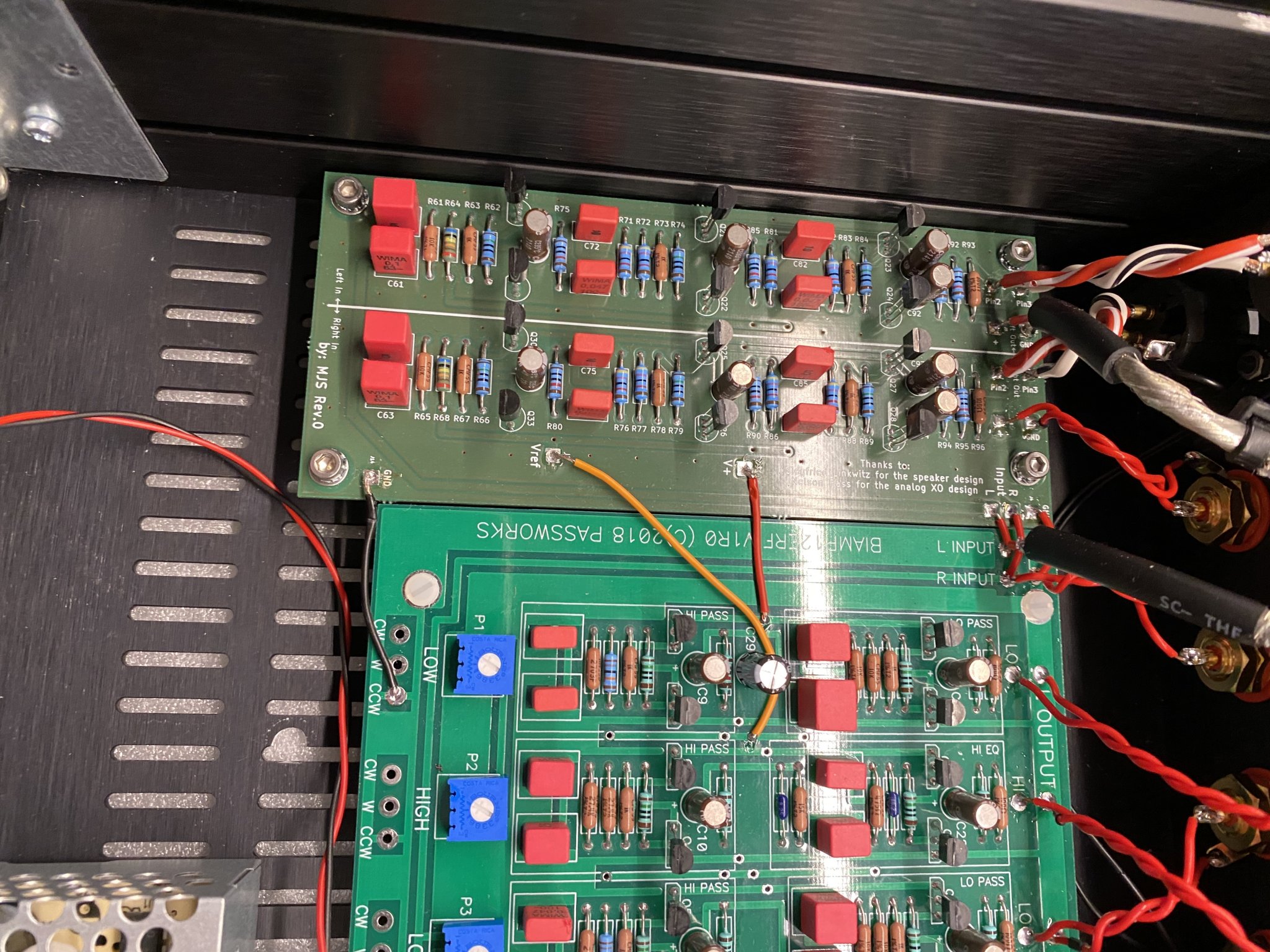

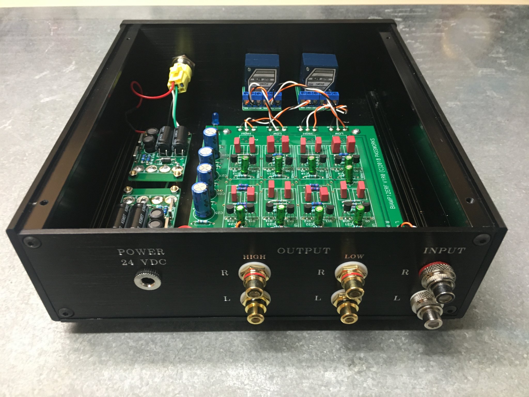

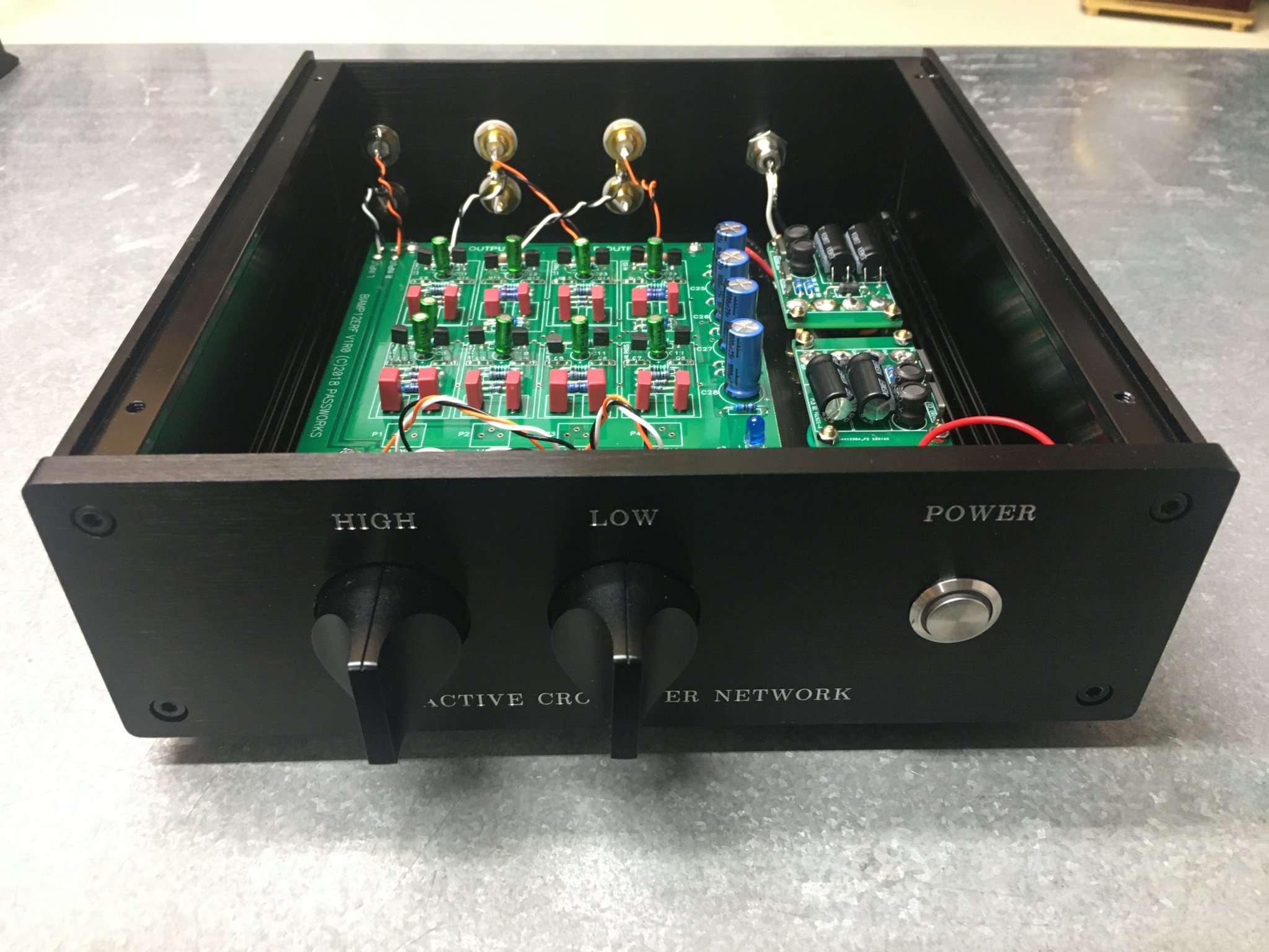

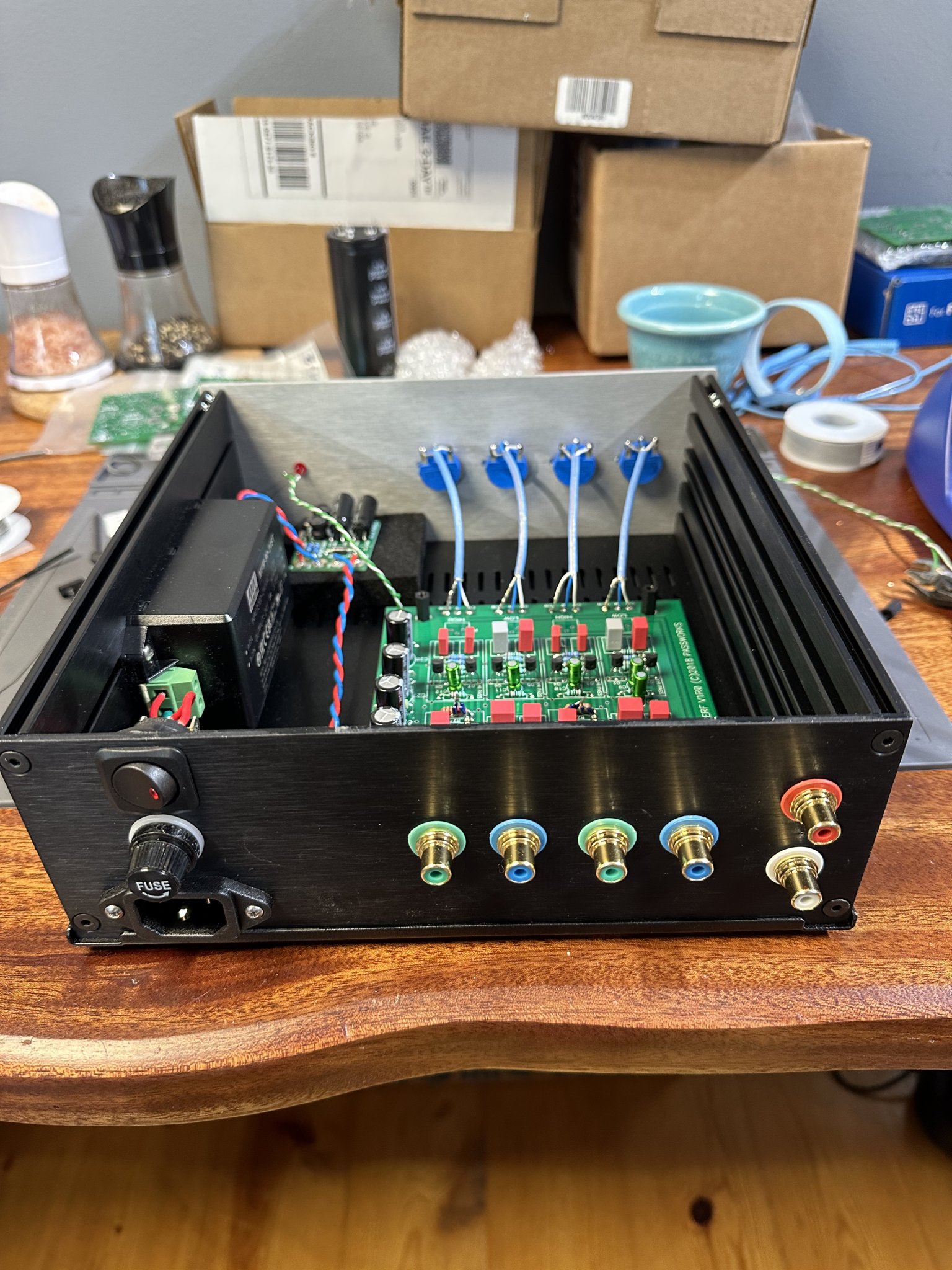

Finally up and running and here it is. It has been quite a while since I last heard them in the all Class D configuration so sound quality memory my be weak but after some break-in it sounds good. The subs are still Class D powered and the bass is great. My 35 Hz room mode is alive and well but only sometimes over powering. Need to look into this when I get around to finally setting up the LX-minis properly.
A special thanks to Nelson for his design, support and patience (with me ) on this endeavor. Well worth having the LX-mini's singing again.
