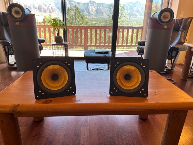

Hello,
I have not been on the forum for a while also a novice at DIY audio. What led me to this forum was a web search on "Cube Audio F8 Magus Open Baffle and stumbled on to this Stereophile article which showed Nelson Pass's Open baffle design using his LXMini. I own a pair F8 Magus drivers and would very much would like to see if I can implement Nelsons open baffle design.
Has anyone else on this forum followed Nelson's footsteps using Cube Audio's magnificent drivers?
Thank you.

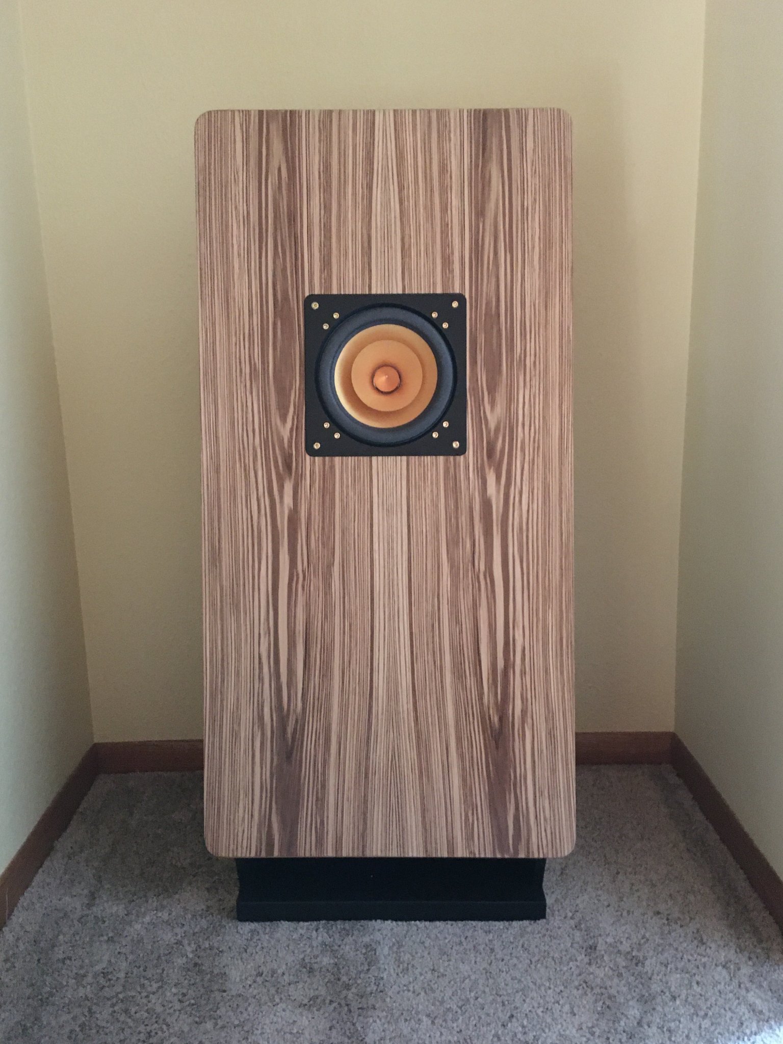

I'm using the Active Crossover Network, which is the LX-Mini with a different crossover center point, the filter values I used were from Nelson's Speaker Camp last fall. The ACN goes to a Sony VFET P channel amp by Nelson and the Woofers are connected to an SIT 50W amp using TOKIN THF51s VFET's designed by Zen Mod. I only had this system in place for a month or so before converting back to Lowthers and a J2 clone amp I just finished.
I very much enjoyed the sound with the two amps, I would like to dial in the EQ of the ACN for the CUBE FC 8 full range drivers, Nelson used the EQ for the MOTH's FR drivers during the speaker camp. I'm not sure if there is a difference, I just want to learn how to measure speakers and make small adjustments, which I'll do after I've listened to the J2 for a while.
Reactions: Monk55
