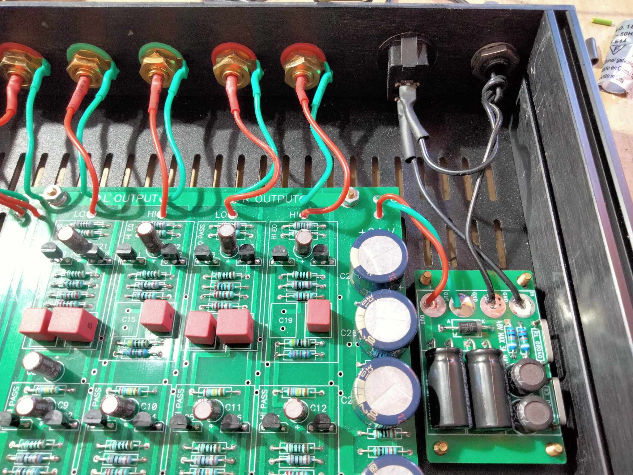

Now I have to build a Balanced version of the LX-mini/ACN, I think this amp will do a great job with CUBE full range. Two boards stacked on top of each other will work to keep enclosure size to a minimum.

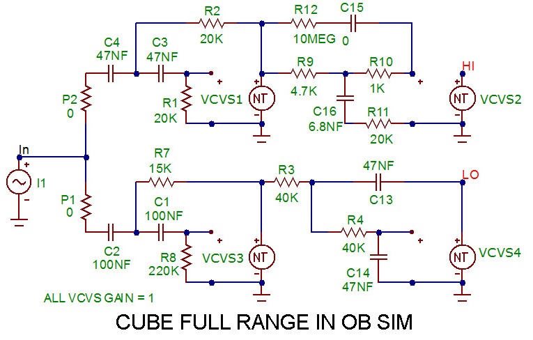

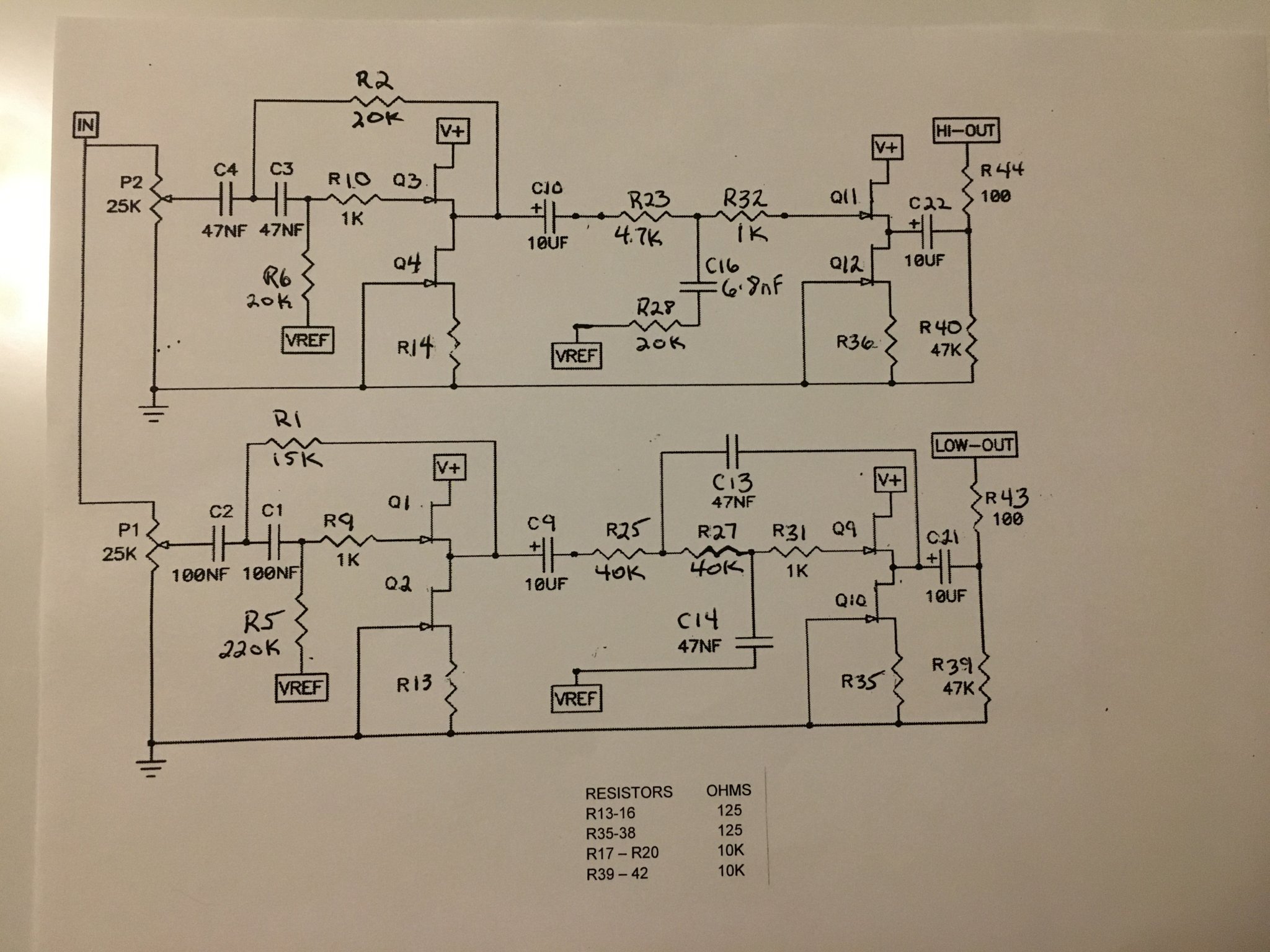

Go to FIRSTWATT.com, find the articles tab, then open the 6-24 article. Nelson supplied a link to a site that has the filter calculators, make sure you select the 12dB filter on the calculator.how can I calculate R, C value ?
Hello Marcus Solomon,
Nelson Pass offered a link to the download of the microsim-software (testversion) and the circuit in microsim to play around with those values
in the LX-mini-crossover.
https://www.firstwatt.com/pdf/art_lxmini crossover.pdf
check last page - last two paragraphs.
The circuit of the LX-mini-active crossover has an equalization built in. It is different to the 6-24-AXO.
Or you could simulate the circuit in LTspice?

Thank you, now I desoldered all R,C from original value (BOM) and prepare to measure their crossover point soon.Go to FIRSTWATT.com, find the articles tab, then open the 6-24 article. Nelson supplied a link to a site that has the filter calculators, make sure you select the 12dB filter on the calculator.

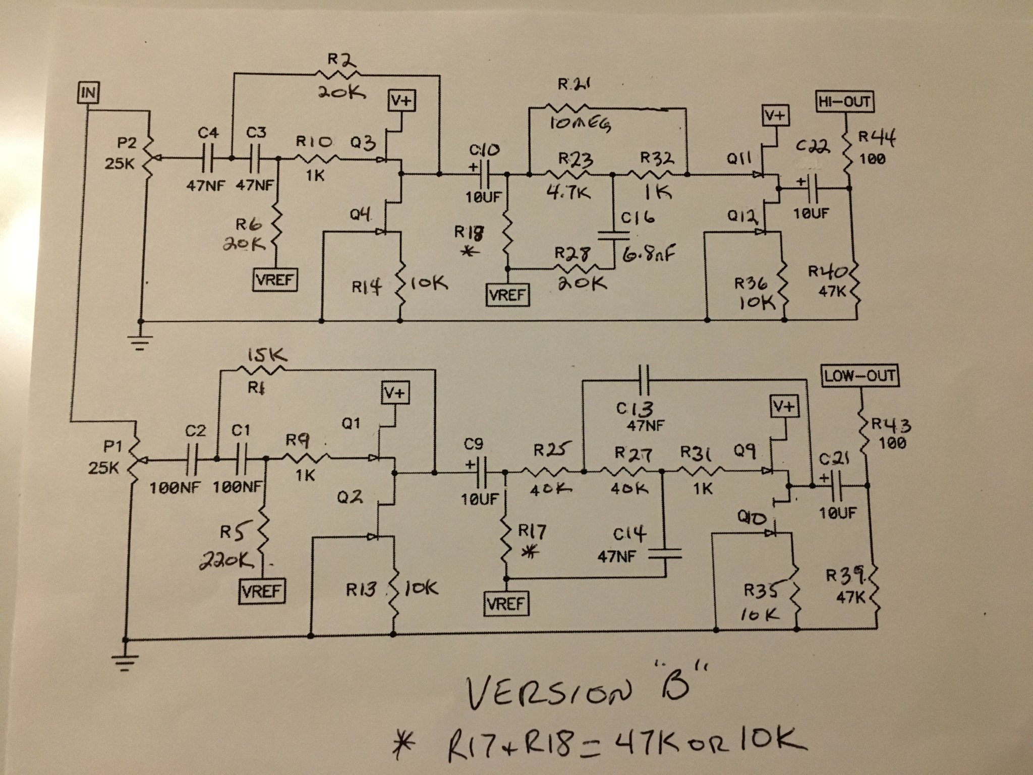

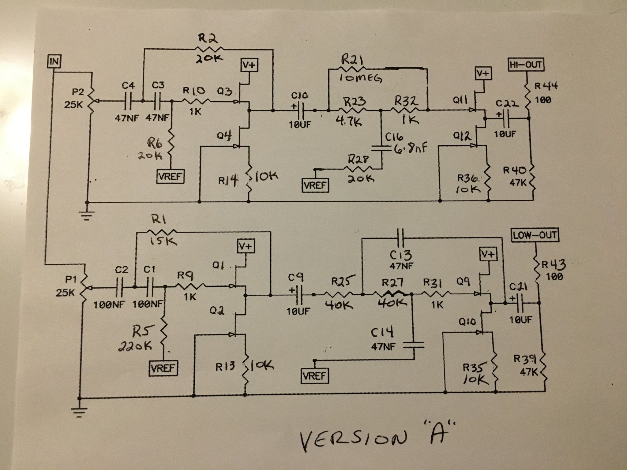

I have the SLOB speakers with CUBE FC8 drivers for the full range, Nelson Pass was kind enough to send me the schematic for the ACN/LX mini using the CUBE full range drivers that he built. I was trying to understand the entire schematic with the buffers, and I'm not sure which version is correct for his schematic. I used the R, C & Q designations that match the LX mini ACN printed circuit board from the DIY Store.
I need help to understand which schematic version, A or B, is correct.
I finished the schematic, on the bottom of the page is the slip of paper that is included with the JFET's and resistors when the lx-mini ACN PCB is purchased from the DIY store. IGNORE the 10K resistors, they are not used in this version, the 125 ohm resistors are for the JFET's source resistors.
The two completed CUBE ACN boards used 150 ohm source resistors, the 125 ohm source resistors were used in the single ended version I built.

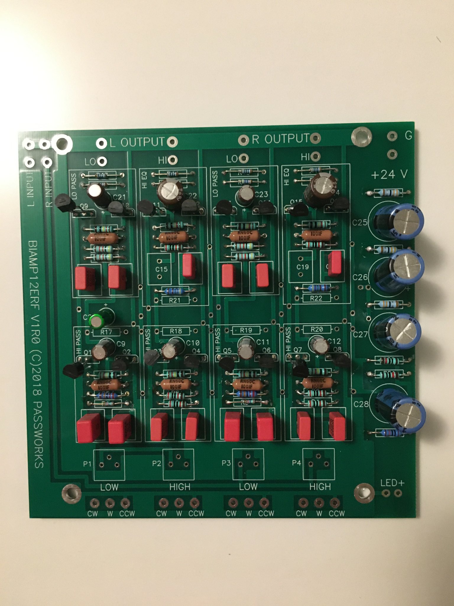

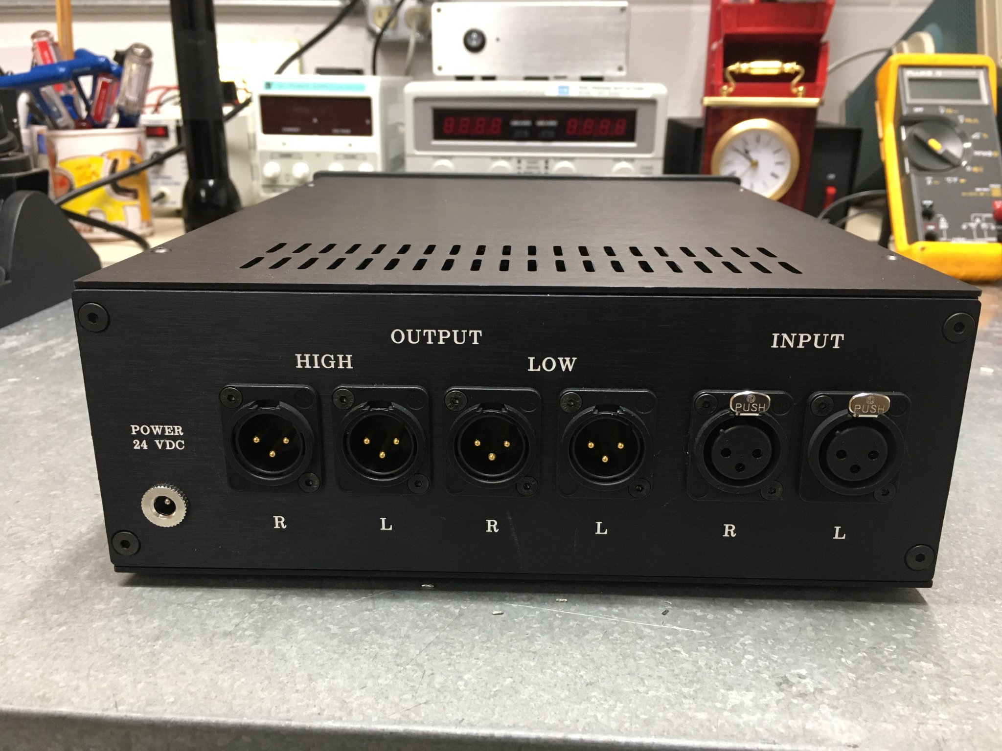

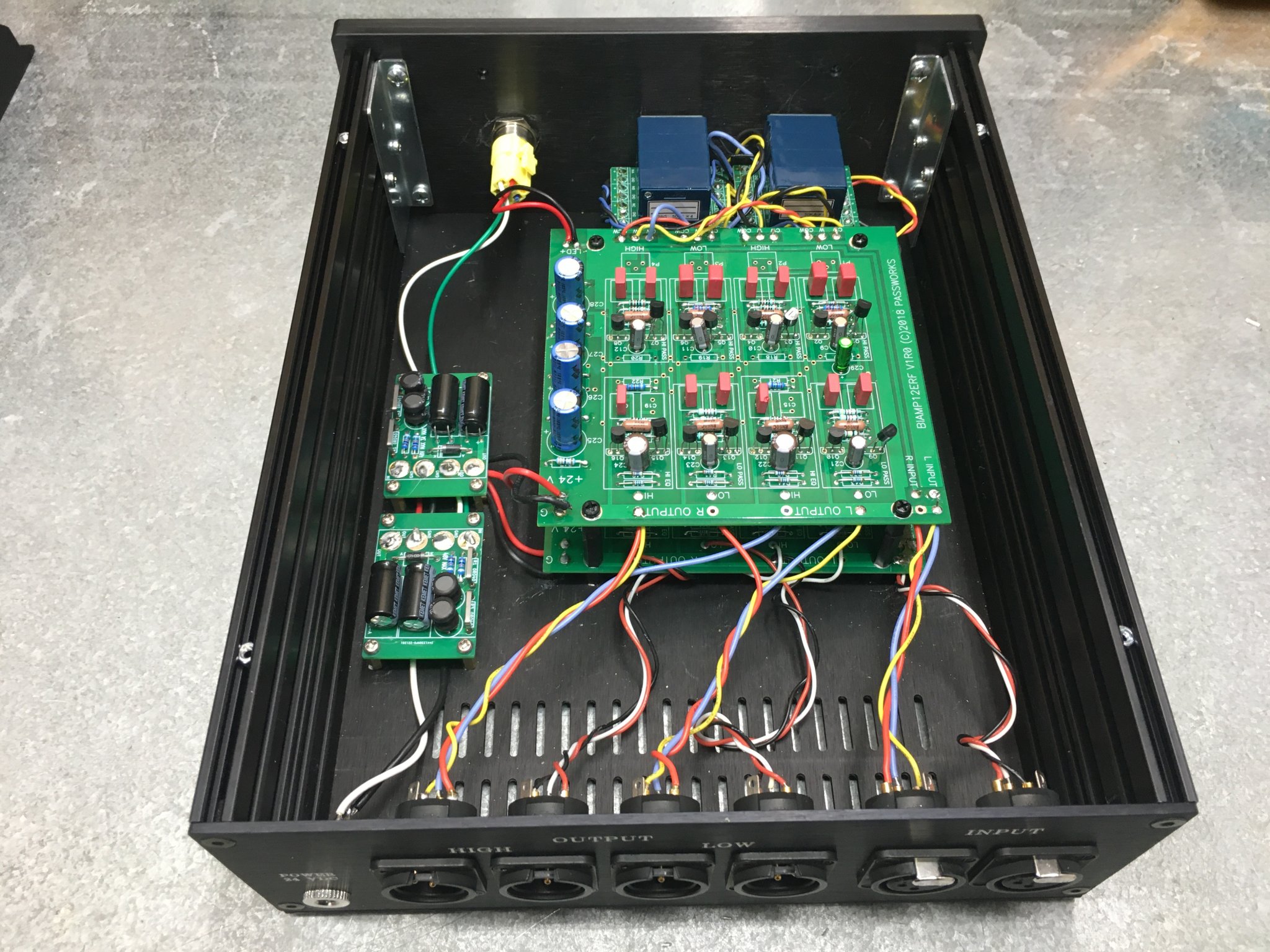

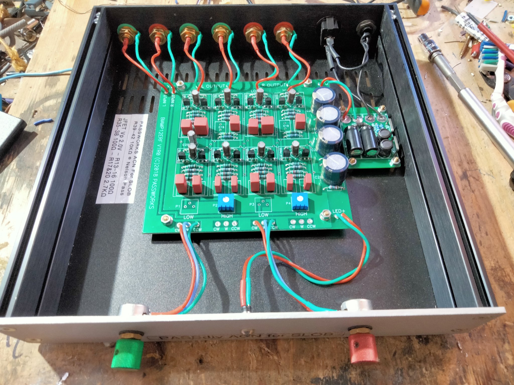

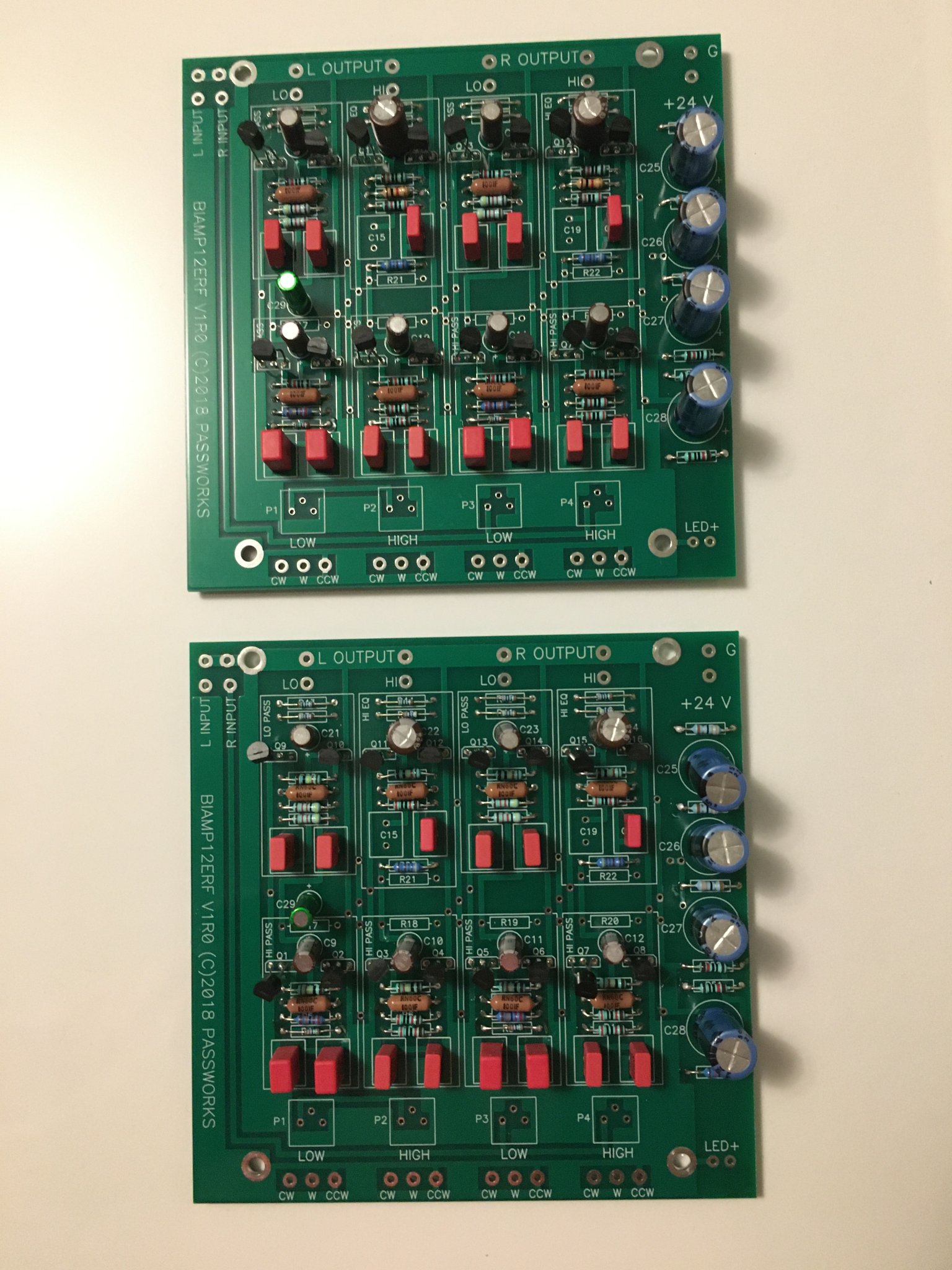

I finished a Balanced version yesterday, rainy day, to use with:
Both of the ACN's use 2SK170 BL devices for the buffers (J113 for CCS), I bought 50 for $2 each and ended up with 6 matched quads and 7 matched pairs.

I matched for Idss, since the J113's CCS are around 8mA, I used matched pairs above 8mA and used them so that they are in the same position, one for left channel and one for right channel.
With the balanced version, I used matched quads in the same position with one for L-, L+, R-, R+.
