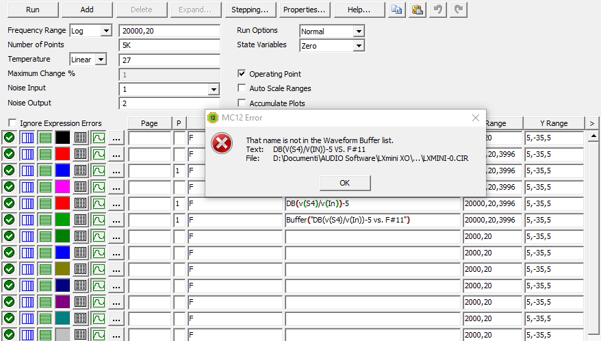

I would like to bi-amp my current speakers. I downloaded the LXmini MicroCap file but when I opened Analysys AC and pressed RUN, I got this ERROR:
Anyone could give me an hint on how adresse this error? I've find tthe zip file in DIYaudio store.

Error: That name is not in the Waveform Buffer list.
Text: DB(V(S4)/V(IN))-5 VS. F#11
File: ... \LXmini XO\...\LXMINI-0.CIR
Ok, sorry, understood my error!Hi,

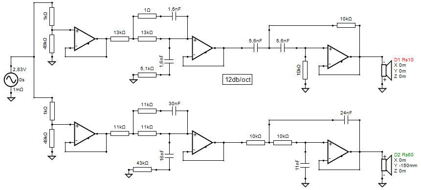

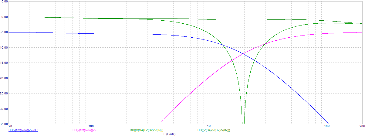

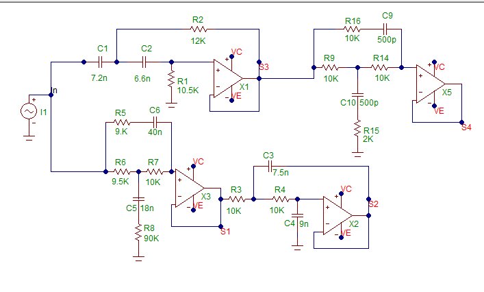

I'm quite a noobie in electronics, but I have read this thread and played with MicroCap a bit. I would like to use LXmini XO to bi-amp a two-way Bass-Reflex that I made almost 15 years ago with Coral/Peerles speakers. Woofer and tweeter cross at about 1,900 herz with 12db slopes, on the woofer there is a parallel RCL and for the tweeter an RC cell tames the frequencies around 7k hz.
On the LXmini filter I then eliminated the high-pass on the low-frequency section and replaced it with a notch filter to be used, if necessary, between... 200-2000hz, trying to imitate the passive RCL on the woofer. I copied the notch filter from the high section and put it on the low section of the filter. Did I get it right? Does it make sense?
Here is the ZIP file for MicroCap and a screenshot, if someone could take a look that would be great!

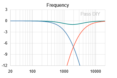

... I've just found passdiy online calc for filter reponse, using values I chose it looks like this, summed response about -1db... does it looks good or should I go lower on the summed response to -3db?

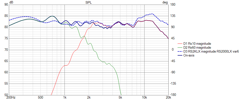

Just a quick note to say that I found some old measurements for my speakers and imported them into VituixCAD. Thanks to Jean-Marc P post (on DIY biamp 6-24 xo thread), I was then able to simulate the filter response for my woofer and tweeter in a cabinet.
There's a huge difference between the simulated response and the ideal one with MicroCap!
So I came up with this. It's not perfect, but it could maybe be a starting point...?
The dotted blue line shows the original frequency response of the speaker with passive cross-over; the other FRs are simulated with active LXmini XO.
I still don't know if there are any issues with the notch I've placed on the woofer, or if it would be possible to tweak the Lxmini board to obtain a notch instead of a high-pass filter on the low section.
