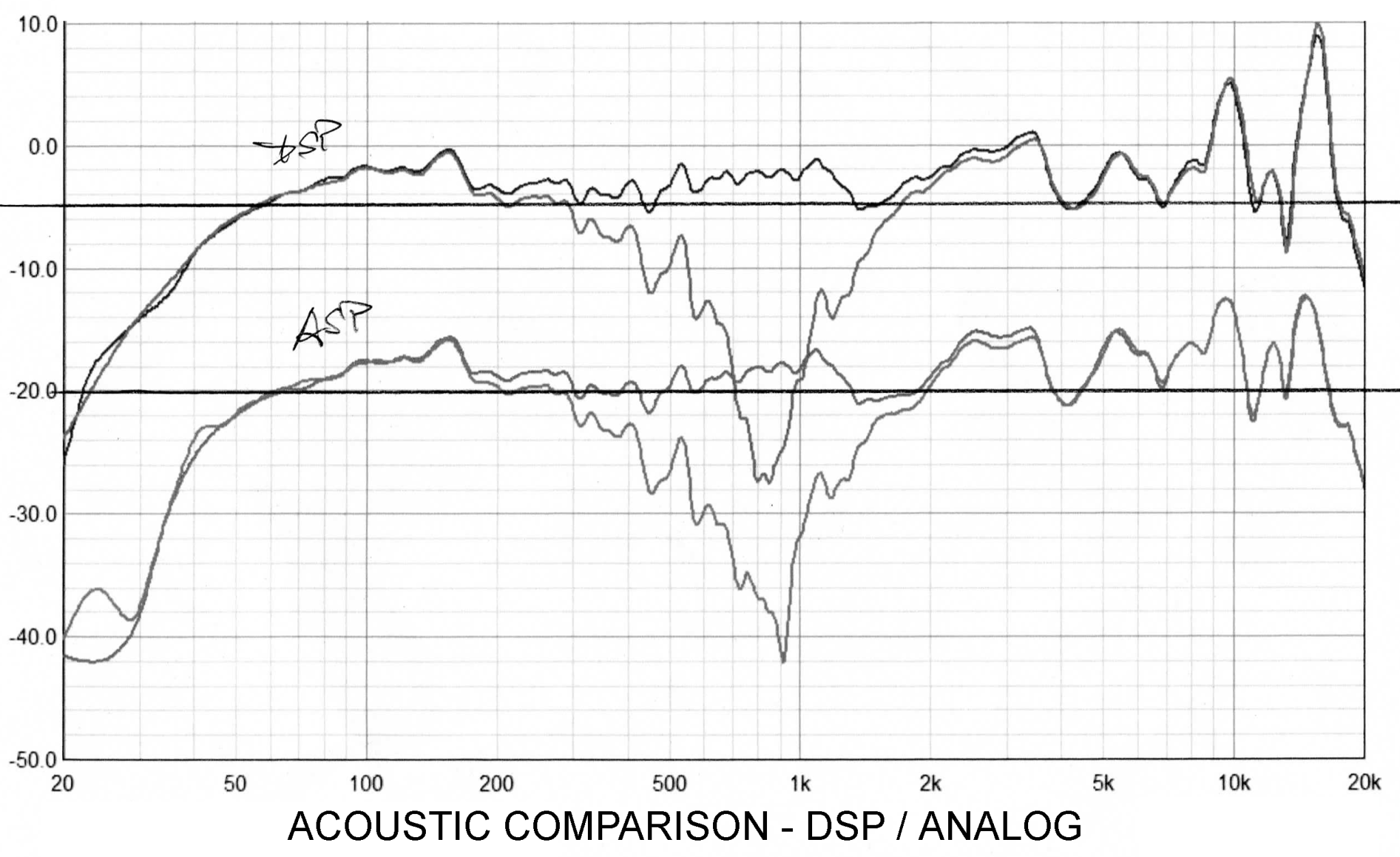

I've built my ASP from the kit, and am enjoying the quality of the sound very much. But it seems like the output levels are quite low... or at least lower than my previous MiniDSP-HD based setup in the same system.
Does anyone know a good way to measure this more objectively? I hooked the device up to a computer and a DAC and its outputs back into the computer, and ran some full scale white noise... and I used REW to try and measure it, but the levels seemed to be very low (like -50dB). I'm no expert with REW, though, and probably don't know what I'm doing.
So there's my first question: Can one reliably measure the output behaviors and level with REW? I'd love to get a curve to make sure that the components I got are working as hoped.
The components I received in my kit didn't match those that Nelson wrote about in his doc... which is kinda why I'm even asking. My measured values on the circuitboard didn't match his ranges either, though they may not have been "wildly off" (I don't know what "wild" is here; for example is 1.5V "wildly" over 1.0V? My assumption is that things are "right" on the board, but I'd like to confirm it.)

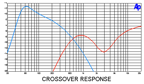

In the original doc there are two graphs of the ASP measured:
The first one indicates that the levels approach about zero at least near the bass bump. The second seems to indicate it's down about 20dB (maybe that's just from overlaying the graphs?).
So I'm not sure what to expect here.
But in-use, I'm having to REALLY crank the volume up on my system, and using any EQ on that side seems to introduce some distortion :-( This makes me think that the levels coming INTO the ASP are quite hot, but they're coming out pretty low. And yep, I know about the -12dB on the full-range side; but that was the same with the DSP.
Any thoughts? Thank you for reading this long post.

The LX-mini analog crossover does not provide any gain, so the output can only be lower than its input. If your DSP was set-up with gain, then its output would be greater than that of the analog crossover.
The levels on that DSP/ASP graph are separated just for clarity purposes. It's not representative of anything absolute.
For the ASP, just make sure the input tweakers are at maximum. That's all the level you can get.

I certainly didn't do that; standard full scale and -12dB as per Linkwitz. Thanks though.The LX-mini analog crossover does not provide any gain, so the output can only be lower than its input. If your DSP was set-up with gain, then its output would be greater than that of the analog crossover.

I'm not looking for a level boost; I'm trying to calibrate my expectations about how the ASP should work.
If someone were to say either "nope, that's not right; it should be about the same" ... or ... "yep, that's about right, the ASP is NNdB quieter than a comparable DSP solution". 🙂

My ASP has the same level in my system, as when it's not in my system, this is when the input pots on the ASP are fully CW. No change. I've never had nor used DSP, so I can't comment on my systems level with DSP.
Then again, my ASP filters were built for SLOB speakers.
Your curves look similar up to 9K, then the DSP has greater level variations. Since the ASP has unity gain buffers, the level should be your systems level.

Also, depending upon what DSP unit you had previously, it might have been yielding +6db due to balanced interface output configuration. In that case you would have lost 6db. That's easily audible.

Thanks everyone; my DSP was MiniDSP-HD, as I wrote.
Does anyone know a good way to measure a device like this, to yield a curve light Nelson put in the published document? Obviously, I don't have one of the pro "AP" analyzers.
For my general education, are balanced connections typically +6dB compared to a similarly set up single-ended?

@mfeif I don't know which miniDSP-HD unit that is. That's why I mentioned it. miniDSP has/had multiple ones that have different output voltages.
You can perform a test on your ASP using any decent USB sound-card and a program like ARTA.
Yep, balanced connections generally will have 2x or (+6db) voltage relative to unbalanced.

Thanks Nelson.To be effective the curves don't need to be precise. For a given system/environment/ears the optimal curves will always be different. Be prepared to play with the settings if you want perfection.

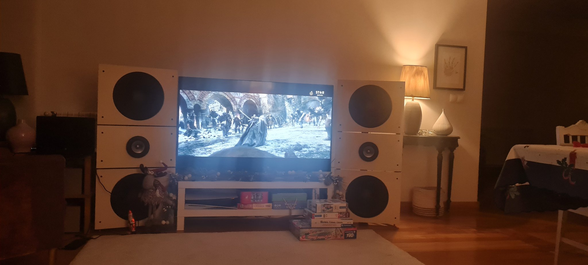

Have the kit since 2018, but life has it's own path and i'm trying to finish what i started back in 2017.
I have a PAP trio clone OB with Markaudio 10.3 and eminence beta15. The baffle is 54cm wide. I have the system running since 2020 with a miniDSP crossing at 550hz but i always felt that the medium frequencies were lacking something. I tried to cross at 250hz and the result was better to my ears. However, after 4 years listening i always felt the need for more bass and body to the sound.
The amps are the vfet part 2 and a diy 100watt A/B amp after a BA3 preamp.
What path to pursue?
Fill the ACN with the parts for the lx mini and build the lx mini speakers, or change the crossover and adapt?
I think my listening space is not the best for the OB PAP. They are 60cm from the wall (can't move them) and i'm 3.5meters far from them.

Do both and decide later 😉What path to pursue?
In my OB builds I have certainly not missed body to the sound. One system which is now owned by a friend, is with the Lii F15 and the Beta 15's.
But you won't get the punch-in-the-chest sound that we have grown used to from box speakers.
Something you could try out is adding a coil for 6 dB filter at 150-250Hz on just one (lower) unit in the MTM, to better fill in on the low end - and to take advantage of the series resistance impact on the Q. That will give an extra fill in.
And then run the other unit to the higher cross point. But you want to cut off the break ups of the Beta with a steeper filter or low pass shelf, not to clutter the midrange.

All that being said... the 60cm to back wall is not optimal, are you allowed diffusers behind the speakers? Some have a bit of an artistic effect to them right? 😛
The mini's are more likely to thrive in those conditions.
They will have a better 3D rendering unless you have been exceptionally lucky with the directivity match of the units.

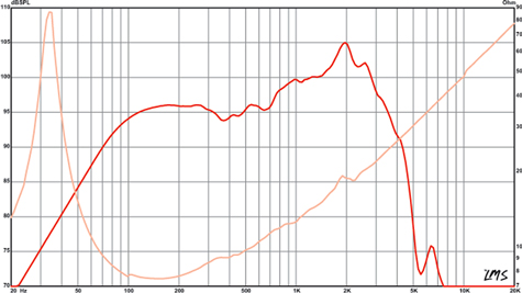

The break ups, is where the membrane start to "break-up" and you get huge resonance peaks, they are quite prominent at 2k - and I expect already starting lower. But the curve smoothing below is already quite substantial, which will hide that.
Look for the impedance curve "kinks", these reflect the behavior of the mechanical system and directly reflect system or speaker "issues"
Beta15:
The kink at around 1k is typically related to the suspension though.
But at 2k, you need a filter that is able to push this way down - as in 30dB, if you don't want that to mix noticeable with the Markaudio.
That will of course be noticeable when doing a umik sweep on the woofers alone to see what damping you actually get out of band.
