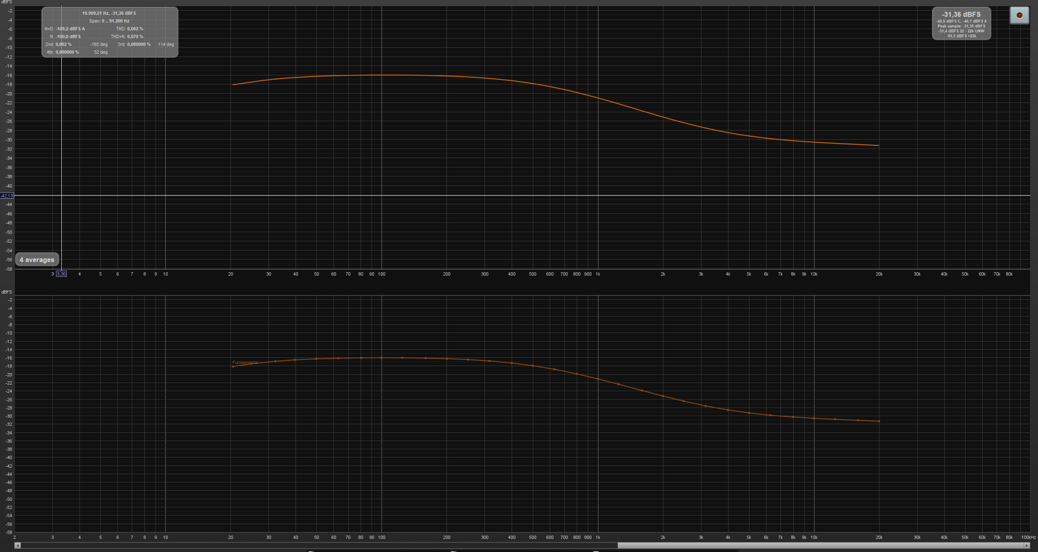

It is almost certain that problem is your measurement setup and REW settings.
FR response you get is exactly (within fraction of dB) what looks REW output of a perfectly flat amplifier or it’s loopback, if 1/48 smoothing + Flat-Top window are used. Smoothing reduces measured level with frequency increase.
However, automatic distortion and FR measurement using stepped sine option, ignores smoothing options from the standard FFT measurement setup in my REW version, so question remains how is that happening in your case.
Do you have latest REW version 5.20.13?
P.S.
Listening test should immediately make clear does that -15 dB at high frequencies really exist.
Hmm...my window is blackman harris 7, no smoothing. I didnt know the stepped sine fact so tried that too, but it truly does have that response (bottom is stepped sine). I do have 5.20.13, installed a few days ago when problems started.
I was about to do your suggestion above (good idea btw), to check levels at gates of relevant components, but i thought ok lets plug it in first since we did verify it works fine, and has no dc offset, i have nothing to lose (doh, where was this thought days ago).
OK now get this...
I plug it in and it sounds perfectly fine (more than fine), and flat.

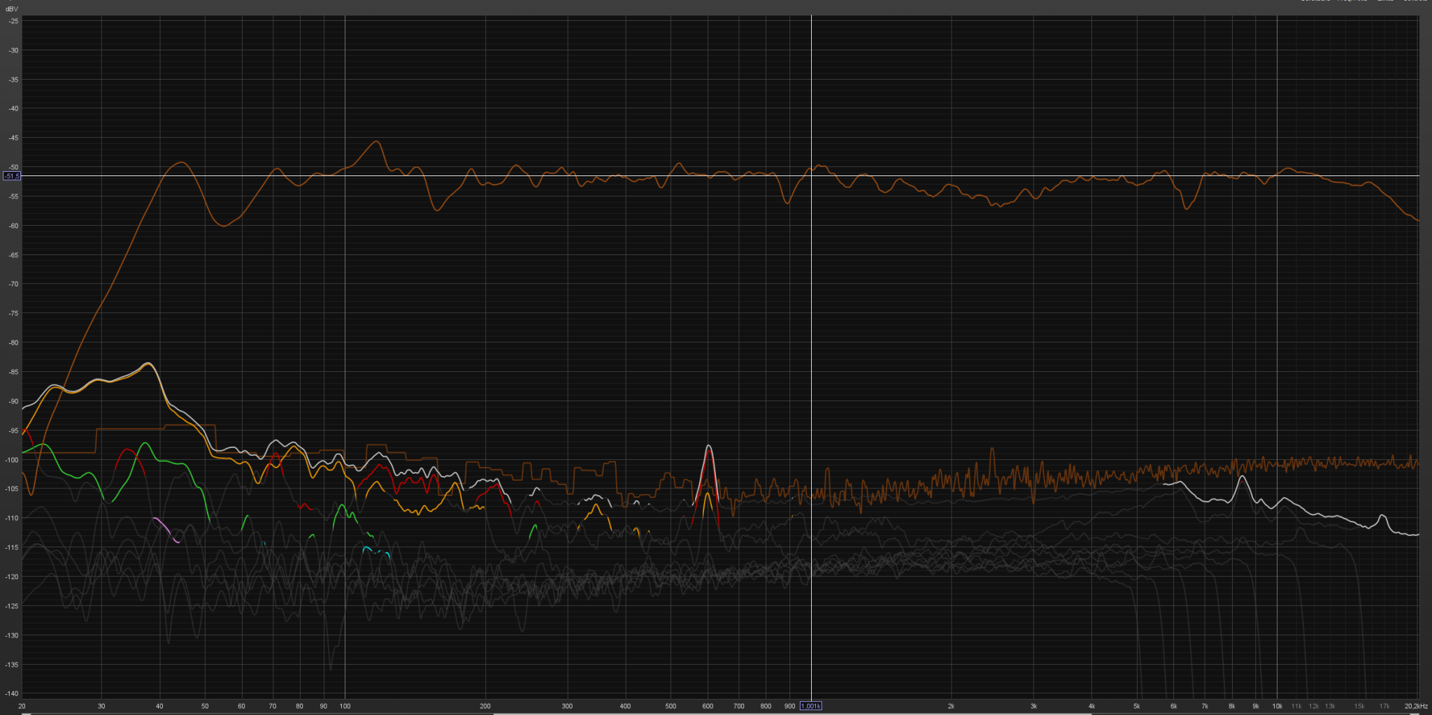

Just to dispell any doubts did a sweep with a measurement mic
All this pulling out hairs, replacing everything, turning amp into different amp and back...funny thing is im still driving it now with MOTU output (just for test, otherwise not enough drive level as expected), the same setup that was incriminating just minutes ago.
I have to apologise to you tombo and ZM....all this time you're been helping me patiently but all i had to do is plug it in...really, thanks a lot for your help and time...i guess no idea in the end what it was, since i can still do flat measurements of everything else with the same settings. Happy the Ali LD's are legit. Happy with amp (time to finally listen and enjoy).

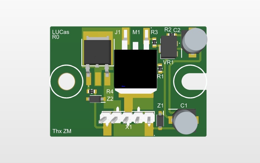

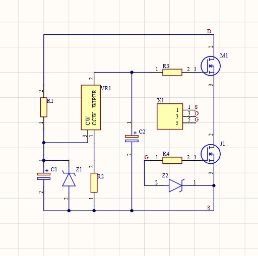

I have some time since I experiment with aluminium pcbs. The last attempt was with some shunt regs that run pretty nice.
Recently I took my chance to draw the Lu1014 and the cascode mosfet on the same alu pcb using the SO227(the hockey puck as we call it here) footprint and only smd components.
This will have to run at 20-25V and 1.5-2A so practically having ~45W max dissipating on the cascode mosfet which is a d2pak.
I found online some info saying that d2pak can do 50W if properly cooled. Not being sure of this I came to ask here for a suggestion(smd packages) for something else I can use if d2pak is not ok. Maybe use 2x dpak(dpak is smaller than d2pack) in parallel? or some other power package like HSOF-8 ? I have some IPT015N10N5ATMA1 in house that I can use.

no, what I meant is - put cascode IRFP240 outboard, so part having biggest dissipation is being directly on its own on heatsink
why bother with subpar component and think about longevity, when you can do it properly
I was thinking of making same arrangement, but in the end abandoned that idea - that should go as option with some existing amp ( say making LuDEF on Babelfish M25 basis), but that's just more complications in future (counseling phase)........besides, don't like cap being on same temperature as output device, and there are 2 electrolyts involved
