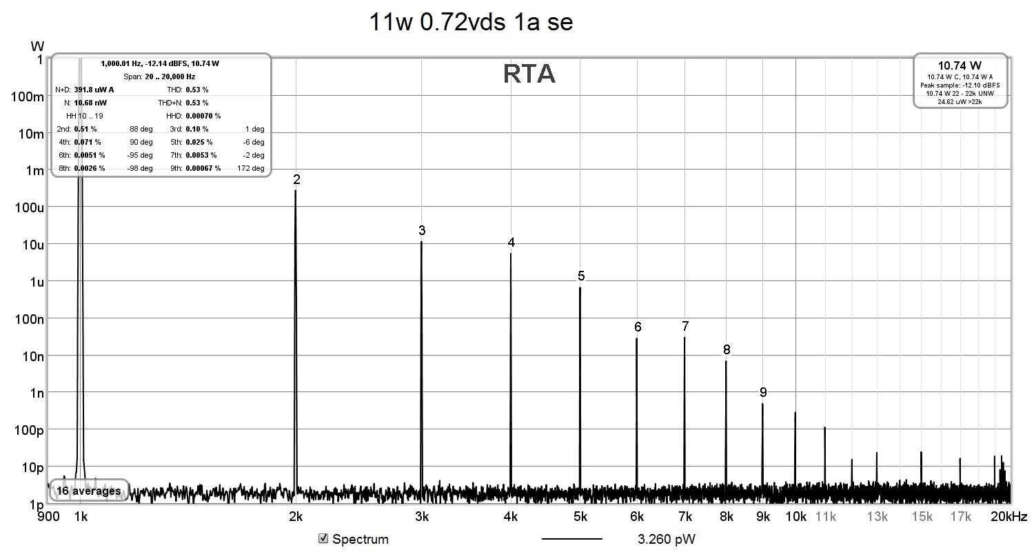

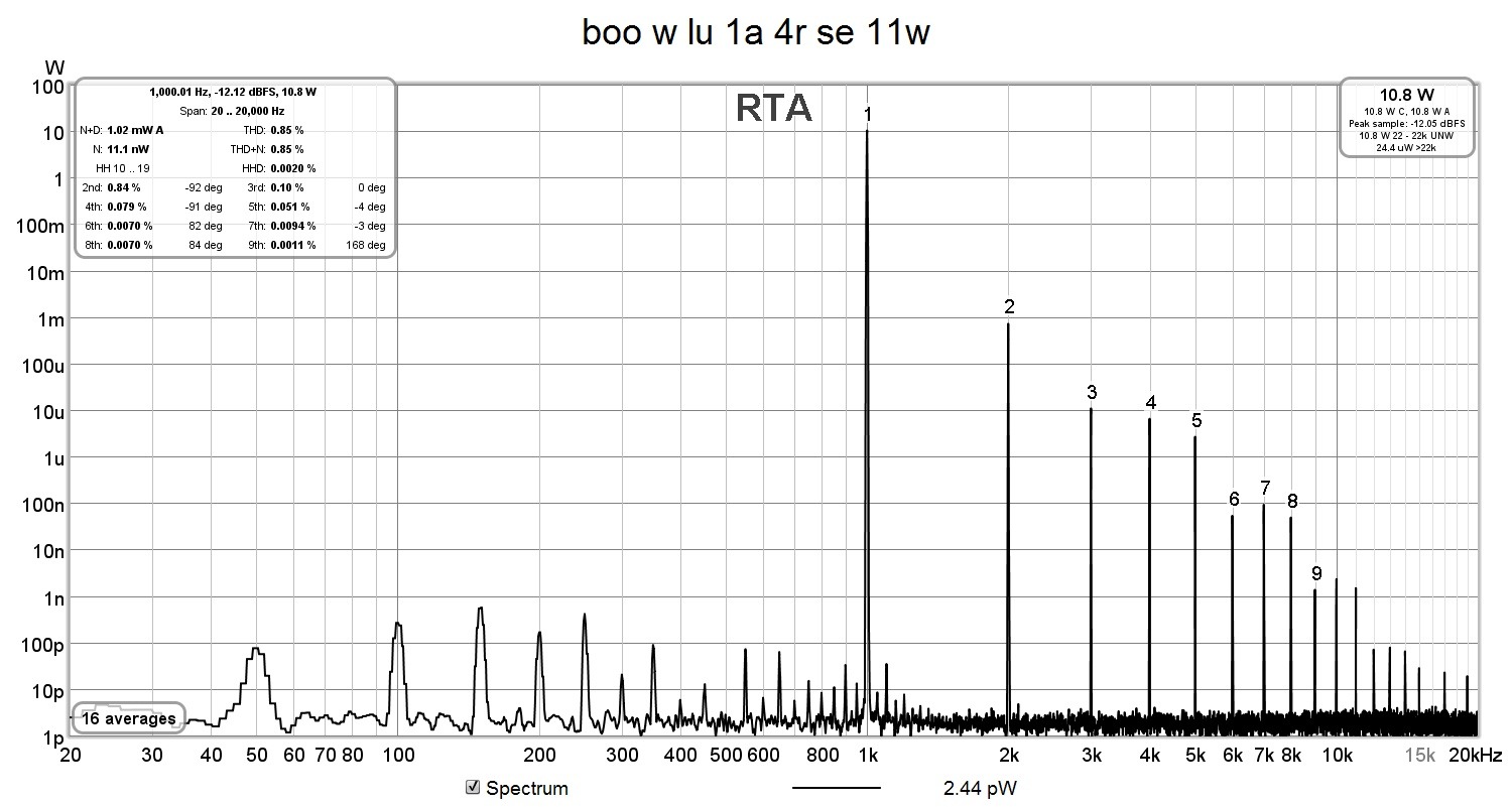

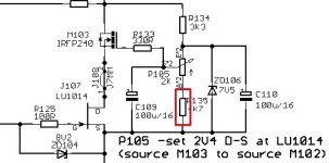

What I wanted to show is that in my amp(which is only the ops of ZM’s plethora of pinjatas with the cascoded lu instead of the nch mosfet and a different front end with no gnfb) I got lower thd by lowering the vds of the lu.
I asked here about the vds because it was a more appropriate thread.
Sorry I didn`t mention this until now.
Another thing to mention is that the loads even if both 4 ohm one can be more inductive than the other and you get slightly different results.

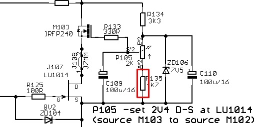

So in the end I lowered the value of one resistor (R135 in this schematic https://www.diyaudio.com/community/attachments/ludef-schmtc-png.937325/ ) from 4.7k to 2.5k and lowered more the vds.
Doing some tests I decided that the best compromise is at 0.72vds. At 11w if going under this value the second harmonic starts to fall under the third and going lower the overall thd increases .
By changing that resistor it changed also the phase of the second harmonic. Now(with 2.5k) if I set back 2.5vds for the lu I get positive phase instead of negative.
Both channels have same results at same vds.

One thing that I don’t understand is how could the smaller resistor change the phase if it’s ac bypassed?
something is fishy
if we assume rail value of 22V5, with values I devised, there is (22V5-7V5)/3K3=4.54mA through R134
then we have 7V5/(2K+4K7)=1.19mA through resistors, so 3.4mA goes through zener, good enough for stable zenering :rofl:
if you change 4K7 to 2K5, current through resistors goes to 7V5/(2K+2K5)=1.66mA, decreasing current though zener to 2.87mA
so, either your zener is current starved, and you also have Gremlins in dark corners, or ..........
decrease R134 to 2K2, if you want to decrease value of R135
something is fishy
Well yes, initially I removed the 2.5k resistor and soldered back the 4.7k with 100k. Like this I can reach 0.5vds on the lu.
Still positive phase.
Looking better I seen that I had a reversed connection on the input of the soundcard. So all good now I get negative phase.

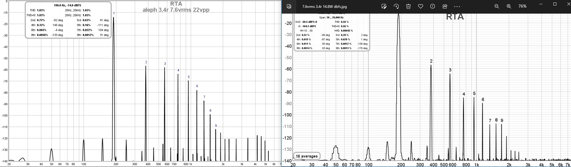

main goal was to have an amplifier more efficient and with lower thd than the aleph j that I had first. The aleph was biased at 3.2a, the actual ludef with current mirrors is biased at 1.6a. My speakers are 3.4ohm
Seems that I accomplished the goal very nice, half the thd at half the power dissipated and also no global feedback.

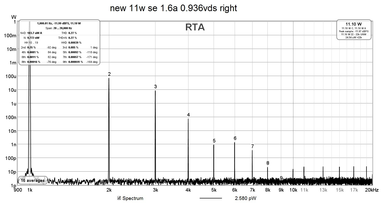

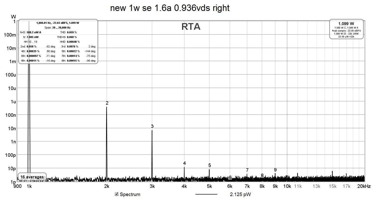

I settled for ~0.95Vds for the lu and 1.6a bias, I didn`t go for the lowest thd but set for ~10x negative second over the third at 1W and ~3x negative second over the third at 11W

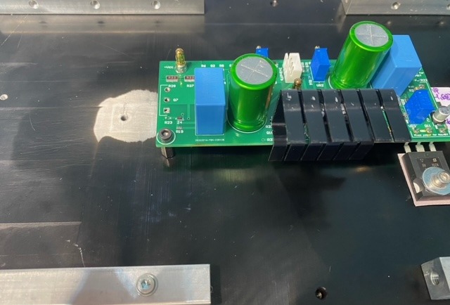

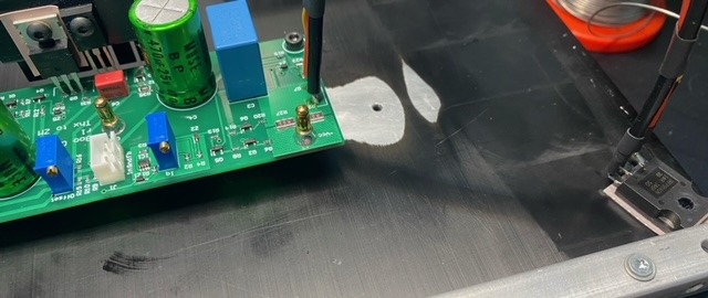

Finally after a year of slow progress / procrastination my LuDEF is ready for power on...
Can anyone direct me to the post # with the initial start up sequence?
I've assumed that I remove the front end jumper and get the LU /backend biased first, then move to the front and connect the jumper when done.
The bias' are on the circuit diagram, but I'm not seeing the expected numbers.. No magic smoke as yet.

Has anyone found any benefit from tuning the LU bias/ voltage? I've got 2v4, as per the circuit diagram.
165mV bias on the FETs and 20mV on the front end. Offset is zero.
I don't have a distortion analyser, so I guess that I'll have to tune the LU distortion by ear...if there are any gains to be had.
Thanks for all the help 🙂
Very early days, amp has been playing for 3 hours now and I'm not really hearing the Lu. I've had an M2 in my system a couple of times and this sounds very similar, at least to my ears at the moment.
Shall I try a lower Vds on the Lu? Maybe 2v?
I think I'd like more 2nd order
