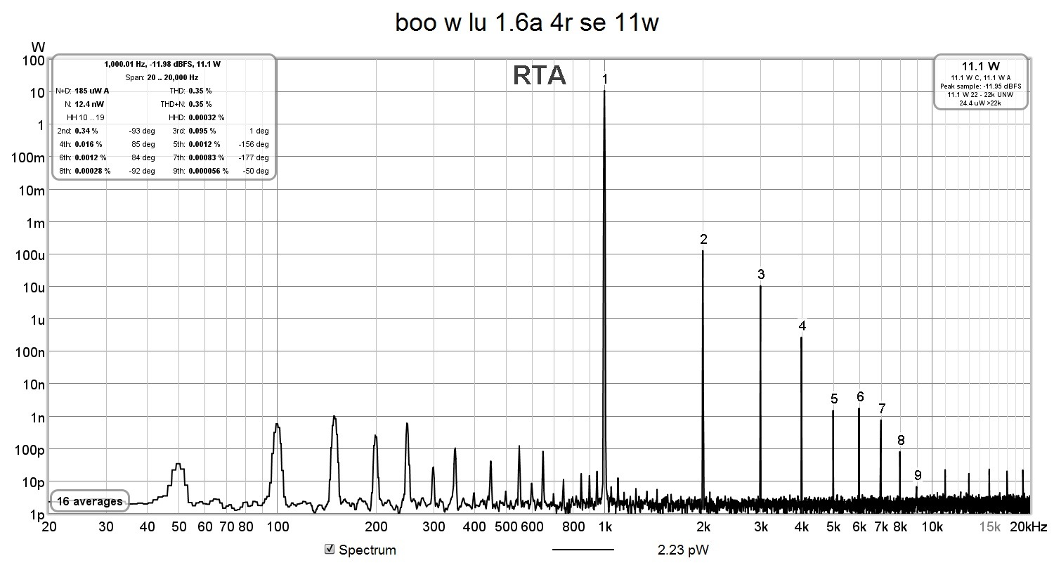

the older graphs(scale in W) have the Vds at 2.5V and the never ones have it at 0.76V.
The measurements are for 25V rails and 1.6a bias, amp used as single ended this time.

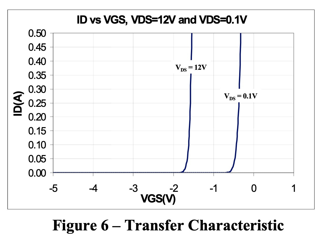

The data-sheet seems to say that you are free to experiment.... Nothing borderline about 0.4-0.5Vds as long as it does not vary to much with the signal.

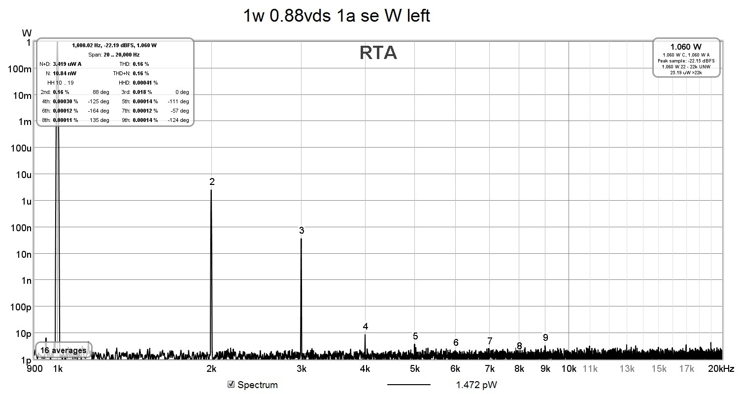

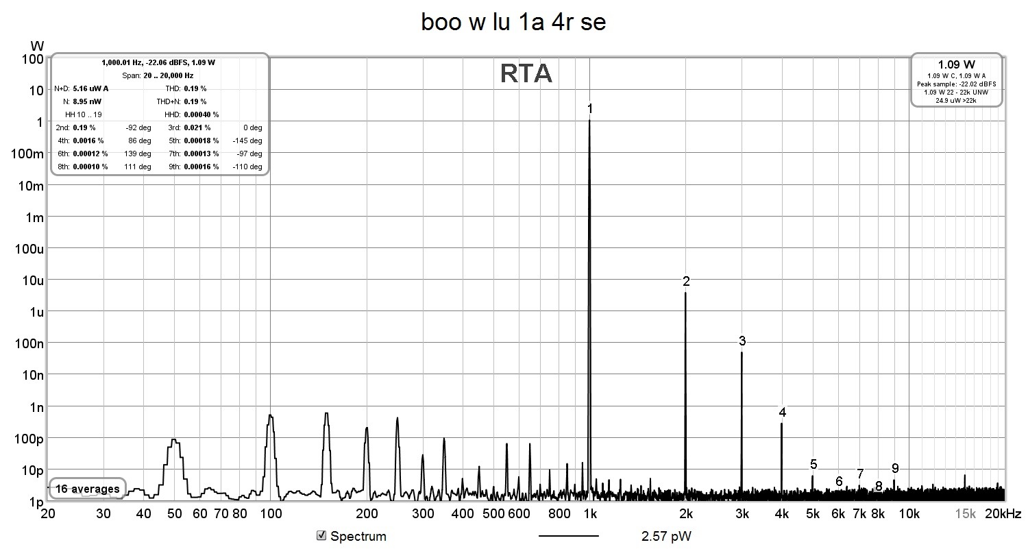

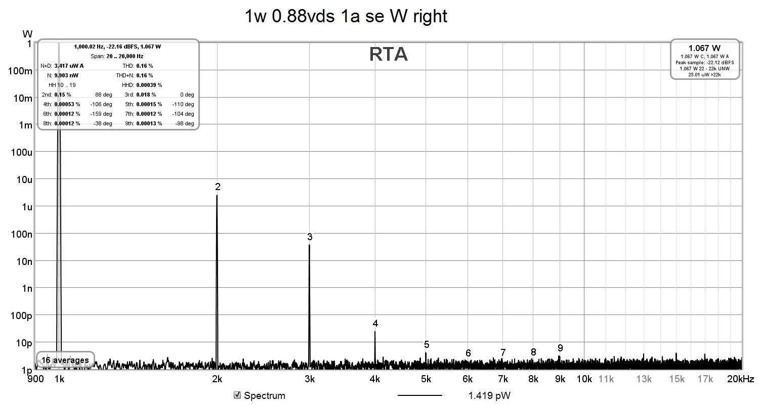

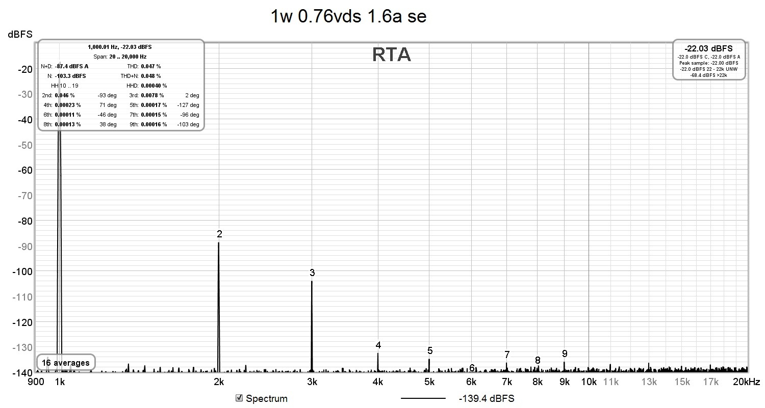

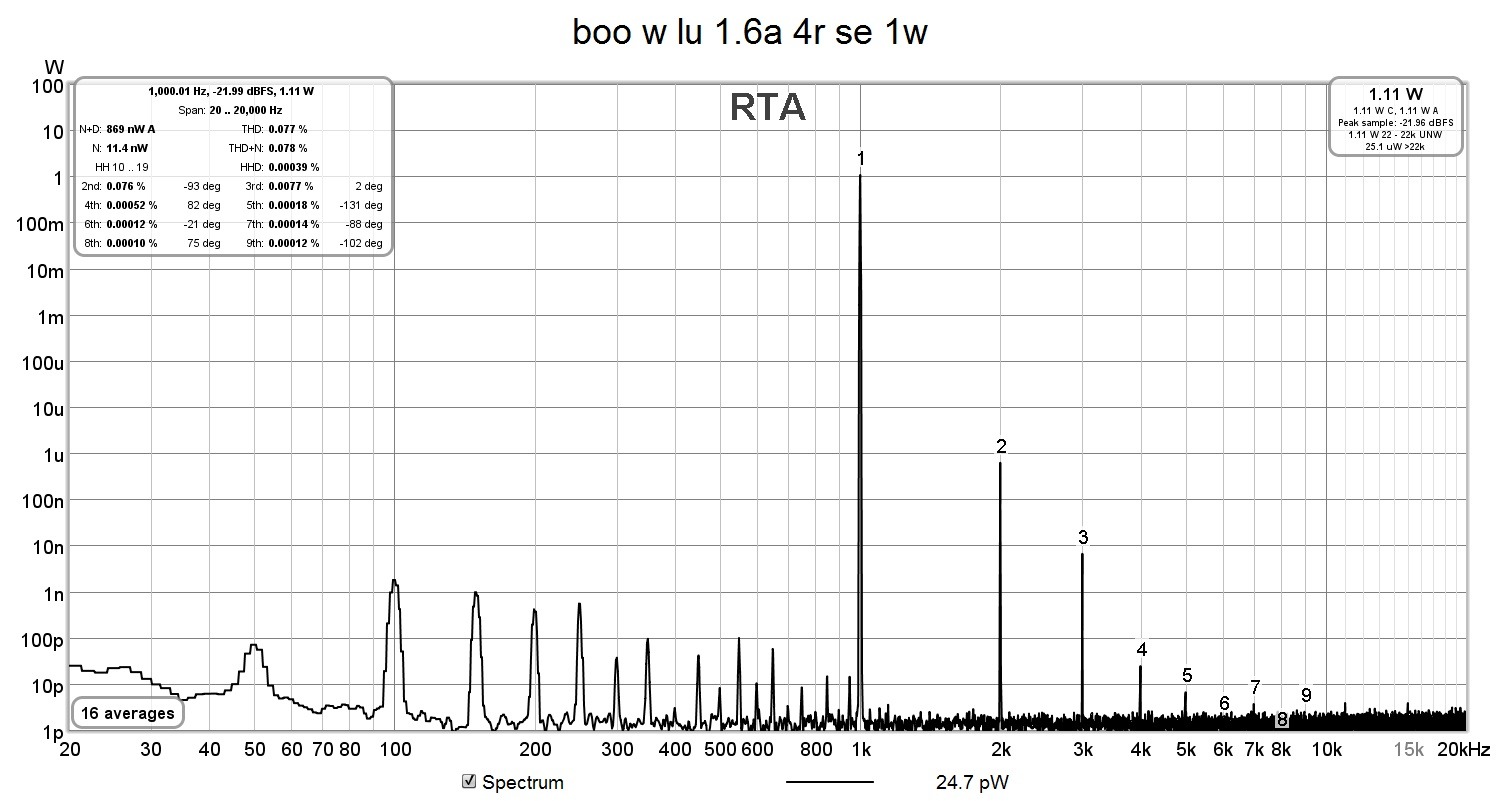

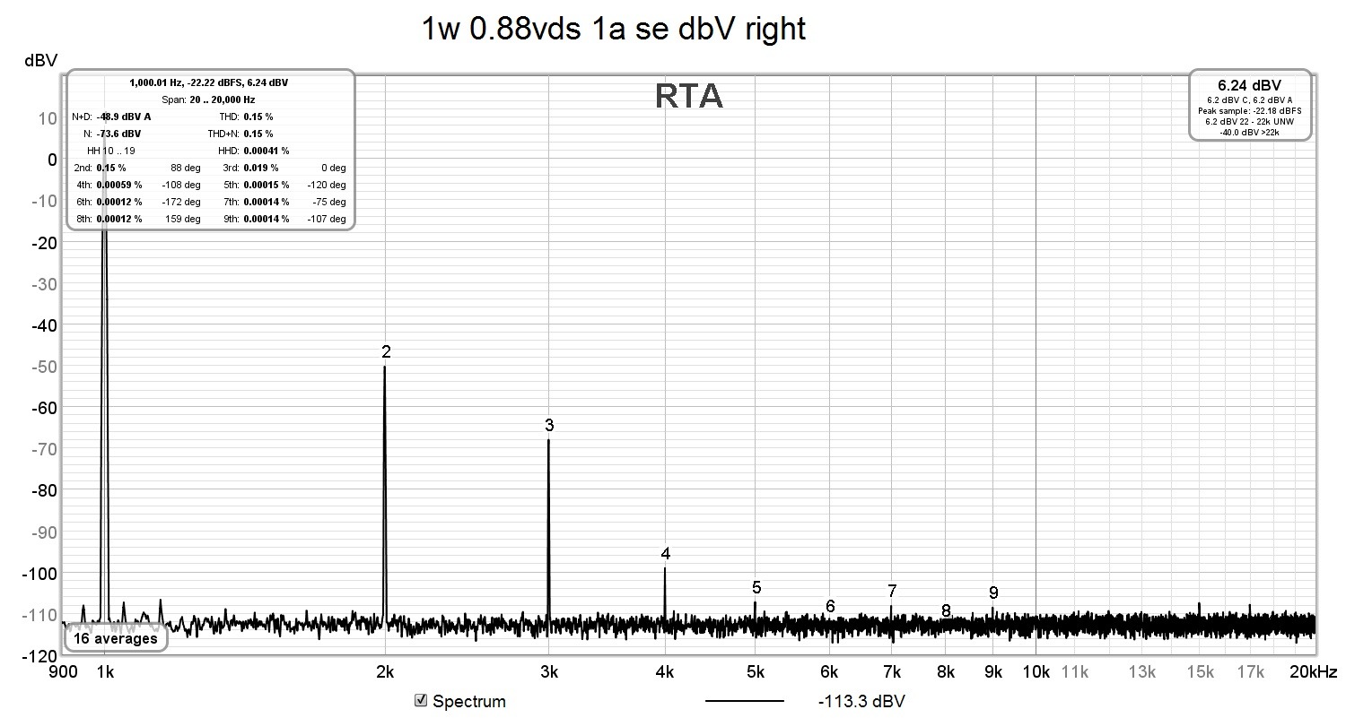

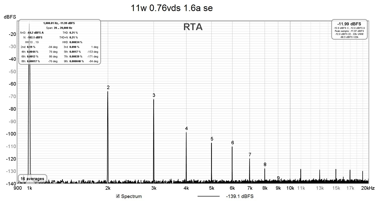

The first attachment is the right channel measured in the past with ~2.65vds for the lu.
The second is the right channel measured now with ~0.88Vds for the lu.

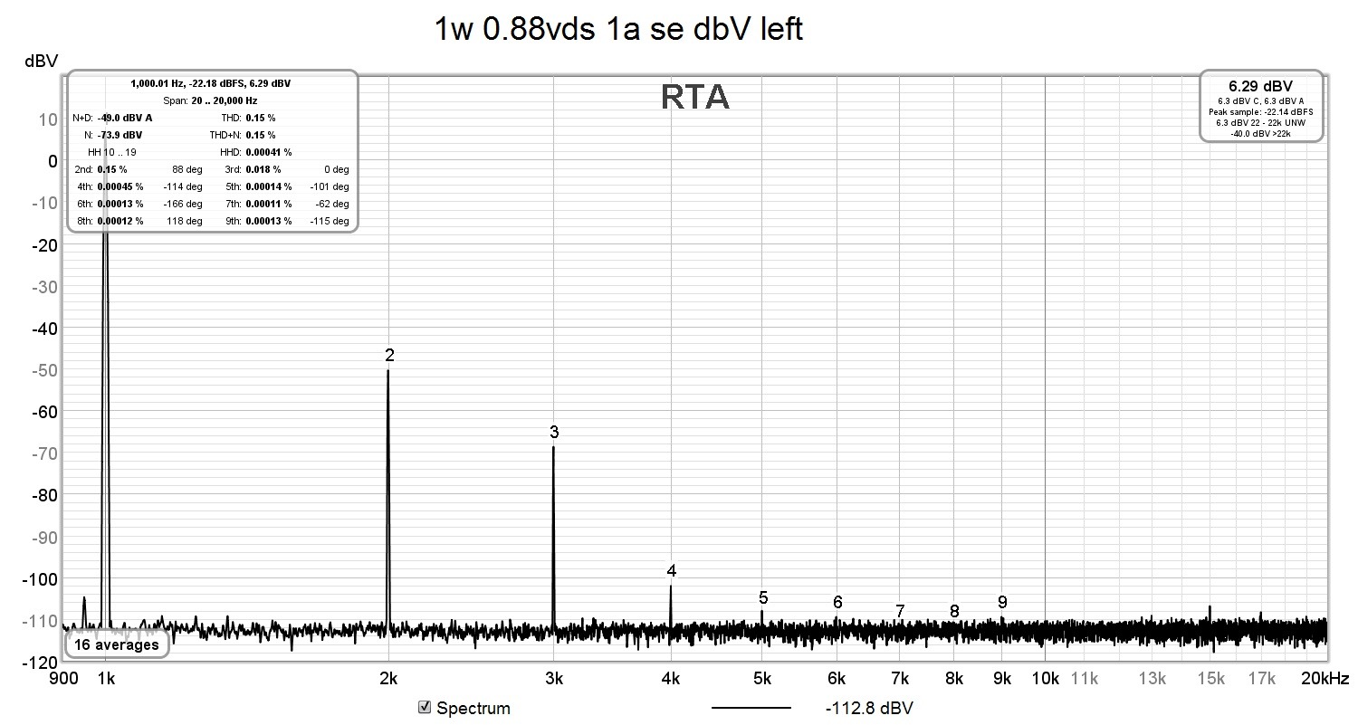

The third is the left channel measured now with same 0.88Vds for the lu. The improvement seems repeatable also on the second channel(the lus were matched for vgs and gm).
The fourth and fifth are measurements from today in dbV.

Ups there is a mistake in my post above, I added the files in the correct order but when uploaded tothe site the order went crazy.
So in above post the order is like this
the 1st and 5th attachments are the measurements done today in dbV scale.
the 2nd and 3rd attachments are the measurements done today in W scale to be able to compare them with the past measurements with same scale.
the 4th attachment the measurement done in the past.
Sorry for the confusion.

Exactly what improvement do you see? To me THD is virtually identical between the 5 measurements (0.15% / 0.16% / 0.16% / 0.19% / 0.15%).The improvement seems repeatable also on the second channel
Your different scalings does not affect how REW calculates THD as this is a ratio.
Today I shown that the thd went from 0.19% to 0.15% at 1w and 1amp bias by lowering lu vds
Earlier I shown same thing but at 11w it went from 0.35% to 0.21% with 1.6a bias.
At 1w there is not much of a difference but at 11w there is a bit. At least we can call it lower thd if not improvement?
Sure you can call it lower THD and an improvement 🙂
I just can't help not to compare with the values shown by ZM in the beginning of the thread, which seem an order of magnitude better.
