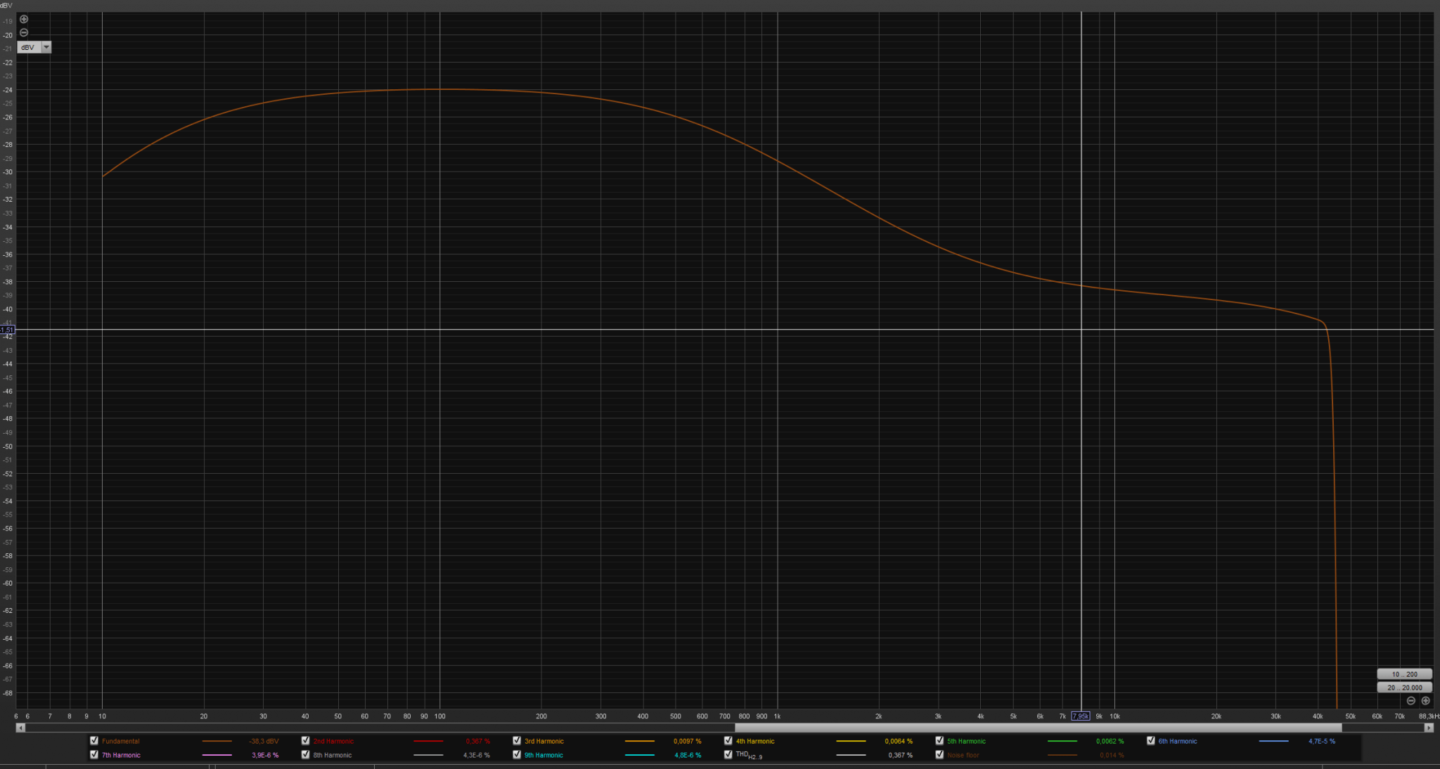

It is not small problem for a follower. 6dB down (meaning half of voltage) from 200 to ~1.3k and another 6dB down (meaning only a quarter) at 3k. Need to trace where the voltage drop develops.Yeah, azure is new modified right channel, red is old unmodified left.
Thats a very nice post, and exactly relevant to the scenario too, maybe i should have seen it soonerAll corrections that were made were necessary. CCS had too small current (cool semiconductors) and you didn’t add capacitors at the Cap mx output for nothing. Check this if you haven’t already:

Now we have 3 completely identical FR's from 3 different LD's...even if they werent good units, what are the odds of having the same exact failiure mode?
I checked with phone now as signal generator, same curve, so its not the interface for sure

not that it'll help , but try ( in future ) to switch to greater resolution in graphs
who care for zillion db on ordinate, when we want curve in window of db or 2

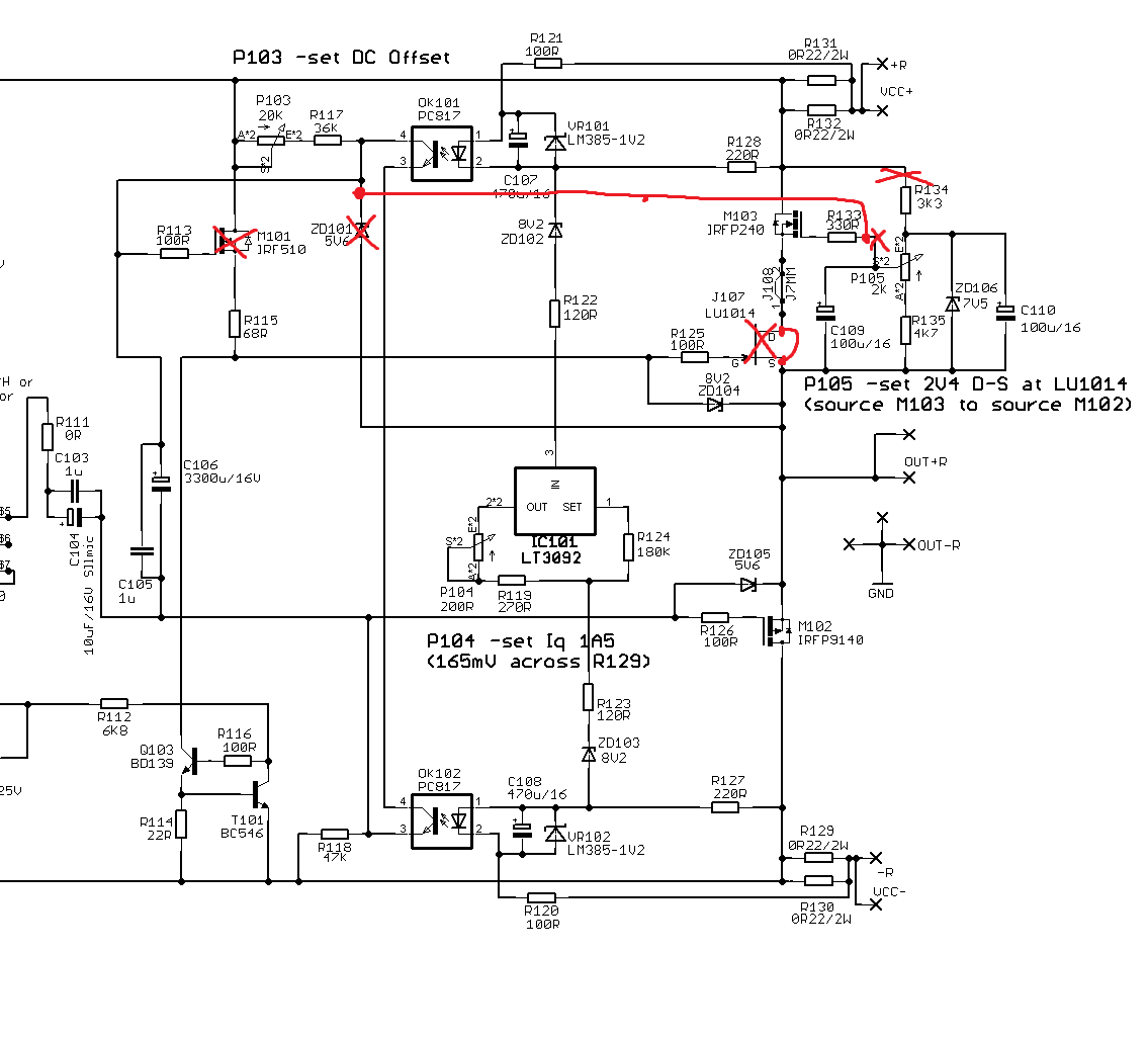

test of your pcbs: remove source follower/level shifter, remove Lu + Cascode
place plain N Channel (IRFP240) up, accordingly connected and try it as simple complementary follower OS
I mean, circuit is proven, it really is just matter of your particular build, finding where is actual ookoop

I am a bit layman at this stuff, but ok removed irf510 level shifter, remove LU (but irfp240 is its cascode, if i remove that then i lose complementary follower in the end), place irfp240 up not sure what is meant. Probably whole layer of my knowledge missing in order for it to "click" what is intended

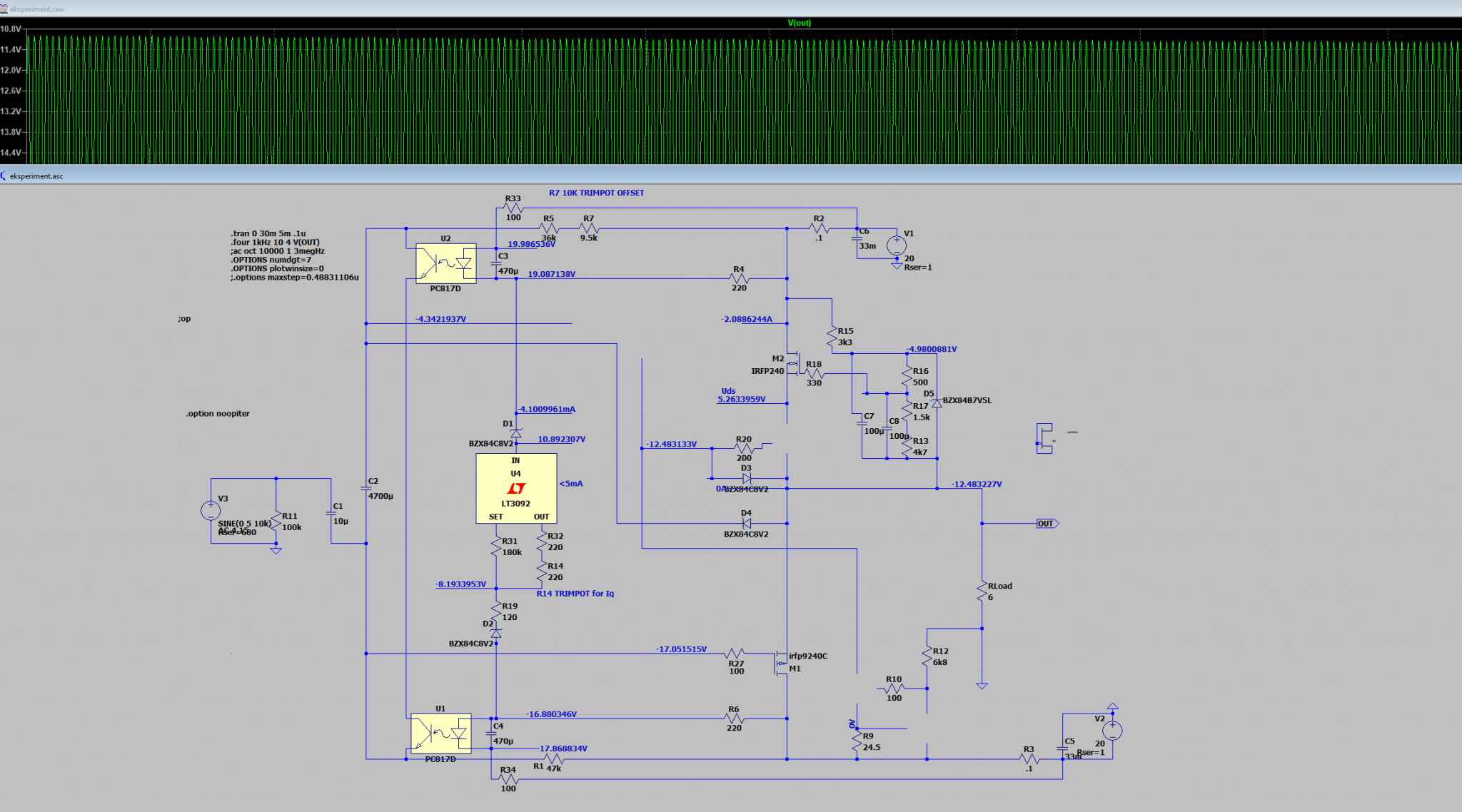

This is only thing i could get that runs in the sim
removed bd139 and bc550 not sure if needed
remove everything needed to try it as Babelfish M25 R.2
that will exclude level shifter and LU outa game

I was thinking, ok circuit is proven, circuit works 100%. I copied schematic, from what i checked 10 times now, correct.
So it "must" be fault of specific implementation itself, either pcb (unlikely? would have to be a massive ookup to have this result) or components.
So tried now changing the dc block caps on input, thinking, maybe they have some weird transfer characteristic (curve looks kind of analog), but it wasnt it either.. Only notable thing i can think of here, the bigboy "steel rod" cap is 4700u instead of 3300u, because AC analysis said fine and mentally i thought fine, but now god knows.
Resistor values i checked, LT3092 cant be because it biases fine, optos cant be because offset sets fine. IRF510 and ludef isnt because we just tested that. Basically tore down, changed or whatever'd 90% of amp and its still there.
So either its something incredibly silly and unrelated to amp, God hates me and cant have nice things, power mosfets, or some combination of above. I just realised i spent like at least 3 days continously doing little else but this, embarassing. I remembered mosfets measured fine before installing so probably i think this is end of the road, but i think i have some irfp250/9240 laying around....

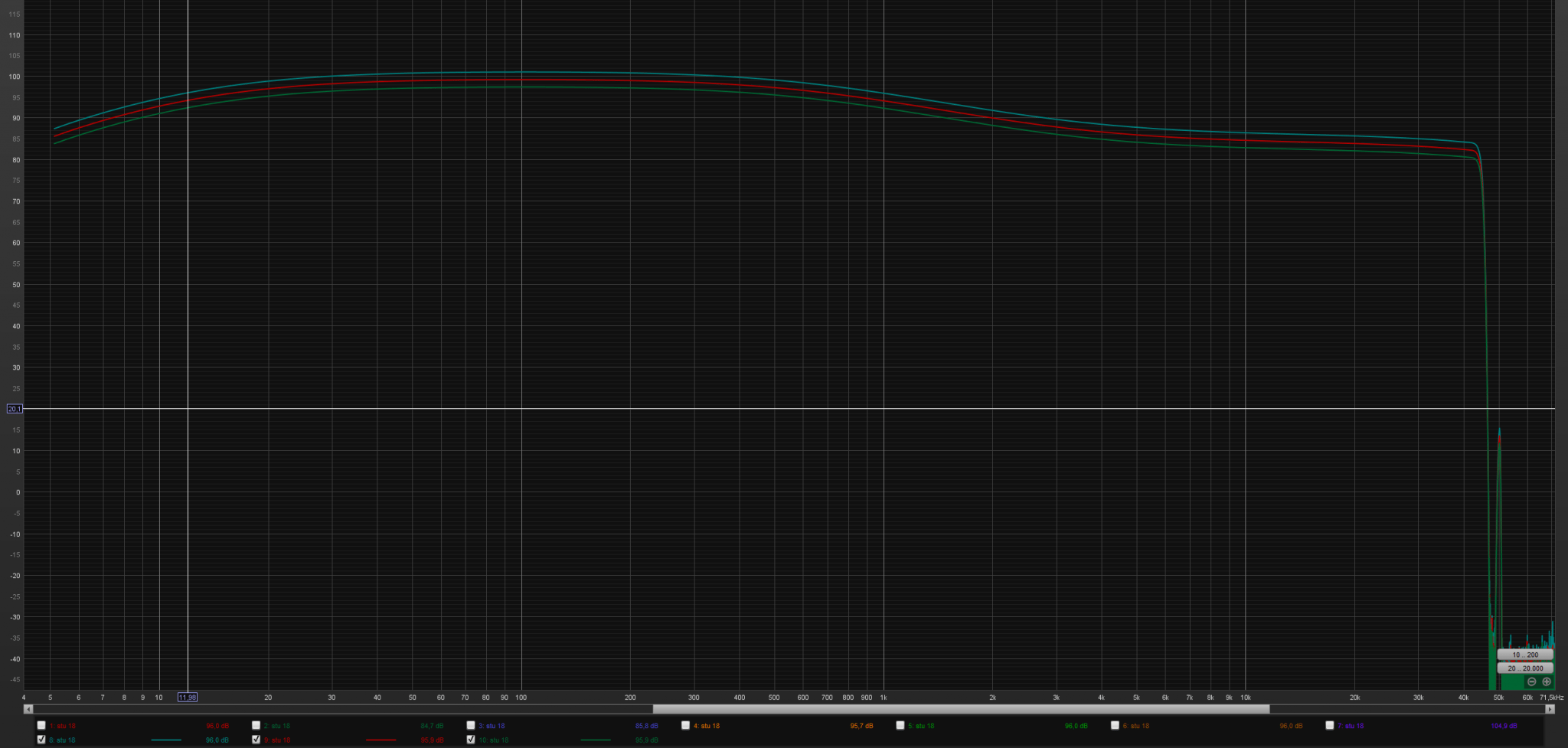

As both channels measure exactly the same, and changing JFETs or simplifying circuit brings no change whatsoever, it is not likely that any semiconductor is defective. Babelfish output stage is so simple that I don’t see what could you have done wrong if biasing works.
When I receive absurd measurement results, after checking circuit, next step is to verify again measurement equipment and setup.
Check again Motu loopback response. I don’t know if Motu has input overvoltage protection and could line input be damaged.
With oscilloscope (use Motu + REW) check signal generator level at 5 kHz and then connect signal to amplifier input. If signal level drops, amplifier input is heavy loading Motu output. Check if there is no drop at 200 Hz. If so, Motu is unable to drive this follower.
Is there a problem with Motu output or amplifier input impedance above 400 Hz, is another question.

That would make sense, but i tried driving amp with both aikido and phone, as well as motu's headphone-out and line-out. That's 4 different outputs giving identical result, if it was loading issue maybe at least they wouldnt all be 0.01dB matching curve i figure..
I tried your idea now too, play say 10khz, and measure output unloaded, then plug in and see if it drops (because its loading the output).
But for all frequencies i tried it remained same to within 0.1mV.
An interesting thing though i found out thoug is even when signal is flat, it shows lower and lower rms number with higher frequencies.

It is almost certain that problem is your measurement setup and REW settings.
FR response you get is exactly (within fraction of dB) what looks REW output of a perfectly flat amplifier or it’s loopback, if 1/48 smoothing + Flat-Top window are used. Smoothing reduces measured level with frequency increase.
However, automatic distortion and FR measurement using stepped sine option, ignores smoothing options from the standard FFT measurement setup in my REW version, so question remains how is that happening in your case.
Do you have latest REW version 5.20.13?

Listening test should immediately make clear does that -15 dB at high frequencies really exist.
