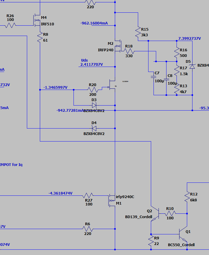

After installing more caps to cap-mx output, and running only one channel at a time, same thing (though i guess not unexpected).
I went to comparing spice and real pcb thermals. Spice says irf510 and bc139 should be dissipating 500mW each, that would get kind of toasty. Yet mine i cannot even tell are even warm (30C or less).
Maybe there is reason for suspicion here even though i get ~-1.345V on Lu gate that spice says

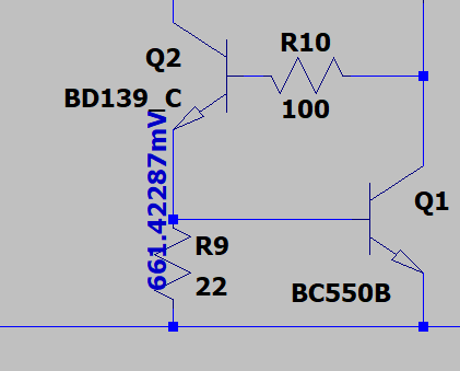

if there is 0V65 across R9, no puzzle
Or if there is 0.65 V across R9, check if R9 is not 220 Ω or more. That would explain nicely problem with driving LU input capacitance at higher frequency.
I must be missing something
Definitely.
IRF510 and BD139 should be hot and require heatsinks if CCS operates as it should at 30 mA.
Did you measure R18 on your PCB (R9 from the sim) without de soldering? There is a BC550 base to emitter junction that could skew measurement. Try with reversed positions of ohmmeter probes.
What is voltage across R11 on the PCB?
no reason that is having anything with wiggly Freq.
If only several mA flows from the CCS, that has everything to do with wiggly fr. response.

While they were off measured this R9, now without bjt Rbb effect and still 29 ohms, but given how critical it is i changed it and now it is 24.5 ohms (ok, not perfect, 27mA instead of 30, but if it's that it should show some improvement at least and then i know where problem lies)
Measured this one at 66..another check of voltage shifter Iq
your LTSpice pic : check voltage across R8
it must be (0V65/22R)*61R
(where did you found 61, dunno)
I remember my value is 68R![]()
1.73V measured across this..ok pretty much correct, (0.65/24)*66
On gate of LU now is 1.172V
DC offset needed retuning, so hopeful now things are different

EDIT: no change, though now the IRF is warmer, but ok, this was worthy sidequest
It is actually interesting but output curve is identical down to minute detail
Maybe its just factory reject Ali LD1014's, what else could it be?
Yeah, azure is new modified right channel, red is old unmodified left.both channels showing the same?
In reality they are perfectly overtop each other, i just clicked "separate traces" in REW so you can even see two.
Cue my embarassment when amp is fine and it is somehow recording setup..but then makes no sense everything i ever measured was flat, except with this.
All corrections that were made were necessary. CCS had too small current (cool semiconductors) and you didn’t add capacitors at the Cap mx output for nothing. Check this if you haven’t already:EDIT: no change, though now the IRF is warmer, but ok, this was worthy sidequest
https://www.diyaudio.com/community/...-at-the-capacitance-multiplier-output.389938/
That’s weird. Both channels measuring the same, mean two semi-defective LD1014D in a row.In reality they are perfectly overtop each other, i just clicked "separate traces" in REW so you can even see two.
If LU's are main suspects, I can send you for free a matched pair soldered on aluminum PCB adapters. They have nice triode curves but that is DC measurement. Who knows how they work at AC.
