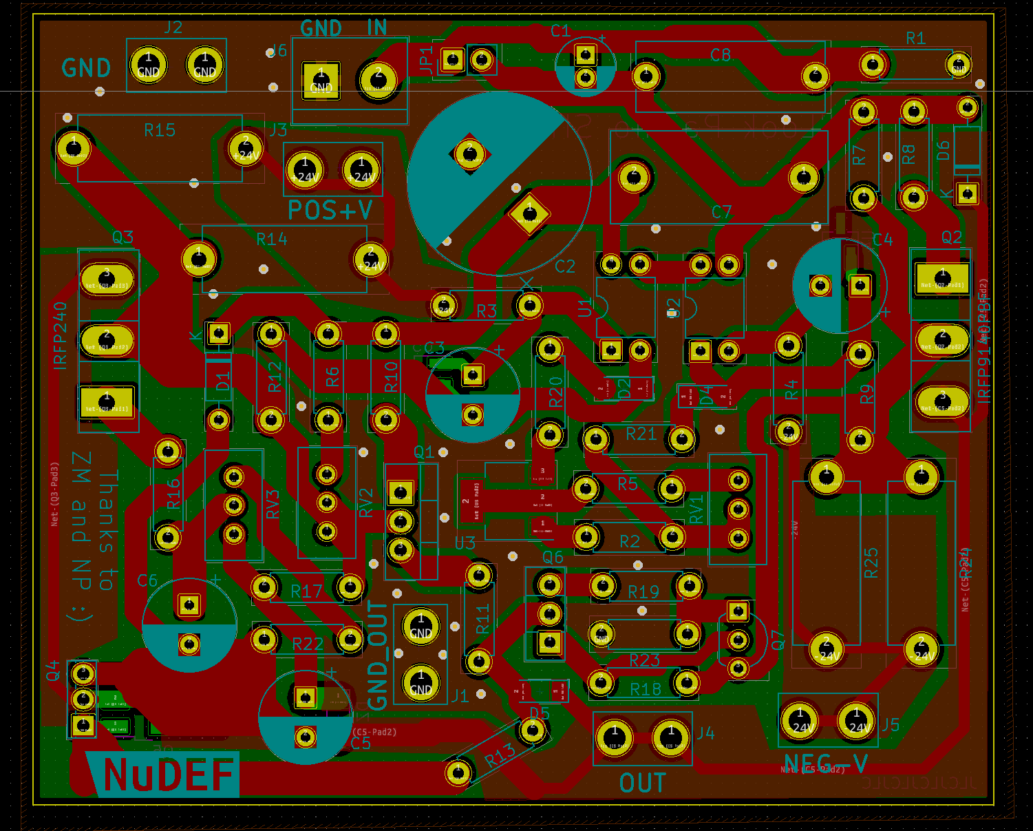

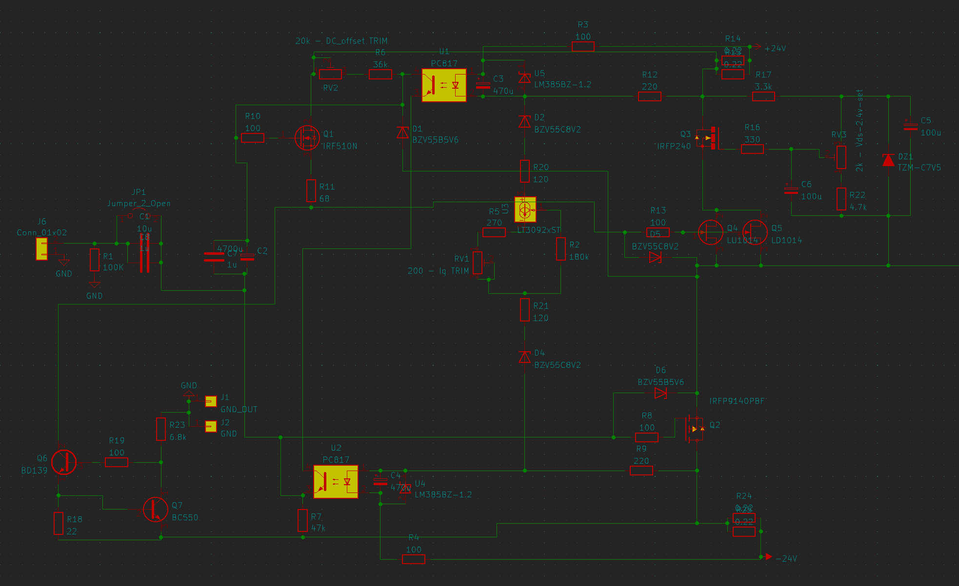

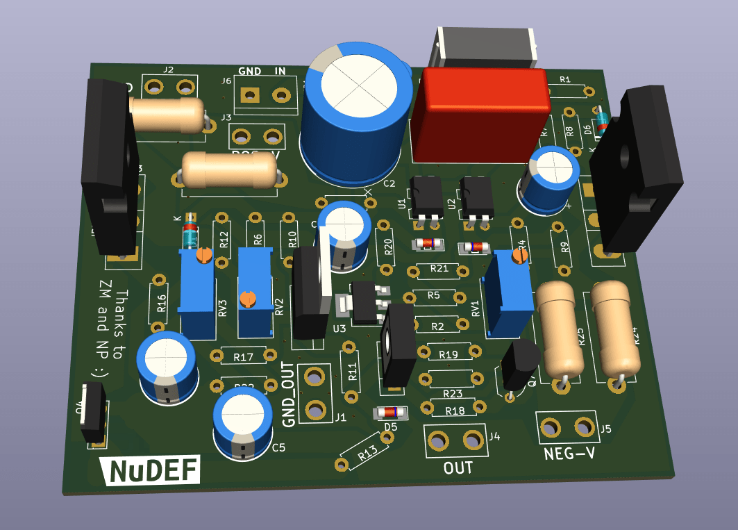

I tried my luck making own LuDEF for my own heatsink format.
For shi$% n giggles decided no front end, so like current buffer (thus NuDEF...cause its bare). Idea is i will keep it modular and not commit to one front end baked into the amp, but just put my own preamp or whatever in front (was thinking Aikido...mmm toobz). A lot of time i listen under 2W, so maybe even line-out from DAC can work.

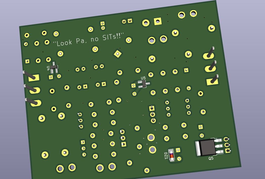

Anyway here is what i came up with, after few layout attempts tried to keep things logical and also have continous ground plane with no traces interrupted
There's 2 LU's on the sch because you only mount one, one is for SMD under pcb, other for off-board ( i just wanted to be flexible, used offboard in the end).

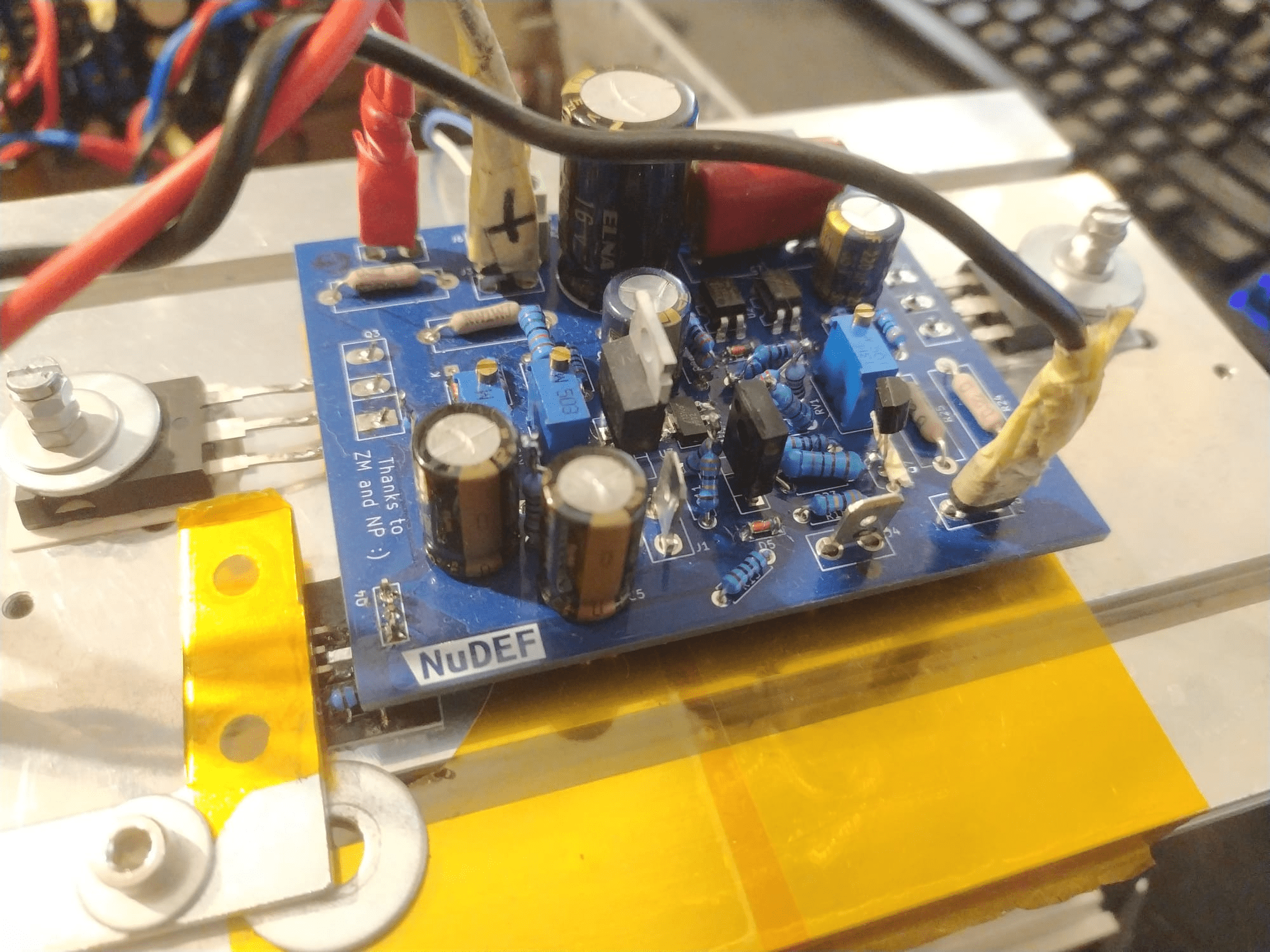

And here is how it came out (ok, looks like s..., moving on ):
Only substituion is KSC1845 instead of BC550, being mindful of different pinout, everything else should be as perscribed by Dr.ZM

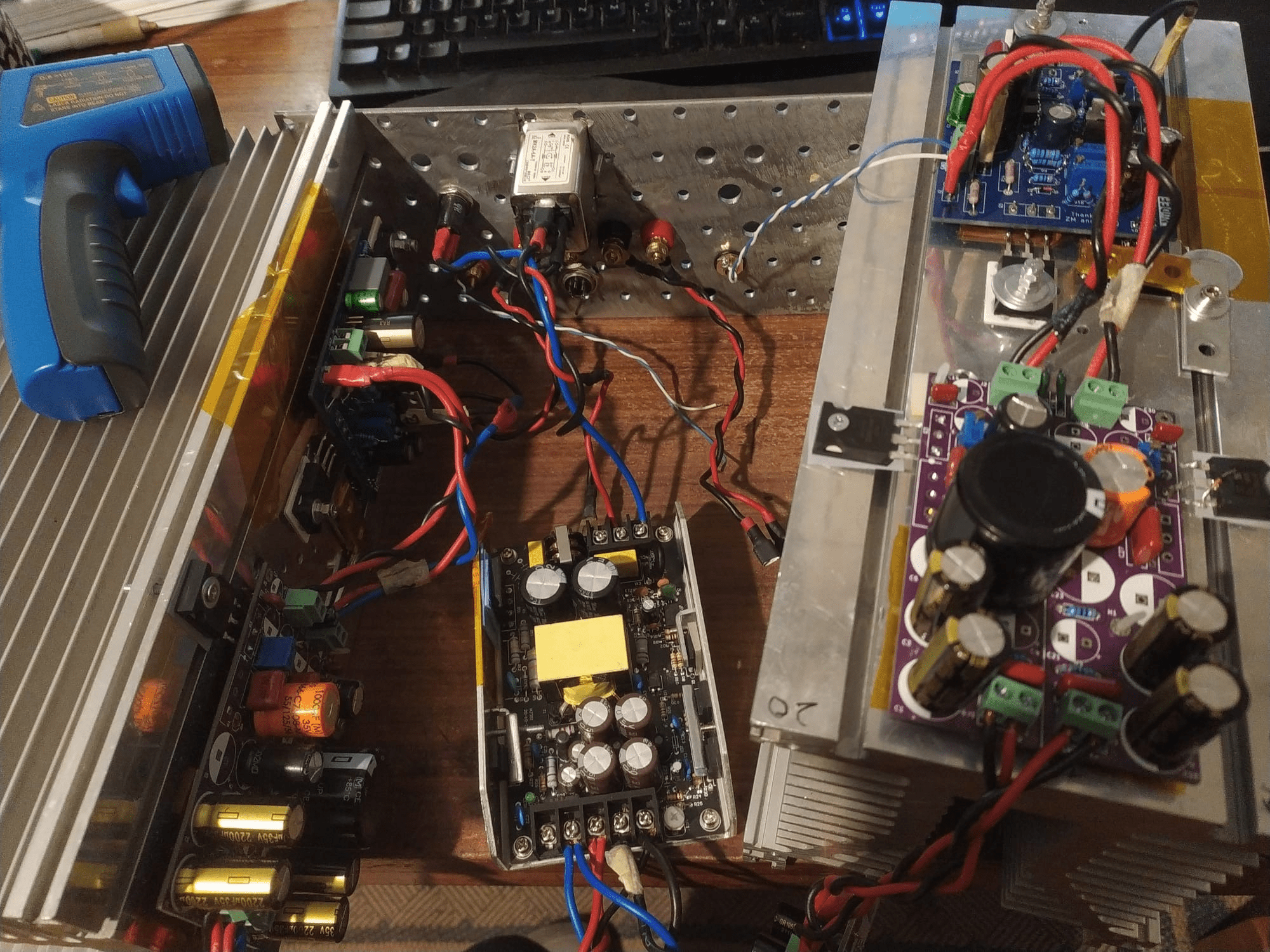

Here is finished thing.. i use SMPS for cheap power, then just filter out everything with juma style cap multiplier (the purple boards)...but capmult does not approximate a good DC source, i'll switch to superreg based thing soon. Anyway, it works fine for all amps i had in here so far ( like, mini Aleph 3, AJ, etc)
Everything biased up fine, went to 150mV (Iq - 1.38A) because smps starts being uncomfortably hot past that..DC offset few mV, LU VGS about 2.4V

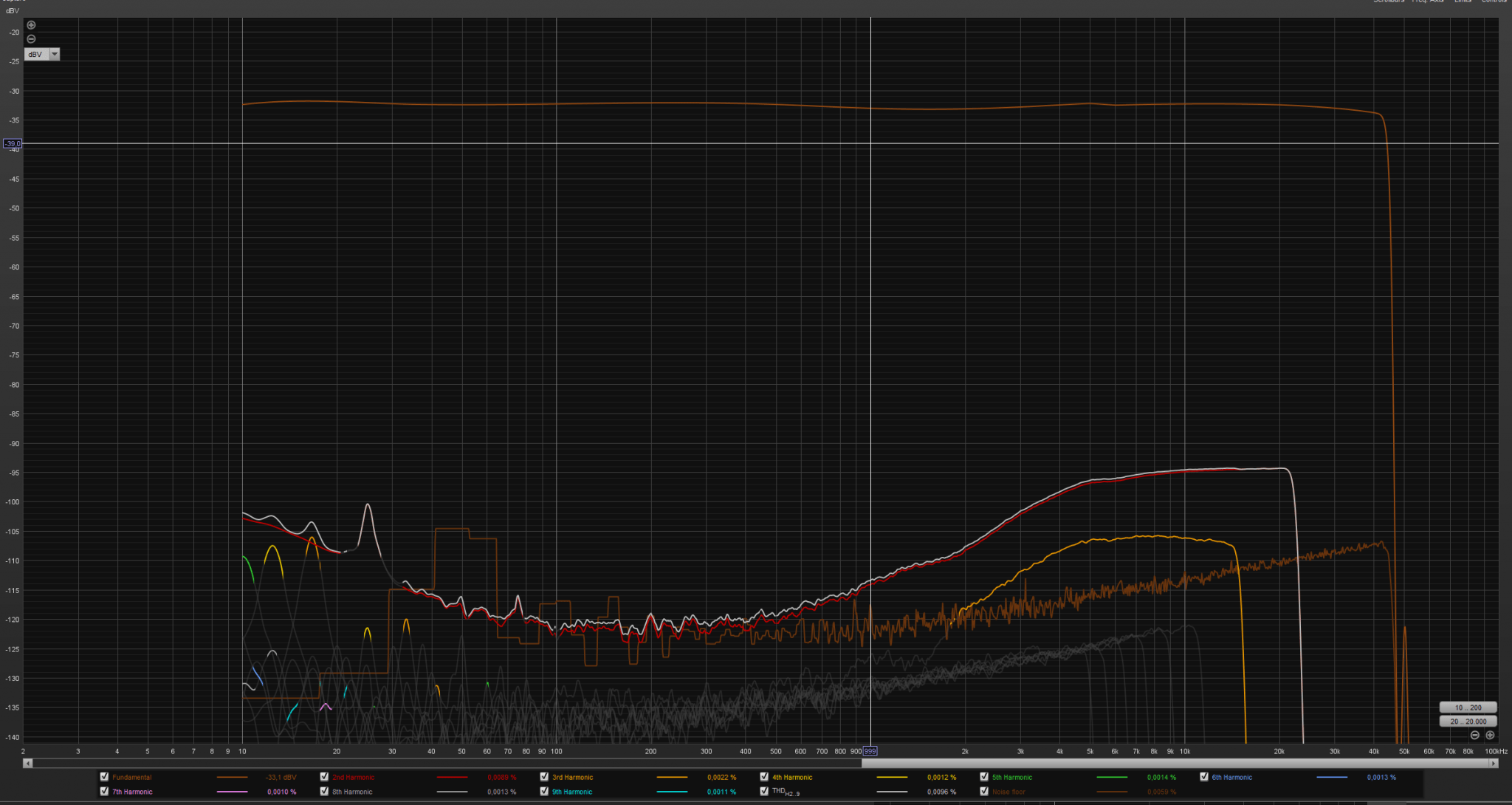

Went to do some measurements and fine tune LU VGS...idea was plug it in REW, play sine wave, then tweedle deedle the pot until it is happiest?
But i come across very unexpected problem.
Frequency response not come close to flat whaaat?
Any guess as to how this could be? I've never seen something like it, loopback of just the audio interface (MOTU M2) that has the dac and adc shows flat as a plank.

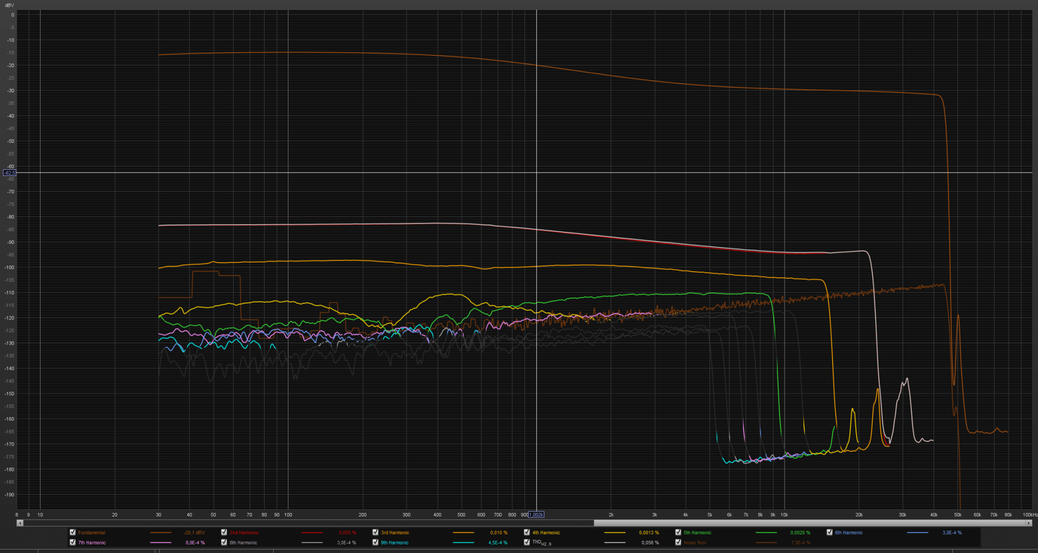

Could be an effect of MOSFETs input capacitance on MOTU output, as there is no high impedance input buffer. I have no experience with MOTU, but using headphones output to drive amplifier would be a way to check if capacitance load is the culprit.

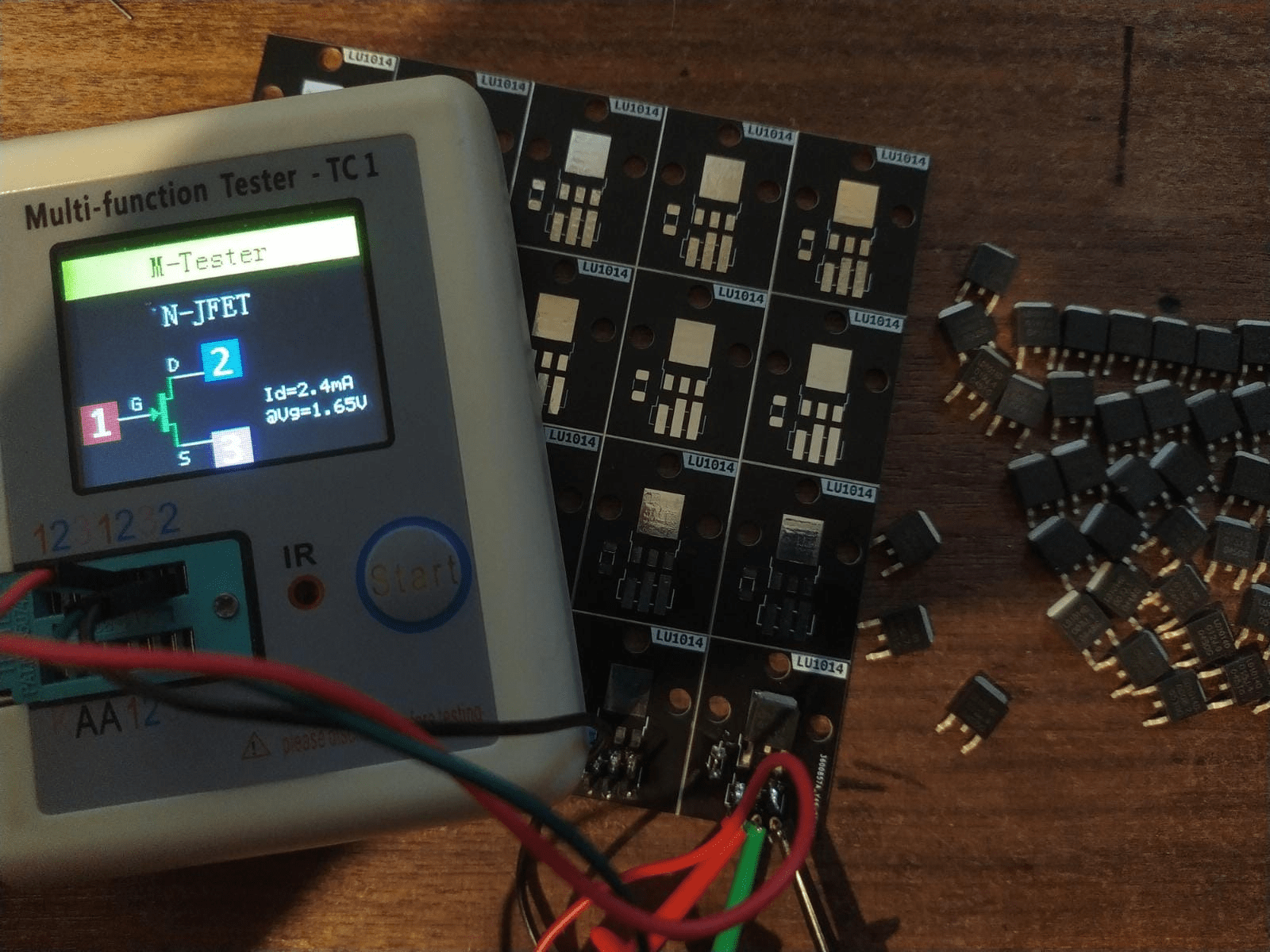

One suspicious thing i tested is LU's performance (i.e distortion and FR) are basically identical from 2.3 to 3.1 Vds (this are the extremes pot will allow me to set apparently).
I did not have the opportunity to curve trace them beforehand (no equipment), frankly i picked random 2 from the pile because all i have is one of those crappy Ali small signal transistor tester which tests far from real operating condition, but it did confirm at least these are n-jfets. Oh, i made my own LU/LD mounting thingies too..
They are actually LD1014, i call them LU just to not confuse as it should be same thing different package, but since now there is problem i have to disclose that just in case.
If anyone is willing to match them i will give all away in return for 2-3 matched pairs.

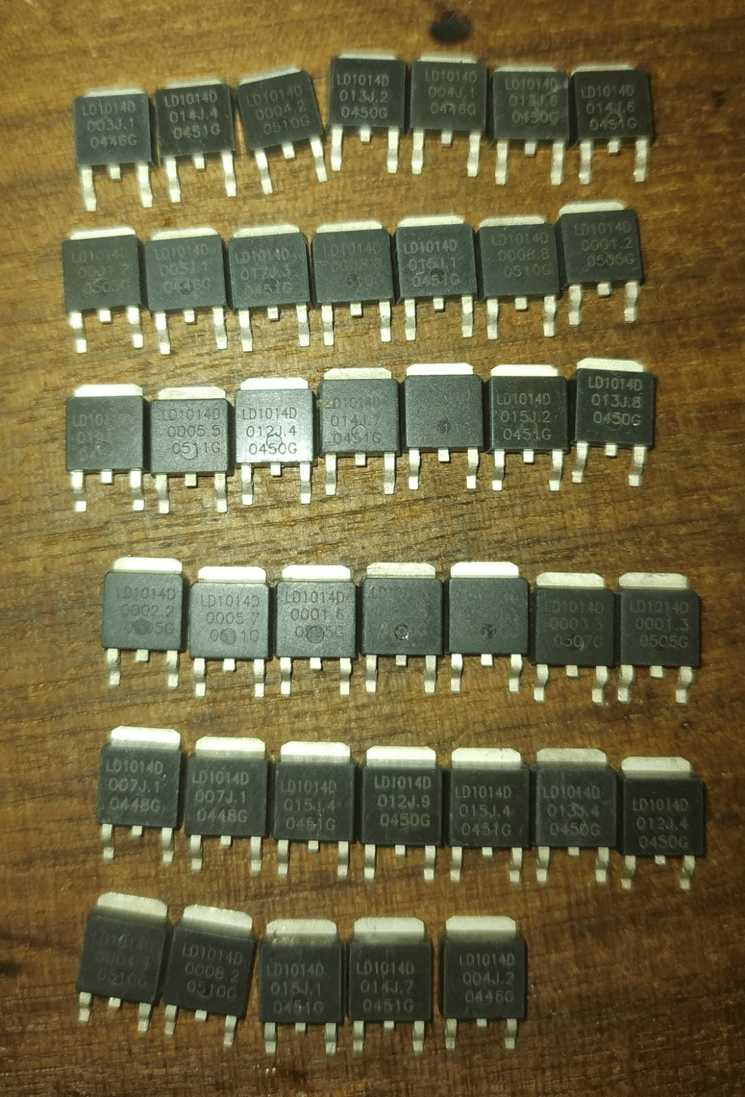

Those LD1014D are real deal. I bought a batch of 50, as some other members did.They are actually LD1014, i call them LU just to not confuse as it should be same thing different package, but since now there is problem i have to disclose that just in case.
However, several were nonfunctional, so I have a suspicion that those LD1014D are some sort of factory rejects or leftovers.
For curve tracing, I used programmable voltage supply, setting fixed Vgs and varying Vds from 1.5V to 3.0V. Curves were all around the place and it was possible to get only 3 tightly matched pairs. In the end, I’ve assembled LuDEF using Papa’s gifted LU1014, obtained through group buy.
Looks like its really something with amp... this FR behaviour remains no matter what is changed
One bruteforce ""fix"" is to just EQ inverse of this, then you get something approximating flat but...somehow im not happy underlying problem is still there
As a bonus you get this bizzaro distortion profile
I think sounds about right, these arent that well matched either, for same Vds i have about 100mv different Vgs roughly.
But im guessing these 2 in particular arent broken or anything, since their behaviour is identical and in ballpark of real part. Beggars cant be choosers i figure, so i'll try to live with it..still, i cant even begin to think how FR would end up like this, what can even cause it other than some analog filter (not present) or something.

Were other amplifiers, that were using the very same power supply (SMPS + Cap Mx) measured in the same way for their frequency response? Question is could PS somehow affect frequency response?
I’m not impressed with that PS:
- Small SMPS close to max. load
- Cap Mx seems to have no capacitors at the output and +/- rails don’t have the same capacitors??
- SMPS transformer ‘singing’ audibly in tune with amplifier output
