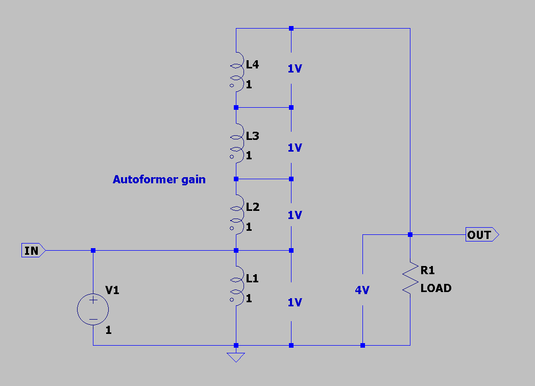

I am trying to learn so here is silly question, in M2 autoformer is voltage gain device, and also impedance matching device, right?
But in ludef is 1:1 so no gain, there must be some good reason to be there since it does introduce its distortion through magnetic histeresis. If we want 1:1, why not have some high current buffer instead of hunky piece of metal?
autoformer : 4V/V gain, not 1
look harder; 1V in, (1+3)V out
red "primary"
blue - added "secondary"
red "primary"

Yes i was just looking at tombo's and familiar with m2x variations, but i meant instead of autoformer, doing its job.
I saw your sissySIT P with XA252 no autoformer FE, and i guess now ludef P will be along same lines, so that got me thinking, why autoformer in the first place? Surely a bit of gain could better be served with IC, unless iron has some additonal special function too? So it let me to google around, but discussion too general so i asked here #925
You have been around the block and know what's what so when you (and Nelson) do it this way i know there is a very good reason.

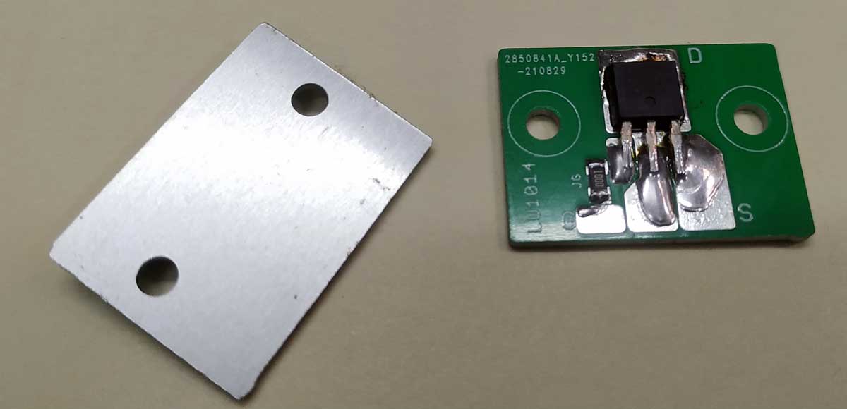

Oooh nice ZM, was waiting for LuDEF-p, I already have matched Lu from papastash and the alu heatspreaders from the groupbuy.

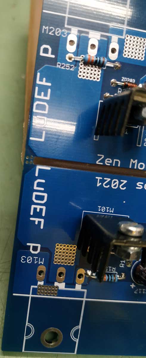

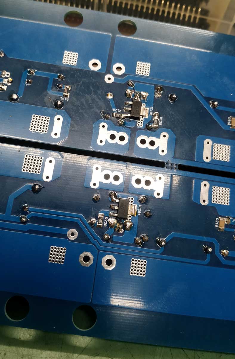

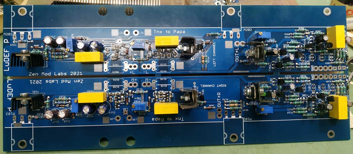

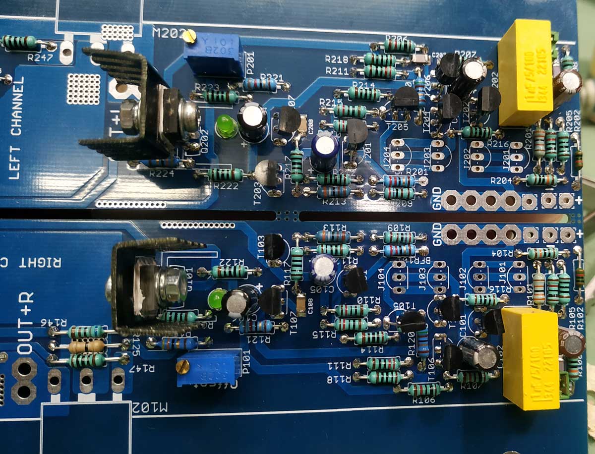

even if I'm working on some other stuff (orders, plenty of tiny wires), LuDEF P somehow sneaked on my bench today ....
not much, but certainly most tricky is done - all SMDs are soldered on
premonitionprecognition is strong ..... next week, T-Bed

explanation of Autoformer Gain
Thank you, i researched later a bit and realised what you mean about autoformer, your electrical equivalent diagram is useful
