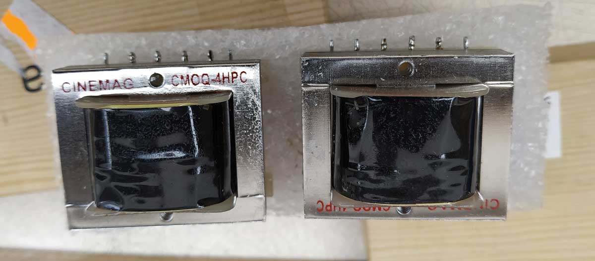

two possible Cinemags - you have both titled in schm in post #1

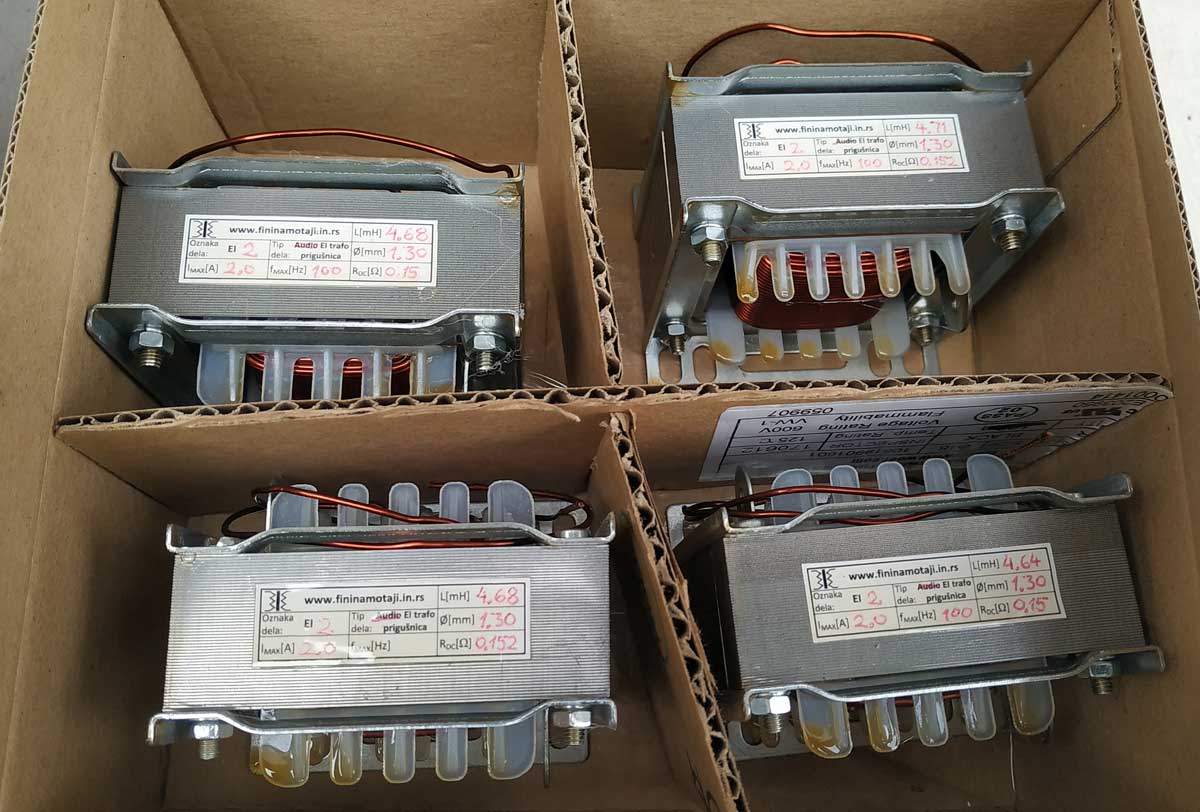

Hello Dan,Can someone point me towards the best place to buy the Cinemag Autoformers in the UK, or will I have to import?
Which one do I want to go for?
i think you found it already. But here is a link to Don Audio and its autoformers.
https://www.don-audio.com/audio-ausgangsuebertrager-transformer_s2
Cheers
Dirk

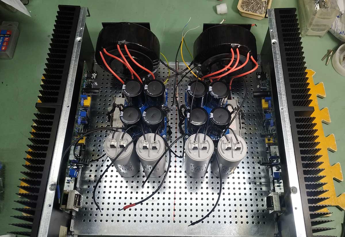

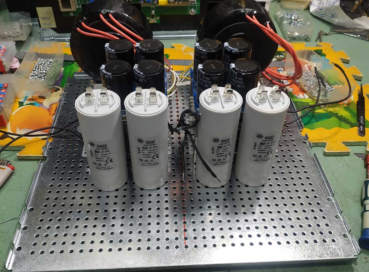

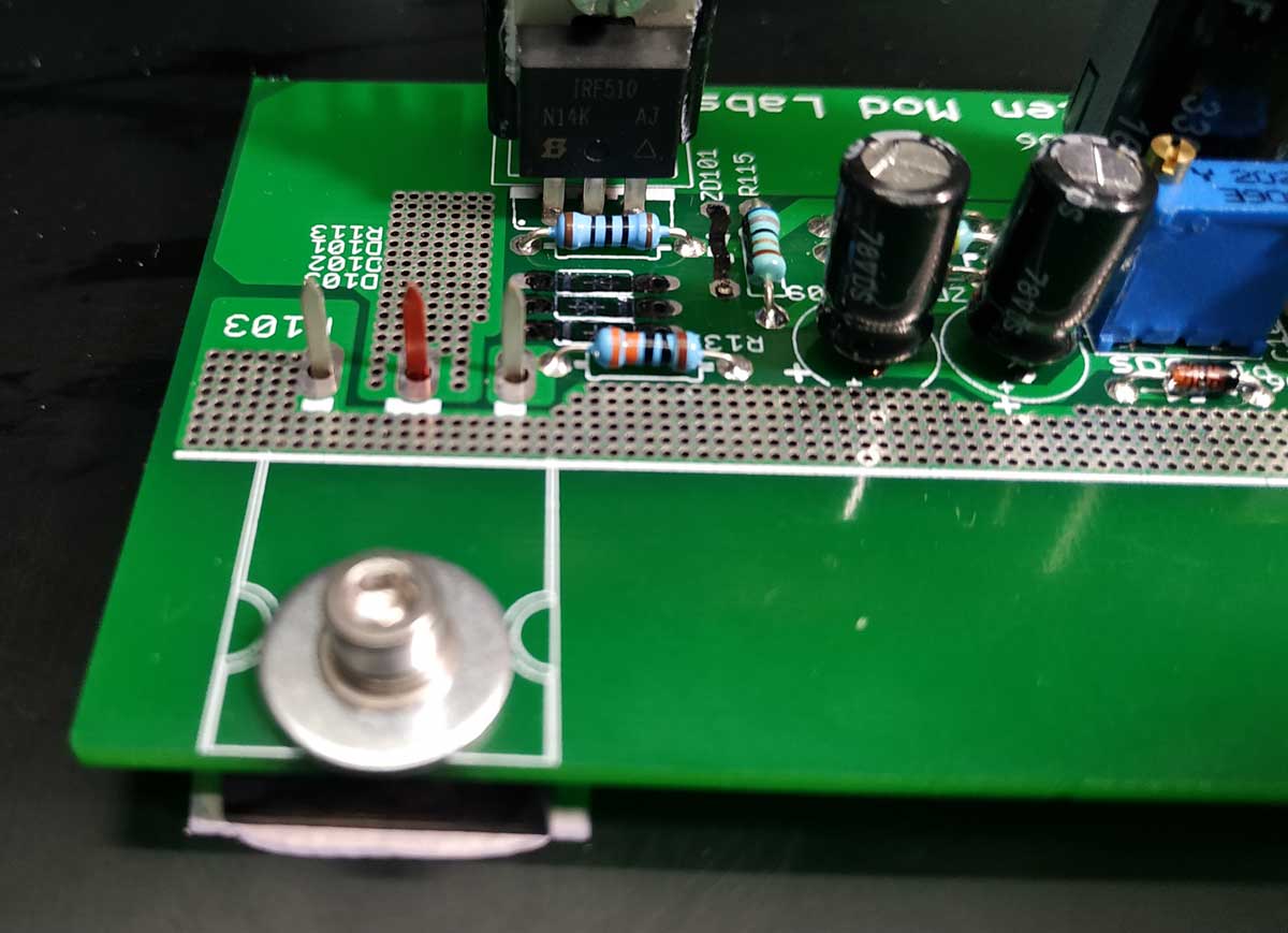

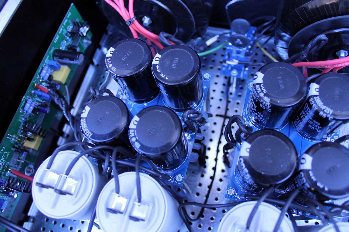

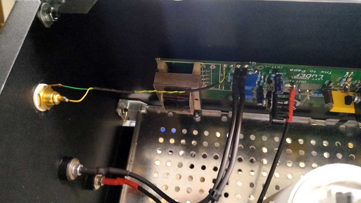

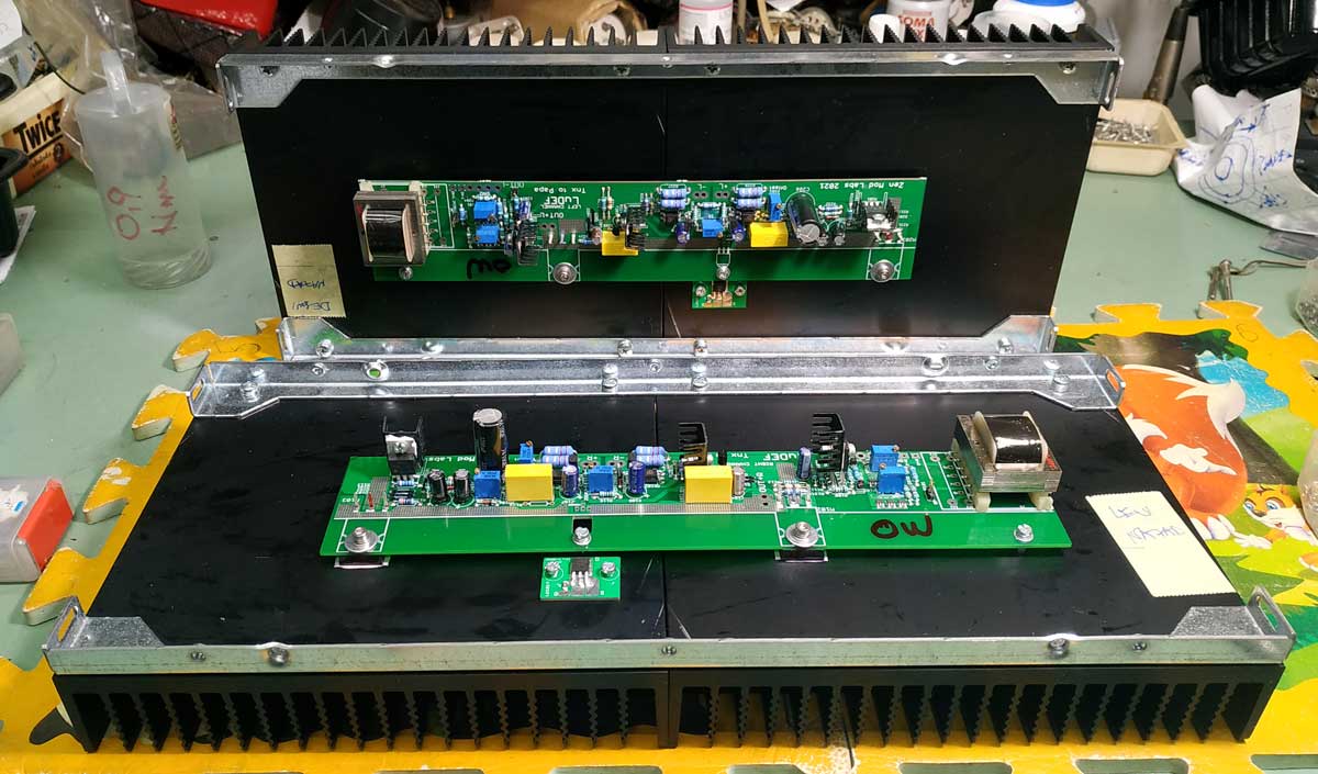

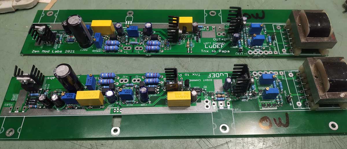

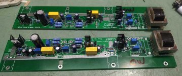

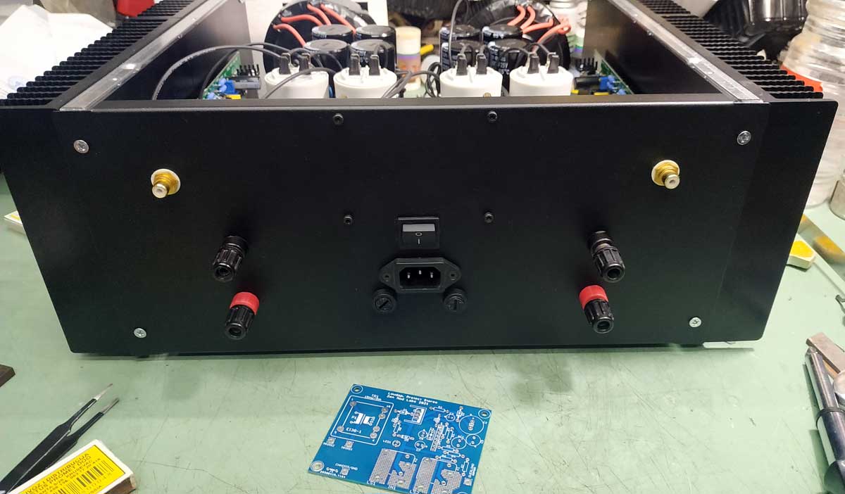

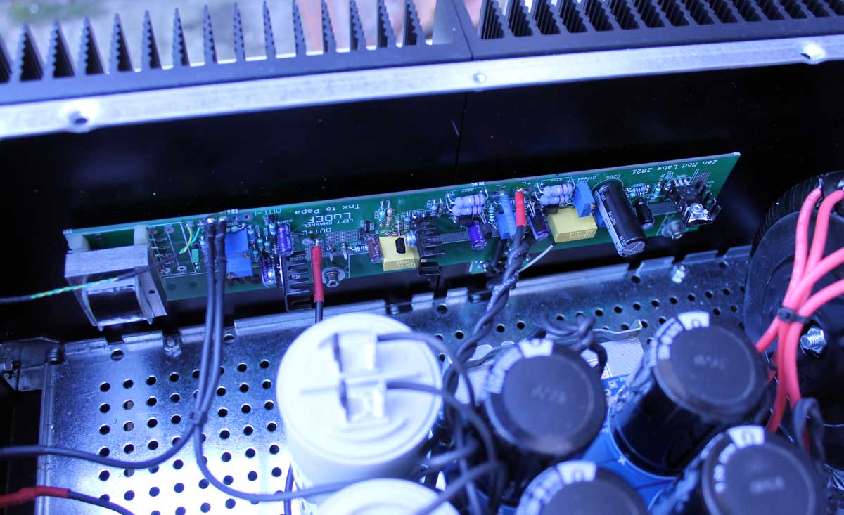

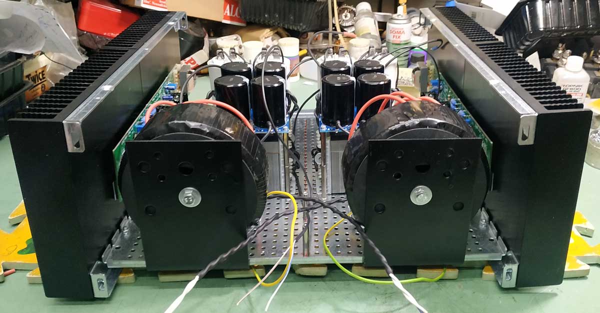

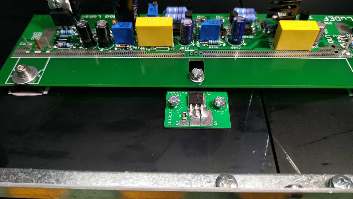

Another question.. Regards the LU board and the 2 large output devices, should they be seperated from the chassis/ heatsinks by a silver mica? Thanks again
if you have LU on small Aluminum pcbs - no need for mica , LU is already isolated form Al back of pcb ...... just put some thermal goop in between
IRFP- each needs proper isolator
small LU pcb - take care to solder wires to same, while small pcb is still not on heatsink
if you fix it to heatsink prior to soldering, you'll need blowtorch or two, and still no go

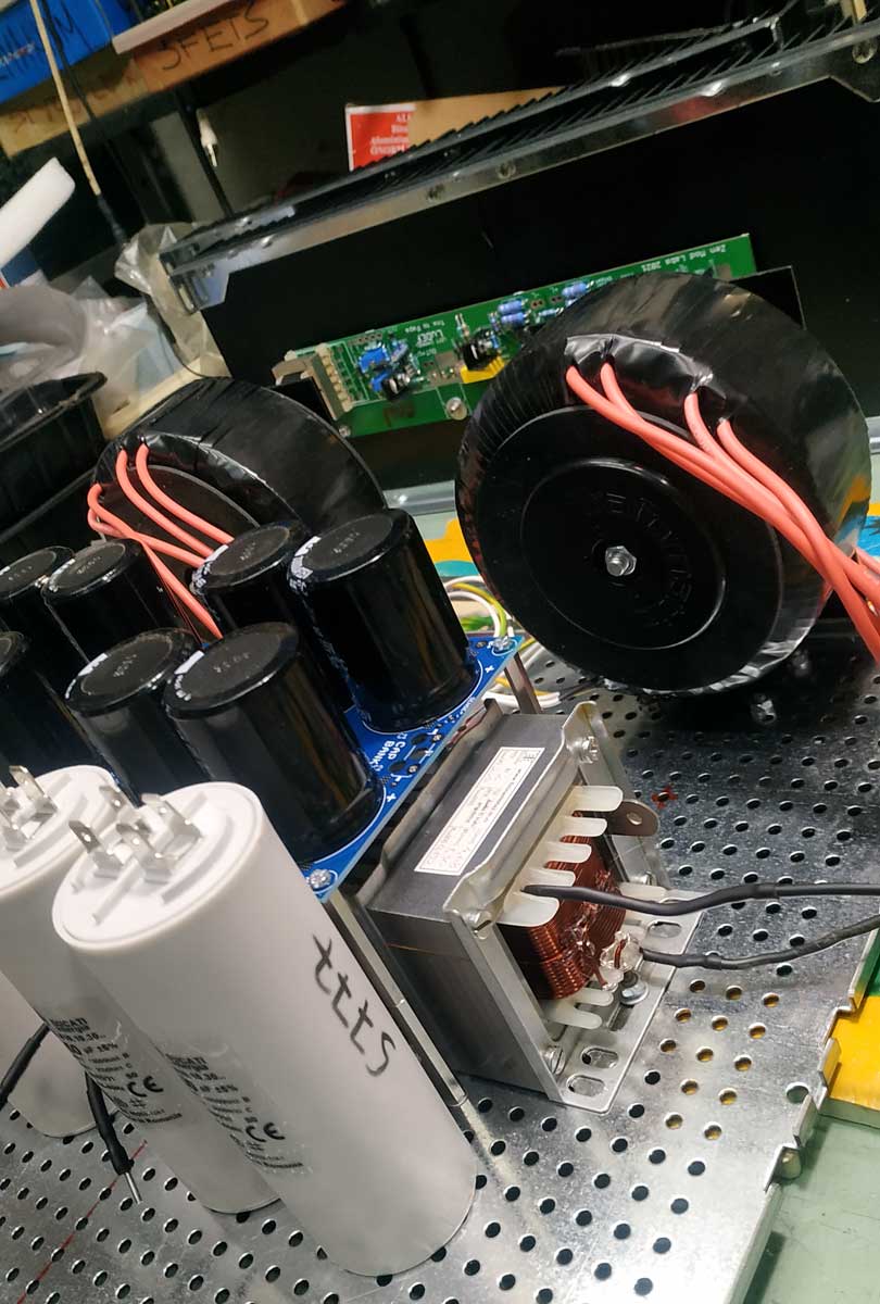

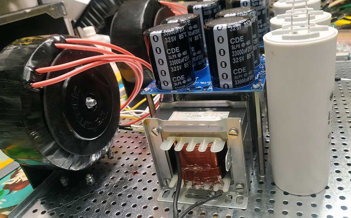

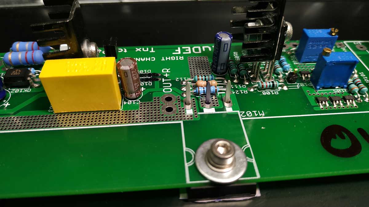

Very beautiful Cinemags have now arrived, assuming that I solder all the connections/ legs?
Thanks again
Thanks again
you got last iteration of pcb, where cutting outer 4 pins isn't needed
so, solder all pins - I mean - outer 4 are still NC, but if nitpicking, better mechanical arrangement
if you're nitpicking to other direction, no need to solder outer 4 pins

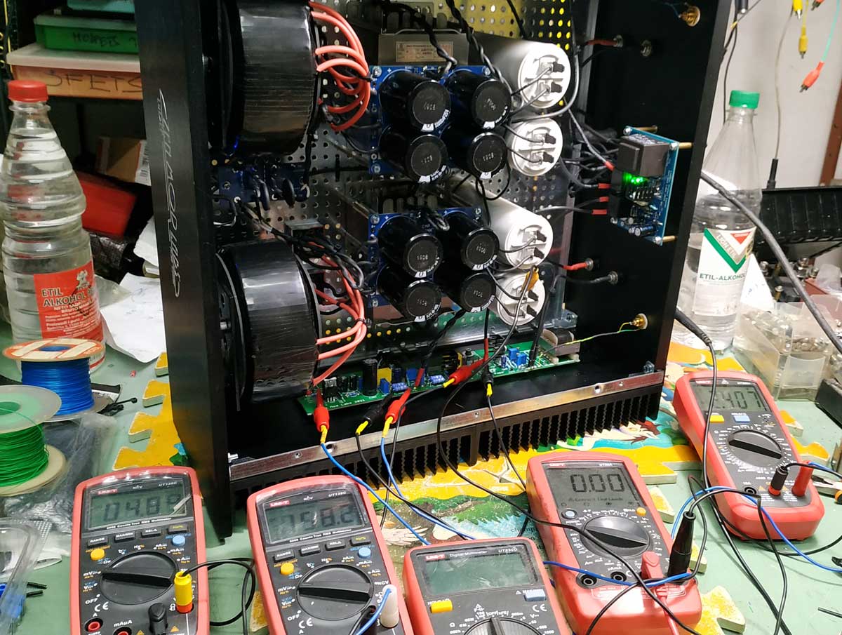

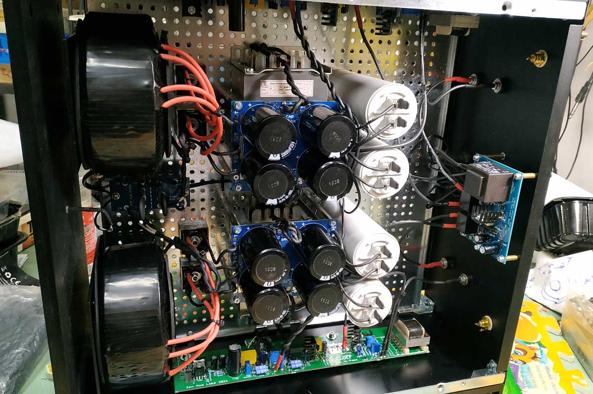

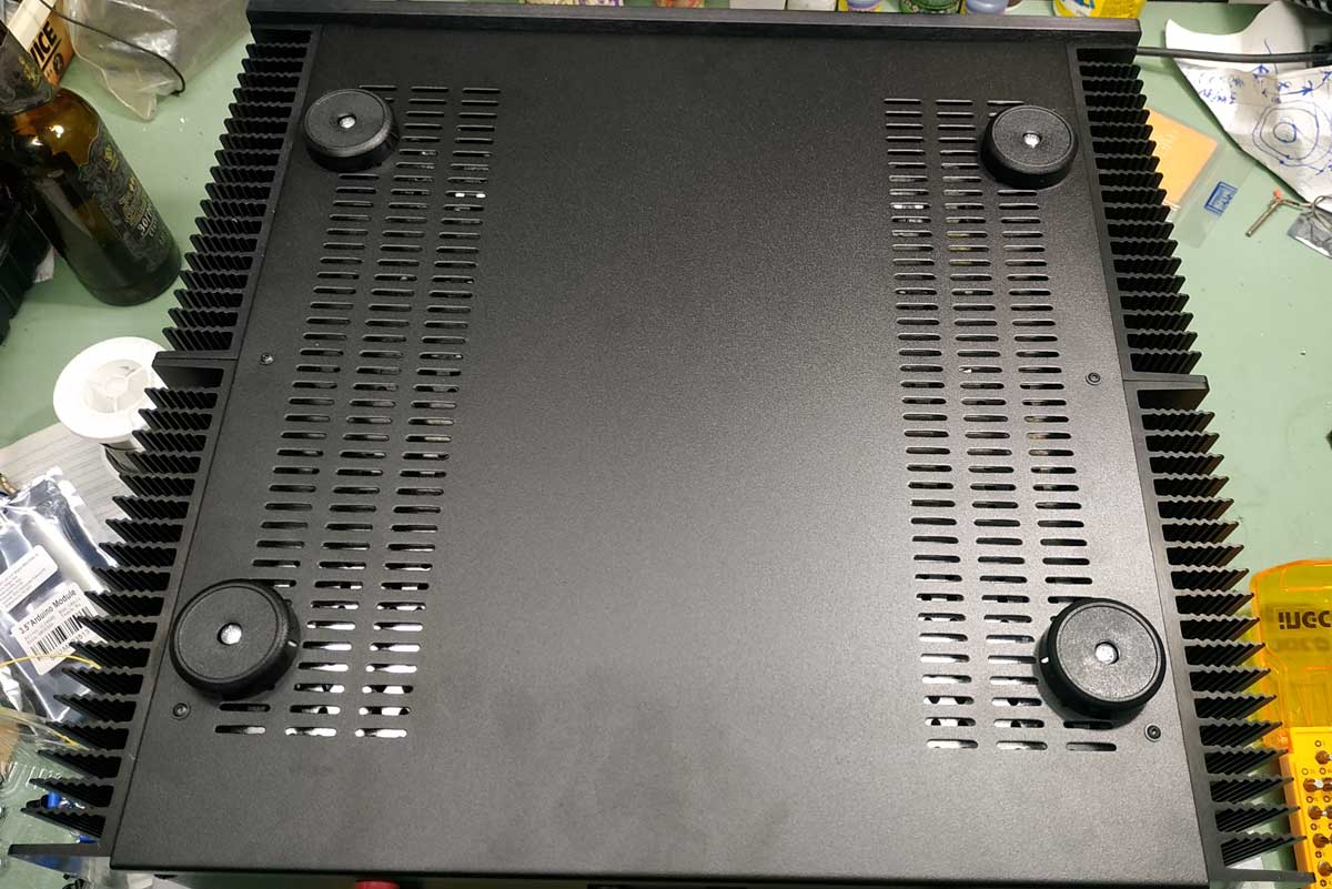

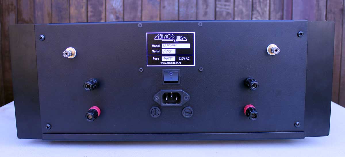

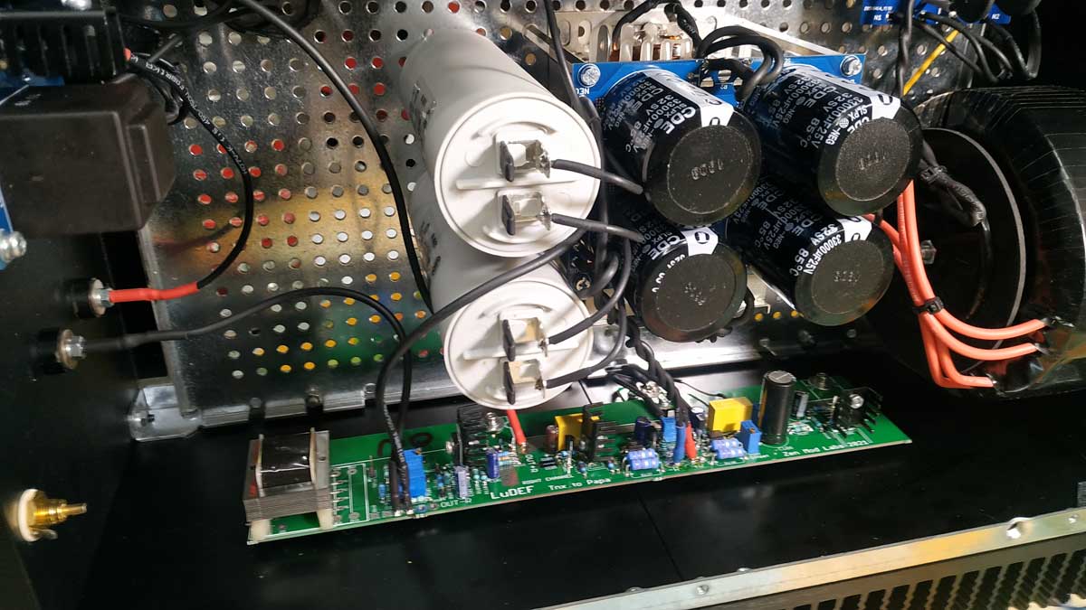

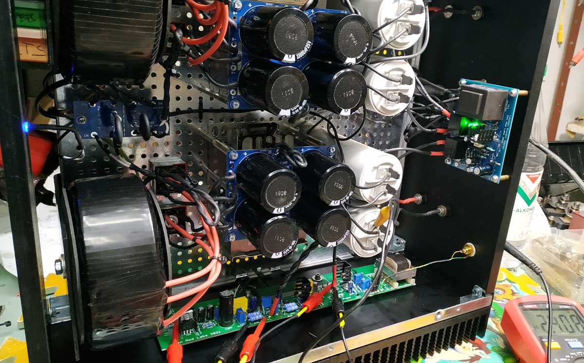

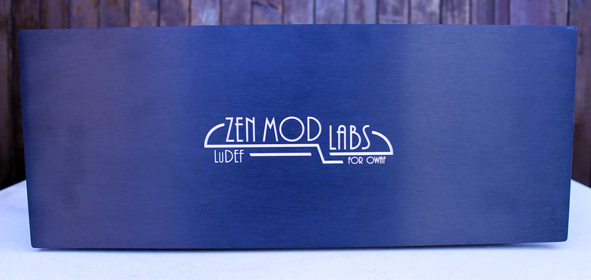

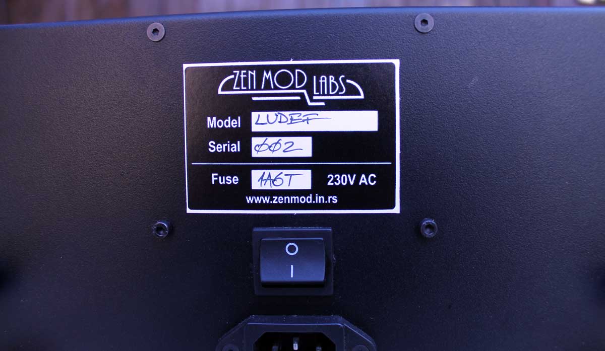

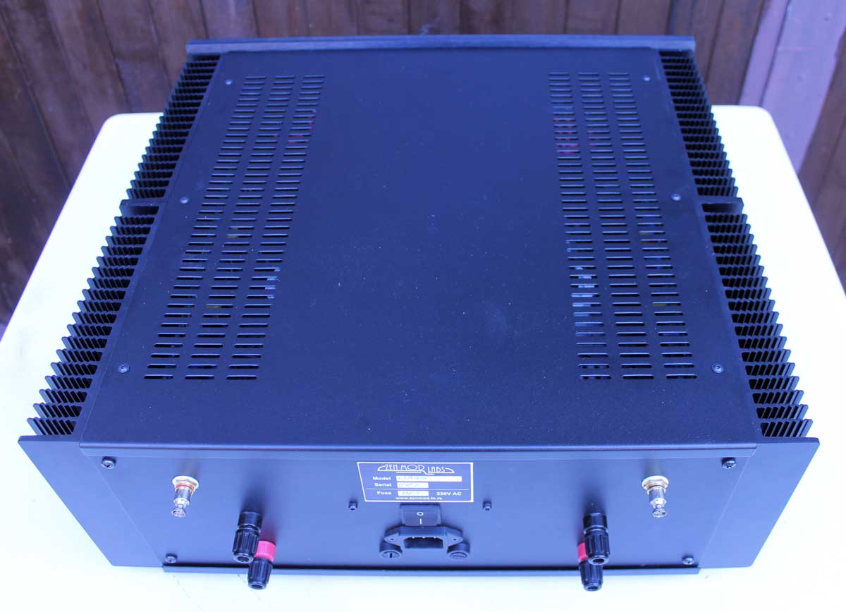

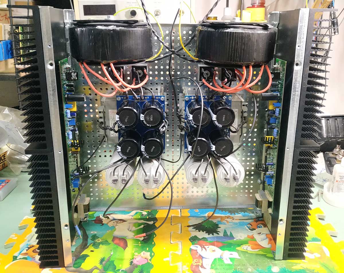

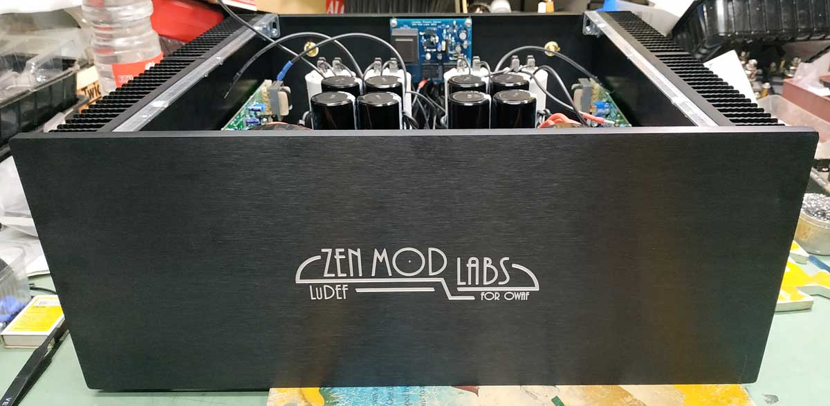

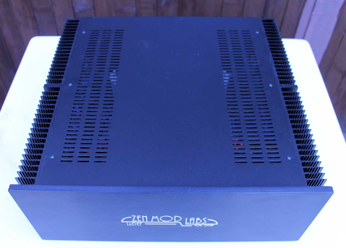

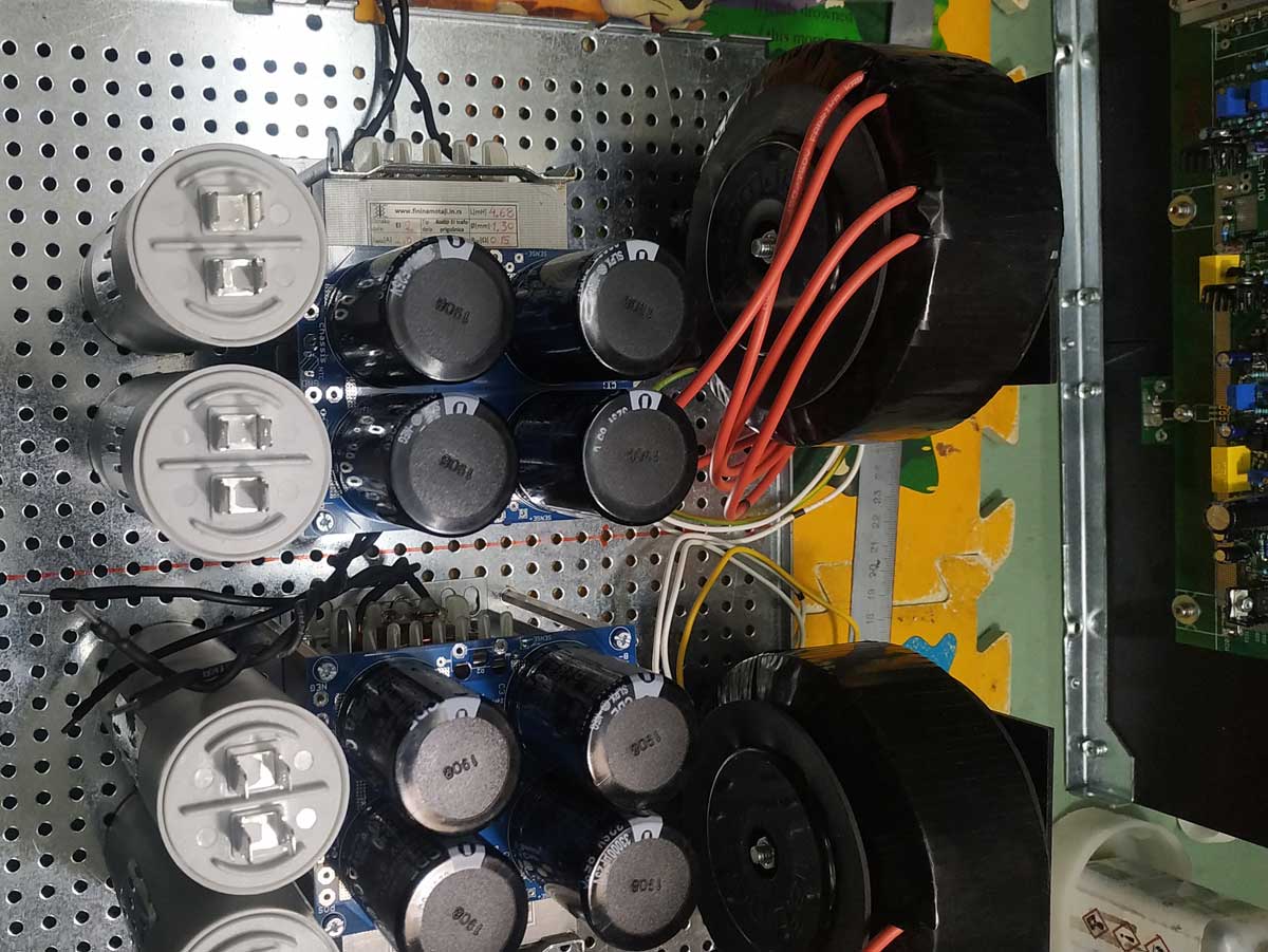

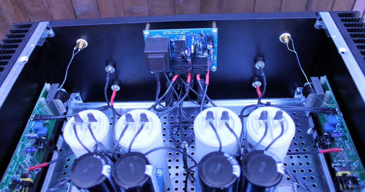

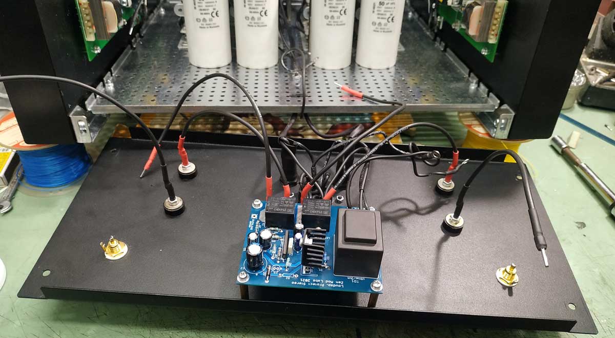

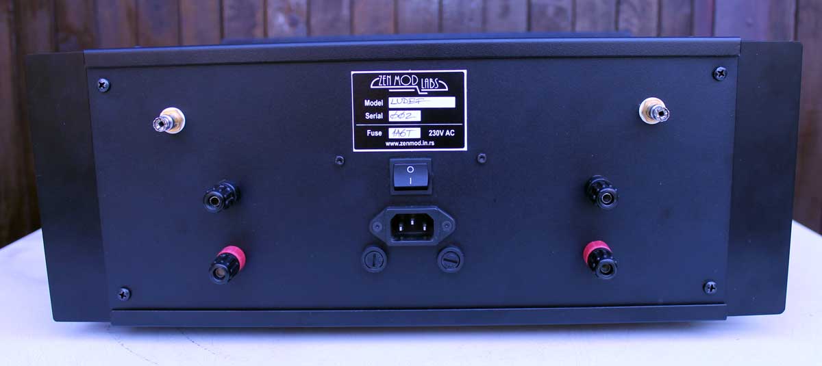

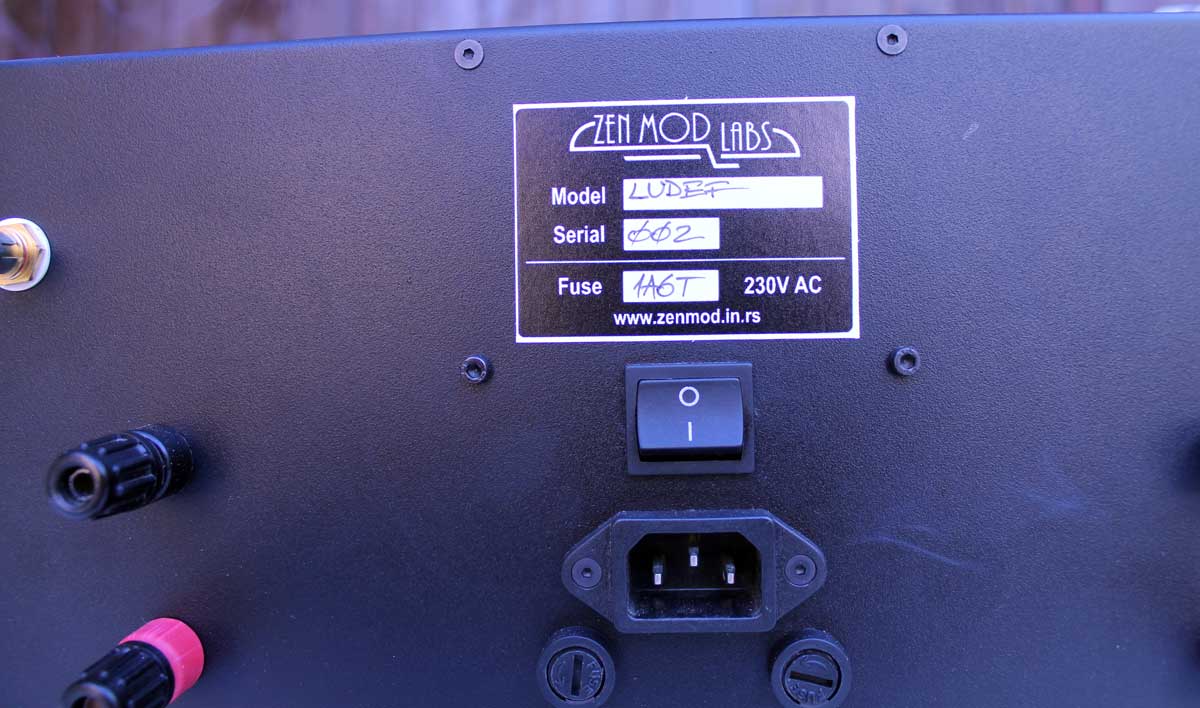

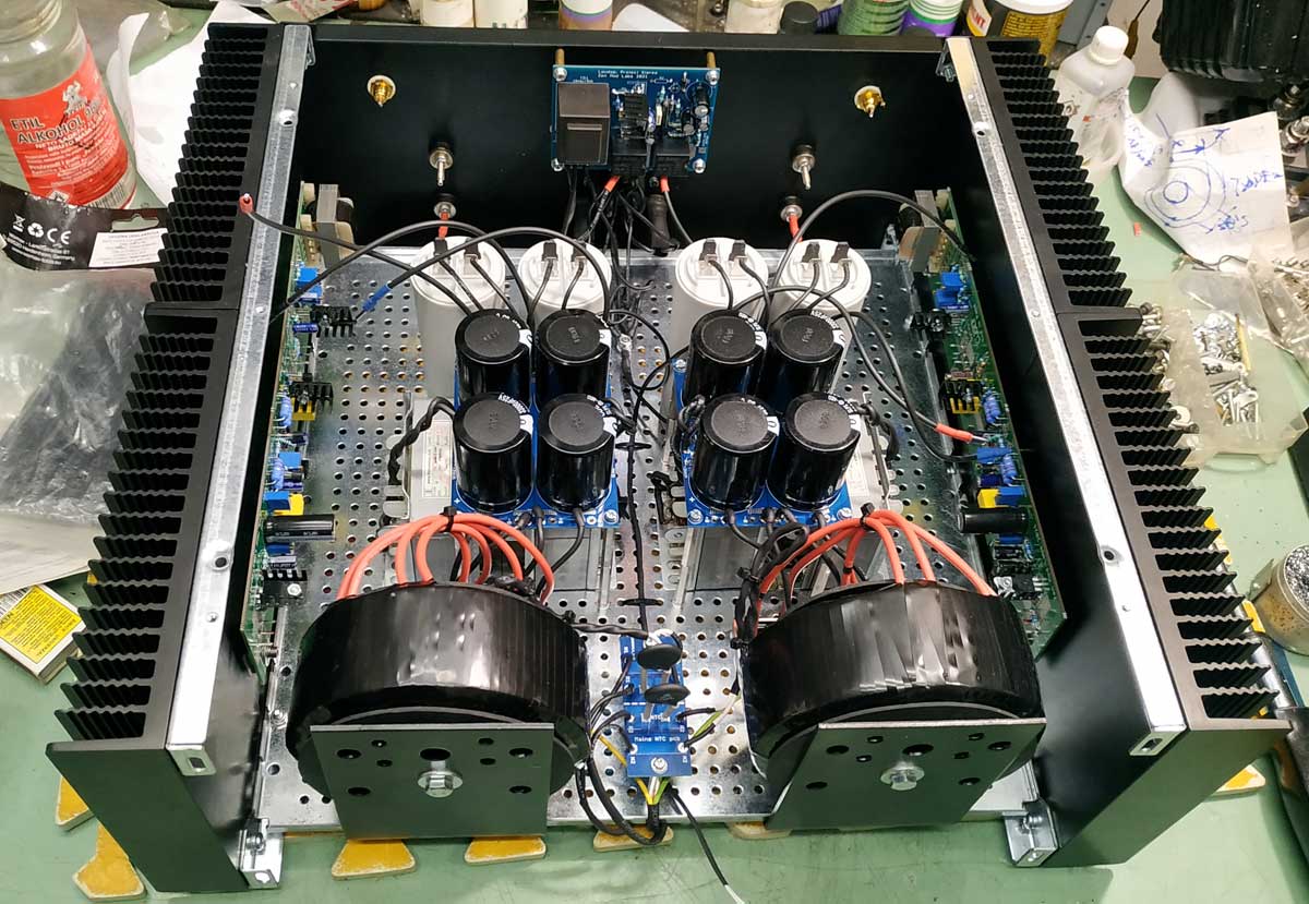

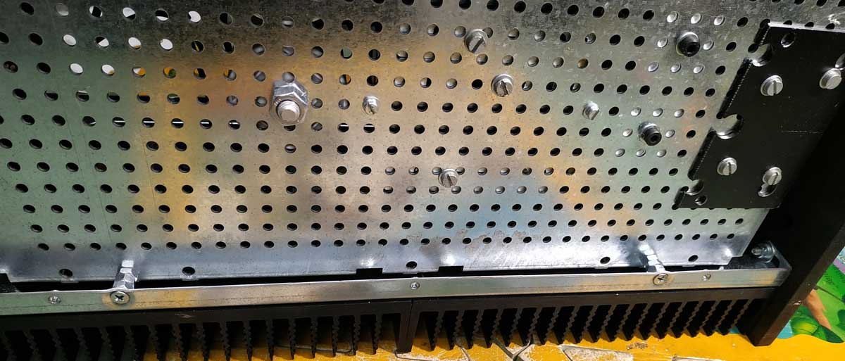

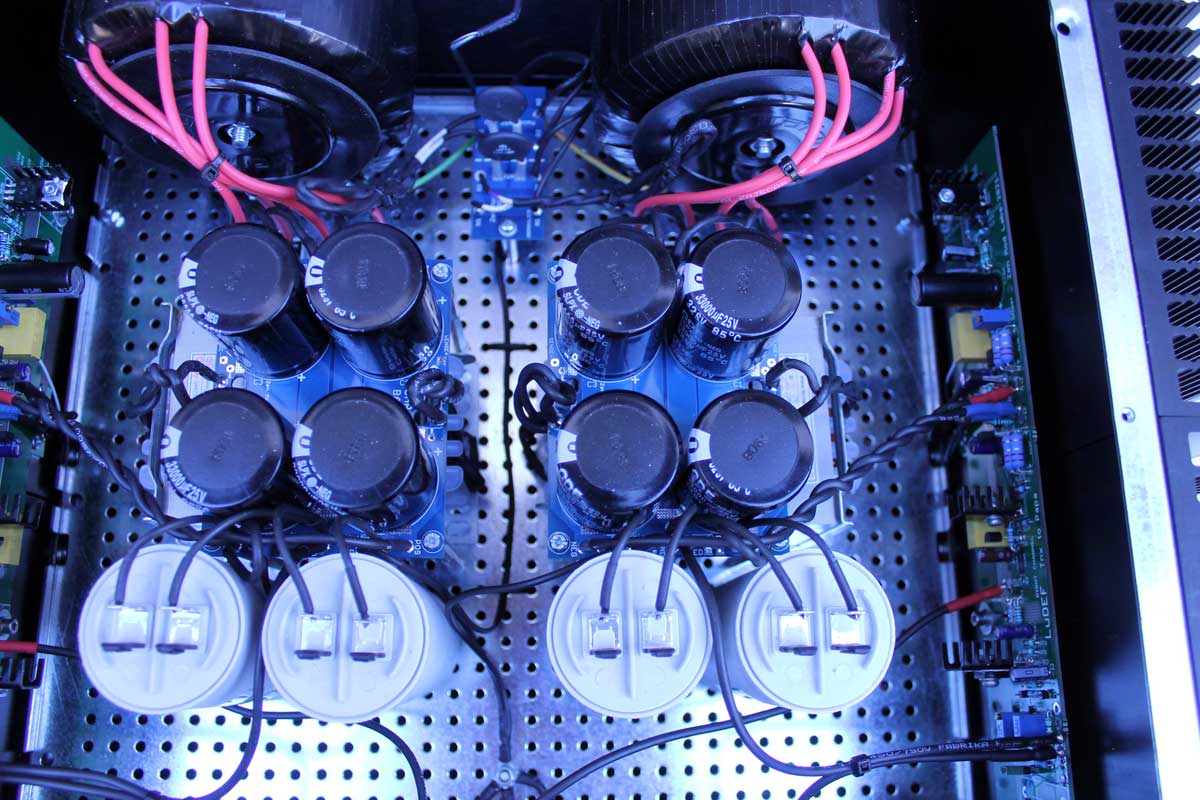

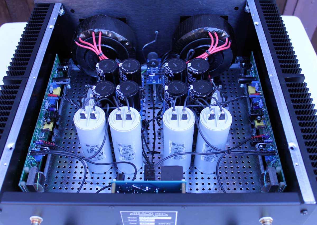

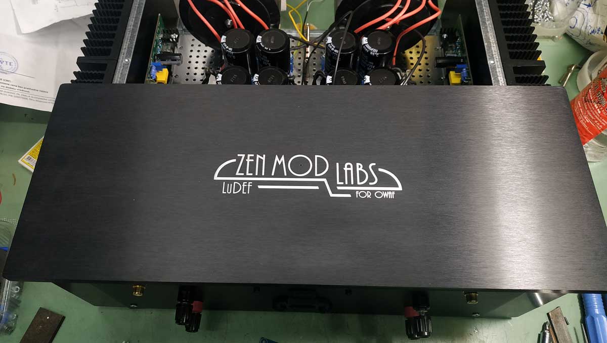

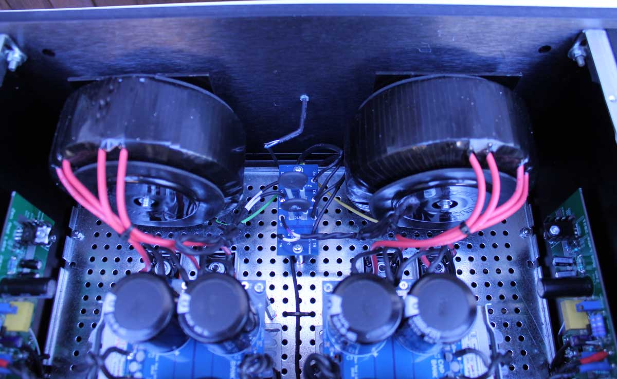

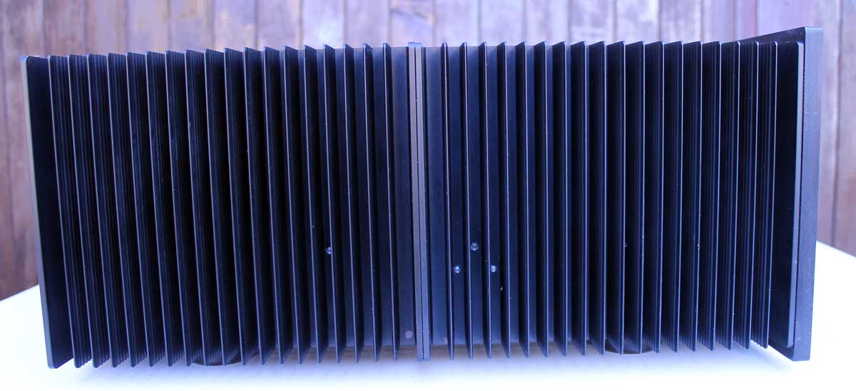

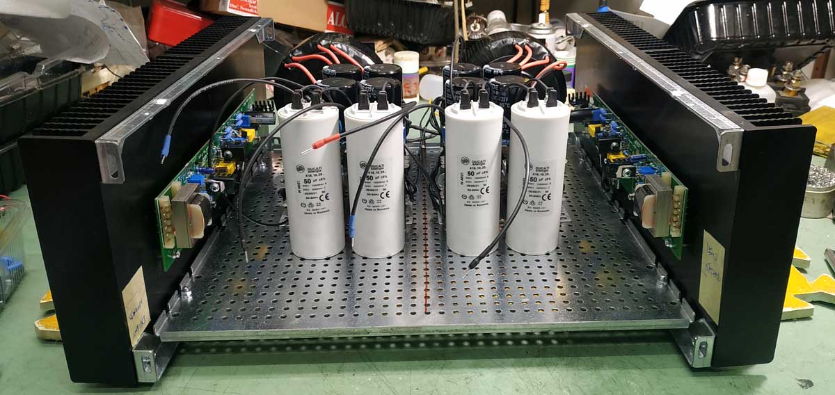

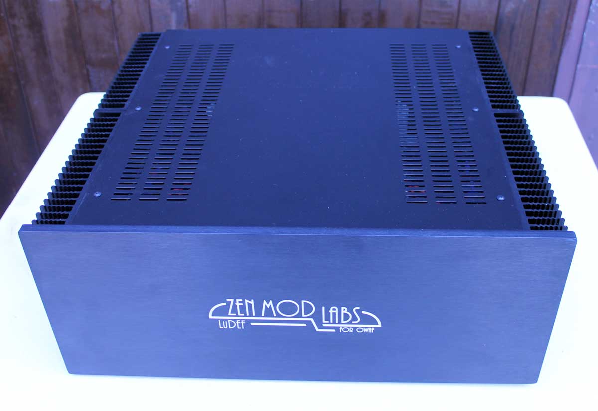

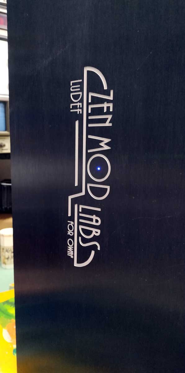

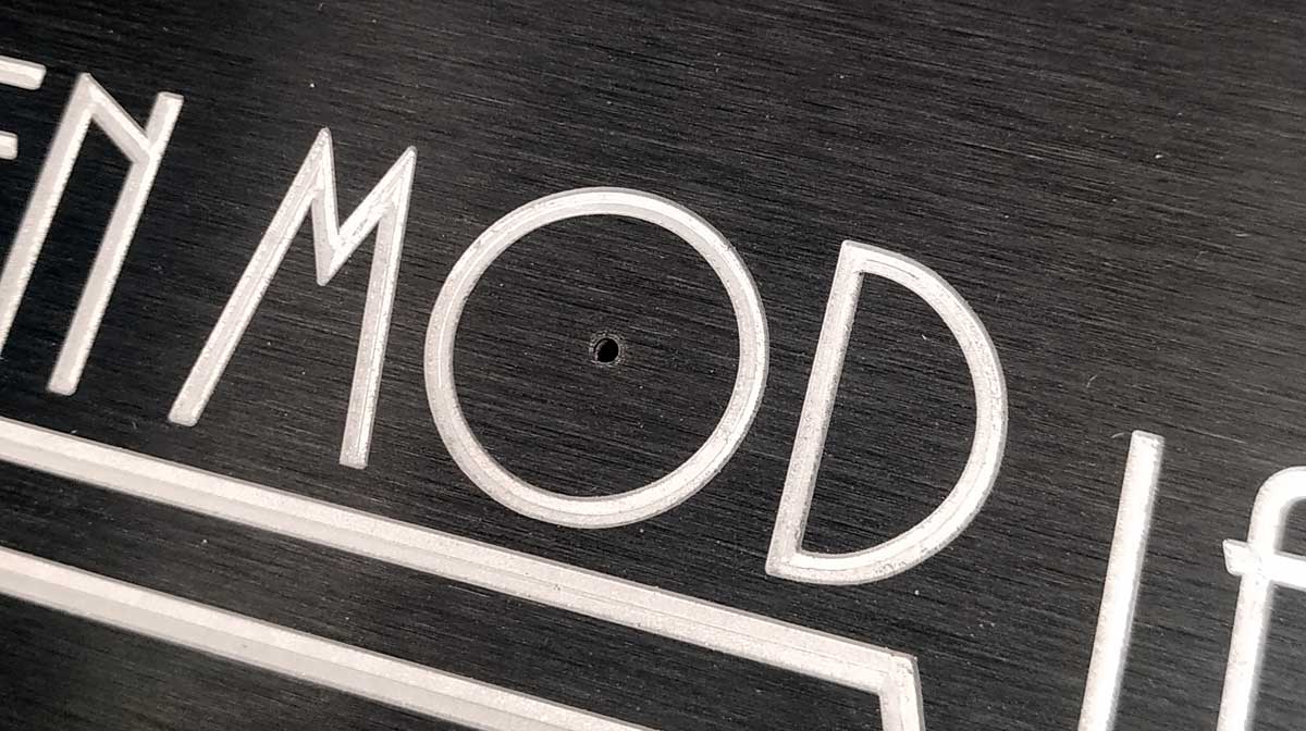

LuDEF commissioned by my Buddy ZeroWAF, Mod at Baby DiyA
he said - better that you make it ......
Photo-shoot
Photo-shoot

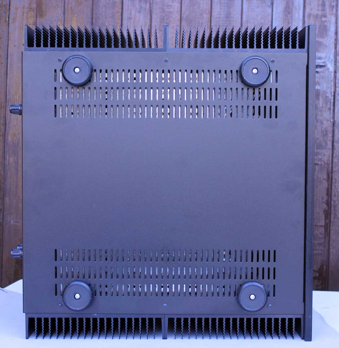

Late to the party, but very clean build, congrats 🙂
