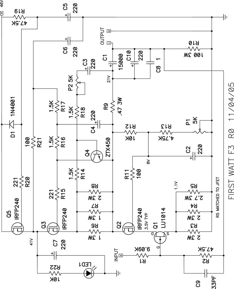

Of course - things can be varied a little, but as far as I'm concerned - only in one way - varying Uds of LU +/-100mV ( so down to 2V3 and up to 2V5, now sweet spot being at by Papa prescribed 2V4, F3 Beastie)
Can you please point me to Papa's 2V4 prescription? Mille grazie!
well, sometime numbers are worthy as words
in many instances, I did found schematics worthy of whole-evening-reading session
