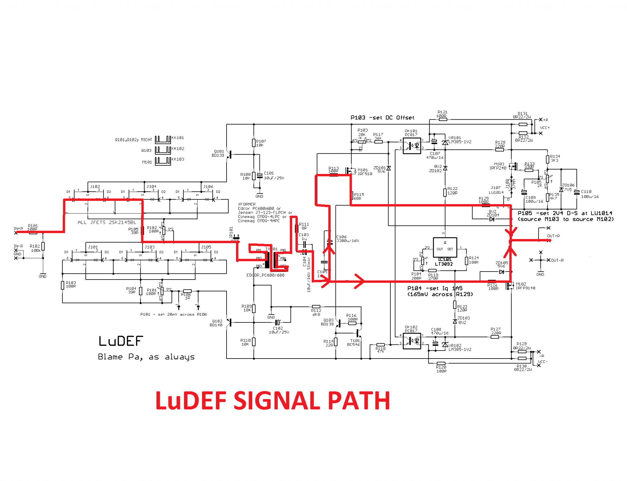

I wonder if anyone would have the time to mark the signal path on the circuit diagram? I'm a little confused by it. M2 was much more obvious.

forgot to say - if you still need signal path sketch, just say
It would be helpfulforgot to say - if you still need signal path sketch, just say
Thanks again
amp is extraordinary simple, you just need to recognize function blocks

question is not stupid ...... only rationale behind it can be
that's practically sole ( serious) cap in signal path .... but it's sonic footprint ( if made as I made it - Silmic+MKC bypass) is much lesser than you think
I have a version of amp (in fact - all of these autoformer based) with current mirror biasing (same as in Babelfish XA252) which allows direct couplin all the way from input to output, but this si not time to pursue that
