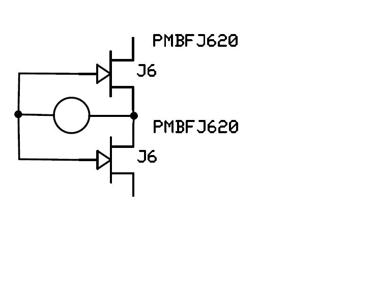

I'm going to order one of those opto photovoltaic cells. I think this would be ideal for fig 19.

What applications would they be for -- high Vp devices? So, I can go to that type to find possible suitable jFET. Thx - RNMarshNo, I think a better statement is that the FET wants to stay in the triode region well away from Vp. What you want is very high Vp which happens in general to go with long channels. The down side is that high Vp low Idss FET's are higher resistance and it's harder to make them be just a small portion of the feedback mechanism. The linearization tries to keep the FET looking like a resistor centered on the origin rather than off to one side, hence the trim tweaks the seconds. This trick is very old BTW well known when I started in 1973.

Yes indeed, perfect application. I will gladly answer any questions should they arise. I think the Panasonic ones are cheap and widely stocked and easily make enough volts for any Vp.
can you suggest a source and model number (approx 50-100 ohms)? Thx-RNMarshYes indeed, perfect application. I will gladly answer any questions should they arise. I think the Panasonic ones are cheap and widely stocked and easily make enough volts for any Vp.
I think he is referring to optocouplers that generate a voltage out from a voltage in. The idea is to drive the Jfet gate from a floating source tied to a pair of resistors in series across the source-drain of the resistor.
Yes this is it.
They can be had from Digikey and other suppliers.
These PV's don't have much of a output voltage range.
3V min and 8V max is typical. Not sure how to use these.
