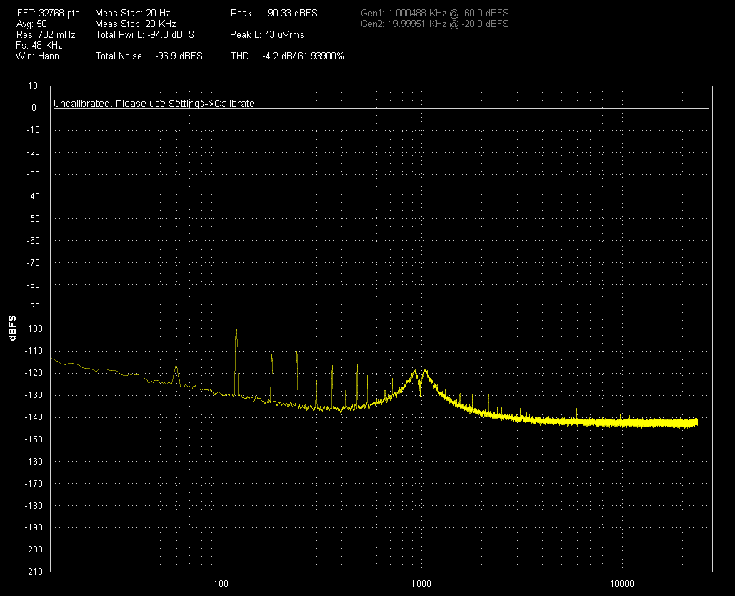

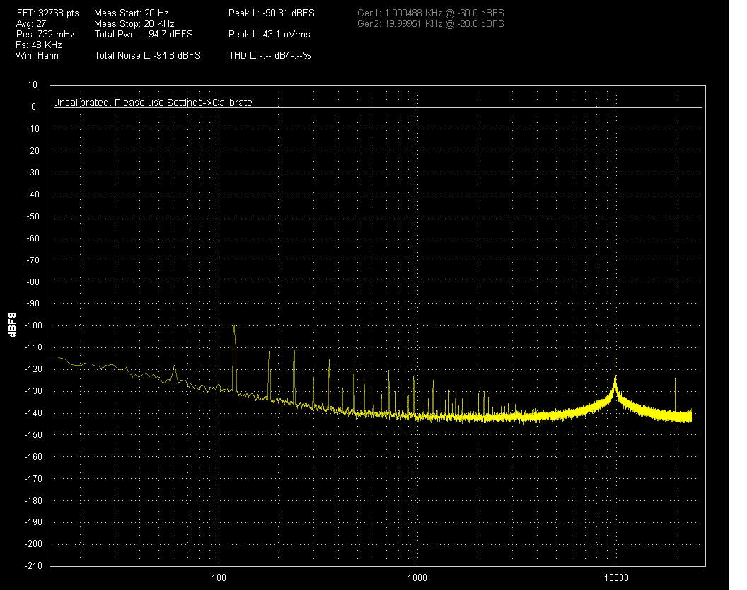

Next up -- 2- VCR2N in parallel and a trim in series with jFEts' source for nulling the H2. Thx-RNMarshThis is with two VCR2N in parallel.
The 5th and 3rd came down a bit.
This worsened the 10KHz. It would need to be trimmed separately.
It's almost to the point of having to trim each frequency for best.
