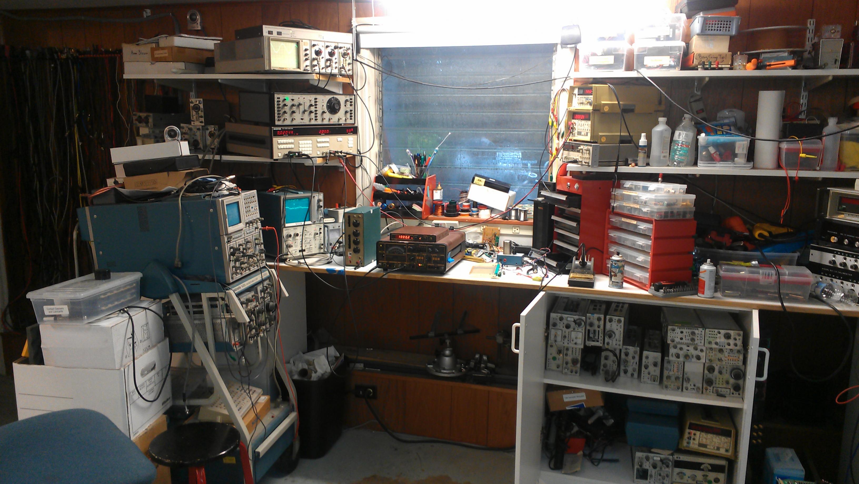

Touche! Guilty as charged. (But the plugins are under the bench and the spares are in storage). Here is a shot after getting Tim's (same as JC) help cleaning up. There are something like 18 7000 plugins visible.

Mmm,
Some samplers, a 7L5 and many more 🙂
I agree that these things are very handy. They are common over here, just not as much as in the us. And much more $$$ if it's a better mainframe or non standard plugins.
What's in the 3 plugin mainframe on the bench, a digitiser?
Nice shop Demian. But still you only have a square foot to work on.

There are 2 7L5's, the one in the cabinet has a tracking generator. The 3 bay box is a Wavetek/Rockland fft thing. It goes to 100 KHz but is only 8 bits. Fine for the output of the distortion analyzer however. It has been very useful. And there is both a TDR and a sampler/timebase (and a handful of plugins for those). This all started when I decided I could not trust what I hear or what the BS merchants of audio passed on. Then I could not trust the meters etc. (The calibration setup is in another part of the shop.) Its a slippery slope. Just get a QA400 and be happy. . .
