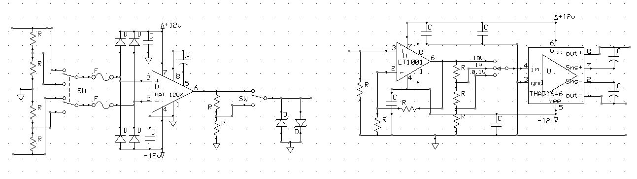

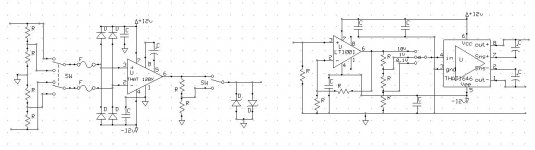

QA400 interface
Here is a sketch of what I'm working out. Its missing gain calibrations, common mode trims, output protection etc. It will give the general idea however. I'm using the THAT parts because they have a pretty high level of integration and take care of a bunch of precision resistors. I don't know yet if they will limit either the noise or distortion. Alternatives would be very interesting to look at. These are also available in DIP packages making them easier to deal with and, if socketed, easier to recover after mistakes.
Input protection uses small fuses (.062A fast blow). I may be able to simplify the output amp if the QA400 can drive a lower Z load without degradation. The opamp is a placeholder. Not figured out yet is power supply and possibly a local reference oscillator (1 KHz, light bulb stabilized, lockable from the QA400).

The THAT parts were suggested to me by Bill Whitlock of Jensen transformers. He said they would be a good option for the AP input stage. Until I get my hands on something I can't tell on way or the other. I suspect that for most audio work they will be more than good enough. The cluster of parts to do it with other circuitry gets huge. The similar input board for the Boonton is 4" X 12" with not much vacant real estate. Paralleling opamps to lower noise can work. On a Yamaha tuner I have they paralleled (without balancing resistors!!) two opamps on the same die and got a real 3 dB improvement. I don't know if that would work here. The biggest constraint is the input attenuator impedance. 10K for 100V RMS is 1W, which has impact both in the source loading and in the size of the components. Going smaller would not be an option I think. The industry standard is actually 100K.
Hi Demian,
All the resistor in the 339a input attenuator are 2 - 3 watts. The 339a input has to be able to blow the fuse with 300V without the resistor catching fire. I would think as an added bonus the resistors in that size would be more thermally stable because of the extra mass.
