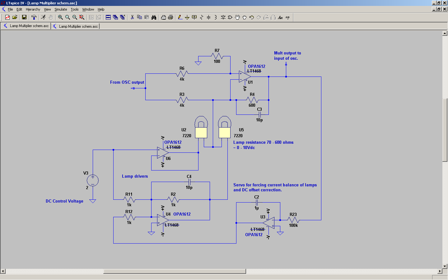

Here is the basic multiplier design.
The multiplier is designed around the lamps resistance curve because we have little control of this. R4 is chosen to center the gains and inverting crossover about the lamps curve.
R6 and R7 set the non inverting attenuation and R4 the inverting attenuation.
The multiplier operates below unity gain. Because the resistance values are low we can take advantage of using one of the ultra low noise op amps available. I chose the OPA1612 because of it's low noise current spec and outstanding distortion spec.
One obvious problem with injecting a DC control voltage or current into a lamp is the introduction of voltage offset appearing at the amplifier's output. Simply adding a blocking capacitor led to phase shift problems within the multiplier which interfered with the oscillator loop. Using two lamps as shown solves this problem. However it is near impossible to match two lamps well enough to keep the offset to a reasonable amount.
Because of this a DC servo loop is added to take care of the last remaining bit of imbalance. The servo forces the current in each lamp to balance, near eliminating
the offset at the multiplier's output. The lamp drivers are a balanced configuration and offer cancellation of ripple and other signals riding on the DC controls signal.
This cancellation takes place at the summing node of the lamps and depends on the current balance of the lamps. The lamp drivers see signal at their outputs through the lamps. Both noise and distortion can be reflected back through the lamps into the multiplier.
For this reason low noise low distortion op amps are chosen.
I have tried other lamps for stabilizing an SVO but the 7220 lamp seems to work best.
The multiplier has been tested with an SVO from 10Hz to 100KHz with a manually set DC voltage at the lamp driver input. I am still working on a suitable ACG for this multiplier. And I need to isolate the performance of the multiplier. I have still yet to determine the TC of the lamps. This is important to know to set an appropriate TC for an AGC. As far as I can tell the AGC TC will have to be ten times longer than the lamp TC.
The distortion performance of this multiplier with an SVO is really quite impressive and well worth the extra complexity of the driver circuitry.
There is more refinement for this multiplier that I haven't included here which has to do with linearizing, (not sure that's a word) the multiplier gain constant. But this is a matter of an additional stage and will be addressed separately.

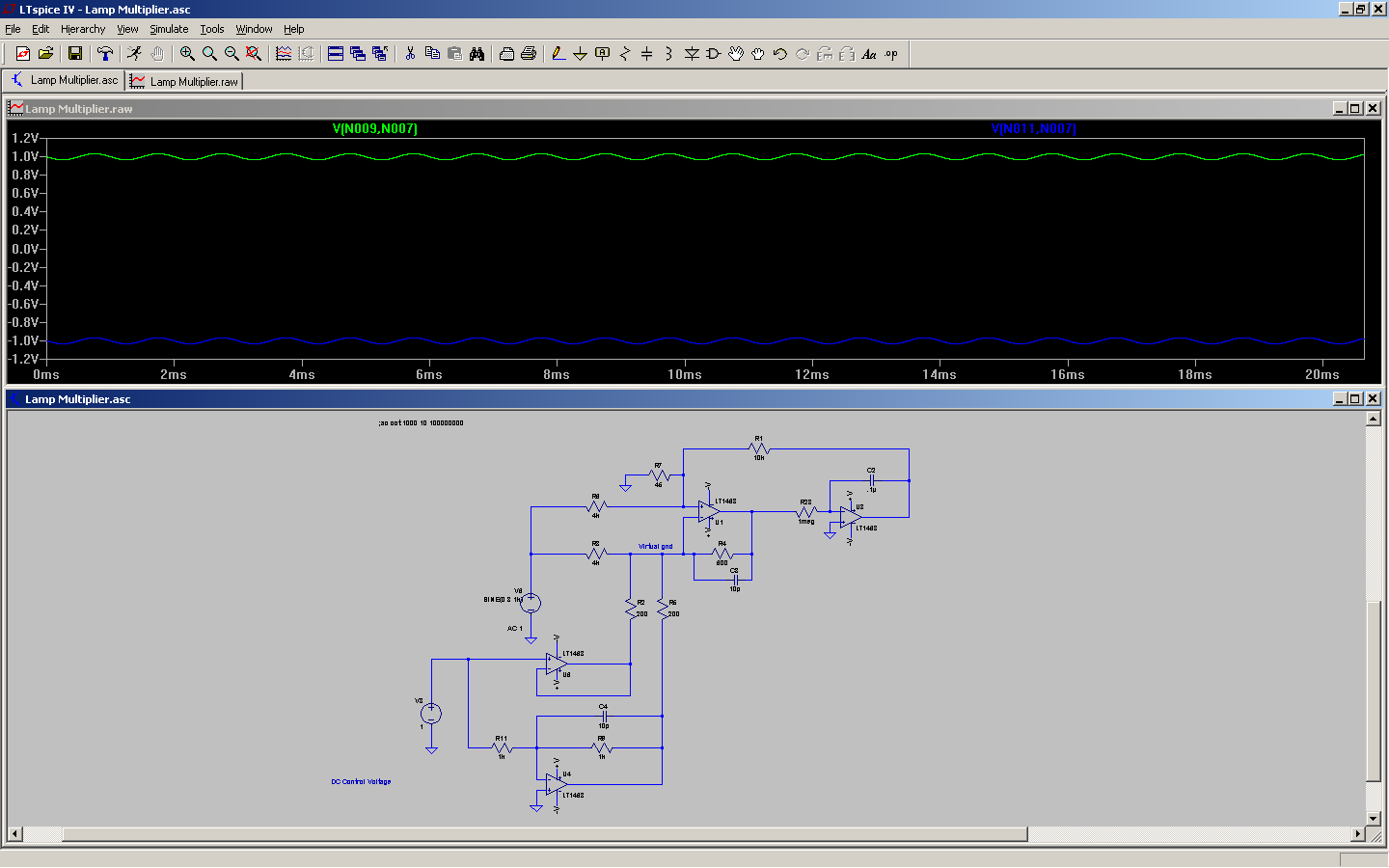

I've included a cheesy LTspice schematic and the plot of the lamp's curve.
The 7220 has a cold resistance of about 70 ohms.

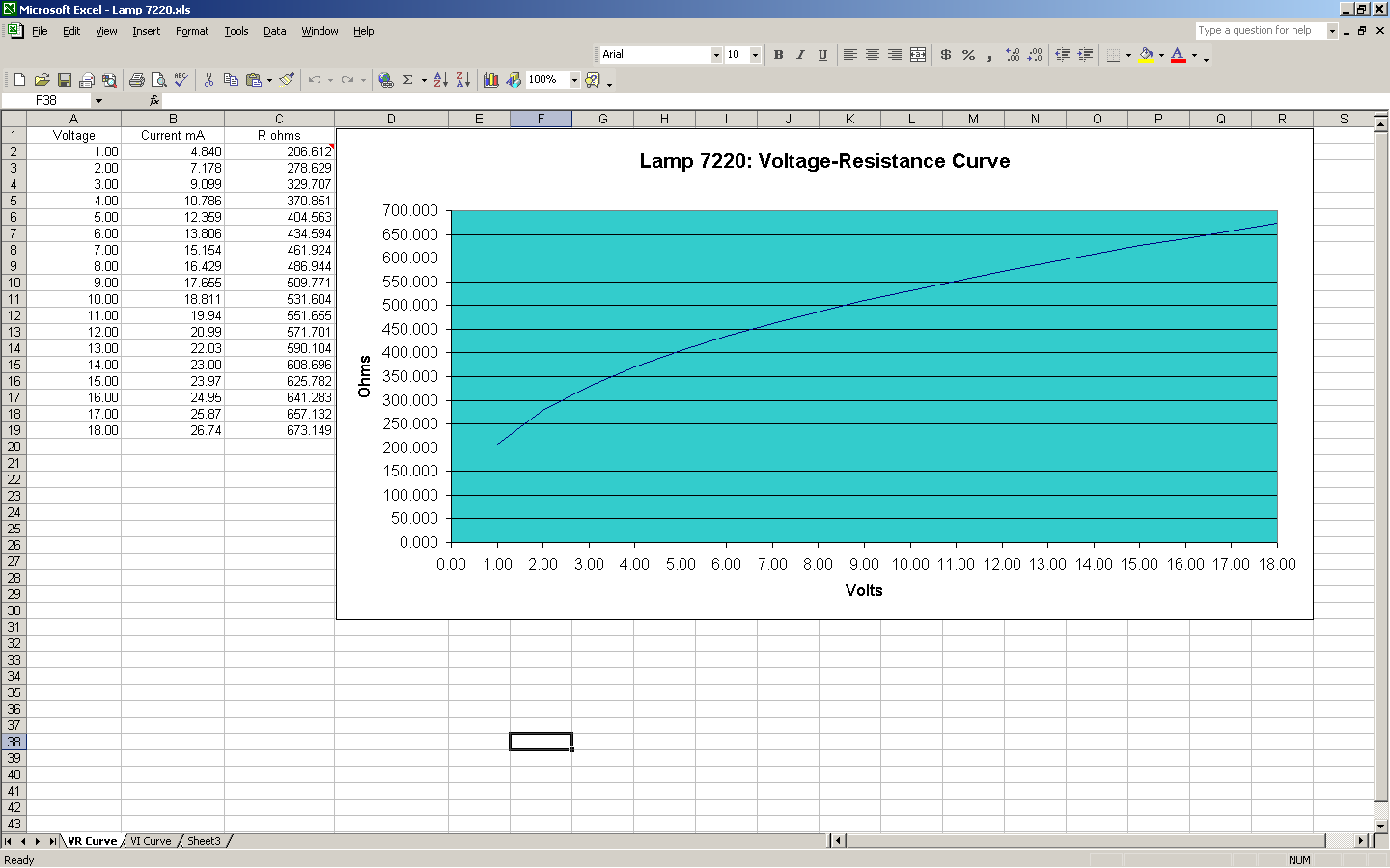

Lamp curves
Here is a zipped file of the xls.

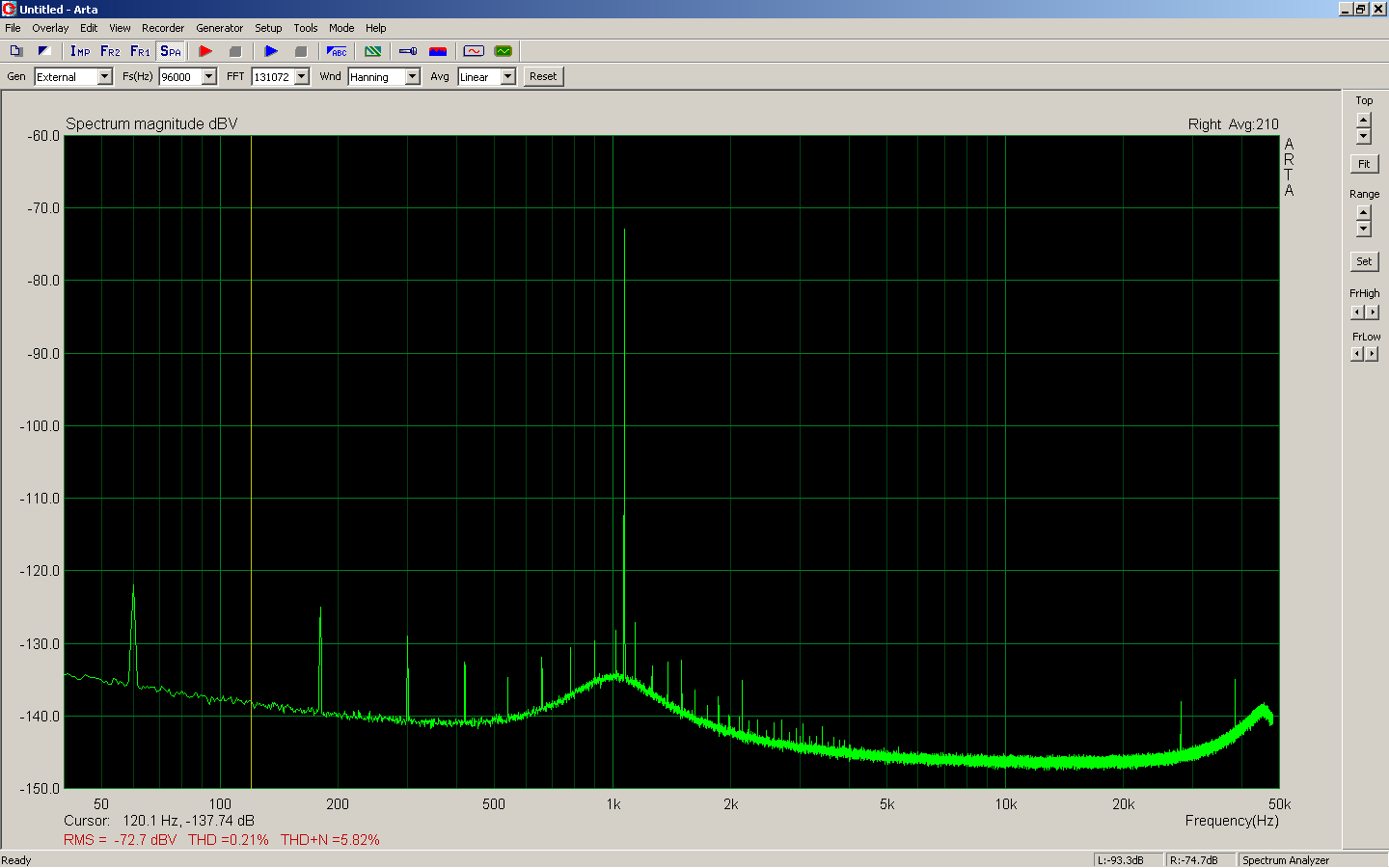

SVO with multiplier perfromance
Here is a screen shot I took back in March of this year.
Dick Moore loaned me his EMU0204 and Twin T notch filter to try out while he was on holiday for a couple of months. Okay he's retired so maybe not holiday.
A screen shot of the performance of the SVO at 6Vrms output, 1.072KHz and the multipler. Most of what you see in the spectra is power supply harmonics and some EMU junk. The input to the Twin T is attenuated to 1Vrms (0dBV) and the ARTA is calibrated to 0dBV 1Vrms, The output of the multiplier is at about 64mVrms.

This is a better way to return the servo. The servo decoupling resistor has to be included with and in parallel with R7.
If you mean to include the servo in the AGC there would be no way to balance the lamps as they would both be seeing the same error signal.
