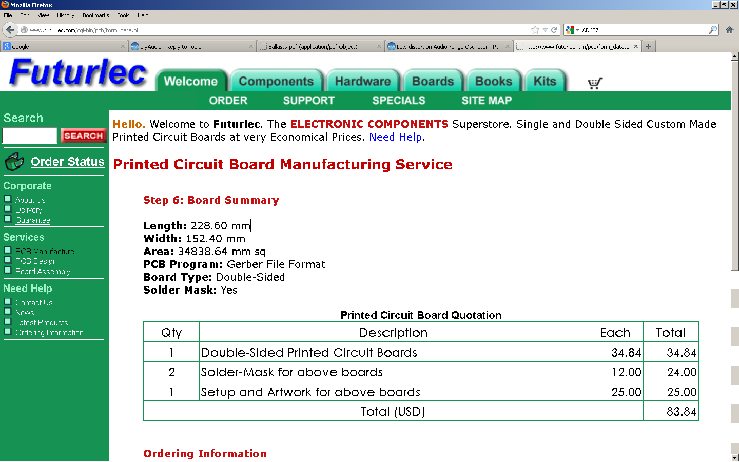

PCBs
This is the place I was referring to.
I see there setup charge has gone up.
Used to be $12.00.
This is a quote on 1 6x9" board double sided.
If the solder mask was left off it would be $24.00 cheaper.
I wonder then if it would be tinned?
For a development board it would be better to not have a mask.
Anyone heard of these guys?

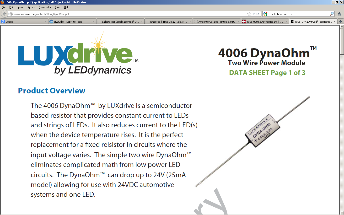

They look interesting but they are polarized and need .6V to turn on so they are most likely a semiconductor circuit. And no glow. .
The Ballast resistors date back to the early 20's.
The HP3400 and HP3403 use dual thermocouples to measure AC voltage. You need a chopper amp to measure the voltage off of the thermocouple. Seeing the price for a basic vacuum thermocouple I would leave them to the standards guys. I have an assortment but it took years to gather them. Except for NIST and a few obscure devices everyone has moved to digitizing for precision AC measurement so the market for these has really shrunk.
I can't find any of these ballast. The company was bought out and only make relays now.

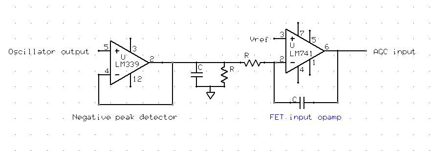

Attached is the simplest peak detector I could think up that would work. The LM339 is an open collector comparator. The input circuit is very like an opamp and what happens here is the the output follows the input until it goes positive. Since its open collector the output is then limited by the charge on the cap and the pull up resistor. Because its a moderately fast comparator the internal circuitry doesn't latch up or slow down when there is significant differential on the inputs. I have used this in several applications in the past and it worked well. And you have three more sections of the LM339 to do useful things with.
