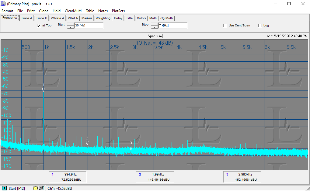

I switched to Praxis because I know how to "bend" it to display usefully. However the base noise level even with an additional 30 dB of low noise amplification (QA470) the harmonics are in the mud. This plot is uncorrected so there is an additional 10 dB of loss at HD2 and 3 at HD3. This still looks like it would not get to where I want to go.

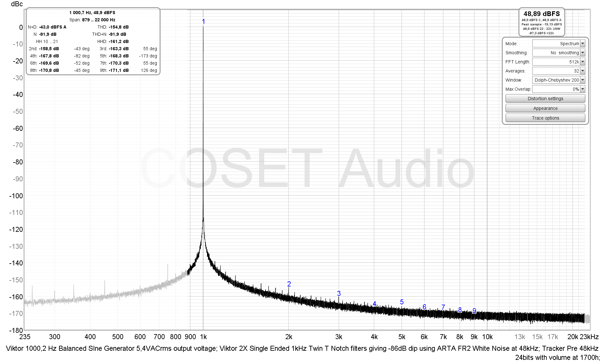

Viktor Sine wave generator V5 balanced and 2X Viktor SE notch filters
Using 2X (to get balanced operaation) of Viktor´s single ended notch filters with -85dB dip according to ARTA (white noise FR2) and Viktor´s sine wave generator V5 in balanced configuration 2,7Vrms SE, I get a bit lower distorsion compared to using my other Twin T balanced notch filter.
H2 = -158 dB
H3 = -163 dB
THD = -155 dB (H2..H21)
According to REW.
It might be that the FKP caps in Viktor´s notch filters give a little lower distorsion than the COG caps I use in my balanced notch.

How is the magnitude of the fundamental (48.89 dBFS) related to the "real" one (5.4Vrms, 14.7 dBV)? I.e. what is the full scale (dBFS) in Vrms (dBV)? in your measurement setup?

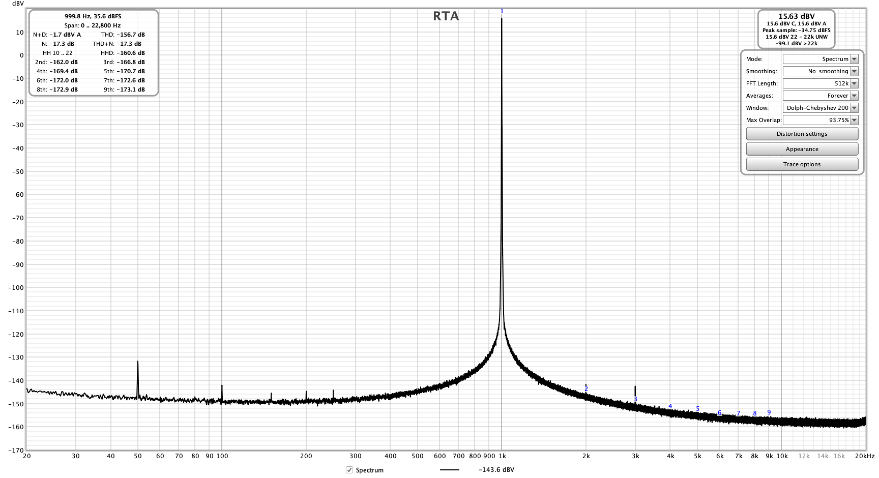

Extraordinary hack Jan:worship:
Works right away. I used a 680K resistor and BNC connection to the RTX generator output. My Victor is floating so BNC cold was connected to Victor gnd.
RTX output 0 dBV scale (1Vrms). REW generator set to -20 dBV (0.1Vrms), but as I'm using the SE output I guess I actually only apply 50mVrms.
The frequency snaps right to where I set it and remains there. When I turn of the generator it takes a few seconds before it returns to where it was. I did not try more than 0.5 Hz offset.
Distortion does not seem to suffer notably:)
