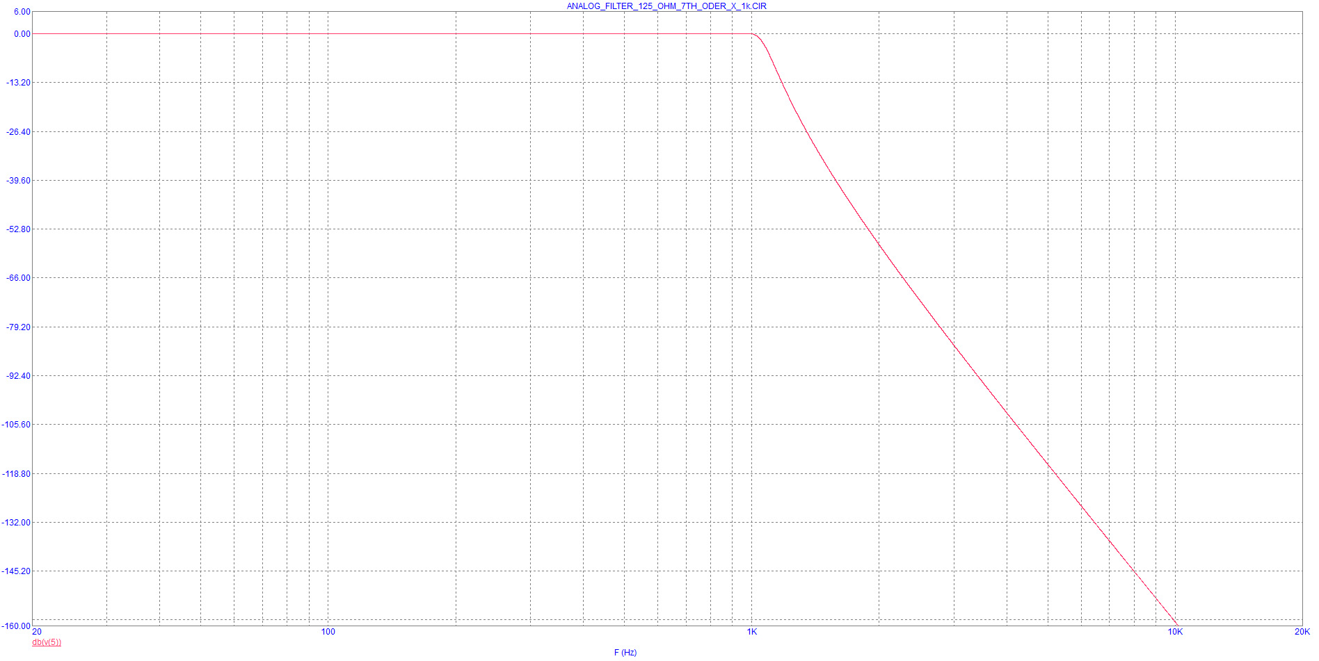

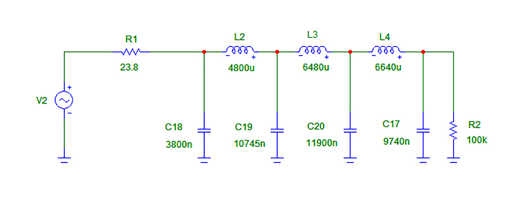

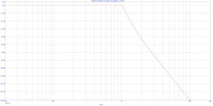

Hi all
After the pain of going through 900+ pages, I like to suggest a passive low impedance LC brickwall post filter for the 1kHz oscillator to further bring down harmonics and noise.
Connect the filter output directly to dut.
The schematic is the antialising filter of my DAC, scaled down to 1kHz.
Values of air coils and styroflex Cs should still be manageable.
2.2mH or 3.3mH in series for the big ones.

Hi all
In theory, this should work fine.
However, I worry about inductor nonlinearity introducing distortion that is bigger than that of the oscillator. The 3 V RMS operating level of the oscillator may be sufficient to drive the inductors into the slightest bit of nonlinearity in the sub-saturation region.
Distortion on the order of -140 to -150 dB is extraordinarily low.
The inductors might also have to be incredibly well-shielded to keep out hum and noise as well.
Bob

Do air inductors distort or go into saturation ?
3 x 2.2mH in series is only 1V per inductor.
I was thinking about LC to eliminate and avoid resistor noise.

Good point. I was thinking in terms of ferrite cored inductors or the like. The air core inductors might not be subject to such distortion, but I'm not sure how big they would need to be, offhand. The point about resistor noise is a good one. That, of course raises the issue of what the input impedance of the filter is, and what the loading is.
3.3mH is not big. Everything would go into a shoe box maybe.
R1 is the output resistance of the oscillator, in this case needs to be exactly 23.8 ohms for the filter to work correctly. Or output impedance of oscillator + R1 = 23.8 ohms.
Load impedance doesn`t matter as long as it is not to low.

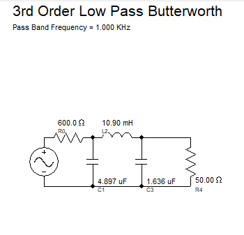

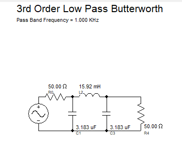

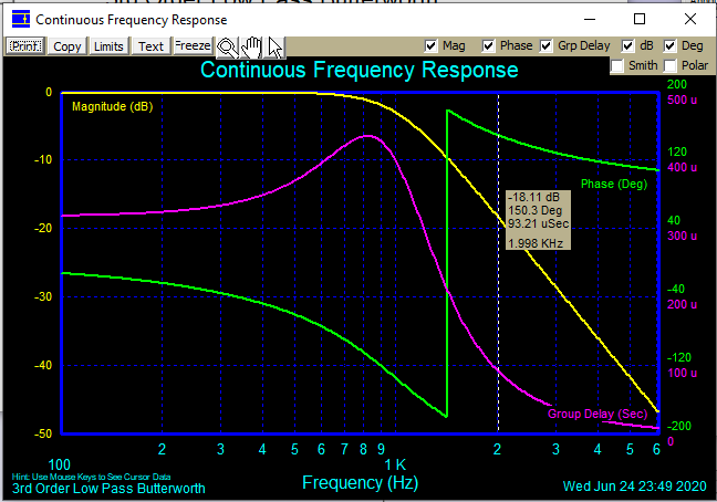

For 1 KHz 28 awg is close to optimum for an inductor. Litz Wire - Litz Design The form factor- diameter to length and the wire lay are both important to getting the max q. The inductors in the CLT-1 are pretty large for 10 KHz so 1 KHz may need to be quite large for optimum performance. Still it may be the best direction. I don't think you need more than 1 inductor and 2 caps to get 18 dB on H2 and 36 db on H3 with one inductor in a 50 Ohm system. I can rescale for 600 Ohms if there is interest. And then inductor design and finally inductor construction and be done with available online tools.
If you scale that to 6oo ohm, the inductor becomes 190 mH
