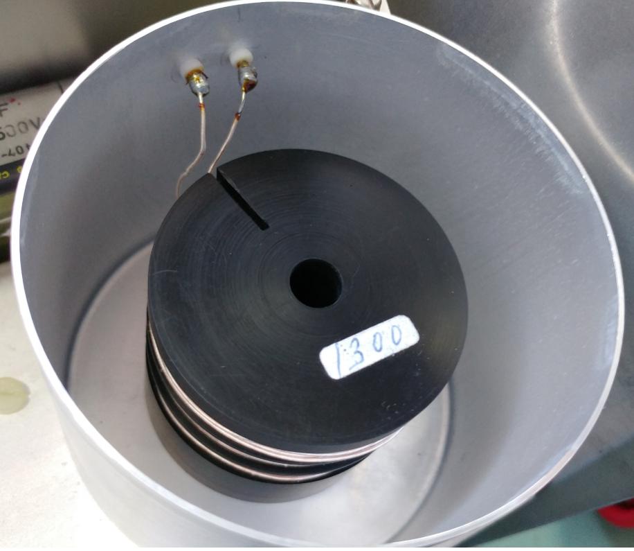

There were pictures of the filter from the super istrument in this thread, if they could do it, we can do it too.
I have a question fot the original uploader of that picture: Is this magnet wire as used in transformers, speaker coils ? Or does it have a thick insulaion like wire wrap ?

I'll pull it out again. I think its just solid conductor but I'll check. Keep in mind that's for 10 KHz so 1 KHz will be bigger in some ways.
Thanks, if it is to much trouble, not so important.
I was just curious if they used standard enameled wire, maybe silverplated wire, or something special.

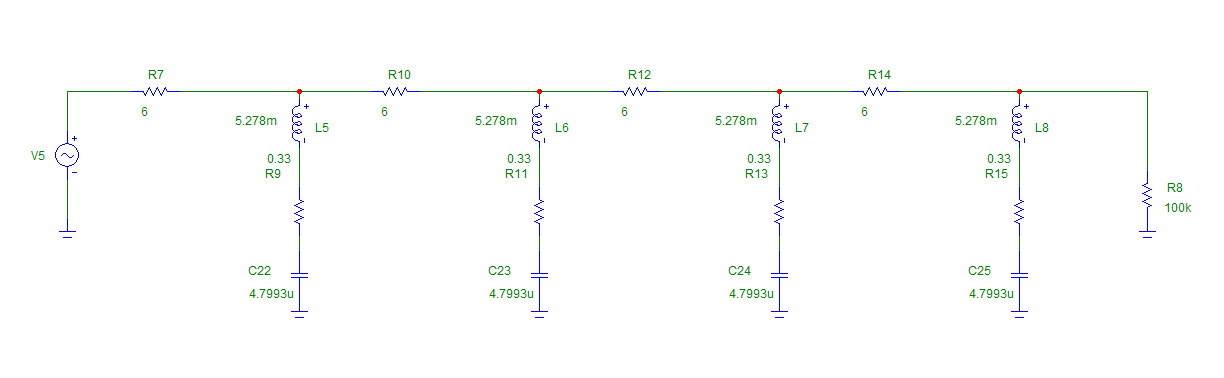

True, in particular in case of band-stop (or notch) filters.I have the feeling that a notch filter made of inductors causes more problems than it solves.
Now we are talking about passive band-pass (or low-pass) filters (in order to further bring down harmonics and noise). Not that easy without inductors.Why don't you stick to capacitors and resistors?
I assume that DIYralf was referring to active filters when he referred to sticking with R's and C's.
I agree with that, both for the case where the oscillator's performance is sought to be improved by a post bandpass or low-pass filter and where measurement if distortion is sought to be improved by a post notch filtering arrangement (which may include a passive twin-T).

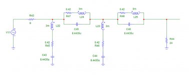

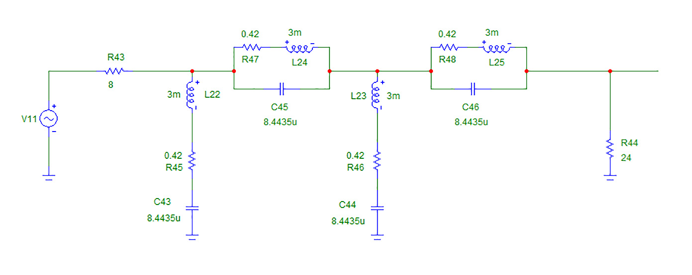

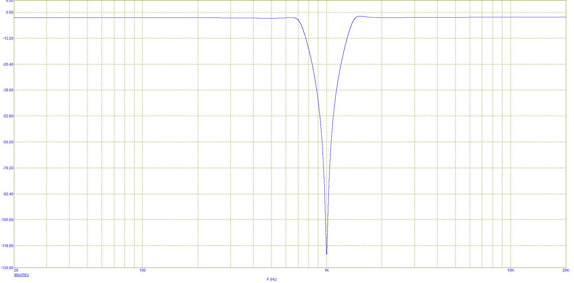

Quick variation with 2 shunt and 2 series inductors
L22, L24 clockwise, L23, L25 counterclockwise.
Same principle as balanced signal transmission.
Inductors of pairs mounted with 1cm space between them.

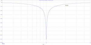

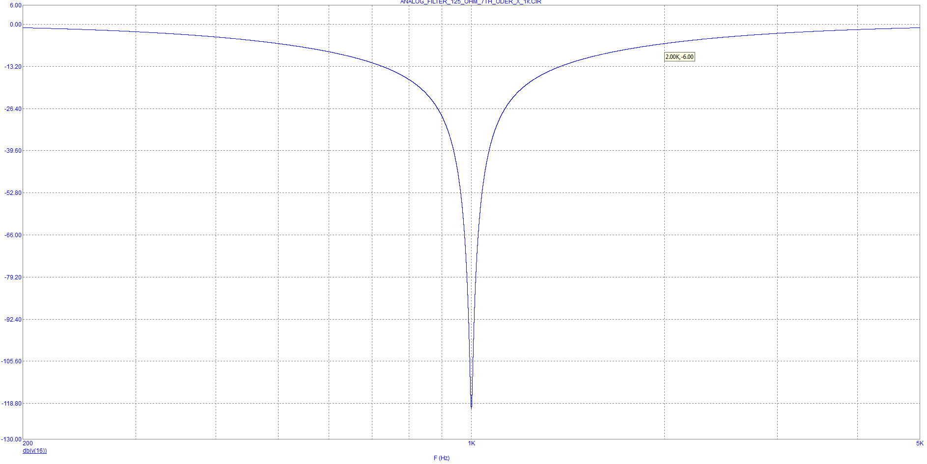

What is the required or ideal depth of the notch ?
If you want to add 40 dB to the dynamic range of the measurement setup, the depth of the notch should probably be at least 50 dB, better 60 dB.
In my setup, using a specially-designed notch, followed by a THD analyzer, followed by a spectrum analyzer, I designed the twin T to have a controlled, calibrated notch depth of 40 dB, even though the raw twin-T notch achieves at least 60 dB notch depth. A calibrated notch depth limitation in a twin-T is easily implemented by putting a parallel R-C in series with the twin-T's connection to ground. The time constant of that R-C should be the same as the time constant of the R and C of the twin-T arms so as not to alter the frequency of maximum depth.
The deliberately-limited notch depth allows a little bot of fundamental to get through, so as to enable the auto-tune circuits of the THD analyzer to lock onto the test signal.
Dynamic range of this arrangement was pretty much entirely limited by thermal noise from the passive twin-T up front and the noise of the oscillator under test. The noise floor in my setup was in the -150's. Twin T arm resistors were 10k. The FFT length and averaging was significant, but not unreasonable, using a QA-401. Lower impedance in the twin-T would lower the noise floor further if the DUT noise is not dominant. A longer FFT with more averaging could also be expected to lower the noise floor. These issues were discussed in an earlier post.
Bob
Bob
thanks, so either -40dB or as much as possible

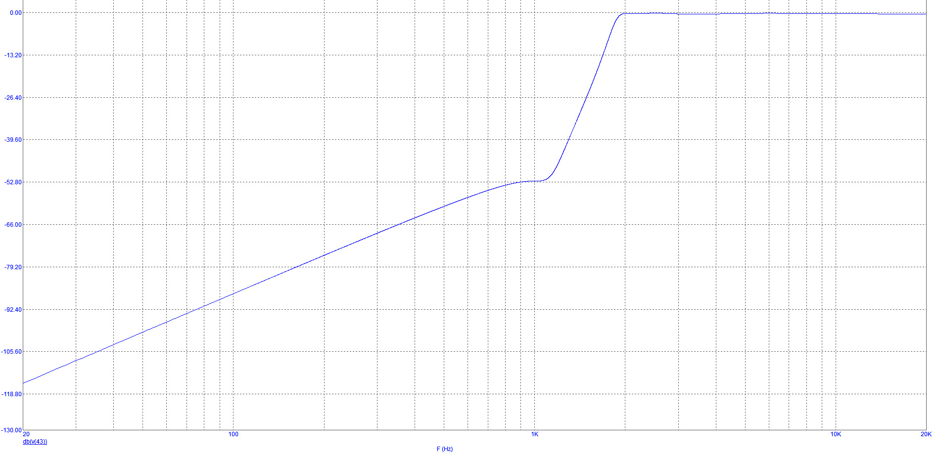

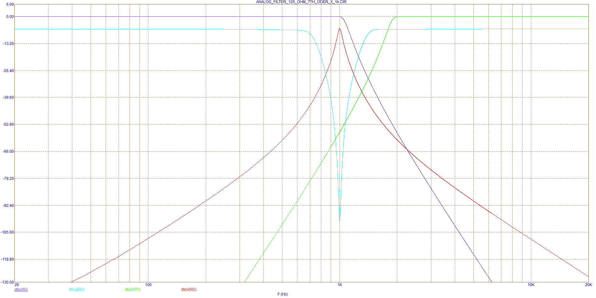

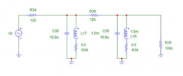

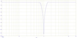

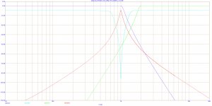

If anybody like to try, here is band pass for post osc filtering with 2 inductors, 1 should carry the signal in opposite direction, h2 -40dB, h3 -50 dB.
R34 is the total source impedance, so if the oscillator output is 50 ohms, R75 needs to be 75 ohms.
To scale for existing values of parts, divide all inductor values by n and multiply capacitor values by n.
Or vice versa.
I can not do tests now, need order inductors first, and all I have at the moment is 16bit fft.
Also I think the final filter should be terminated on both sides with low impedance to shunt the antennas
