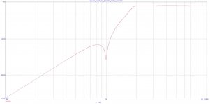

Available filter curves at the moment.
Lowpass more steep -75 dB at 1 kHz
Added 100 Hz notch by accident

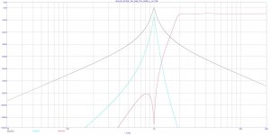

Evolution of the oscillator post filter...
Lowpass followed by bandpass. -110 dB for h2, -150 dB for h3 + hum rejection.
I think a single higher order bandpass would´t get there so easy, did not try yet.
Just put the existing filter in series, practically a less steep version with 2 inductors for lowpass and 2 for bandpass would be ok.

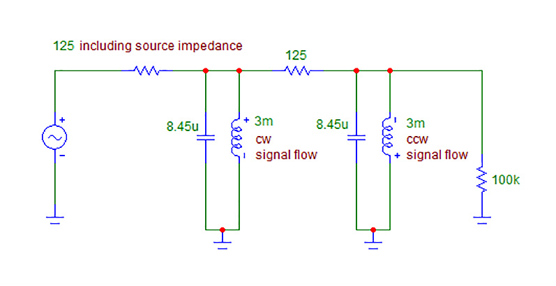

Now I remember seeing this earlier:
If a LC filter for example had 2 equal inductors in series, could the picked up hum be eliminated by having the signal going through the inductors 1 time clockwise and 1 time counterclockwise, inductors mounted side by side ?
This MAY cancel the hum, but putting the coils next to each other couples them together, making a transformer. These are no longer separate inductors, and any signal in one affects the other. This is going to substantially change the filter response and make it something other than intended.

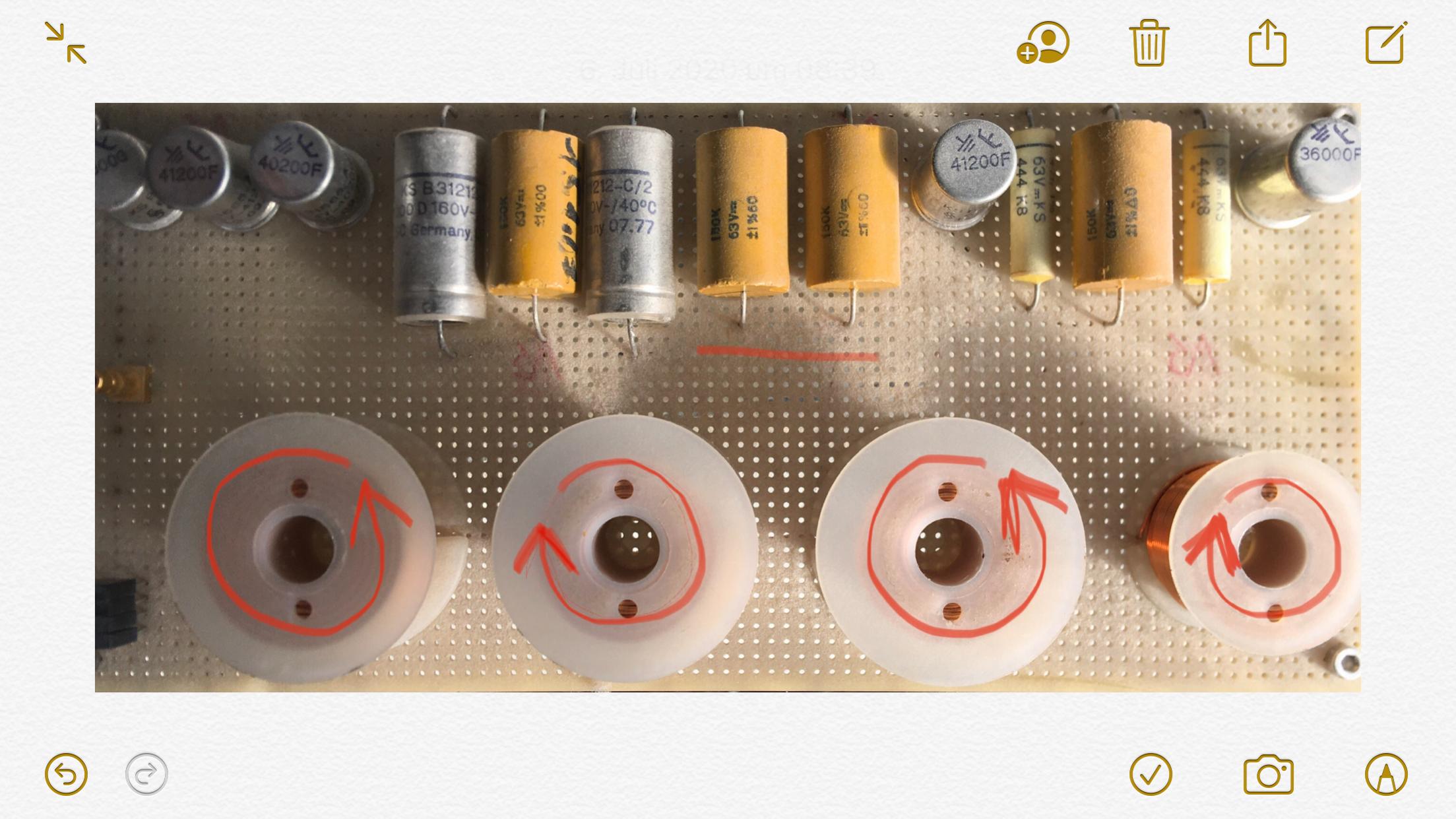

Air-core coils (or any coils not magnetically enclosed, like a toroid core) in a circuit are usually set with their axes at 90 degrees to each other, to reduce coupling as much as possible.
In the picture is my DAC lowpass filter, still has no box after 10 years and collecting dust... spacing between coils outer windings is 2 cm and the filter response is ok.
For outside the box testing or if shielding does not remove hum completely, I would try connecting the coils as the red arrows are showing in the picture.

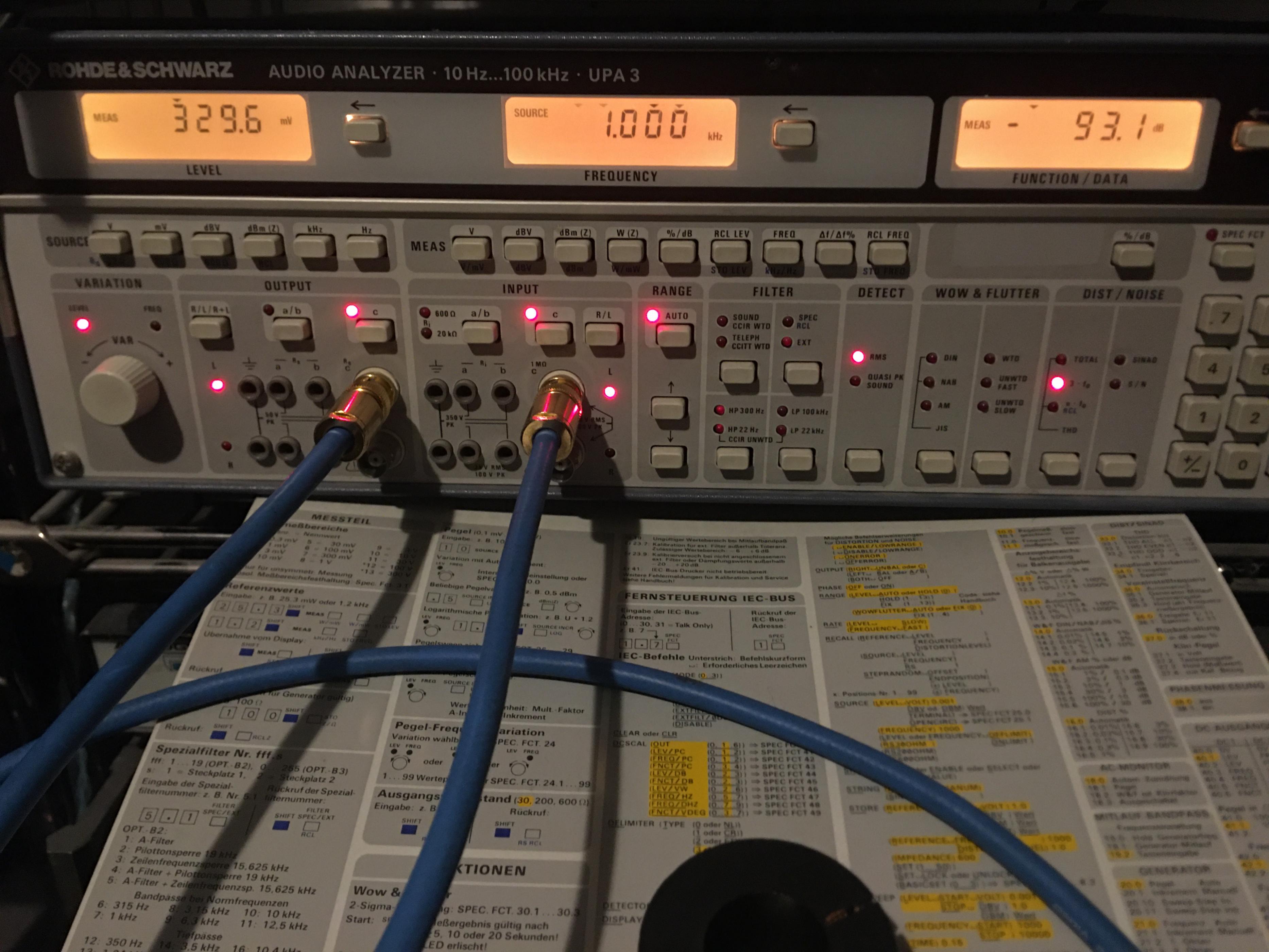

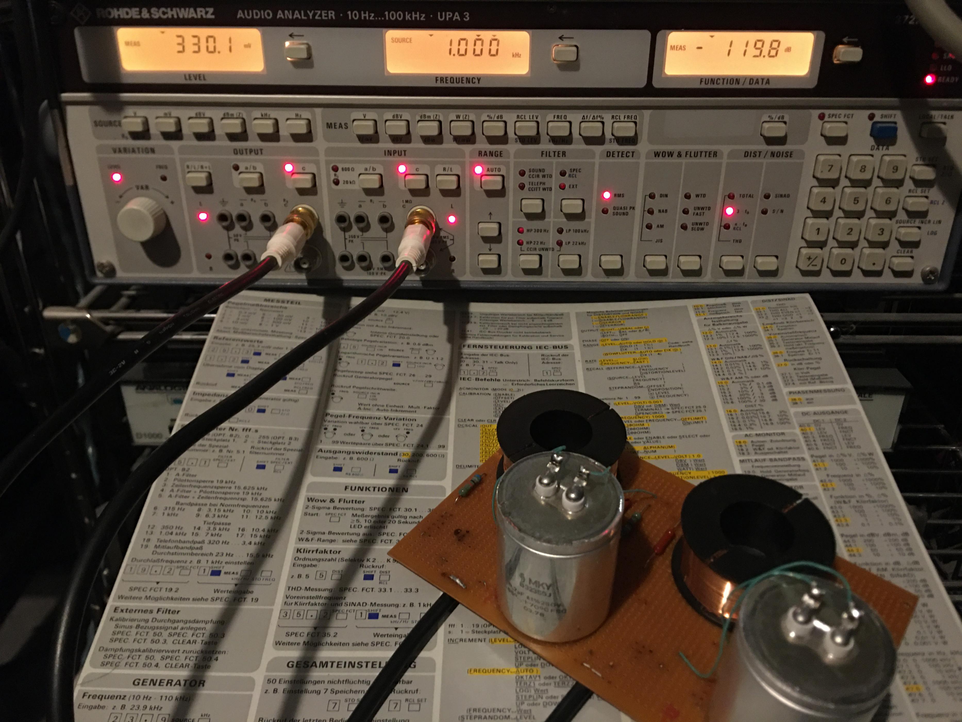

My analyzer‘s generator directly to THD input is around -93 dB
With simple 2-inductor bandpass (a few Hz off) is -115dB to underflow (> -120 dB)
THD display of this Analyzer gets unstable below -95dB
So, with the filter, distortion is at least 25dB better.

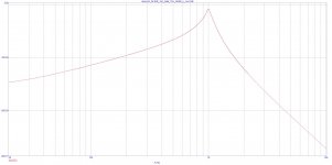

In Simulation h2 -30 dB, h3 -40 dB

Now I make this simple filter, report later.
