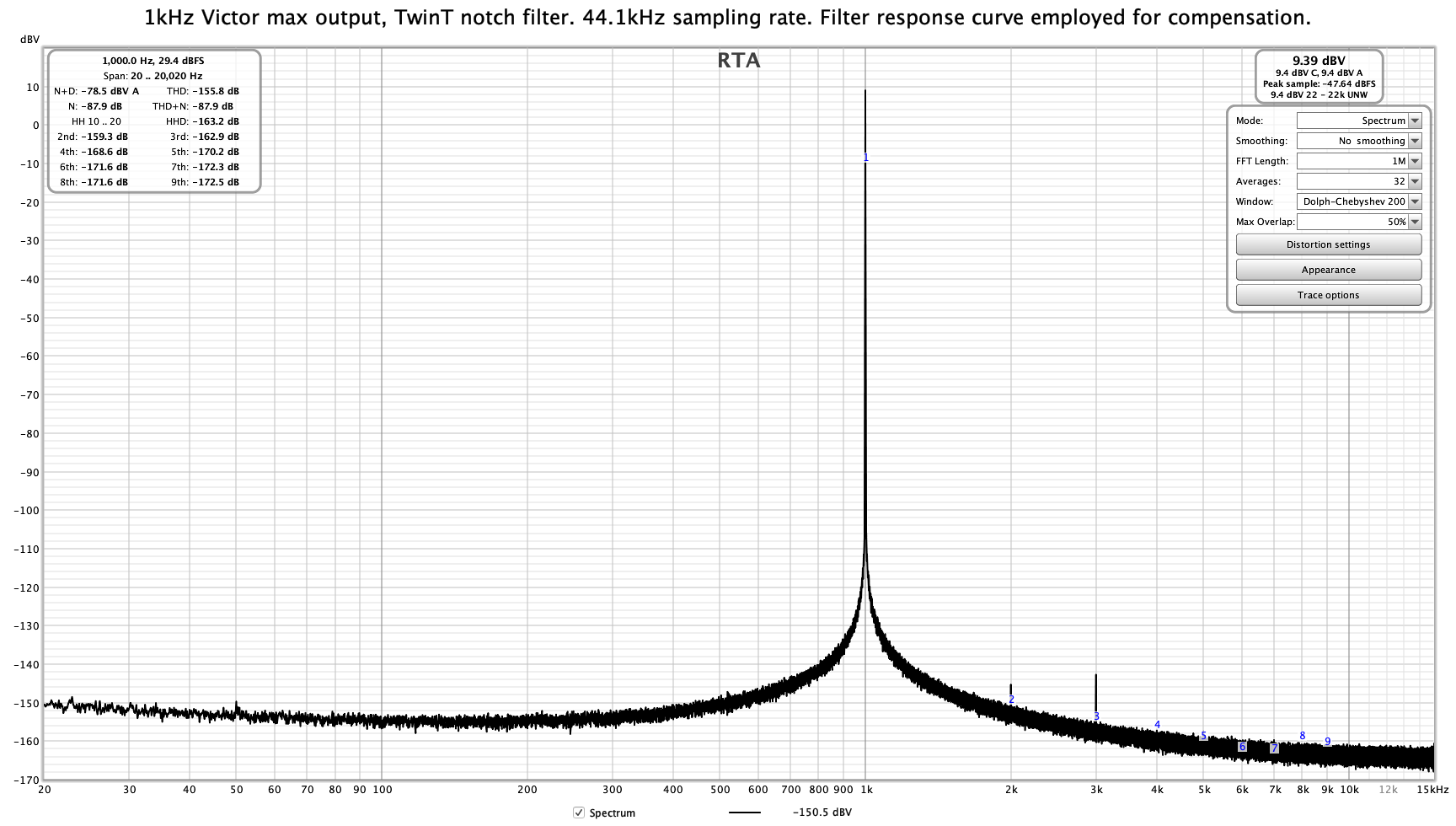

After messing around in REW I succeeded in generating the filter compensation file and employing it in the measurements. Looks good to me and the data are very consistent with what I measure/calculate without compensation.

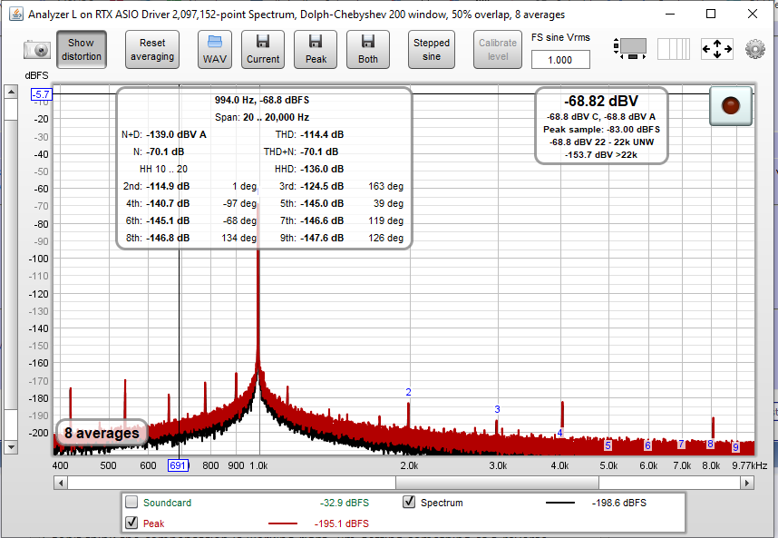

I don't think the compensation is working right. I'm getting something of a reverse nonsense on this loopback with the notch.
The harmonics of the output at -18 db should be in the -135 dB range or higher typically. This is reporting -114 H2 which is considerably higher than it should be. Something is not scaling. I used the soundcard selftest and converted that to a correction file but it still did not work it seems the notch is too narrow for tREW to catch it. it shows the phase transition but 20 dB insertion at 994 Hz. I measured 70 dB insertion loss using more conventional instrumentation. I retried the cal routine and got the same -20 dB on the cal sweep even though the reference comes in at -50.
Demian, John posted some tips. After you get the filter response, you need to uncheck the 'limit max boost to 20dB' check box on the Cal tab in the Measurements screen. Also you need to normalise the filter curve you want to use as cal file to zero dB, but I forgot where that was.
Then do again a loopback response using the cal file and if all is well the result should be a flat line.

Spend some time over at the REW thread. Managed (with the help of John M) to use the response curve of the twin tee as the eq file for the measurements. Two advantages: automatically take into account the attenuation of the harmonics by the twin tee, and restore the fundamental to its original level.
Great software, check it out! This is the Viktor, 3kHz at 2V out. The numbers are in the left hand corner.
But it takes a lot of averages to get the noise low enough ...
What I have to wrap my head around is the various different numbers in that screen (and I have them too, it's not your problem).
Left top says: 29.4 dBFS, 2nd -159.3
right top: 9.39dBV
the fundamental in the graph is ~9.4dBV
the 2nd in the graph is ~-145dBV
So when I add the fundamental level to the 2nd I get ~-154.4 . How does that jive with the -159.3 in the top left? And what does that 29.4dBFS top left mean?
Jan

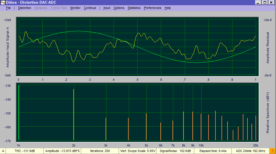

I would like to believe this is an accurate measurement of Victor's oscillator. Nevertheless there are several steps here I'm not so confident of. The process of characterizing the notch and also corrections for different gain settings on the RTX I'm very unsure of at this stage. E.G. if I increase the gain on the test channel to make up for the insertion loss DiAna gets very confused so maybe its too soon to go that far.
I'm also getting rather confusing results at different gain setting of the ADC. I think it has something to do not only with "analog" noise, but also with quantization noise from the ADC. I have to investigate this further,
Also in the hour or so I was doing this my victor drifted from 994 Hz to 995 Hz and DiAna correctly rejected the existing notch filter setting.
So some tracking mechanism would be an unnecessary luxury (I'm working on that too).
right top: 9.39dBV
Jan
It took me a long time understand all those numbers, but I think I worked it out.
All the values recorded and used by REW for distortion calculations are inside the distortion box (upper left). The unit used here is dBFS as this is the unit of the data coming from the RTX.
In the graph main window you can choose what Y-axis unit to use, but you will need to tell REW the scaling factor for it to display correctly. The scaling factor for dBV is the number you insert in the "FS sine Vrms" box. In my case I have here inserted 0.1V as I had the RTX input scale set to -20dBV. This is also why you see 29.4 dBFS in the distortion box (upper left) and 9.39 dBV in the graph window (upper right). The difference is the scaling you entered in the "FS sine Vrms" field. You can enter whatever you want in this field and the distortion calculations remain the same. Only the graph and the upper right number (magnitude of fundamental in dBV) changes.
In the measurement I showed REW tells me that the magnitude of the fundamental is 9.39 dBV, but this is not really true. It is 14.5dBV (full output from victor).
I can correct this manually (which would make the distortion data some 5 dB better:)), but at least for me this is not a good solution as the hole point of the filter calibration response correction is to get reliable data without having to do post hoc calculations.
I have one idea how one might make it work. If I deliberately offset the oscillator frequency from the notch centre by a couple of Hz I should still have sufficient attenuation of the fundamental (some 55-60 dB). At this frequency, however, the notch curve is much less steep and I would expect the filter compensation to be more accurate and reliable.

The way I used to do it on the AP was setting the Y-scale to dBr, and setting the dBr ref to the level of the fundamental (which I know of course) corrected for the harmonic attenuation, which is 8dB for the 2nd.
So with a 2V (+2dBV) fundamental I would set the dBr ref to 8 dB lower, to -2dBV.
I was hoping that now in REW we can correct exactly for the notch curve, this would be easier. It might be, but I'm not looking through it yet.
BTW I am pretty sure that REW does a perfect job in correcting for the notch. You can easily check that by doing a loopback with the notch between output and input, using the same notch cal file. With the correction you should get a perfect flat response - I did!
