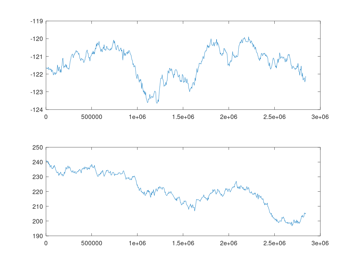

This is output from a simple octave script calculating 655360-long FFTs on blocks starting every 5000 samples, getting fundamental amplitude and phase time-aligned to the first FFT. Analyzed first 3.5mil samples from the original file sent by Jan, avoiding the 12kHz-noisy end of the file.
The first chart is amplitude per FFT offset in the file.
The second chart is phase per FFT offset in the file.
The amplitude deviates, the phase deviates. I can imagine this being caused by the two analog notch filters in the measurement path - a slight change in notch frequency in any of the filters will change the amplitude and phase shift.
That makes sense, they are not in the loop. I get all the same results that everyone else got with averaging the magnitude only. I was just wondering that if the vector averaging worked the noise floor can be averaged to its mean (0) rather than the rms, sort of like a lock-in amplifier. Wishful thinking.

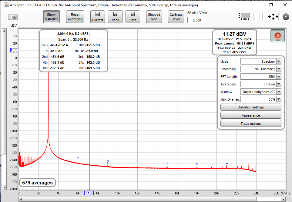

Spend some time over at the REW thread. Managed (with the help of John M) to use the response curve of the twin tee as the eq file for the measurements. Two advantages: automatically take into account the attenuation of the harmonics by the twin tee, and restore the fundamental to its original level.
Great software, check it out! This is the Viktor, 3kHz at 2V out. The numbers are in the left hand corner.
But it takes a lot of averages to get the noise low enough ...

Jan, I don't understand why you have entered 2.000 in the "FS sine Vrms" box in REW.
I believe that you should here enter the input range that you are using on the RTX.
The distortion calculations will be the same, but I believe the dBV Y-axis scale will be incorrect if you don't do so.

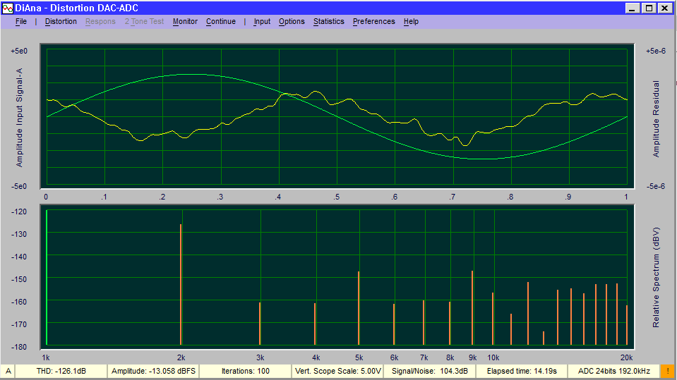

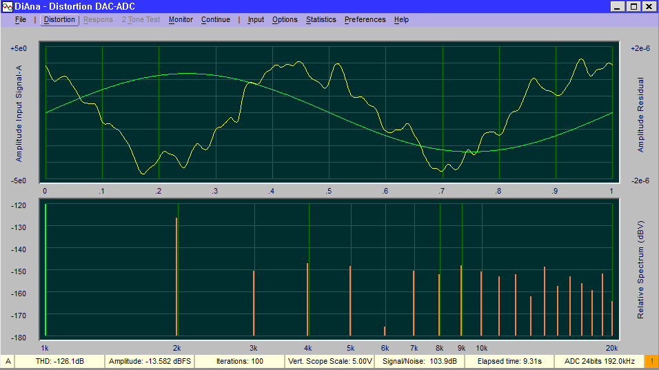

Here is the kind of headache that makes ultra low distortion measurements so difficult. This is two measurements, Victor into RTX. The only difference is the cable. One is much longer 10' conventional shielded coax. The other a shielded two conductor cable maybe 3' long. The longer cable consistantly shows lower HD3 and HD4. I don't think its a capacitive roll off that gets an additional 10 dB. However there could well be some phase shift that cooperates with the internal distortion of the RTX ADC.

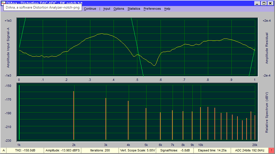

I would like to believe this is an accurate measurement of Victor's oscillator. Nevertheless there are several steps here I'm not so confident of. The process of characterizing the notch and also corrections for different gain settings on the RTX I'm very unsure of at this stage. E.G. if I increase the gain on the test channel to make up for the insertion loss DiAna gets very confused so maybe its too soon to go that far.
Also in the hour or so I was doing this my victor drifted from 994 Hz to 995 Hz and DiAna correctly rejected the existing notch filter setting.

I would check the connector, if the connection is not soldered. After connecting/disconnecting 10 times maybe the measurement will be slightly or more than slightly different. I do a similar ritual every day with cables between the adapter and sound card before working on the distortion compensation - after that the spectrum stays stable. A soldered joint would provide much longer-term reliability in keeping THD < 130dB (i.e. all harmonics below -140dB to fundamental).
I'll open the box and add the sync next. (or sync X 3 for the three oscillators) The cable thing was pretty consistent across multiple cables and setups. I still like the last measurement number, I just hope its reasonably correct.
