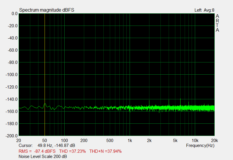

- if you feed osc with battery power, does it have the same amount of low frequency (150, 250, 350 Hz etc) noise?
It is on battery power. I am pretty sure those mains spikes are from the RTX, they typically look like spurs from rectifying process, what with the higher harmonics.
A simple mains incursion would be 50Hz, maybe also 100Hz, and not much more.
Jan
Looks a bit dirty. Here is my usual Asus Xonar Essence RTX (on PC, powered from ATX) for comparison (input of cable is shorted):
From the REW help file:
"A dBc Y axis option is offered which places the peak level of the input at 0 dBc, or places the peak of the fundamental at 0 dBc when the distortion panel is active."
Clear as crystal?
