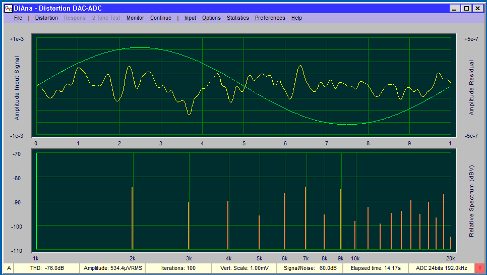

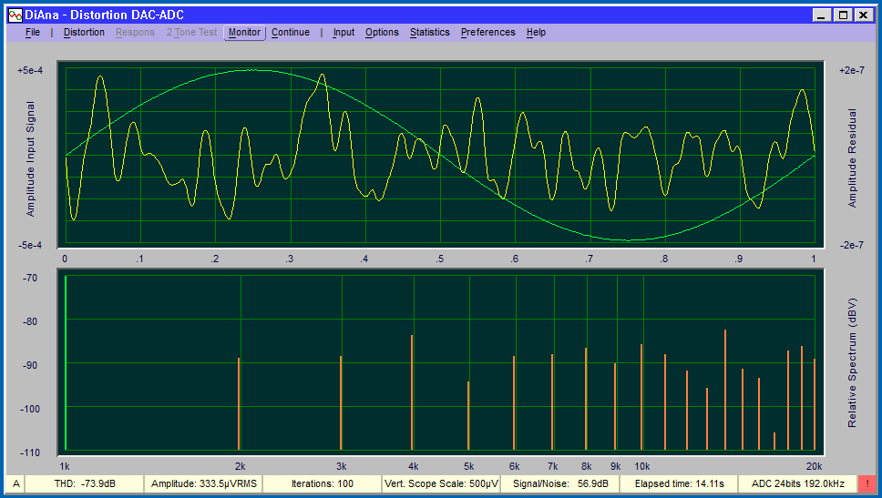

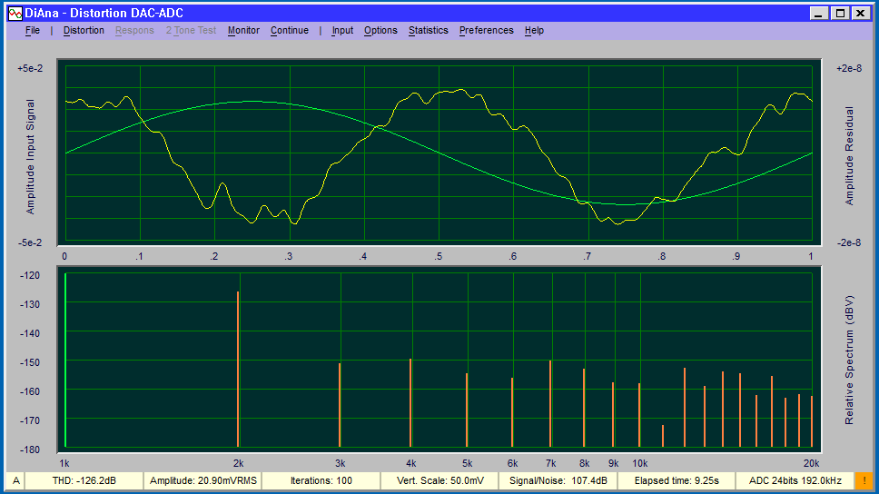

Here are some measurements of my first gen Victor oscillator. I has the original LME49720 and none of the more recent tweaks.
This is using ta Victor oscillator (first gen) + B&K 1607 tunable notch filter + RTX. The first measurement is direct into the RTX at a pretty optimal level and indicative of what you can get with possibly the best ADC implementation today. The second is with the B&K notch which has a 70 dB insertion loss at the fundamental (994.38Hz) 10 dB at 1994 Hz and 6 dB at 2988 Hz. in the "frequency" mode. In the "distortion" mode its 74 dB at the fundamental 21 dB at 1994 20.5 dB at 2988 KHz.
For the frequency mode you need to add 70 dB + correction for the harmonics, for the distortion mode you are within 2 dB by just adding 54 dB.
DiAna does a great job of avoiding noise and spuriii which there will be a lot of below -140 dB. The signal in to the RTX was at 500 uV approx.

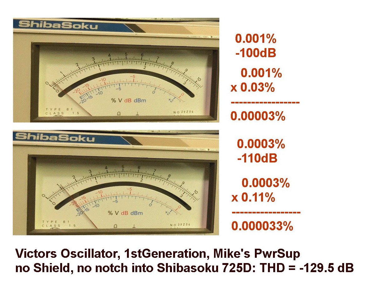

Hi Demian,
That's alright. My 1st gen Victor's oscillator THD is -129.5
as best as I can determine. No shielding, no notch, open
frame with Mikey's power supply. There is no difference
that I can determine yet between Mikey's board with
capacitor multiplier with 2 resistors or diode FET.
Here are my last measurements for confirmation:
