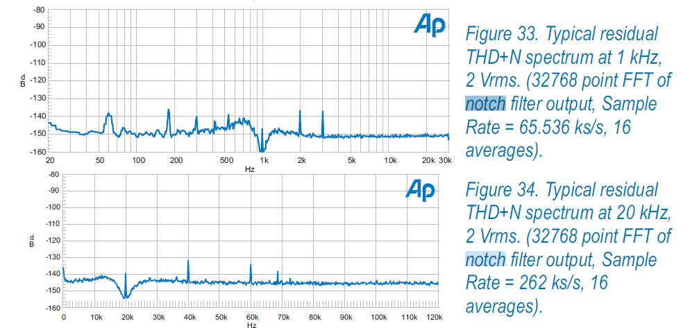

Lets do some mental calculations then, I also want to understand it. Start with 1V to keep it simple. Through the twin-tee gets you -50dBV.
Next, the AP autoranger applies say 60dB gain, which it remembers as a correction to be applied later. The fundamental signal is now 3V.
Next comes the AP notch filter. I don't know it's performance, but let us say -110dB; that seems a reasonable assumption looking at many 'normal' AP 2722 spectra. That puts the fundamental at 10uV.
I have set the reference to -2dBV. 10uV is -110dBV or, -108dB below the reference -2dBV. Correct by the 60dB internal gain puts it at -168dBV.
Have I got that right?
Edit: that notch is even better apparently ..
Here are the parts of the scheme I was looking for 🙂 Thanks.

That -170dBr is referred to a certain number. It does not mean that there has been a -170dB calculation. See my post above.
But if you want you can calculate how much (little) -170dB is; your Windows calculator can do that {10^(-170/20)}. Then you know how many digits are needed.
