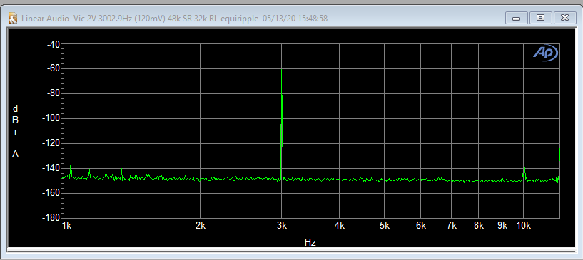

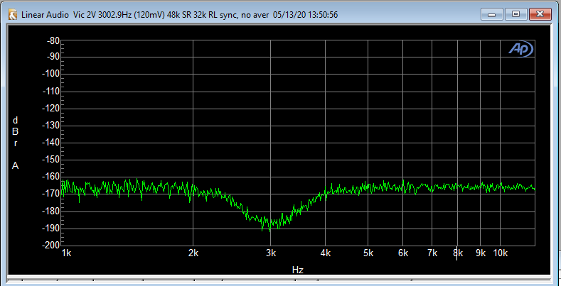

I can't leave well enough alone ...
My previous-best was with the synced Vic oscillator (3kHz), no window, move-to-bin-center.
What I did now was to slightly change the nominal 3kHz Vic oscillator I have to make it synchronous to the FFT to avoid the whole move to bin center processing and still not needing to use a window. I can do that now that I can sync Vic (not Vic, his oscillator ;-) to the AP digital generator.
Calculated what the nearest frequency is to 3kHz that will be synchronous when I sample at 48kHz, 32,768 FFT samples record length. Each sample has 1/48,000 = 20.83uS, and each 32,768k samples record thus takes 0.68267 seconds. Which freq closest to 3kHz will fit an integer # of cycles in this period?
204 cycles @ 2988.3Hz
205 cycles @ 3002.9Hz
206 cycles @ 3017.6Hz
... so pulling the oscillator to 3002.9Hz seemed the way to go.
This gave the attached curve, even lower than before, and still no trace of harmonics. Using the 'Sync' setting on the FFT processor means I cannot do averaging so the noise is more ragged than before, but clearly lower.
Vic where are your harmonics??
Jan
You basically see the fundamental attenuated by the external twin-tee notch.
Edit: sorry, this was without Vic syncing, new attached. 8 averages.
Jan
Jan
