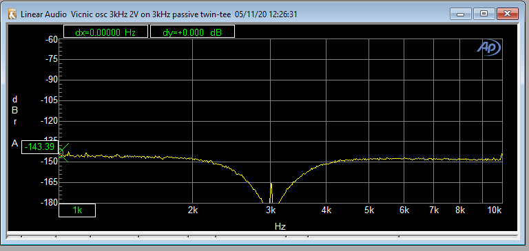

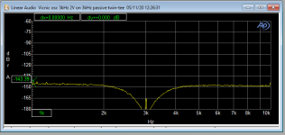

Mounted the latest Vicnic 3kHz osc. in a Hammond diecast alu box with a SilentSwitcher. Measured through a 3kHz twin-tee, 64 averages.
I don't know how you do this Viktor, but it is exceptional!

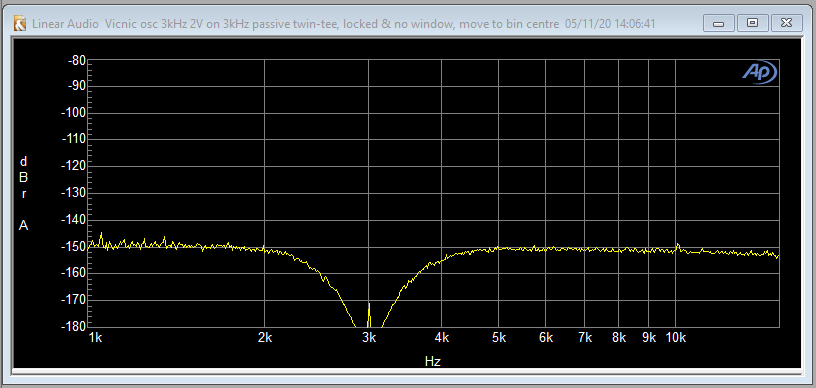

Next issue: trying to synchronize Viktors oscillator to a stable ref oscillator.
I have no clear picture where I should inject a locking signal, see attached Viktor's oscillator.
I haphazardly injected a signal that was a few Hz off the oscillator frequency at pin 2 of IC2, through a very large (0.5M) resistor, but all that does is cause a beat on the amplitude with the difference frequency ...
Any ideas?
Jan
My mistake, I should have injected it at pin 6 of IC2 of course. And then it works beautifully! Vic's oscillator, on itself, runs at around 3003.xx Hz, and drifts a few Hz from turn-on cold. With an injection of 3kHz at 200mV through 560k into pin 6, it snaps to exact 2999.99 Hz, rock-stable from the AP digital oscillator.
There is a fraction of a second re-stabilisation of the level when you turn the injection on or off, but the level returns to exactly the same in each case.
Distortion measurements give the same results as shown above, I don't see any harmonics above -148dBr or so.
The sweet spot seems to be between 150mV and 350mV injection through 560k, going too high starts 3rd harmonic to peek up, going too low shows a very low level 2nd and 3rd (-144dBr) until it looses lock.
Very nice - I now have a locked oscillator and can start to look into synchronous no-window FFT!
