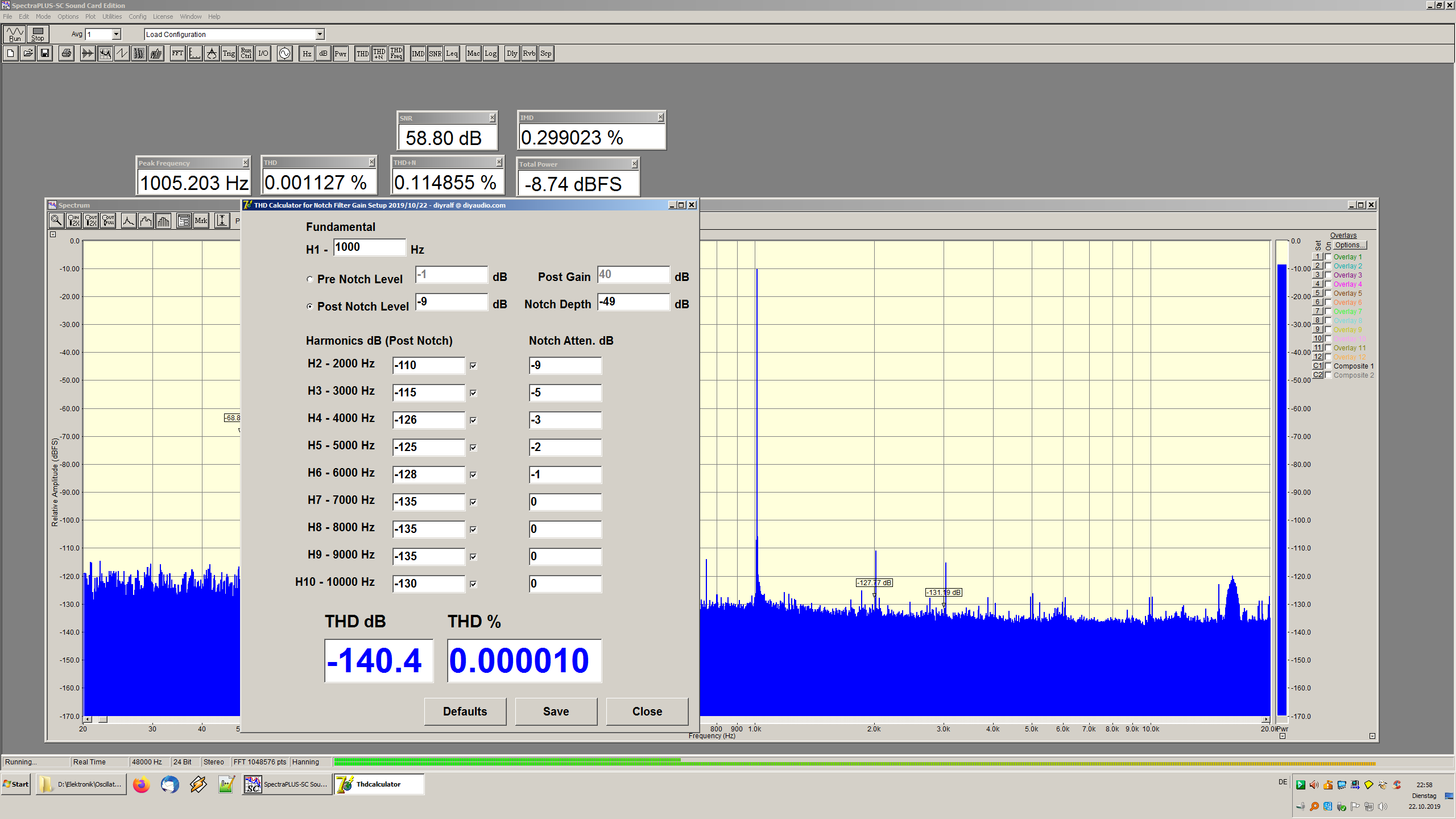

With my new tool, I finally measured my oscillator. Note the balanced output 🙂
Good point. dBc refers to power (spectrum analyzer), dBr to voltage and power. At the end of the day everything is dB. I'd rather say it's dBFS, because the values are read from a digital domain, namely the analyzer SW.
What I mean is that 'dB' is a ratio. -100dB means a factor 10^-5 ratio between two quantities. That means that -100dB H2 is not very meaningful in itself unless it is refereed to the fundamental, at which point it becomes dBc - 2nd harmonic referred to the carrier (= fundamental).
So if your gadged shows a fundamental of -10dB, and an H2 of -100dB, does that then imply that the difference between fundamental and H2 is 90dB? Then you should say, H2 = -90dBc.
If you want to use dBFS, then what is the FS level? If H2 is -100dBFS, and your fundamental level is at -10dBFS, we know that H2 is 90dB below the fundamental. So again H2 = -90dBc, and if you say H2 = -100dBFS you imply that the carrier is at 0dBFS but that would conflict with your entry that fundamental = -10dBFS.
dB is an easy way to express things, but being a ratio, you need two parameters to make it meaningful.
Corollary: an easy way to 'fudge' your data with an AP or other analyzer is to show the distortion graph and then change the fundamental reference from 1V to 10V and presto! your distortion graph drops by 20dB. Sometimes you see people here trying that to show their stuff has -150dB distortion ;-) . The giveaway is that the top of the graph usually is hidden.

@Jan.Didden re post 7797
Thanks so much for adding some clarity to presentation of distortion data. I often see graphs that look enticing but miss key reference levels that make the results ambiguous. I often find I have to review earlier posts to guess at the test setup and try to intuit performance results. I don’t intend this as an attack on members’ data--- not recording key measurement levels is one of my own recurring failures.
My suggestion is that spectrum plots report reference calibration re the fundamental at the top of the graticule--- e.g. Top of screen is -50dBc. Taken from that perspective, it doesn’t matter if notch depth degrades a bit during measurement because distortion is assessed with respect to top of the screen. With FFT analysis , suppression depth of the fundamental is important in that it allows the A/D to measure distortion harmonics at its input without contributing significant distortion and noise of its own.
Other key setup data are the generator level (V rms or dBv) and enough details about the FFT to ascertain its resolution bandwidth. That would support measuring noise density re the generator level, e.g. dBc/sqrt(Hz).
No doubt I’m forgetting other key data.
