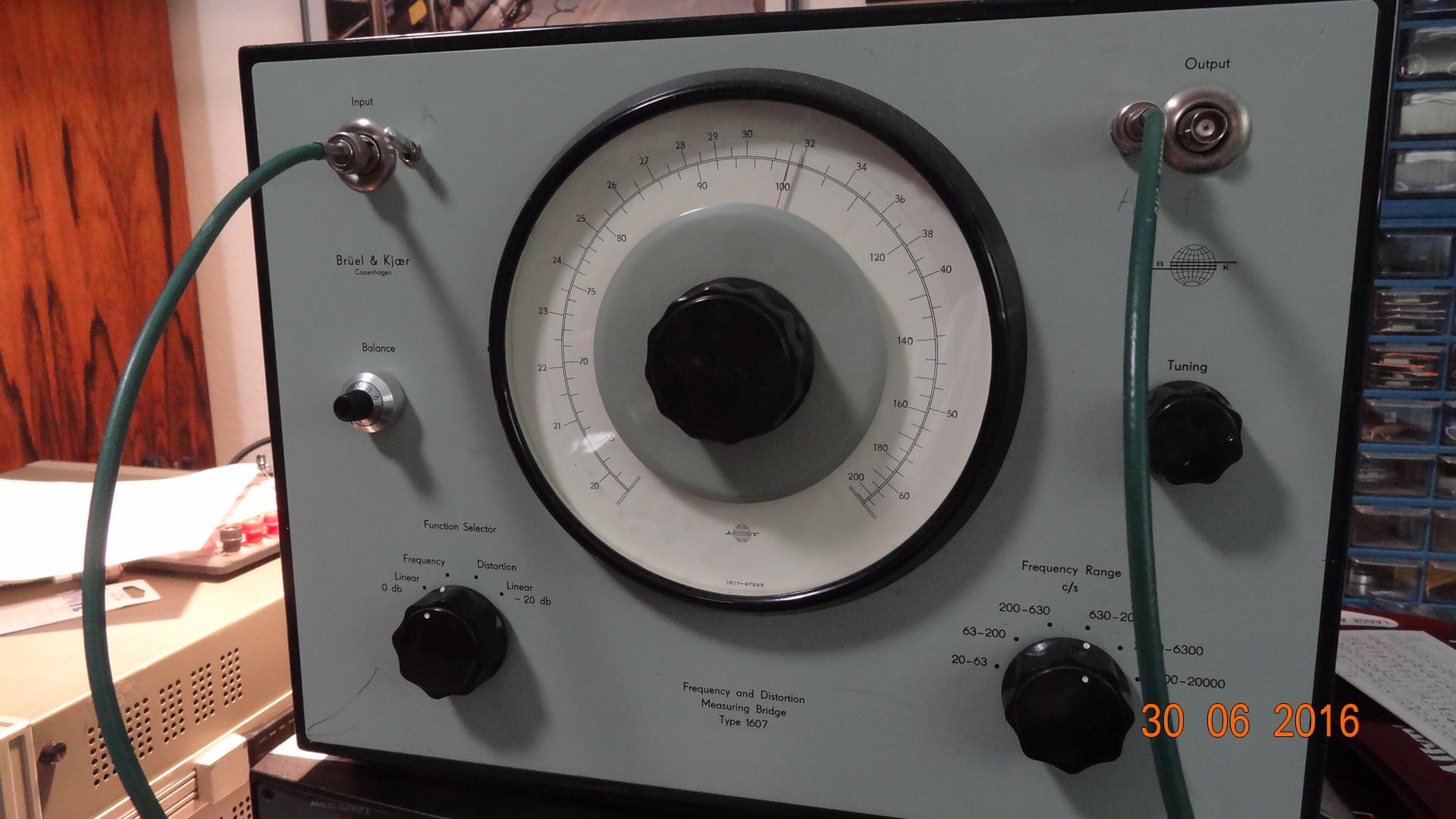

The B&K passive notch filter has a correction for harmonics but with 20 dB insertion loss. I have not had the patience to reverse engineer it and the manual has no circuit info, quite unusual for B&K in that period.

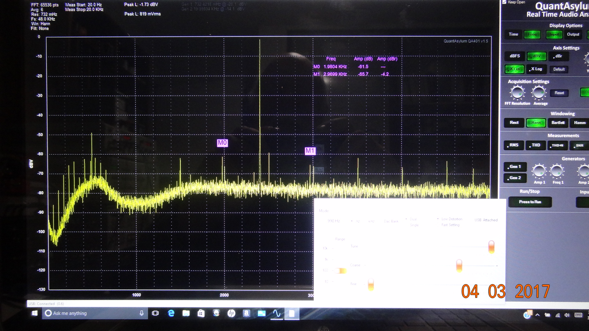

I have very average results, nothing interesting to show. Second question - I haven't measured that. 🙁 And now I am far away from my PC.Xonar Essence has the CS5381. The same as my Xonar D2 has. This chip is one of the best.
What the residual harmonics you can measure with your Essence? What is the input signal level (dBFs) in the best linearity region of your card (when the residual harmonics become invisible)?
I am talking about noise, of cause.Averaging won't change a thing, unless it's synchronized and is performed in either vector FFT or time domain. Then it will reduce noise only, like 20-30dB of noise reduction.
Any averaging that reduces harmonics is faulty 🙂

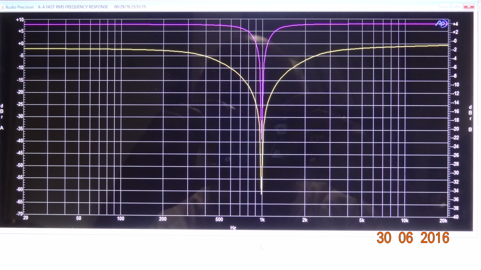

The passive variable notch filter with and without active circuit modification applied. [July 2016 file date]
I used this to tune out a harmonic. Some generators can have 2H nulled but 3H is then higher --- tune gen to reduce one harmonic and other is higher. But with notch, you tune out the remaining Harmonic for exceptionally low residual. I need two notch filters locked with each other would be best. hint hint
Note-- No atten of 2H with active switched in.
This is so far possible to measure and obtain with -100dbv cal reference signal = 0 -->
Davada's Gen . Retuned for 1Khz best perf.
THx-RNMarsh

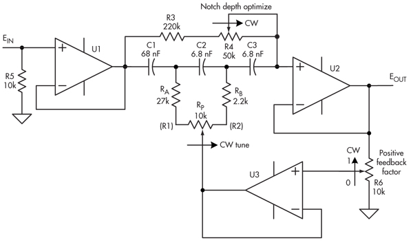

How does your active Notch circuit look's like?
Did you also measured the noise & THD contribution of this active notch?

It was a basic dual opamp config notch filter... each used in X1 config. No I did not measure its contribution.
Seemed to be just the dist and noise of the passive parts.
sorry
maybe something like this without input buffer --->

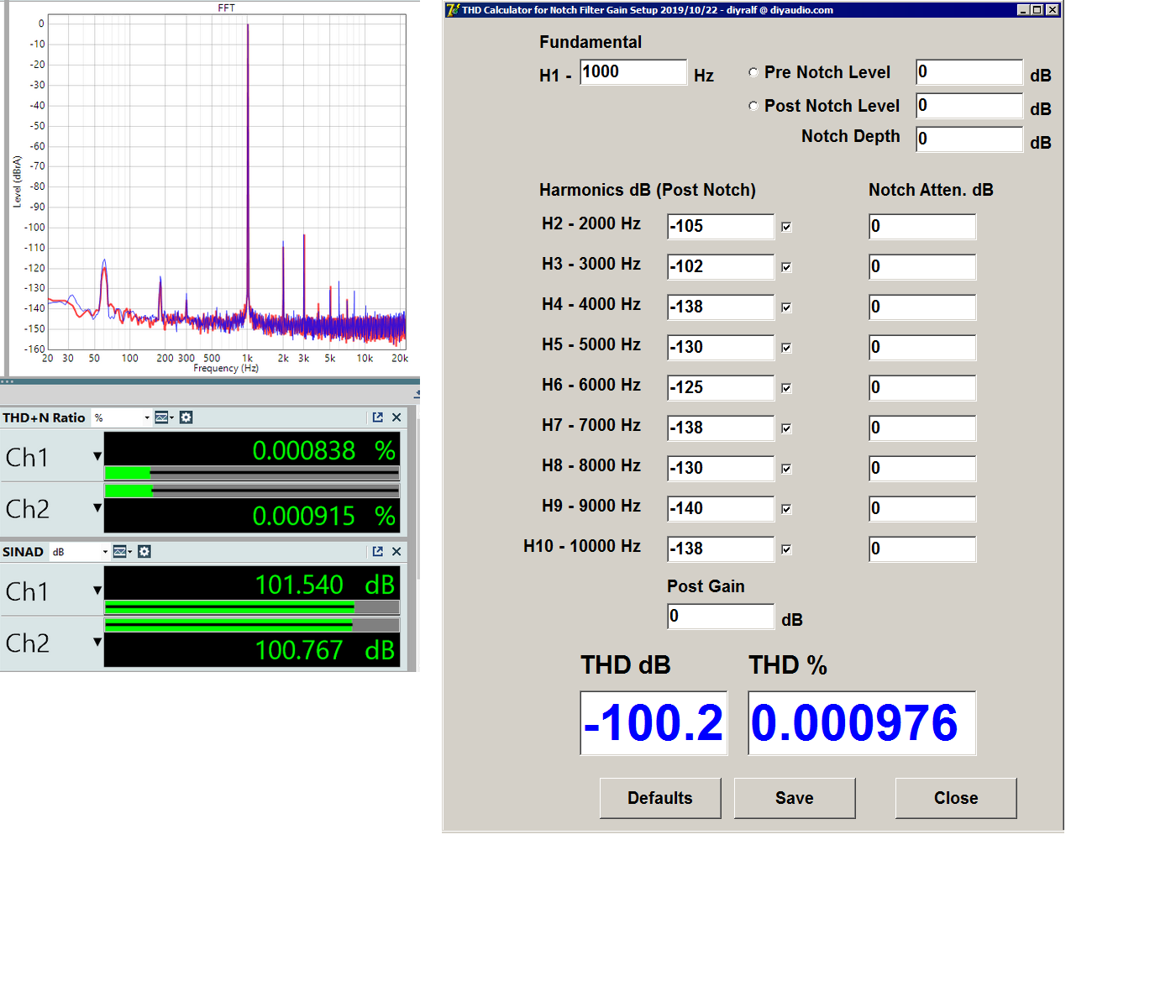

I made a small tool for THD calculation. Please post any errors here.
You could add "noise level" parameters and then calculate the values with better precision and get better (lower) THD values.

Generally, the app seems to work.
Ralf what is the user interface? Does it import numbers from the likes of ARTA?
Or do you manually input some numbers and it calculates the rest?
You could check against the AP harmonic analyzer results which provides essentially the same functionality.
It is a subfunction on the digital analyzer panel.
Jan
Good idea: Import the readings from ARTA.
