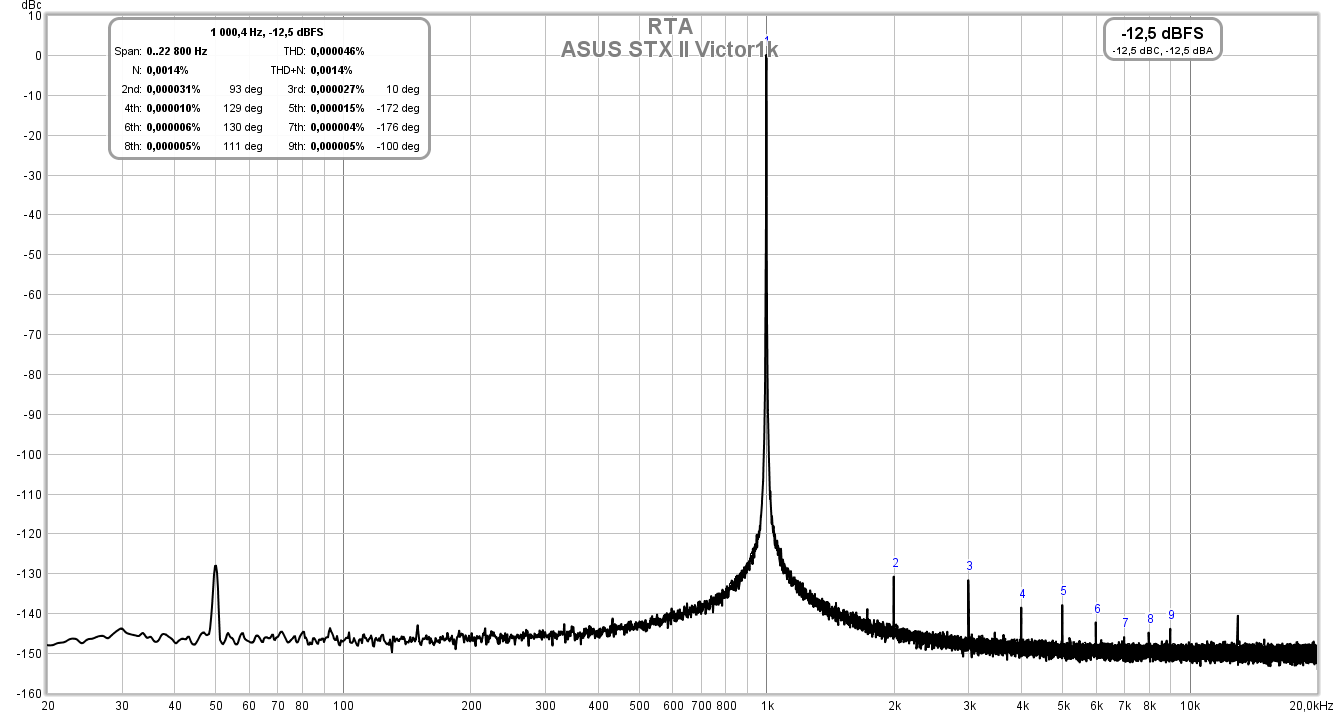

The three numbers on the right are a bit confusing. I assume that the -12.5dBFS is correct.
But with dBc (decibels relative to the carrier) on the left axis, the fundamental is scaled to 0dB. I just tried it on REW V5.19.
correct, H1 at 0dBc (H1 -12.5dB full scale)

CS5381 in my ASUS STX II, oscillator Victor1k;as Victor wrote, -130dB

they measured DAC , I showed ADC performance at -12.5dBFS with external analog oscillator.
and yes, STX II DAC (line out) is quite bad

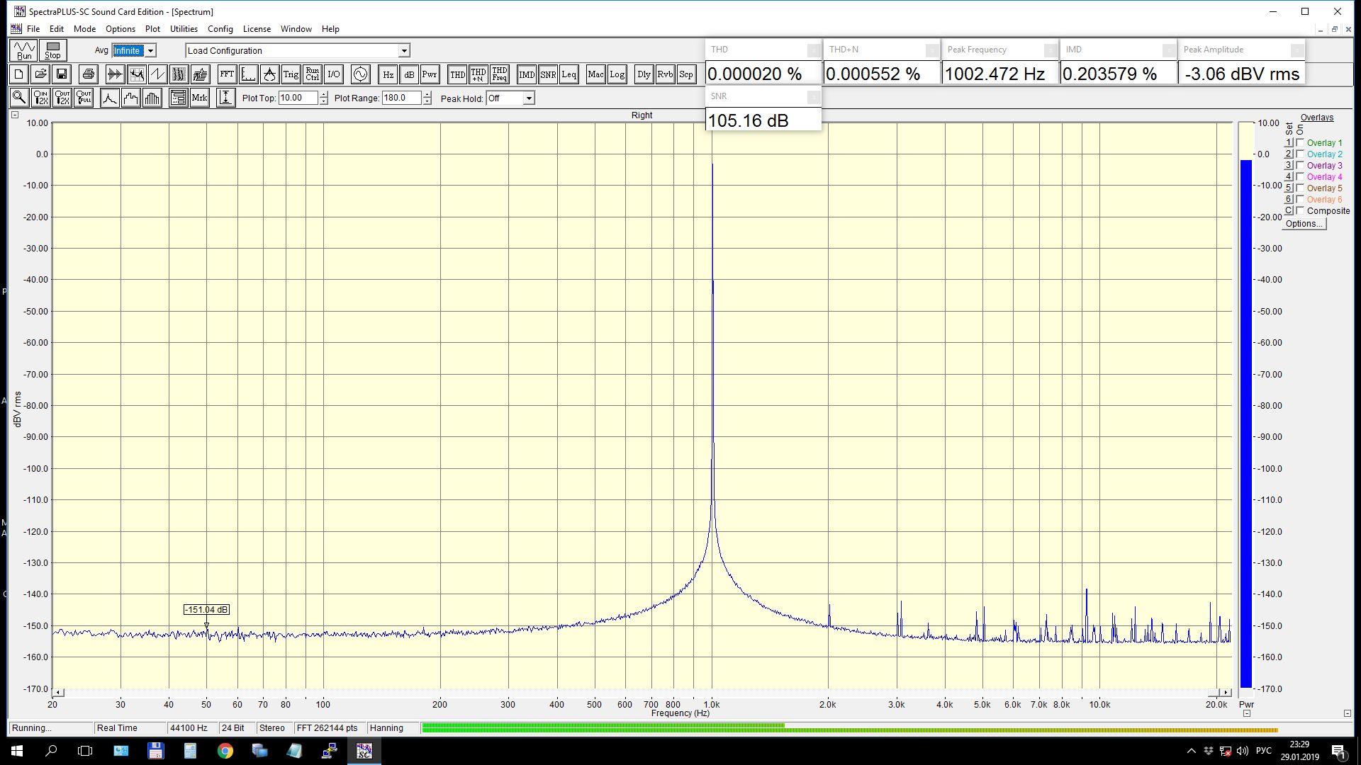

ASUS Xonar Essence STX II, THD 0,000020%, THD+N 0,000552%

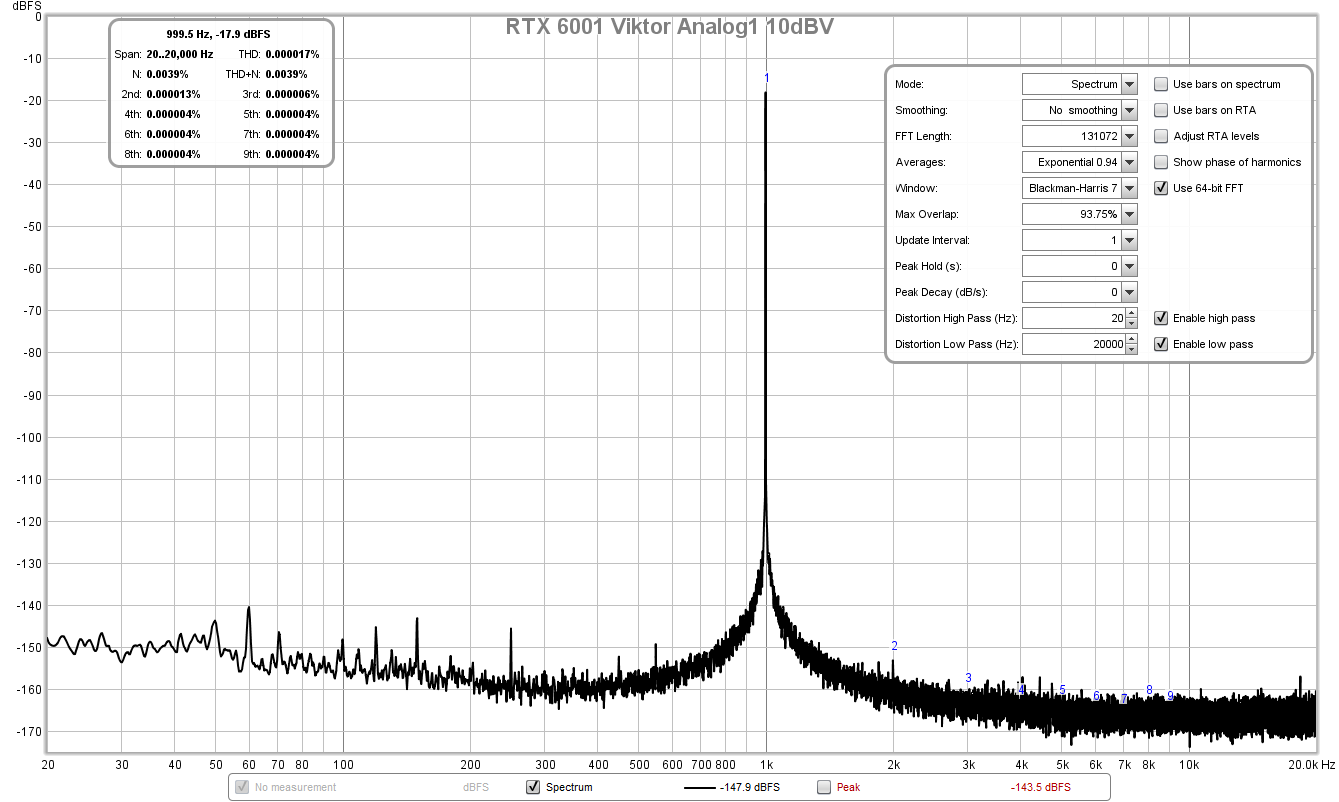

And RTX6001:

ASUS STX II, THD 0,000046% THD+N 0,0014%
And RTX6001:
THD 0,000017%, and THD+N "only" 0,0039% ?Originally Posted by nyt![]()

BTW, attached is a measurement of a single-ended Viktor 1k oscillator using the RTX. The Viktor is crippled with a 30V smps (battery based DC-DC converter) when it needs 35-36V, so it's not giving it's full performance but the limiting factor here is the ADC I believe. (When pairing with a Hall notch filter with 4x9V battery, my Viktor was verified to have an H2 of <-150dB before). Attached Thumbnails![]()

The ASUS cards seem to be good, but nyt's measurment with Victors oscillator and the RTX6001 shows a THD below -135 dB. So slightly better 🙂
In reality the THD measurement is limited by the ADC, but also by the noise. The 2nd harmonic is visible, but the higher harmonics are somewhere in the noise floor. Perhaps a larger FFT window could have revealed the true level of the higher harmonics.
Reference to the measurement by nyt: GB for RTX6001 Audio Analyzer with AK5394A and AK4490
The THD+N is most likely limited by noise from the supply as indicated by nyt.

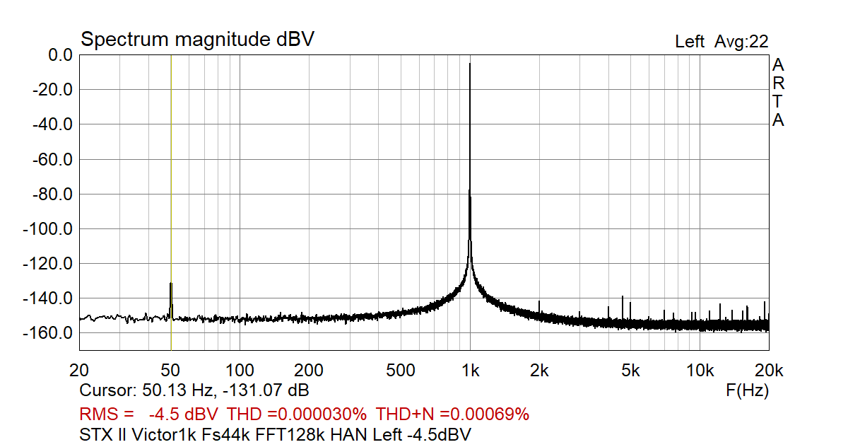

Ok, this is my best setup -10.8dBFS (-4.5dBV), Fs44k, FFT128k
Previously I used -12.5dBFS, Fs48k,FFT65k
