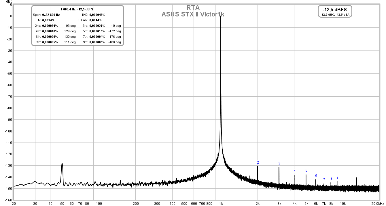

What is the amplitude of the fundamental frequency in this measurement? We can't see the full graph.

CS5381 in my ASUS STX II, oscillator Victor1k;
as Victor wrote, -130dB

-135dB ;-)
It is difficult to measure when the residual harmonics are visible. I always use the input levels when the residuals become invisible.

From the numbers it looks more like -126.7dB.
Not bad, but to do better you may need the AK5394A 😉
The highest harmonic is at -130dB but the fundamental is at +5dB. Hence my mention of -135dB ;-)

Actually the fundamental seems to be at 0dB. Due to the text it is not easy to tell from the figure.
And the second harmonic is at around -130dB. This fits with the 0.000031% = -130.2dB. The THD is stated as 0.000046% = -126.745dB.

I see the fundamental spiking through the text (black spike) at +5. The 2nd is at -130 so the difference between fund and 2nd is -135 in my view, but I'm not going to war over it.

yes, i see that also from dbC scale. BUT, the data says -12.5 dbFS
