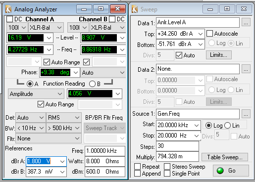

Since distortion measurements don't have fixed reference to signal values it doesn't make sense to use dBr. dBc makes more sense because it doesn't have any restriction this way. dBr is more for either checking or making calibrations.
David, an AP distortion analyzer has the option to have the Y scale in dBr.
There is an entry on the analyzer panel where you can set the ref level. Then the reported distortion is scaled referred to that setting.
So let us say that your signal (carrier, fundamental) is 1.8V, you set the dBr ref to 1.8V and you get dBr referred to 1.8V.
It sound much more complicated than it is to use it.
Jan
Jan when we scale a signal to 0dBV to make a measurement easier to read we have used a form dBr to get it there. What's complicated about this? If we're going through a number of gain changes in a chain of measurement such as we might to get to -150dBV on more that one instrument, say sound card and analyzer readout, it makes sense to do this.
Supposing you are calibrating a batch of your autoranger and the value you want has a lot of decimal points. Whouldn't it make sense to use the dBr function in your AP to scale the set value to an even number. This would make it easier to read at a glance. This is what dBr is used for.
