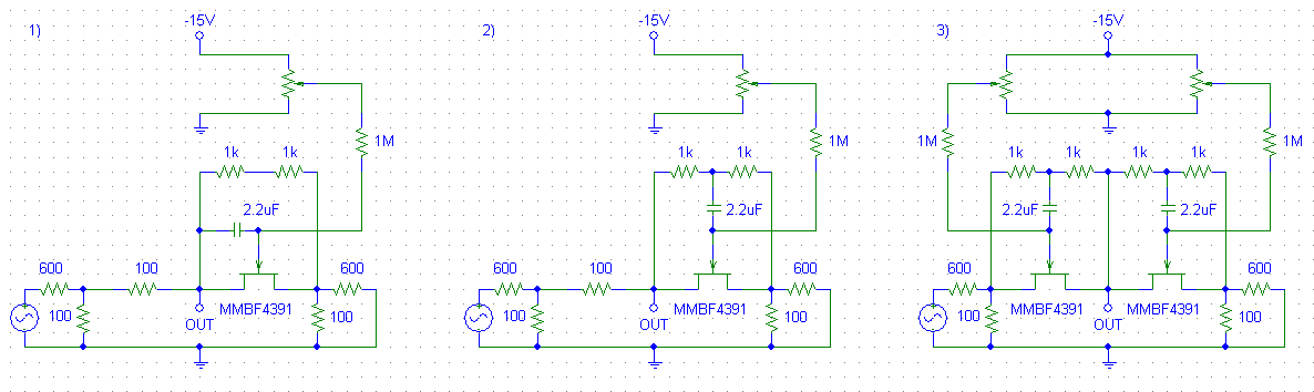

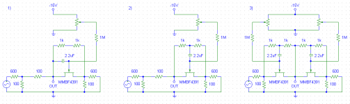

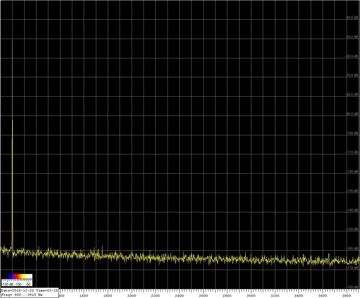

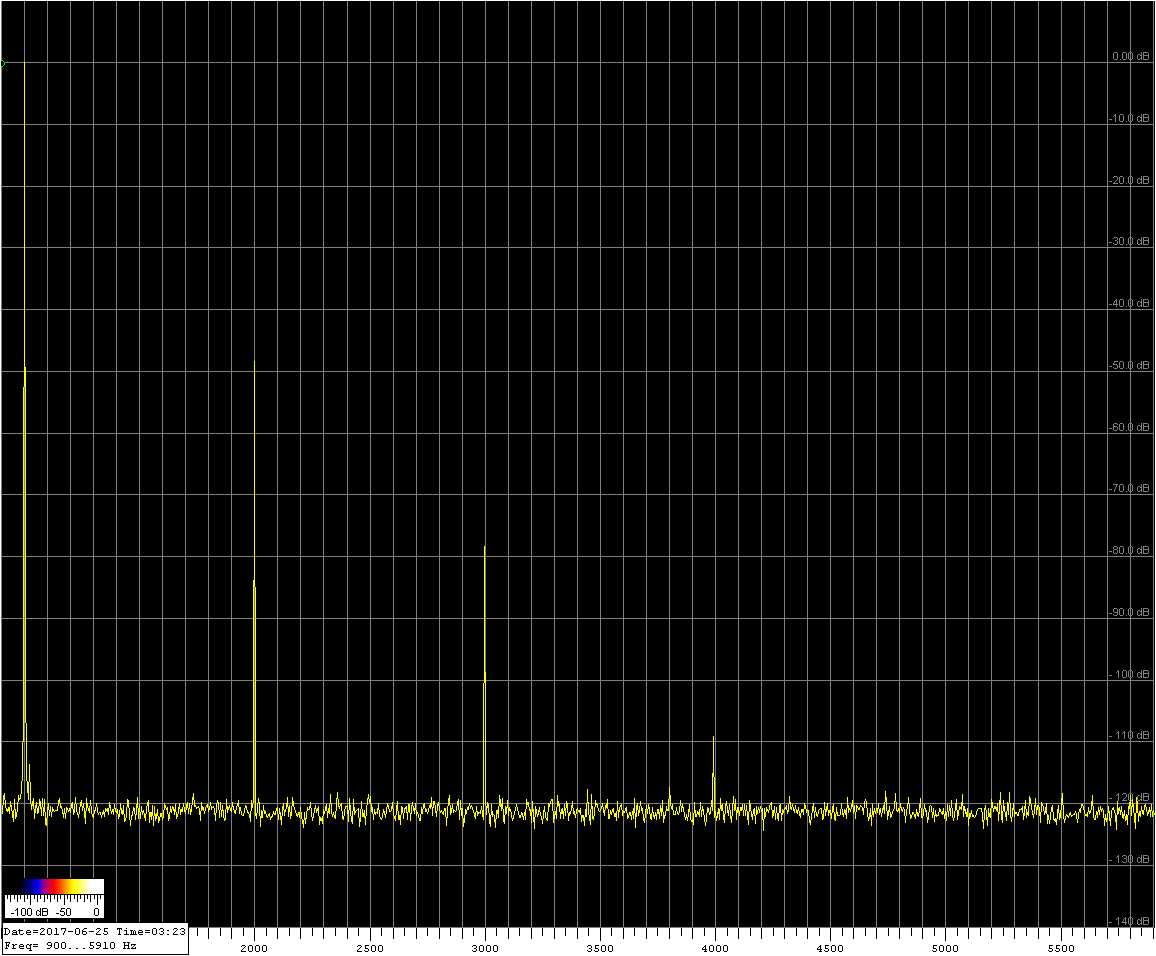

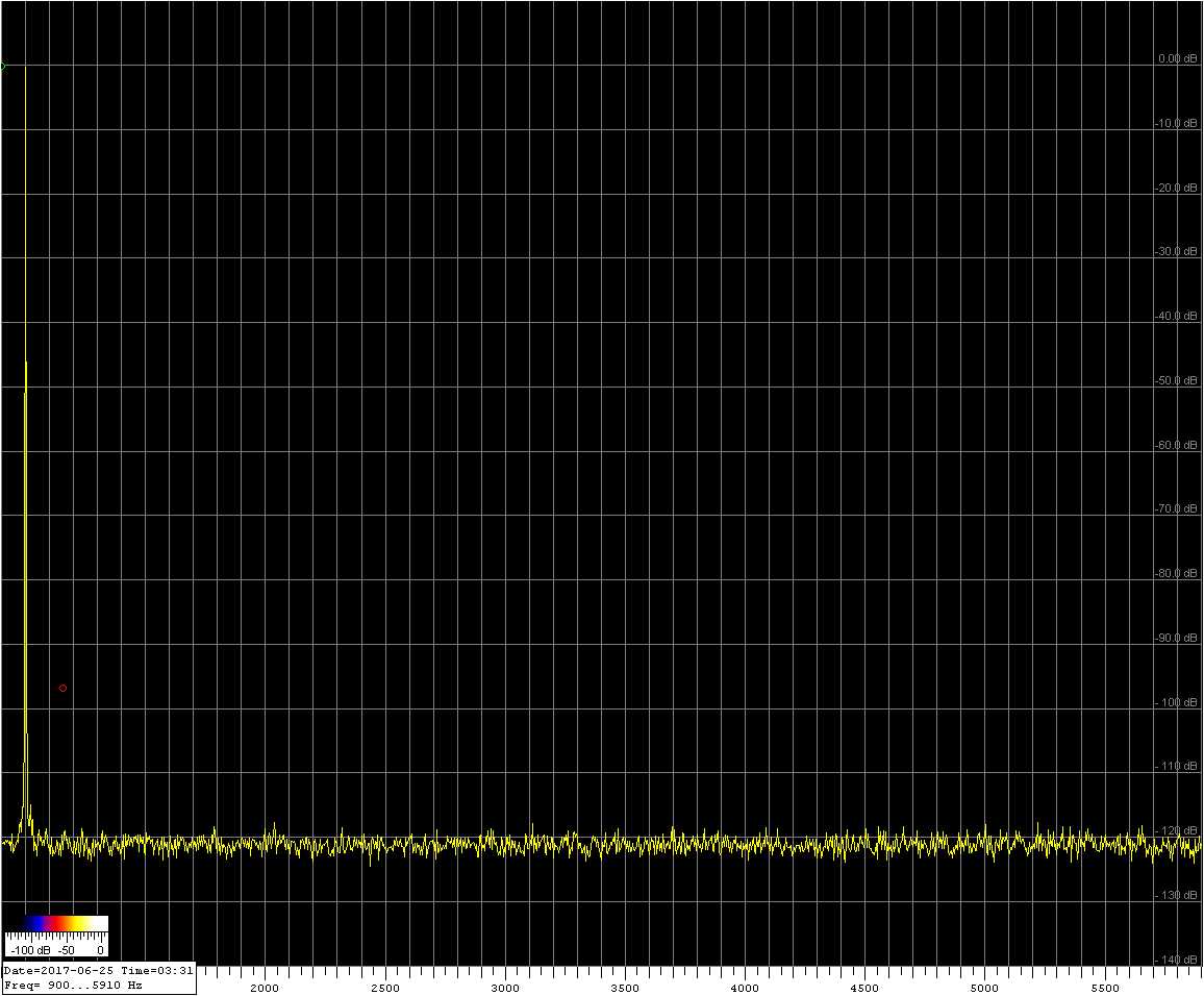

The FET distortion problem was discussed some time ago, and the radical method is the balanced FET regulator. As example in the attachment. Other simple method may be paralleling or cascoding of the FETs, if we can't find the FET with needed specification. As example, the MMBF4391 runs in my oscillator with around 40 ohms resistance. The fully open resistance of this FET is around 20 ohms. So, I have only 20 ohms for to change, but other 20 ohms as unwanted ballast. When I use the matched FET in parallel, I can reduce the resistance and also the voltage across the FETs without losing the same control.

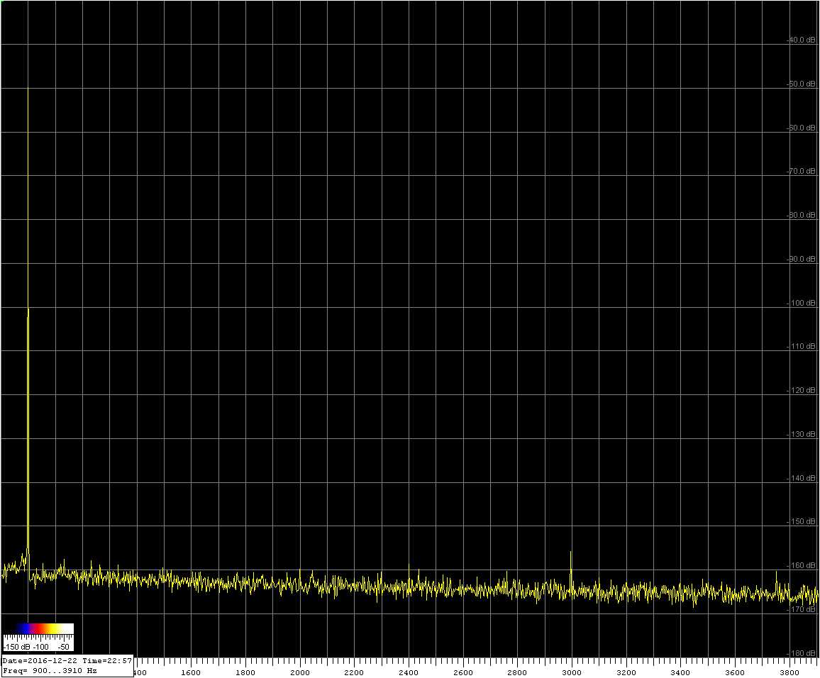

Also other serious problems we can find under -150dB - capacitors, opamps and the PCB board quality. Some PCB boards don't allow to run so low. Maybe chemical residues, moisture, bad mask or PCB material. The oscillator under -160dB probably must be mounted on teflon board without the mask, or air mounted - point to point soldered.
Vic.

That JFET regulator is a neat-looking circuit. Did you come up with it, or did it originate with someone else? Have you simulated it? If it works as my initial look suggests, both for H2 and H3, it seems that it should ideally cancel distortions without the 50% gate feedback trick. Is that right? I'm not saying to abandon the 50% feedback trick (invented by HP when they first started using JFETs for agc control in their oscillators), but rather am suggesting that seeing how well this circuit works without that gate feedback is a good sanity check on its effectiveness.
Bob
Hi Victor,
Bob
Hi Bob,
This balanced regulator was drawn by me, but idea is very old and was implemented in some devices, and in other configuration. In theory it can run without the 50% feedback, but then it needs very precisely matched FETs. I haven't try this schematic yet, but I was tried the compensation principle in simplified schematic (schematic 3 in first attachment) with two FETs connected as divider. I measured it, and the results was published when the previous discussion was going on. The principle works fine, and also without the very precisely matched FETs. You can see the spectrum comparisons between the schematics in the same sequence as drawn schematics.

Nice work, Victor. I used the 2N4091 back in 1981 when I did my distortion analyzer, and as far as I can tell the 2N4391 is pretty much the same. I picked the 2N4091 because it had high pinchoff voltage and low Rds-on.
The 50% gate feedback does need to be quite precise for best distortion reduction, especially for the 2H. I have seen evidence that it is not always exactly 50% at the optimum, and have 10-turn pots in my distortion analyzer for adjusting that ratio. In the arrangement I use, the JFET and an associated op amp implements essentially a 4 quadrant multiplier that creates an error signal that is injected into the SVF for control. I can thus see quite easily the in-situ distortion created by the JFET circuit on a spectrum analyzer. That makes it easy to adjust the pot for the optimum.
The other thing that I discovered is that the phase of the 50% gate feedback signal is very important, and any (usually lagging) phase shift of that signal can seriously limit the degree to which the technique can reduce the distortion. This phenomena often does not show up at 1 kHz, but does tend to be something that needs to be considered when measuring a 20 kHz fundamental.
Bob

Thank you, Bob.
Yes, I know about the FET feedback tuning trick, and I tried it. I think this also may eliminates the 2nd which comes from the other parts of the oscillator and the measurement tool. The worst situation may be if the measurement tool has the similar 2nd in opposite phase, and we get the wrong result.
