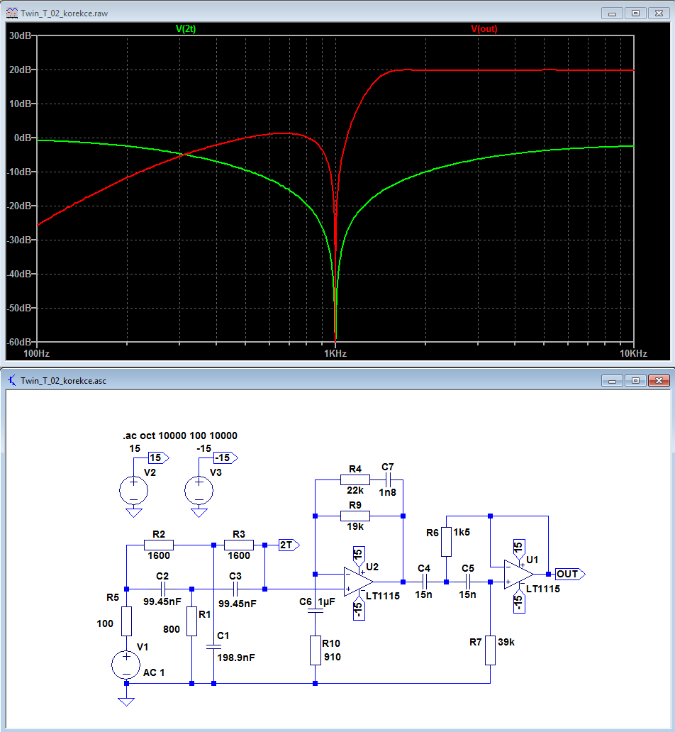

Twin T
For your inspiration
Nice! I like this idea. I toyed with the thought myself, of electronically compensating for the twin T droop with a peaked high-pass filter, but never implemented it. A key nice thing about it is that the filter amplifier does not see the fundamental to any extent, so it does not introduce distortion.
In the real world, of course, this idea competes with, and needs to be compared to, the positive-feedback active twin T circuit (where some worry about the amplifier being in the signal path and contributing to distortion).
I also note that, while the passives in the twin T itself must be quite precise, the passives in this compensating part of the circuit are not that critical.
Bob
I figured out a way to tweak software to do the correction- if your software supports a correction file (like a mike cal file). Plot the response of the notch and manually adjust the correction curve it at the notch frequency back to zero or some arbitrary level correction. It will then correct for the harmonic attenuation with a complementary curve. you could have curves stored for several notch filters.
