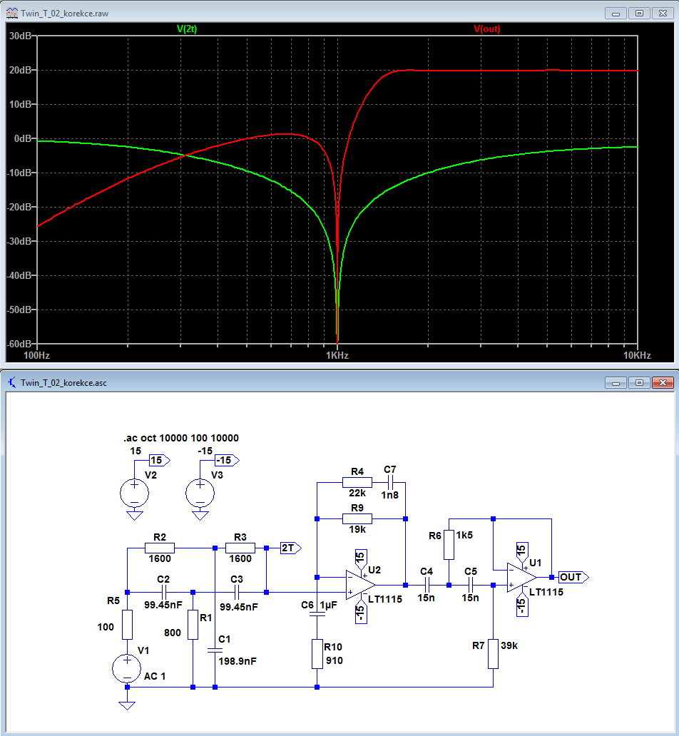

This circuit looks great. I have a Radiometer distortion analyser.
There the notch filter is variable (there is a balance knob to tune the notch) and this needs to be aligned a few times before it stabilises.
Question: can your filter be 'tuned' a bit to be able to match small drifts in frequency? Which resistors should be changed or is that not do-able, 1600/1600/800 cannot be changed in high enough matched quality)?

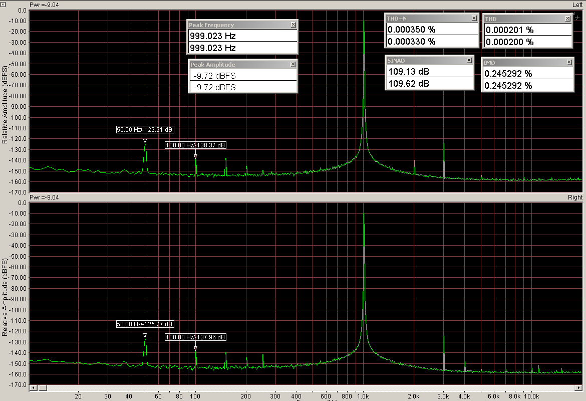

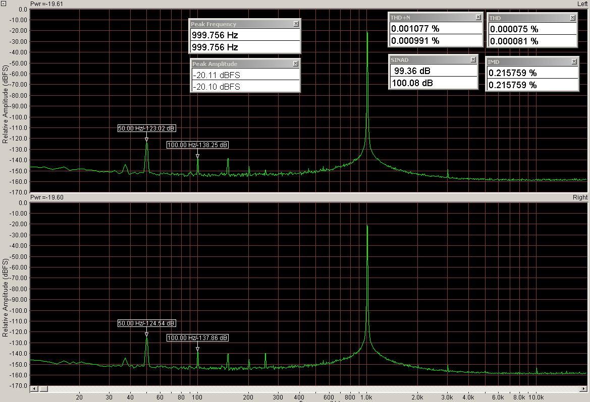

After more months of waiting (job related issues) i have finally test Victors 1KHz generator.
Here are the results.
At -10dBFS (here i have some doubts that distortions come from generator)
attachment.php
Here is at -10dBFS
attachment.php
I need to work little more at shielding. Thank you Victors!

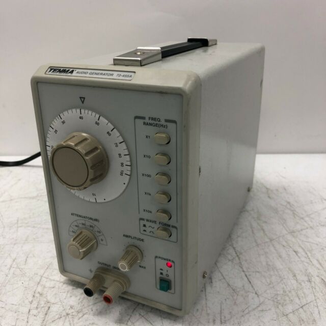

For around a measily $150, a Tenma generator works just fine on my service bench.
What is the distortion spec on the Tenna at 1 kHz and 20 kHz at some output voltage around 1V RMS?
If you are not using it to measure distortion, it doesn't matter much. For frequency response measurements, it is more important that the output amplitude be leveled (flat with frequency) to better than 0.1 dB.
Bob

Not having the operating manual handy right now, but on my 'scope it puts out a perfect sine/square wave signal at all frequencies.
