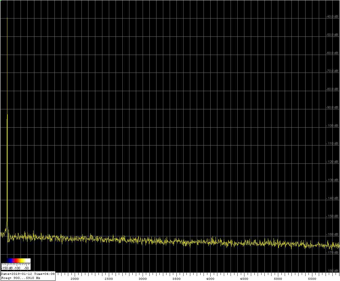

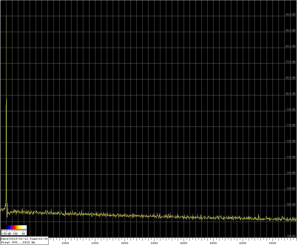

The modified Jan's board has the second harmonic around -158dB (as I mentioned, needs to add +3dB at 2kHz, and -1dB at 3kHz on this plot).
Richard, I don't forget about you. As I remember, you wish the oscillator finished in box with PSU, but this is not so easy for me. Also I don't wish to send you the similar board as you already have. Probably you have not so old 1kHz board. Can you measure this board with your equipment? Probably your oscillator board must have the harmonics lower than -150dB at max output. I can modify your board, too. But I can't give the warranty for -160dB. Some boards may can run so low, but I have no statistics. If I can get the stable performance under -160dB, then I immediately offer you the solution.
You can see how around 5-years old board looks before the modification (1) and after modification (2,3). Last plot (3) was done with three times averaging.
Vic.

The real levels of the harmonics can be easy calculated. There is app. 4dB level difference between 2nd and 3rd when this type of notch is used. Every time we know the fundamental level at the notch input. Then we can adjust the proper scale (calibrated injection from other source) at 3rd or 2nd and then calculate the other harmonic level. In my picture, which Jan previously post, needs to add +3dB for the second and -1dB for the third. And it is not so important how deep is notch rejection, only needs to know that the signal after the notch is in the linear region of the ADC. The notch fine tuning practically not affects the second and the third harmonic levels. When the oscillator is adjusted with +/-0,5% precision via the manufacturing process, then in practice usage not needs to tune the notch, and I am using fixed ones.
I don't like active notches. The distortions will depend from the opamp. This is not so good when extremely low harmonics needs to measure.
Vic.

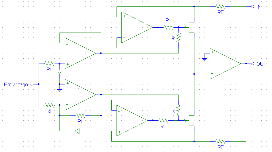

One thing about noise in oscillators that is a tradeoff in my experience is noise vs distortion from the AGC element, usually a JFET.
My experience here is mostly with low-distortion state variable oscillators and notch filters, but I think it applies pretty much in general. Assume that the main source of distortion in the oscillator is the JFET agc element (this will not always be the case, of course). We can reduce the voltage across the JFET to reduce the distortion that it introduces, but if we only do that we reduce the amount of agc range that we have. To get back the lost control range so that it is enough to control over worst-case tolerances, etc, we must increase the strength of its control injection. But the JFET and its associated circuitry already has noise, so doing so introduces more noise into the oscillator.
This noise generally shows up as a combination of amplitude and phase noise around the fundamental. We care about this a lot if we are making a traditional THD analyzer because this noise will come through in a THD+N measurement. It is a little less of a problem if we are using a spectrum analyzer to look at the distortion components coming out of the THD analyzer.
Bob
The FET distortion problem was discussed some time ago, and the radical method is the balanced FET regulator. As example in the attachment. Other simple method may be paralleling or cascoding of the FETs, if we can't find the FET with needed specification. As example, the MMBF4391 runs in my oscillator with around 40 ohms resistance. The fully open resistance of this FET is around 20 ohms. So, I have only 20 ohms for to change, but other 20 ohms as unwanted ballast. When I use the matched FET in parallel, I can reduce the resistance and also the voltage across the FETs without losing the same control.
Also other serious problems we can find under -150dB - capacitors, opamps and the PCB board quality. Some PCB boards don't allow to run so low. Maybe chemical residues, moisture, bad mask or PCB material. The oscillator under -160dB probably must be mounted on teflon board without the mask, or air mounted - point to point soldered.
Vic.
