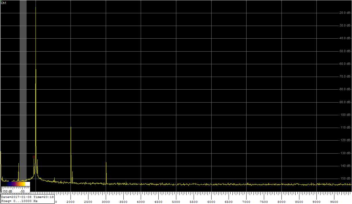

Here are two results with my latest configuration:
  • The FET is MMF4391, the shunt resistor R4 is 500R instead of 1K
  • The voltage across the FET is 20mV,rms
  • Reducing the R3 has a profound effect on the 2nd harmonic: with R3=150K (as delivered) the 2nd is 20dB higher than with R3=82K. However, reducing R3 by another 1K results in losing the control over the oscillator output voltage in that the latter then amounts to the full swing possible with the opamps used.
The spectra enclosed document the above (48kHz/24bit, FFT length 512k, spectral window is -169dB flat top, 16 averages). My notch filter is not yet quite finished, so the measurements are for information only.

P.S. With apologies,the correct value of R3 for the spectrum with lower THD is 133K, and not 82K as previously stated. I misread a color ring on the trim resistor parallel to the original R3.

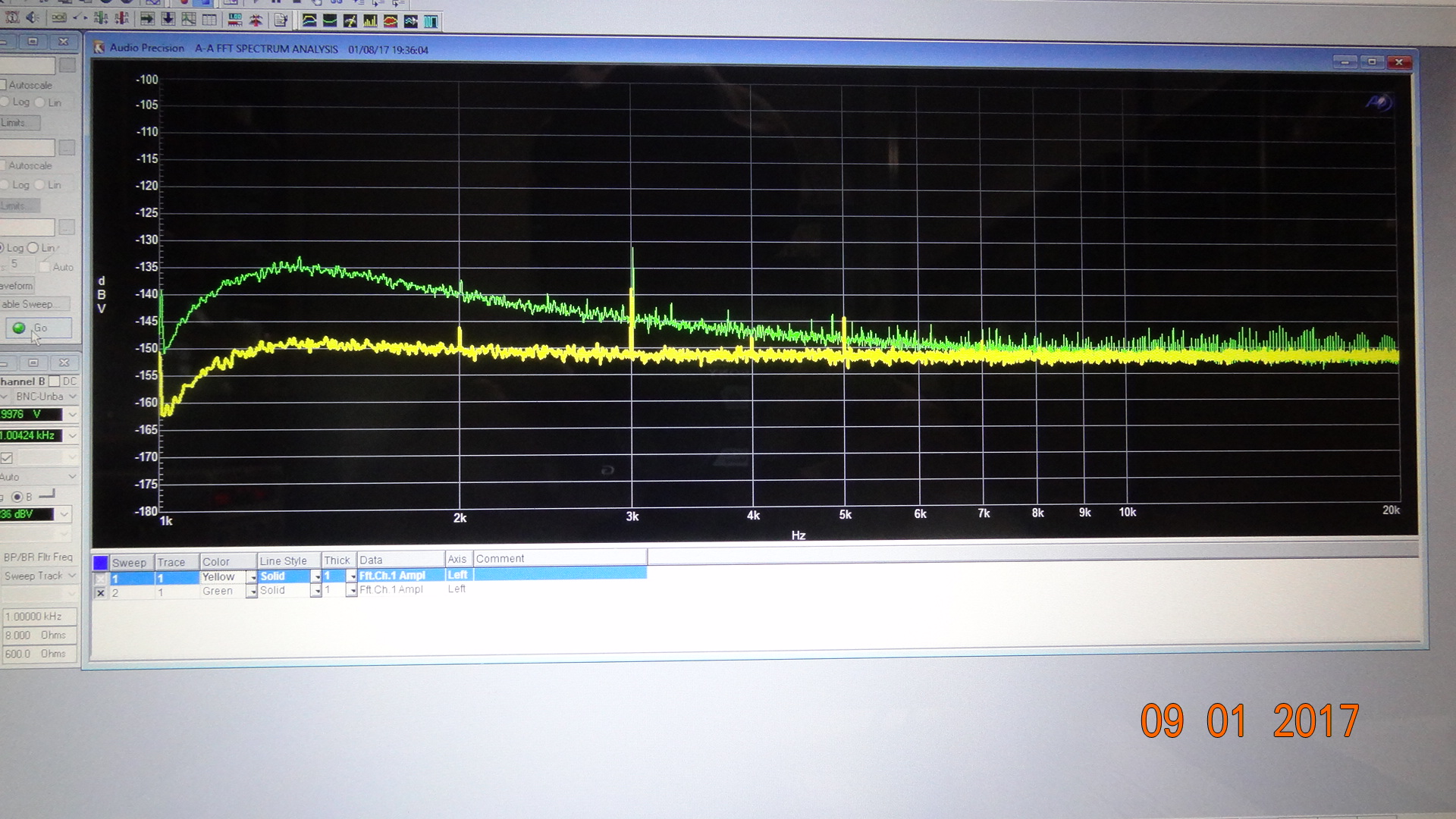

BTW -- the victor osc/gen and the AP 2722 shows the increased noise (green) of the Victor gen, as we know, and the 3H. How to lower the 3H?

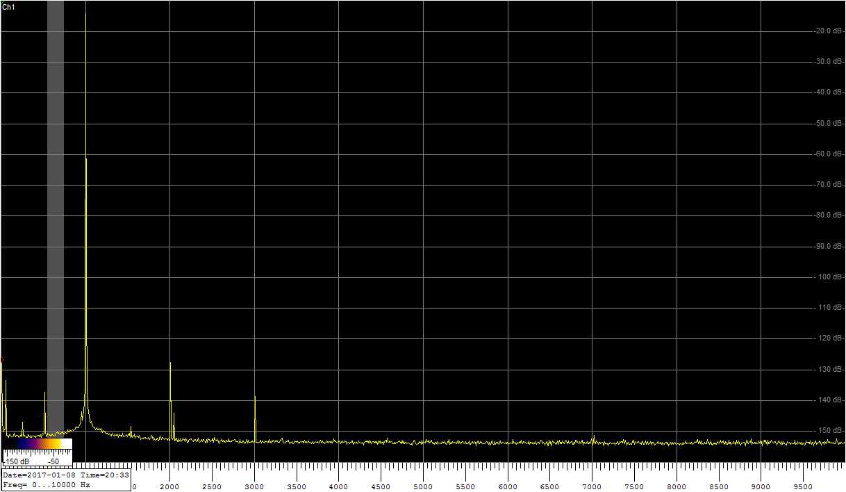

Congratulations - the sterling performance of your 2722 finally returns! Here's the FFT of a 1Vrms 1kHz after an "extreme" notch treatment on the UPV. The signal was routed from the generator to the analyzer externally through a RG316 cable to simulate connection to a DUT and reveal any possible EMF/RFI weaknesses in the chain, With H2 and H3 both around -151dB, it looks OK to me.

Something i had explored was the accuracy of "sound card" type/based test systems. I found that below -100db the harmonics shown had no relationship to any reality.
recently, some have done a little better ---- -105-110dB is Ok.
Now I checked the relative numbers of three very expensive analyzers to see to what degree they agree. The three are Audio-Precision 2722, Panasonic 2277 (Matsushita Comm Ind) and ShibaSoku 725D. On each of these, i connected the QA401 FFT to their respective monitor output.
I used a generator which had 2H and 3H dominant. The only difference is found in the level of the 2H. of course, the 2H is closest to the notch circuits influence etc.
The levels are < -120dB r 1v rms
With the 7722, the 2H was +6db above 3H;
With the 725D, the 2H was +4dB above 3H;
With the AP, the 2H and 3H were same level.
However, the FFT displayed on the computer interface/screen... not at the monitor output via QA401.... showed the 2H to be much lower than the 3H. By -2 -4db
(2H seemed to go down with time -- heat related? drift? )
So, even with expensive analyzers, the numbers are not exactly the same, either. There is up to a 6dB or 10dB difference. But not wildly out of whack like cheap units. No ghost or added harmonics either. Of course, this is based on tests well below -100dB. Their limit in accuracy appears to start to become nuts below -130dB though fairly useful/consistent to -140 to -150dB.
The 2H seems to be most affected. higher fundamental freqs a little more so... null spreading/Q change etc?
I tend to think that the analyzer which gives the higher 2H is a more accurate unit..... tentatively.
