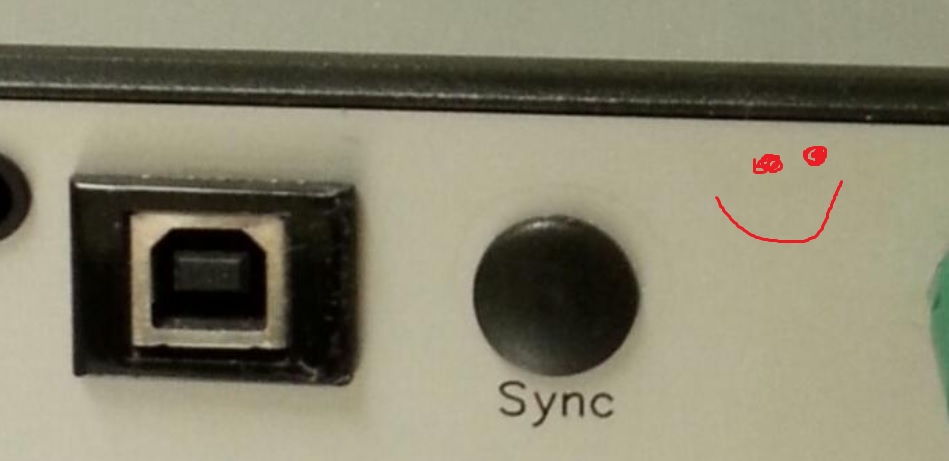

Oh I put the hole in the wrong place. Couldn't get the connector in.
It should have gone where the happy face is.

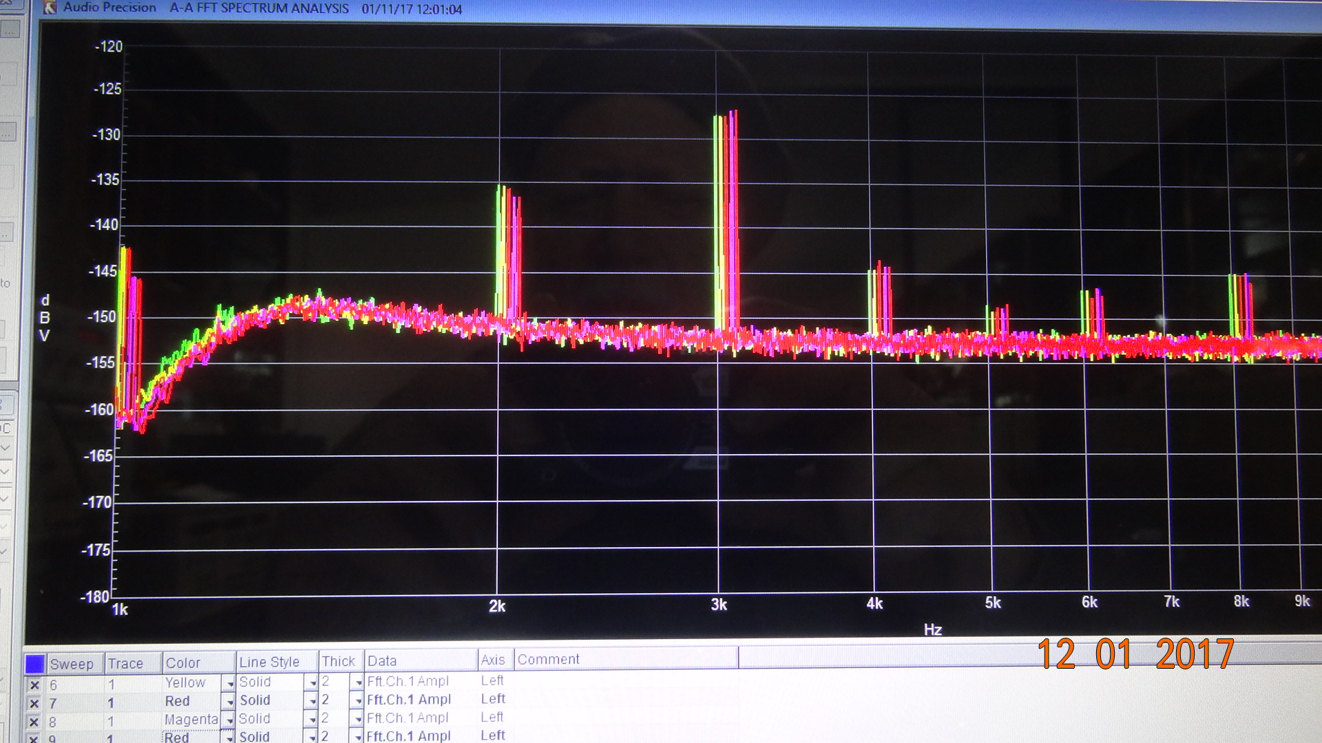

here is what might be termed a tracking caused error on the A-P 2722 analyzer --
The freq is 1KHz. The 2H and 3H is affected inversely.... but most affected is the 2H; The 2H level decreased at each freq change of 1% higher. At +5% change the 2Harmonics went back up.
THx-RNMarsh
Richard could it not be that a slightly different frequencies, the generator and/or analyzer have slightly different harmonic levels? Not necessarily a tracking error?
Jan
A notch filter is very sensitive to phase change closest to the center of the notch.
Move the frequency slightly increased or decreased and the phase can change. This may account for summation or subtraction between the generator and analyzer harmonics and consequently harmonic level.
RC generators are probably not all that phase/frequency stable at least not enough to avoid the above.
But would the notch not track with the freq changes?
Implementation of notch filters vary. The R&S analyzers offer a notch filter tracking option called "Gen Track" which adjusts the center frequency of the filter to match the internal generator automatically. However, this option works only with the standard generator which is DAC-output driven. If the optional low-distortion analog generator is used, a reminder appears reminder to select manual tracking. Since the generator frequency does drift, the notch filter effect when it's right on and just a bit off can be obvious.
Depends on the design, If the control is too fast it can modulate the phase/frequency.
The control in the 339A for example tracks the average. If the changes are fast in the generator the notch controller just sees the average. Then there is the TC of the integrator in the control loop as well.
Just like the compensation in a FB amplifier a control loop has to stable within the loop phase response. Too fast a response and loop is unstable.
Also in some cases like the 725 the notch is open loop and moves in discrete steps set by the frequency counter so there will be some small issues as the fundamental changes. I don't know if the AP is open loop or has a servo. Again, the best way to know what is happening is testing.

Without delving deeper into the design(s), there are many possible reasons for the harmonics to shift and be inaccurate; drift, clock freq drift, freq tracking and null adjust sensitivity, phase shifts/changes, etc etc. I just like to show that the readings on a quick one-take may not be what you think it is.... especially at very low signal levels.

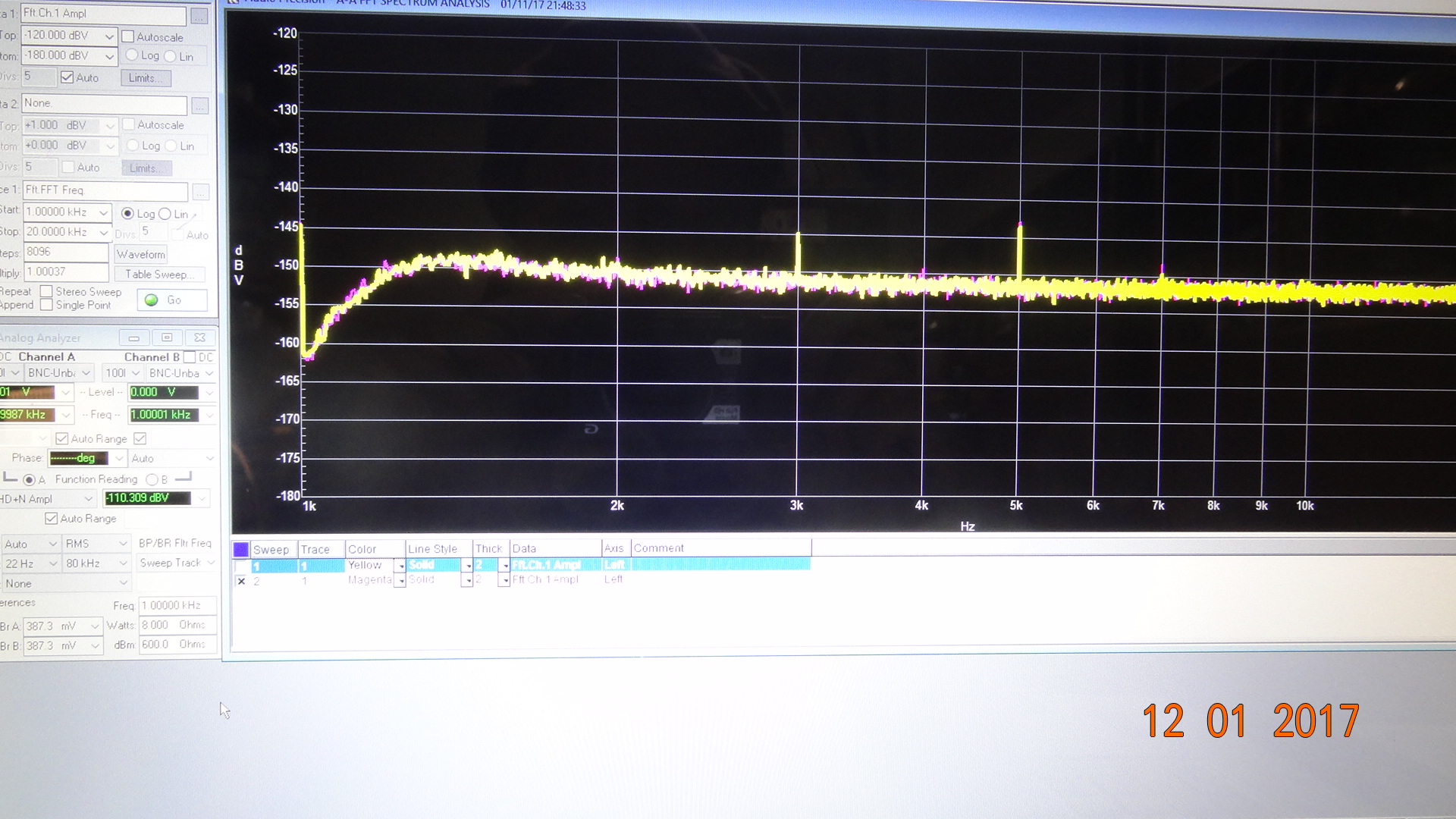

After many hours of being ON, the AP seems to loose the 2H ..... for what ever reason.... Would make your DUT seem to have no 2H .
Then as before when the freq source is shifted a small amount higher.... the first harmonic detected starts to drop in level and the 3H starts to rise.
Shift the freq enough and - what? -- a 2H appears !!
I'll check this against the Monitor output hooked to a QA401 because something seems to be going on with the post-processing.
For the inexpensive "sound card" type based analyzers, I would carefully look at the accuracy below -100-105dB before taking the data as the truth and nothing but the truth.
