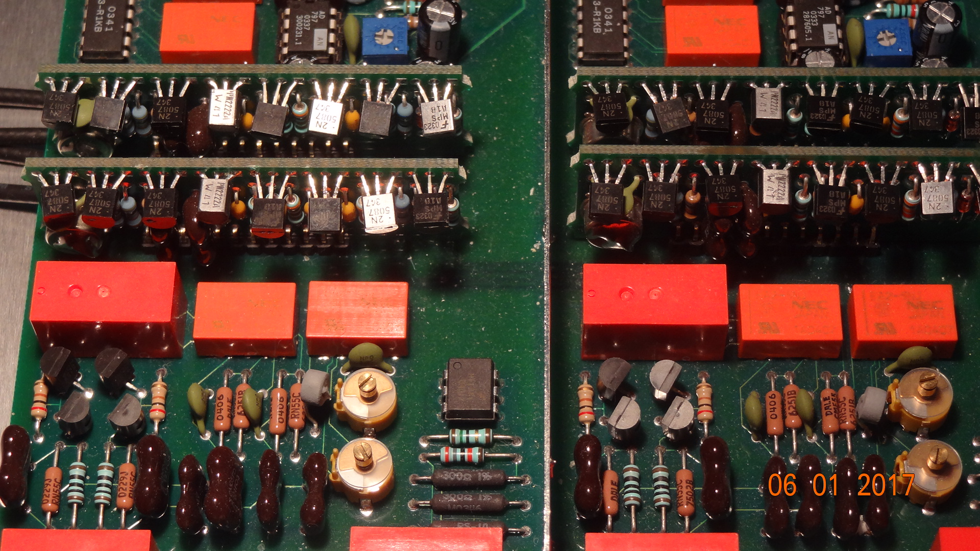

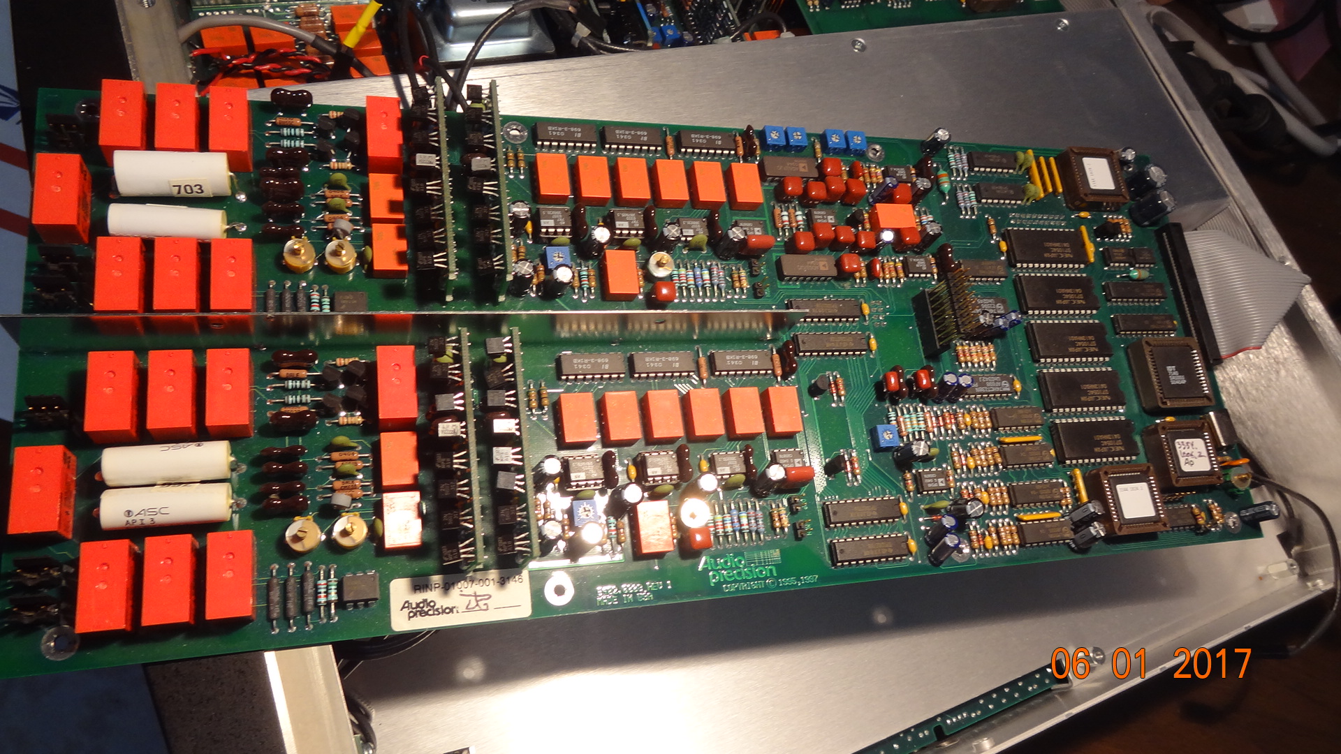

well, i have started to tackle the IPS/protection for the AP-2277A. Good luck to me. Thx me.

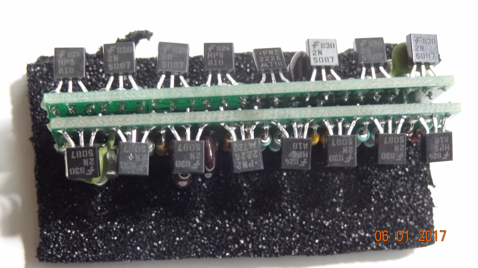

The group of 4 transistors are the protection fets... DS2435 on the input to the two (Bal) IPS pcb.

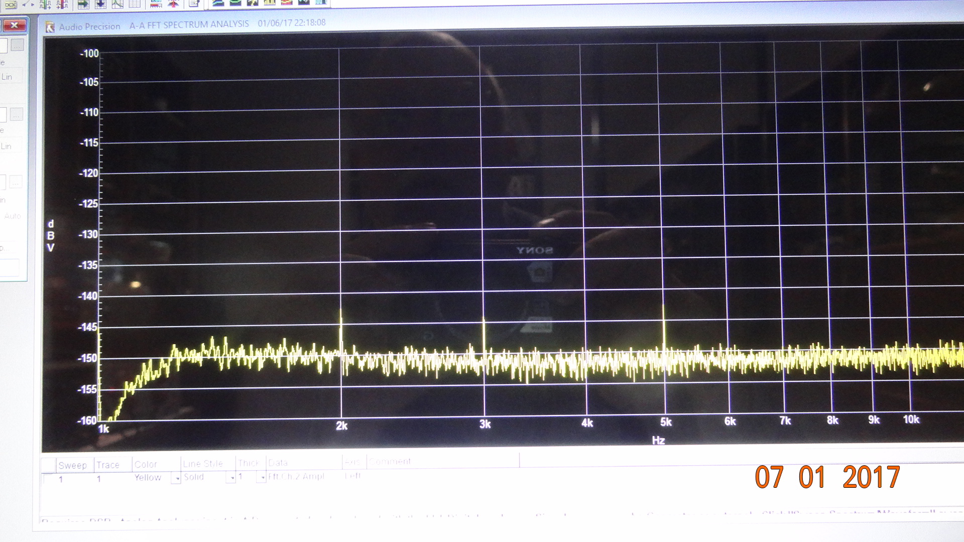

meanwhile, i got the leaky ips protection fets replaced in one channel of the AP 2722 analyzer. Waiting for more parts on the other channel. Checking the internal gen now shows it is pretty decent to say the least.

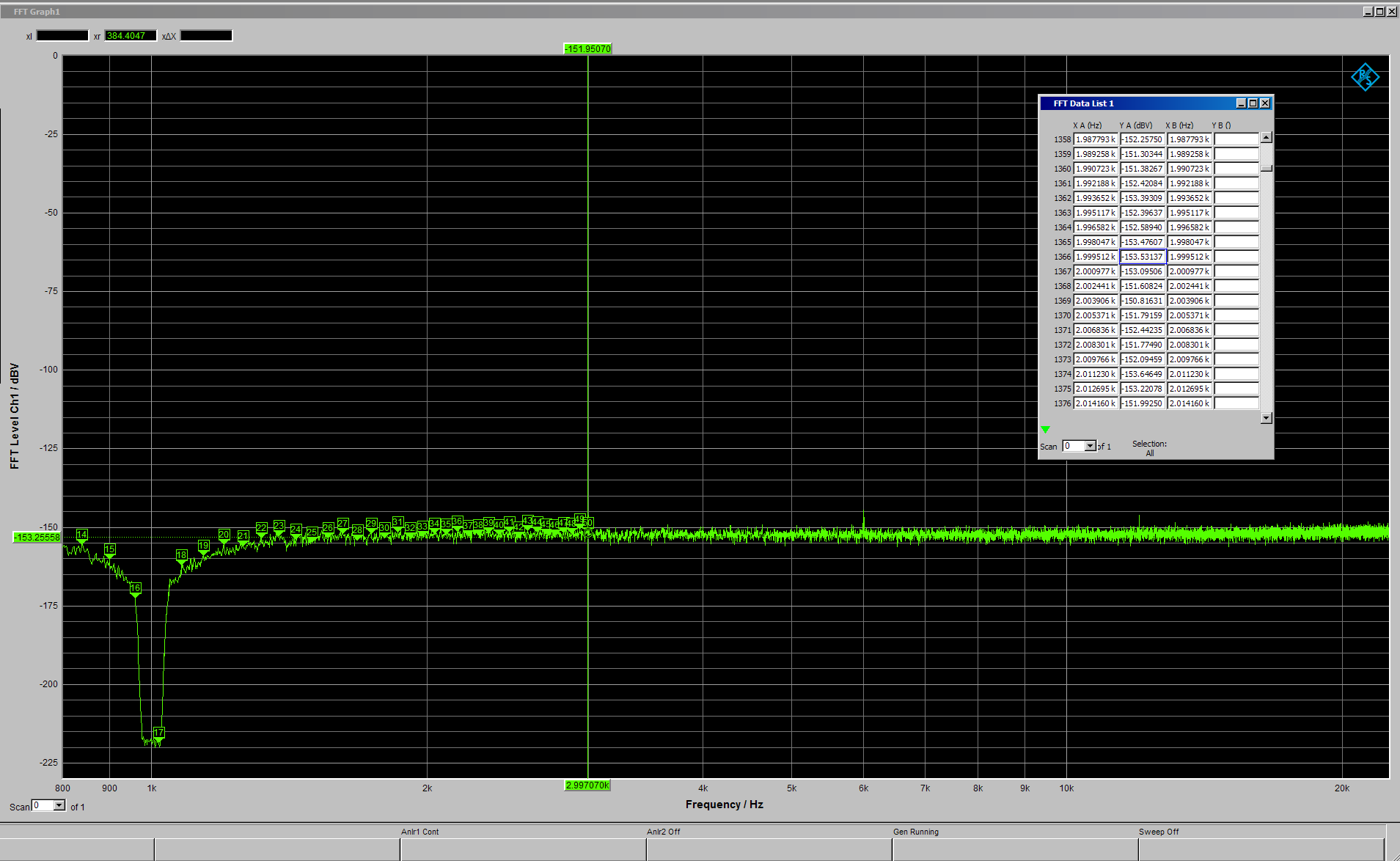

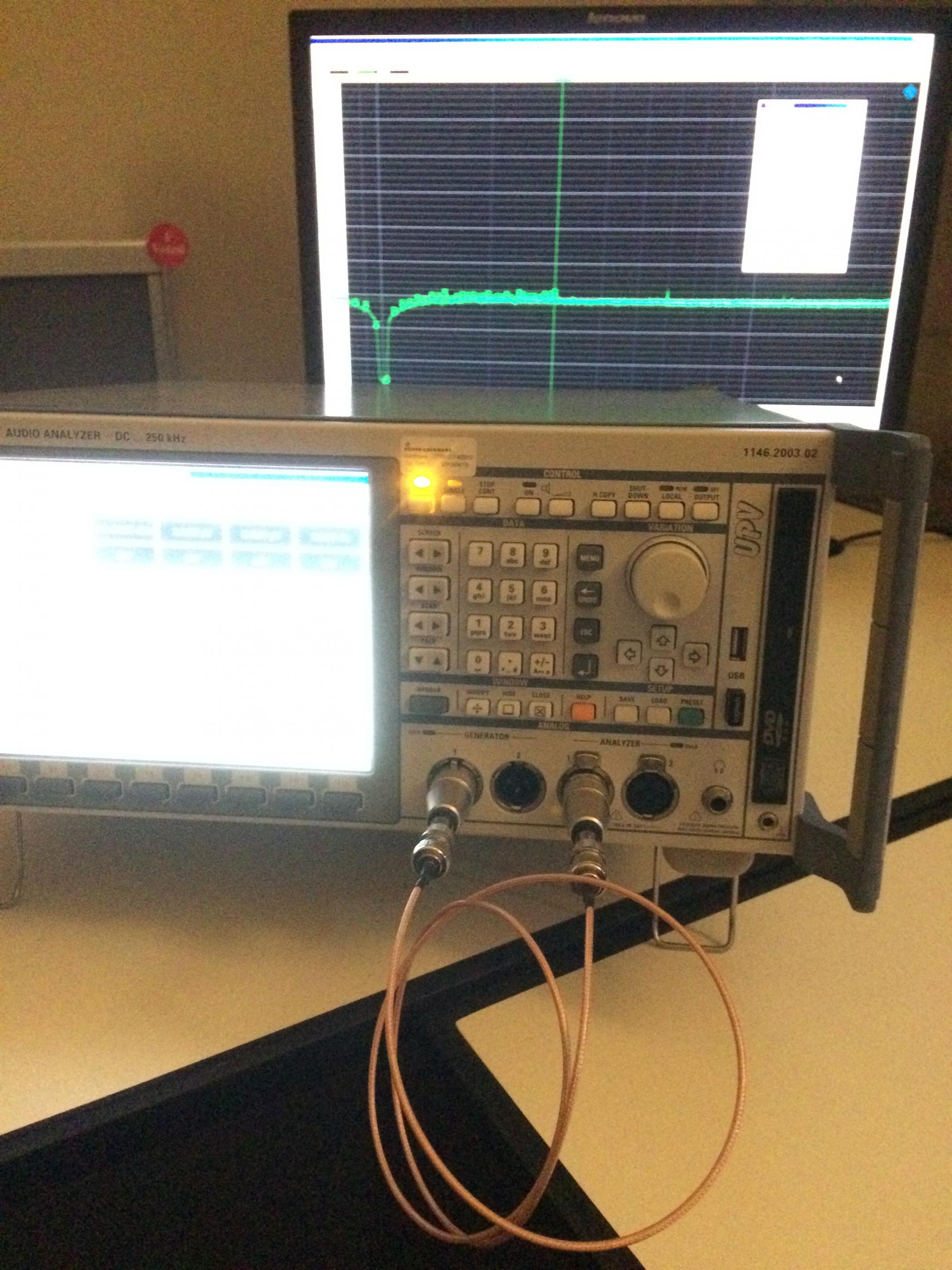

Congratulations - the sterling performance of your 2722 finally returns! Here's the FFT of a 1Vrms 1kHz after an "extreme" notch treatment on the UPV. The signal was routed from the generator to the analyzer externally through a RG316 cable to simulate connection to a DUT and reveal any possible EMF/RFI weaknesses in the chain, With H2 and H3 both around -151dB, it looks OK to me.
