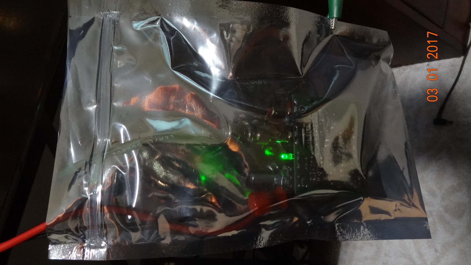

At levels below -100dB, the shielding is paramount to keep unwanted freqs from entering. I have resorted to extream measures in order to see the levels Davada has produced in his generator. But if the levels are not too bad and the extraneous field in the room isnt a total disaster..... I can drop the Victor pcb into an IC anti-electrostatic bag and get significant reduction in noise pickup (emi/rfi).
View attachment 589348 Victor's pcb in the bag.

Love that Viktor-osc-in-a-bag. He should send you a check for royalties!

Oh my God, it seems a great idea! : D
But seriously speaking, there is perfectly fitted enclosure on ebay:
1pc 100*65*35mm Electronic instrument Aluminum Box New box | eBay
This box is two times longer, then needed for an one board. The board in this box looks that:
http://content4-foto.inbox.lv/albums/e/elterra/SGbox/InBox.jpg

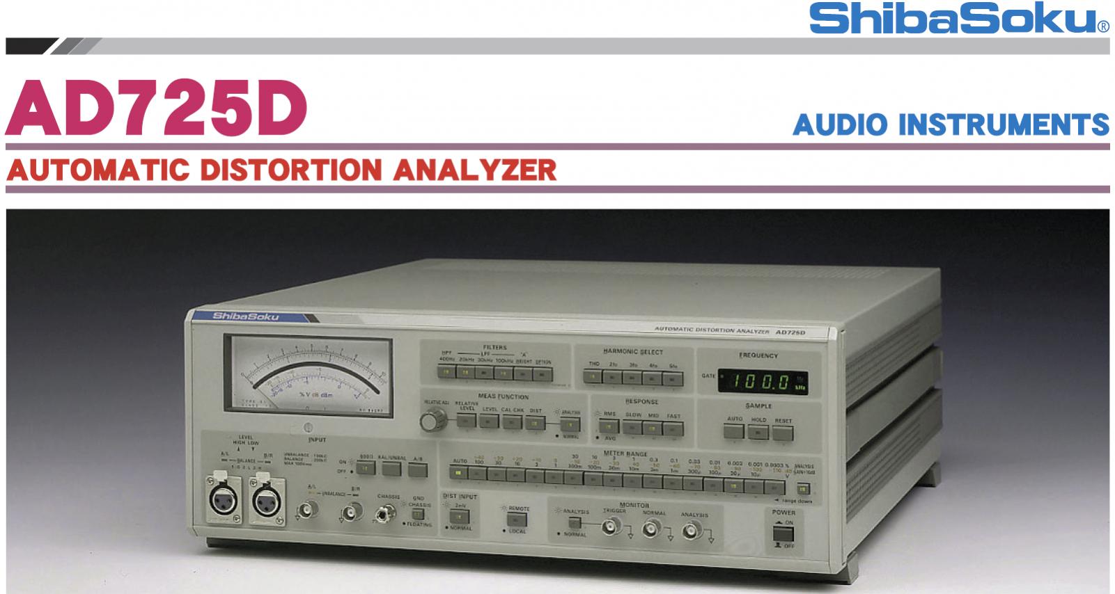

You got a wrong number there the AD725 is an obsolete RGB to NTSC/PAL converter. Reminds me of the "Jack of Diamonds" test. The customer just said open up solitaire and find the jack of diamonds to find the image glitch they didn't like.
This is the one I mean.

AD725D is the correct model number according to Shibasoku's 725D calibration manual.
Oh I see. The AD725 is an Analog Devices IC.
Scott makes funny joke.

As used at the old HW days as or similar 16 | Rf | Products | Electronic enclosures - Metal 😀
Hp
The fingered steel boxes are designed to minimise the slot length through which emi leaks. (HpW's posted link).
How badly do the long slots in the other enclosures leak?
Do we need to fit electrically conducting gaskets into the slots to make them effective for emi attenuation?

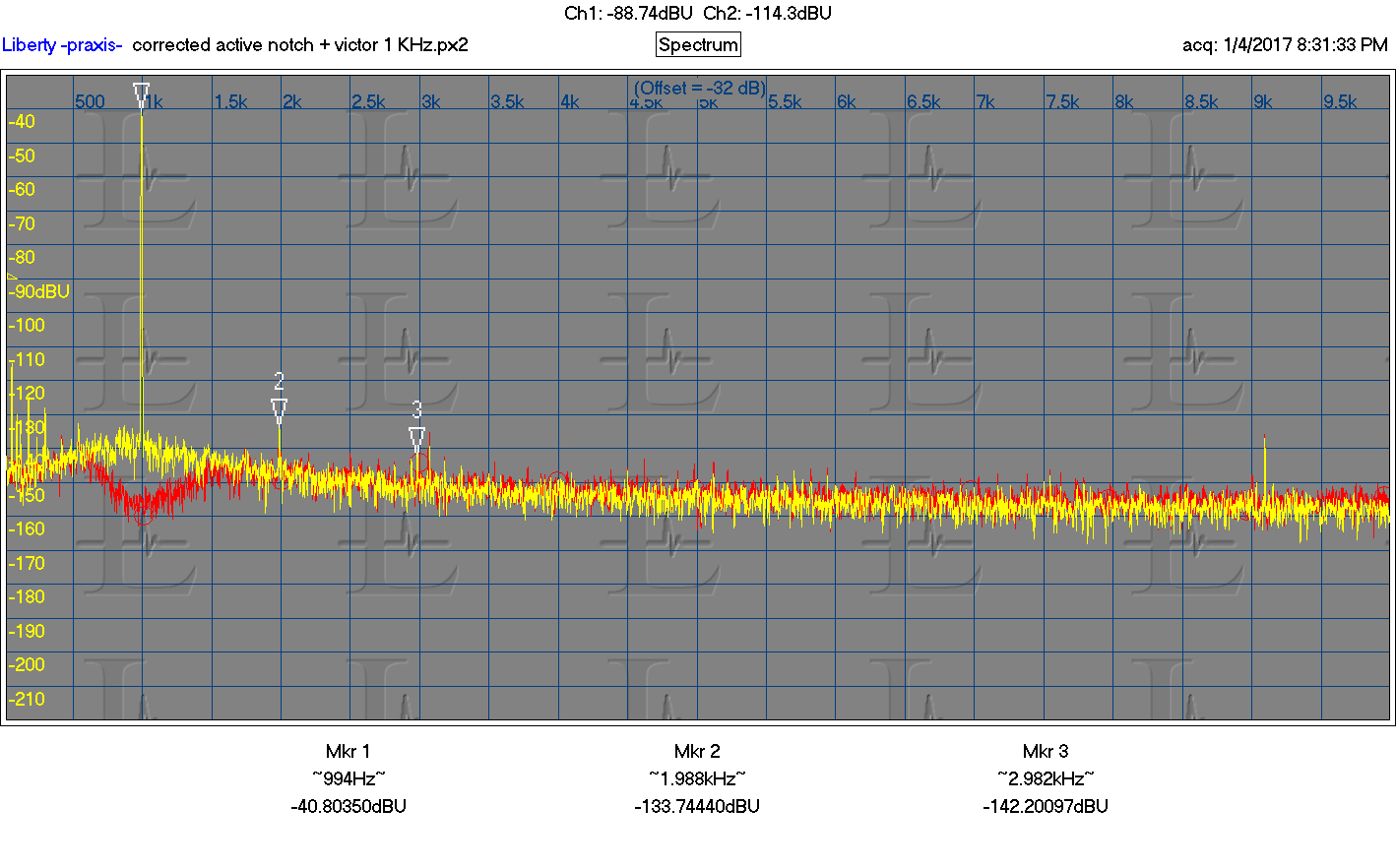

Right now, i am comparing the data produced with various analyzers and generators. Can you measure with other analyzers and get the same identical results?

Per request here is the Shibasoku and an active twin T superimposed. The harmonics agree to around 1 dB. Its hard to see that difference. Yellow is the active twin T and red is the Shibasoku. This suggests that the harmonics of my Victor are around -133 H2 and -142 H3. This is an earl example and victor has improved them since. He sent me the details of the upgrade but I have been too busy to either upgrade or get another so far. This is on battery for both the oscillator and the notch. AC power brings a ton of other crud.

This is close enough to two other machines for comparison --- the 7722A reads 2H = -133, 3H = -146 (re 1v); The 725D reads 2H = -138, and 3H = -145
But my AP 2722 is way off the mark. I will have to tear into it tomorrow. AP sent me a matched pair of input amp pcb's. Very nice of them to respond quickly and surprised they had the input pcb's in stock.
