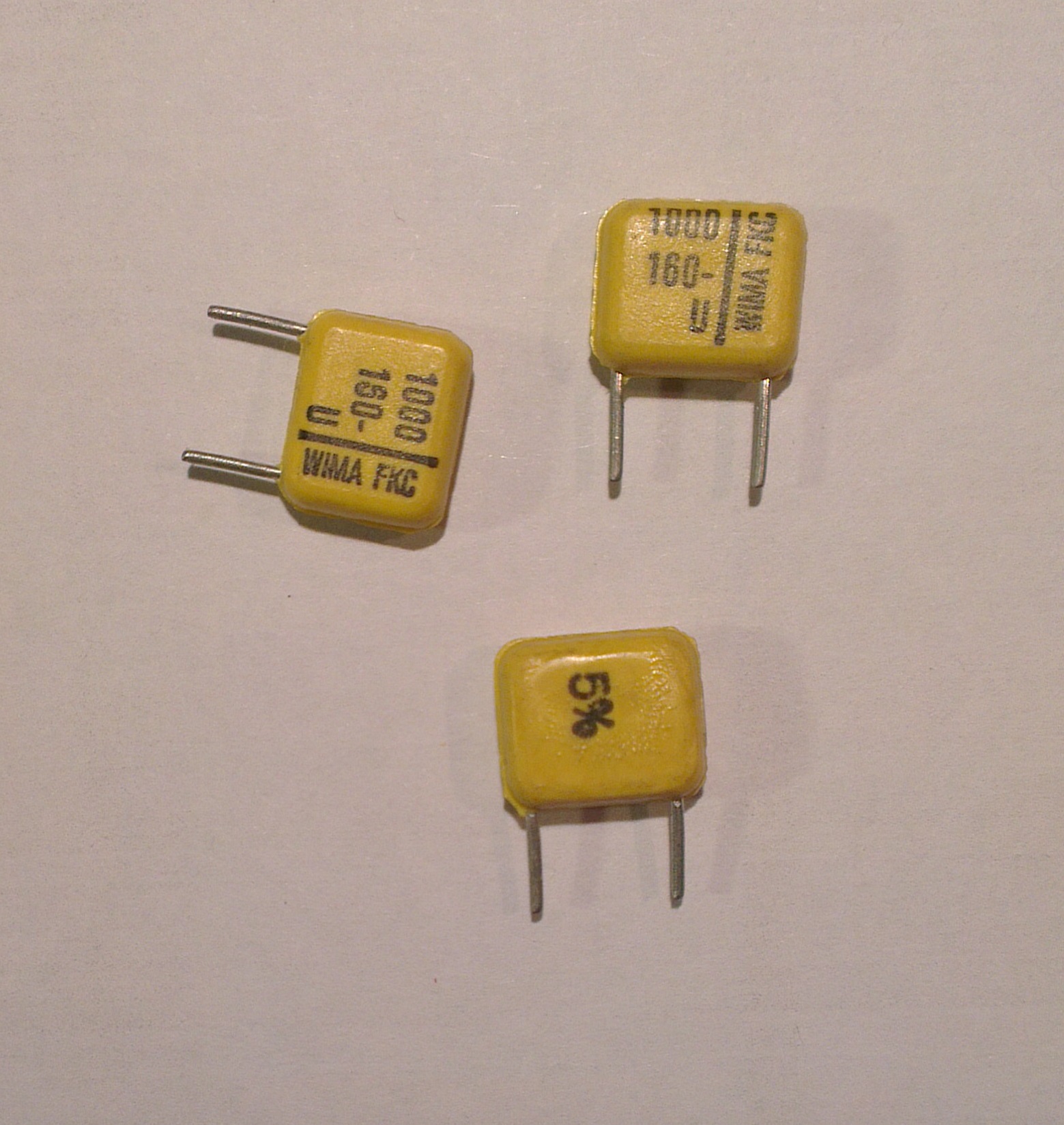

yellow Wima are old polycarbonate from memory

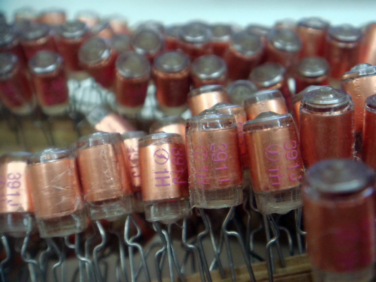

Exxelia (was eurofarad) still make polystyrene-capacitors caps
the Nissei copper foil Styrene caps are getting rarer and expensive on ebay
