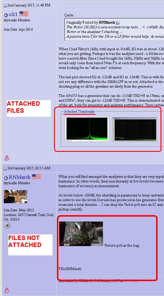

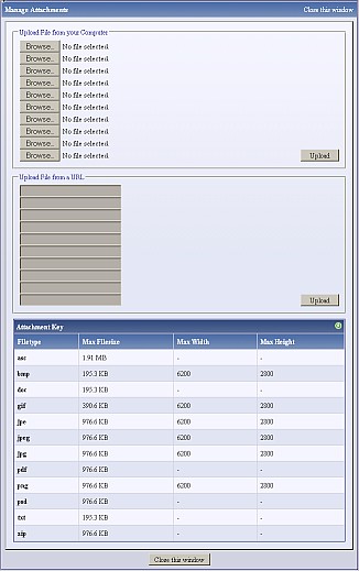

That's strange, it's just that your pictures doesn't appear as attachments inside the attachment box at the bottom of your posts (See picture 3), instead they are spread inside the post message area where one writes the text, for most other people it works and I can click and zoom in.
Are you sure you use the Attachment Manager as in picture 1?
And when you click on it, it opens up another small window on top of your browser according to picture 2?

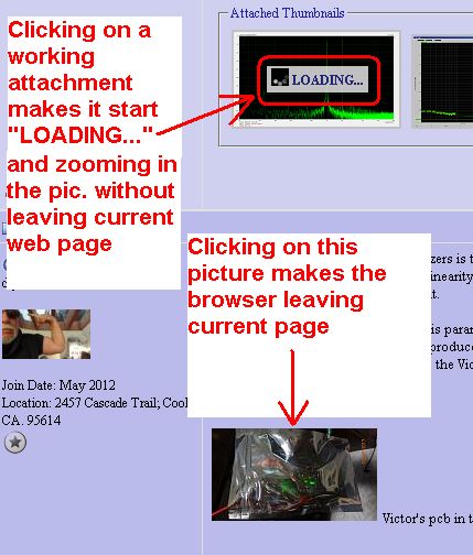

As one can see in picture 4, user ci11's attachments works perfectly fine for me.

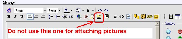

Do not use the "Insert Image" button or any other tools from above tool bar, see picture 5, and do not paste pictures directly into the post.

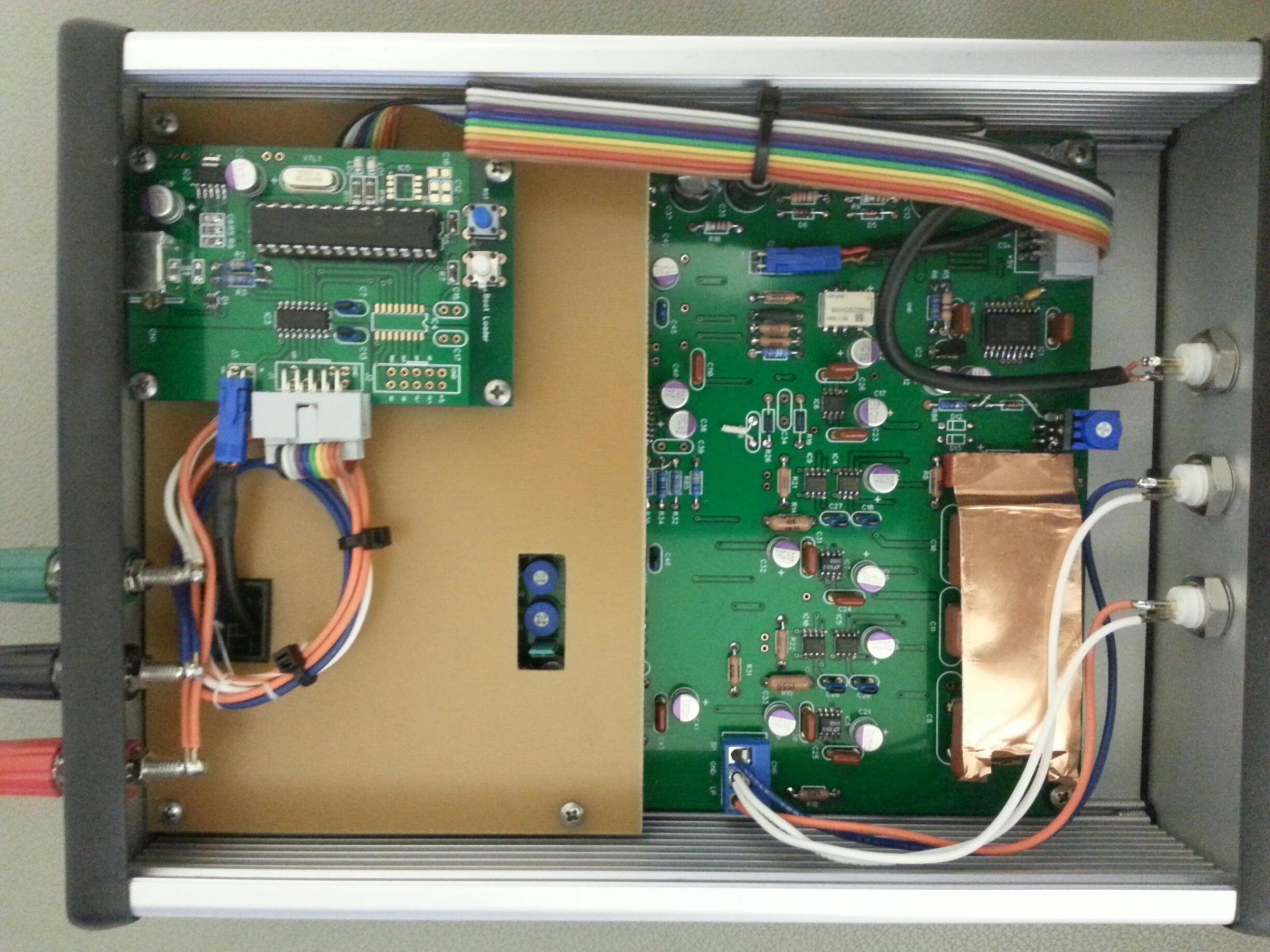

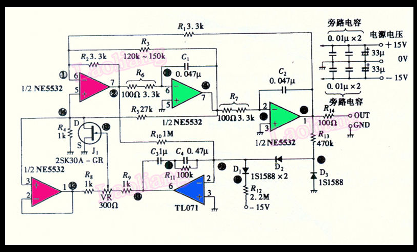

I've been playing with this oscillator for a while, and here is the list of changes made so far:
  • The two 5532s replaced by 4562, TL071 by OPA627
  • The 0.047uF polyester caps in the SVO replaced by two matched 0.033uF Wima FKP2
  • The 3K3 resistors replaced by 5K/0.1% glass-encapsulated resistors. I don't know their origin but I know they were used in the precision strain gauge amplifiers made by a company I used to work for.
  • Removed the two 100R freq. adj. trimmers, the frequency is now adjusted by trimming R1
  • Added a 22K pot in front of D1/R12 for adjusting the output voltage
  • The FET is now MMBF4091 with the parallel resistor R4 reduced to 500R
  • R3 in the local NFB from the 1st integrator to the inverter is reduced from 147K to 133K
For illustration, I'm enclosing a spectrum obtained at the output voltage of 1Vrms, but please note that this is not the best result I've got - I'm not at home right now and the measurement with the lowest THD was made with another laptop. While the 2nd is the same in that plot (-130dB), the 3rd is at the level of -140dB in the lowest THD spectrum I measured.
The measurements were made with a MOTU Audio Express interface using the SpectrumLab S/W, the sampling rate was 48kHz, FFT length 512K, spectral window was -196dB FlatTop, and the number of FFT averages was 32.
Other artifacts in the spectrum are not due to the oscillator - they come from the SMPS powering the audio interface.
Hope this spares some time in modifying the oscillator.
Braca

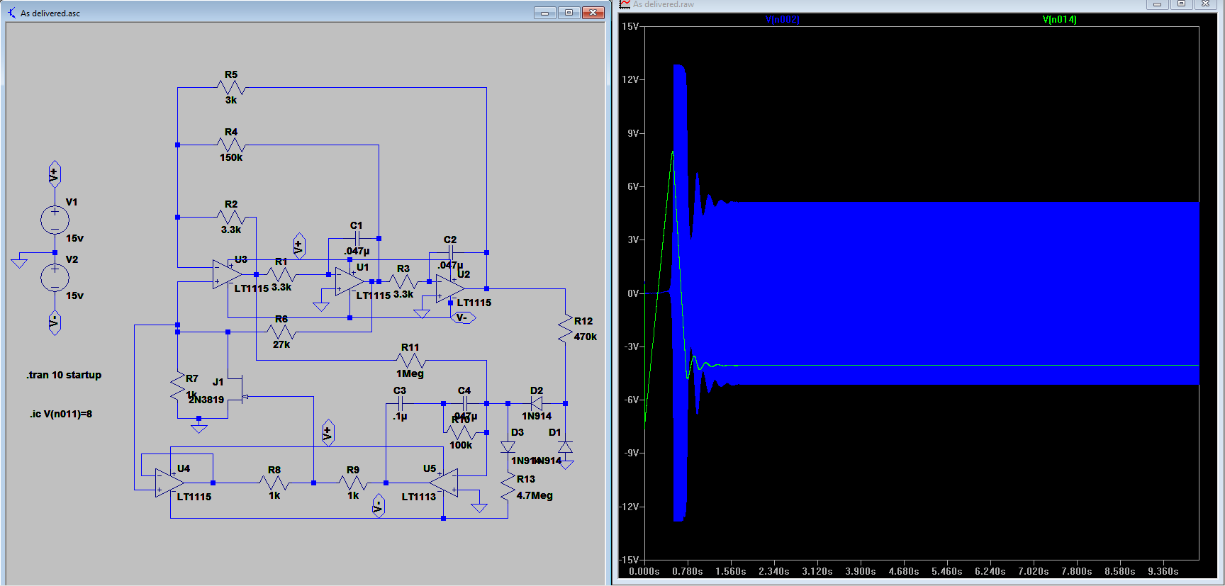

I finally got my two examples running. Stock they are disappointing given what they started with. The output is sensitive to the negative supply voltage and is too high, especially for 5532's. I get less than .01% but just with strong HD2 and HD3. The AGC level detector seems to be less than ideal and has significant harmonic energy at its output. My first trick was to try to lower the output by changing R12. I think the PCB may be mismarked because its responses more like R13. Lowering to 3V out did not reduce the harmonics significantly. The distortion trim has almost no identifiable effect.
I created a simulation (attached) to see what it happening. It seems the AGC output has enough harmonic ripple that its getting into the JFET and causing the distortion. I'm still not sure what the real contribution of R3 and R10 is supposed to be. I made the simulation so i can try options easier, however even on a fast computer it takes a long time to run. With the stock values for C3 and C4 the output doesn't stabilise in 10 seconds which takes about 10 minutes to run. I reduced both 10X in the simulation pictures and increased R12 to 5 Meg to get the output down. It may be faster to just tweak the board itself.
The diodes listed are fast diodes but not really different from 1N914 and the transistor listed actually has a lower IDss with more C than the one I'm using in the simulation.
I'll play with it some more today.
