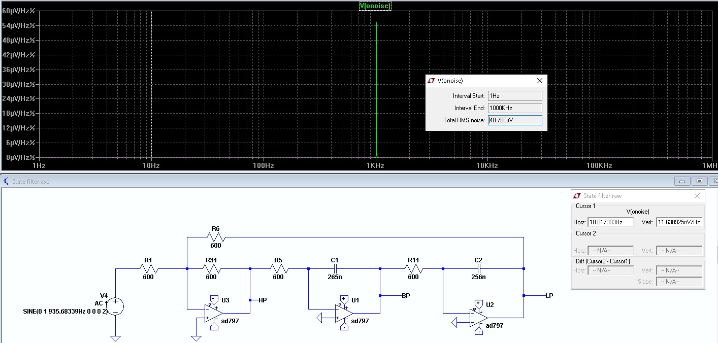

In the oscillator for my THD analyzer, the integrator resistor value is about 2.2k at the geometric middle of the frequency range, so I'm guessing that the target would be in the neighborhood of that value. I think the optimum op amp noise impedance is quite broad.
Although not stated as a particular feature, it looks like the OPA209 has quite respectably low THD on the order of -110dB at 20kHz driving 3V into 600 ohms, and on the order of -130 at 1kHz. By comparison, the LM4562 is spec'd at -126dB at 20kHz under the same conditions. Spec differences at 1kHz are about the same, but at -130dB things get pretty fuzzy. In my view, 20kHz is where the rubber meets the road.
The LM4562 is spec'd at 2.7nV/rt Hz and 1.6pA/rt Hz, so its noise impedance is lower and its "noise figure of merit" is not as good.
For reference, the NE5534 is spec'd at 3.5nV/rt Hz and 0.4pA/rt Hz.
The OPA209 would be quite competitive for this application.
Bob
...The LM4562 is spec'd at 2.7nV/rt Hz and 1.6pA/rt Hz, so its noise impedance is lower...
Noise power is lowest at the noise impedance but does this matter when we don't impedance match?
I don't think our application is comparable to, say, a matched RF antenna.
Instead we have an output buffer amp that sees the noise V.
So shouldn't we try for the lowest source impedance we can?
For our State Variable oscillator the source impedance of one section is the load impedance of the previous section so the lowest acceptable load impedance sets the minimum.
So I think the noise FOM is En squared + (In * minimum cleanly drivable load) squared.
I looked at the noise impedance only to find a ballpark number to try.
Have I overlooked some point?
Best wishes
David
Yes, Dave, I'm pretty sure you're looking for the lowest noise energy spectra on absolute basis, as you describe, rather than necessarily balancing the relative contributions of each respectively. As such, it's going to be toggling network impedance against opamp drive capability against overall noise energy. Which seems, to a first order, to examine minimum feedback impedance you can get parts for followed by best opamp to handle that impedance. From there, you're just playing with racheting up network impedance to meet a sweet spot with a given opamp.
Likewise, irony, especially subtle, is very hard to pick up in written form. 🙂
SVF noise LP out
That certainly proves Samuel's point that the resonance causes the noise to be rather concentrated😉
Probably clearer to show the noise on a dB scale.
I think that if the op-amps are to "see" a 600 load then the resistors need to increase because they are effectively in parallel with the feedback capacitors or resistor.
I also think it's time to fix my Spice computer, even if it's educational to work this stuff out, because that plot raises a few questions.
Like "what is the impact of noise very close to the tuned frequency".
Presumably that causes the noticeable "skirt" around the frequency peak on Bode plots, so would lower noise op-amps help?
For the sake of demonstration you could rerun the sim with the resistors well below the noise impedance (I think the macro models are linear and will work for a noise sim, even at unrealistic loads).
Noise should be lower.
