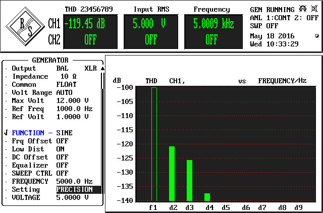

Ok, since it's quiet Sat I'll bite, Attached:
- Distortions of a piece of 1.6mm double sided PCB 1.6mm thick (the first piece I was able to grab from the dumpster) about 15x15 cm in size. 575pF as measured by a handheld impedance meter.
- Distortions of a 470pF/100V styroflex capacitor.
Bottom line, the PCB distortions are under -119dB. Could get lower with multiple air separated shielding, steel box, etc... unfortunately I don't have the means to do this.

Yes, and 10ohm RGen as shown. Input impedance is 20K||200pF (balanced). I should have mentioned, I'm not saying that distortion values are correct as absolute values (the cap impedance at 5KHz is about 63K, so there's definitely a large contribution) but the PCB distortions are not worse than a good quality film cap.
If I connect the UPD generator with the analyzer internally (no cables involved), the distortions go down to -133dB.

That's all I can get (-120dB), even with the balanced I/O cabling shorted (no cap). Sorry, I can't do better without a multiple shielding enclosure, which I don't have and have no intend to build. Material is FR4, don't know the source.

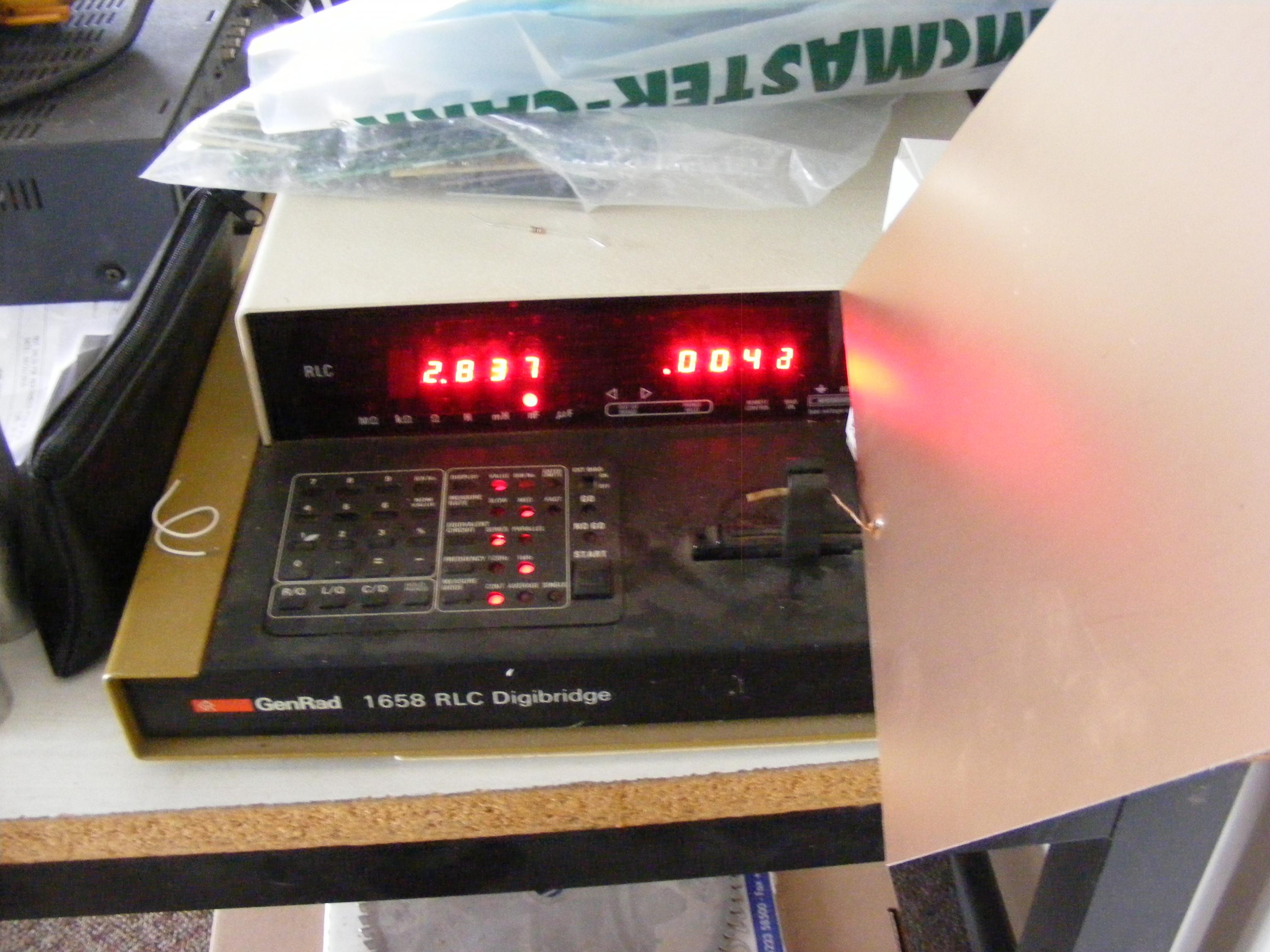

Well I have some FR-4/G10 PC material with 1/2 oz. copper .032" thick 8" x 10" with a dielectric constant of 5.2 at 1 Mhz., dielectric strength of 400V/mil, a dissipation factor of .025 @ 1 Mhz., permitivity at 1 Mhz. of 4.7 maximum, a loss tangent of .015 at 1 Mhz with a volume resistivity of 5e5 mimimum. Test signal 5 Vrms at 5,000 hertz.

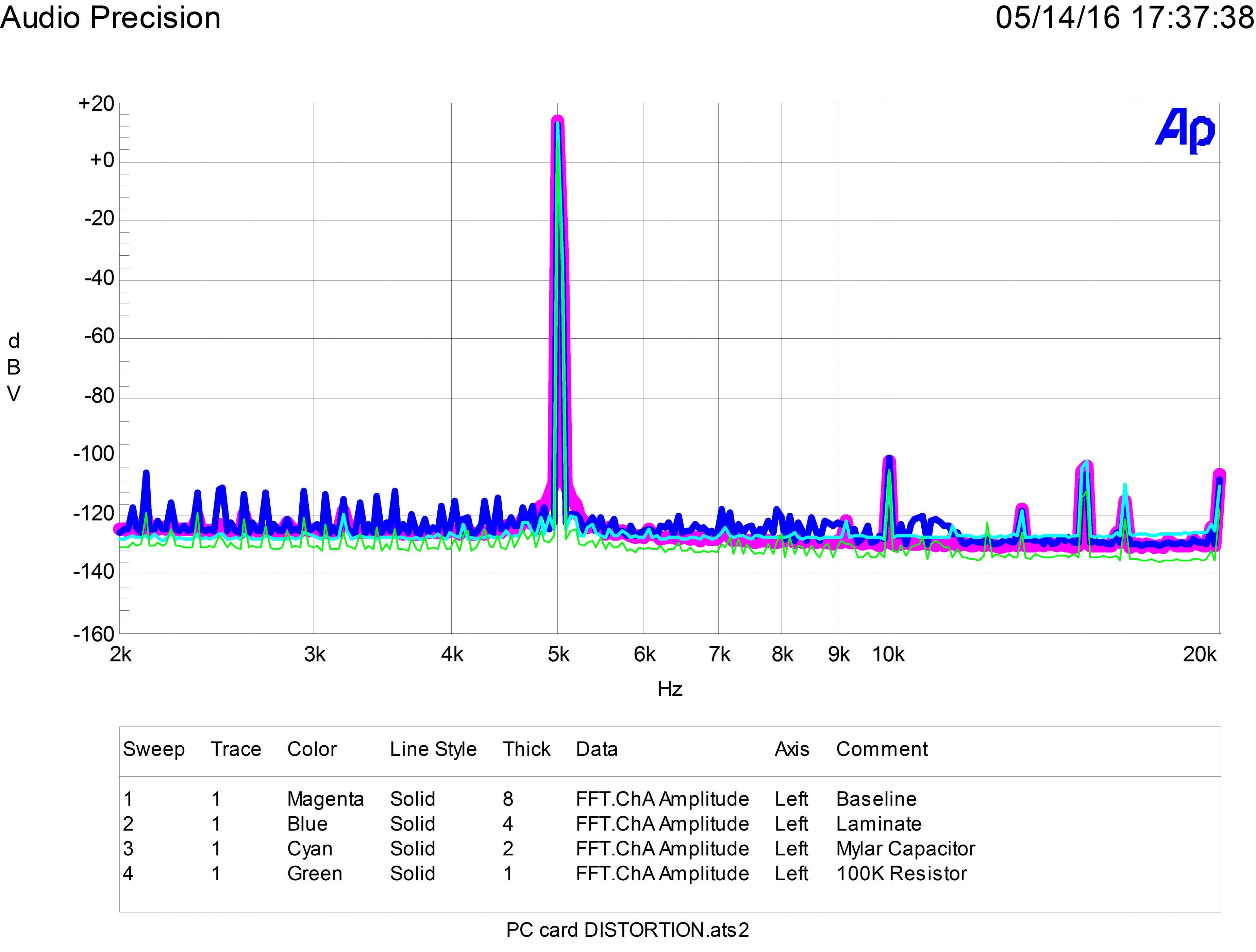

Soldering two leads to it and measuring it with my bridge is shown in the first attachment. A similar MYLAR capacitor is shown in the second. The third are my test results for the AP System 2 residual, PC card, capacitor and 100K resistor.

All I see is the laminate acting as a great antenna (which was my point about multiple shielding being required). Is there anything else I'm missing? Or is this one of the usual "how dumb you all are" charades?
Just looking for the lowest distortion material by any and all available tests and how to measure it. As this isnt about amplifiers per se.... but ultra low distortion generator...... which I tested months ago and it DID require me to put in its own double shielded environment to test the very low residual distortion from Davada's generator .....
JC might have a partial answer to the limit of measuring small C in series with the instruments input (non-linear) C might cause us/me looking at distortion generated by the interface.
What do you think?
